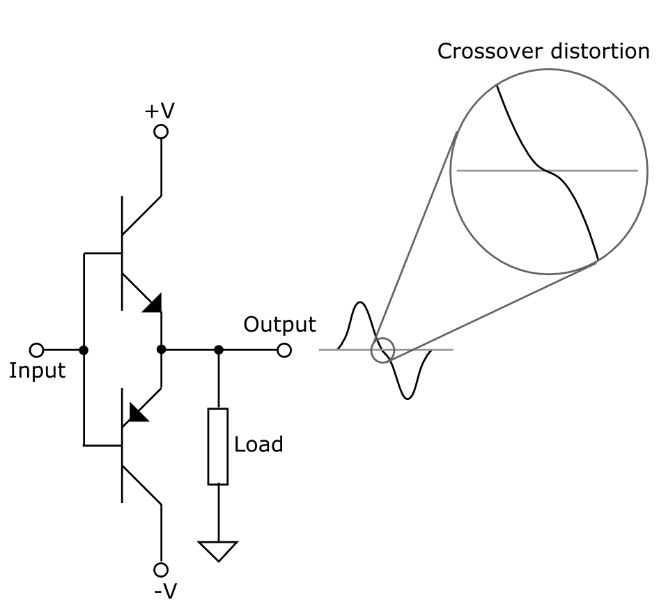

I can't help thinking you'd be able to identify something just a little like crossover distortion?

I'm not sure crossover distortion is quite "right" as an analogy because the waveform itself is already "in-movement" (positive crossing-into negative).

I think the "behaveier" is with and without xover, and that a xover can`t correct the cone movement in that matter, but again my own thought.I can't help thinking you'd be able to identify something just a little like crossover distortion?

I suspect that whether it starts out like this but doesn't do it during the next crossing is an important part of what you're trying to demonstrate.I'm not sure crossover distortion is quite "right" as an analogy because the waveform itself is already "in-movement" (positive crossing-into negative).
I think whether it falls into the linear category and is therefore irrelevant is what I'm trying to find out, as it seems you're saying it's a non-linear effect.
In any case I tend to hear the same at low levels as higher, unless thermal effects or gross distortion come into play.
Perhaps I was just hoping to be shown a distortion plot or something. I don't understand the part of what you say that I've quoted.I think the "behaveier" is with and without xover, and that a xover can`t correct the cone movement in that matter,
