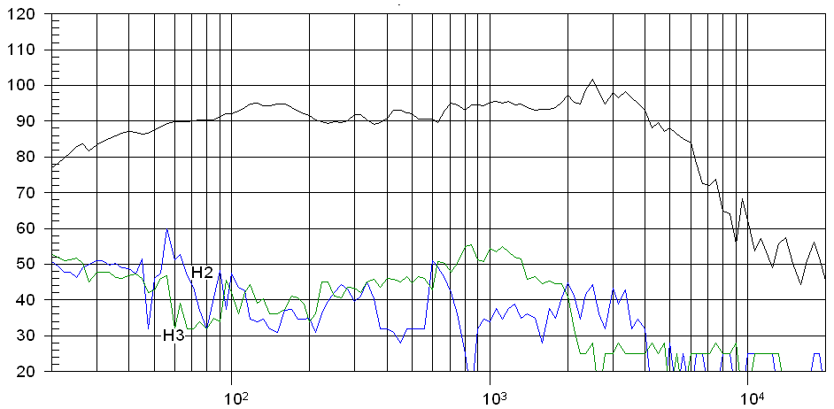

How is the low of this 12 vs a 15 ? Does the room will give enough gain to figth the extra Fs of a 12" vis a vis of a 15"?
They both have about the same FS ( Omega 33 vs Beyma 31 ), and not "much" to work with in the Omega´s 4,8 mm XMAX.
But even if the Beyma is "only" max 250 W, the Beyma 12BR70 ha almost x2 on XMAX and also work in smaller cabinettes.

with normal music, how loud do you think you need to listen to hit the xmaxx long enough to hurt the omega 15a? 120db?
ive just been told even the Beyma 15lx60v2 vs the Pro 15a wouldnt give anything better even though its rated at 35hz vs 50hz, same with SM-115n.
do you think the Beyma SM-115n would give better extension?My measurements show that the omega pro 15a are flat down to about 40hz in my 180L cab...

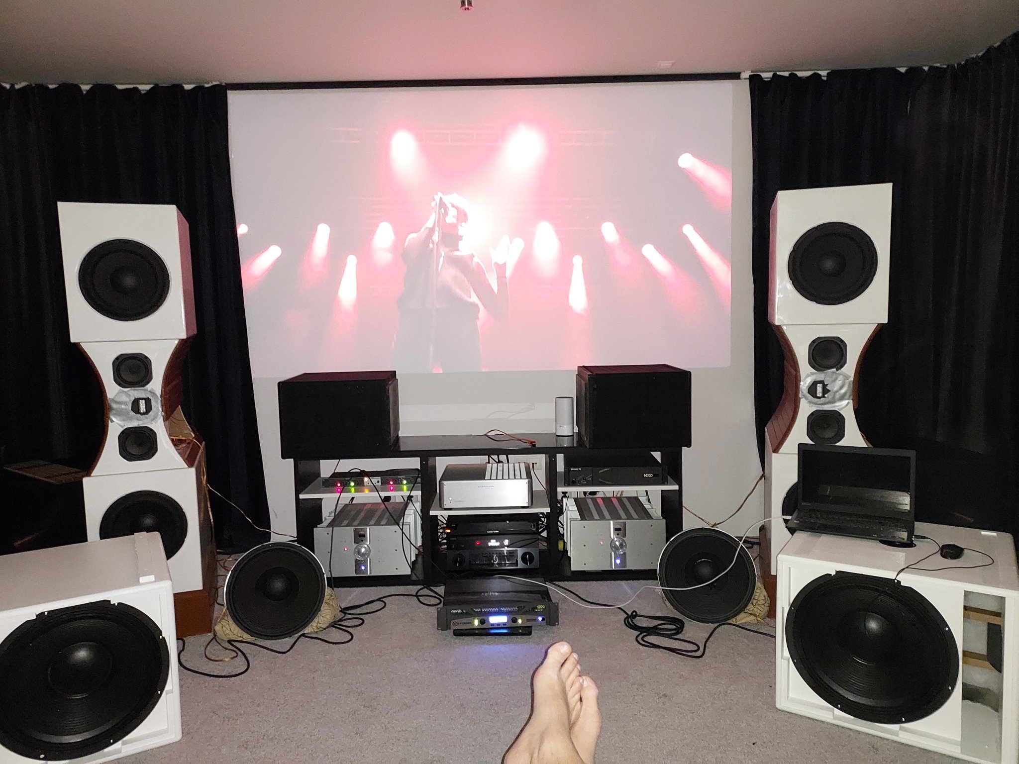

Have YOU ever heard Eminence omega pro 15a in a 180L?

Of course you can play very loud with the Omega 15a youknowyou, i don't hesitate that hahaha 😉
And 180 L cab is "a real" big one 👍, what port tuning frequency?, or do you use sealed box?
For me "the foundation" in the music (when i listening on speakers) the sound between 16-35 hz. (with the room´s help)
Hard to explain but it "fills the room" coming from floor-hight/level and builds up against you, and makes the music so much more "real/dramatic/better"....Hard to get the smile out of your face when you listen.

Even at 100db, i barely see the woofer moving.

No it's not that I disagree - basically I'm saying that subjectively the results will be fairly similar. Slightly more low freq. extension rarely has much to do with an audible improvement. (..a full octave near the average will of course.)
BTW, you can put the T/S parameters of the Beyma woofers into winISD and model. I believe it's in the "Database Maintenance" tab for adding "your own" drivers.
