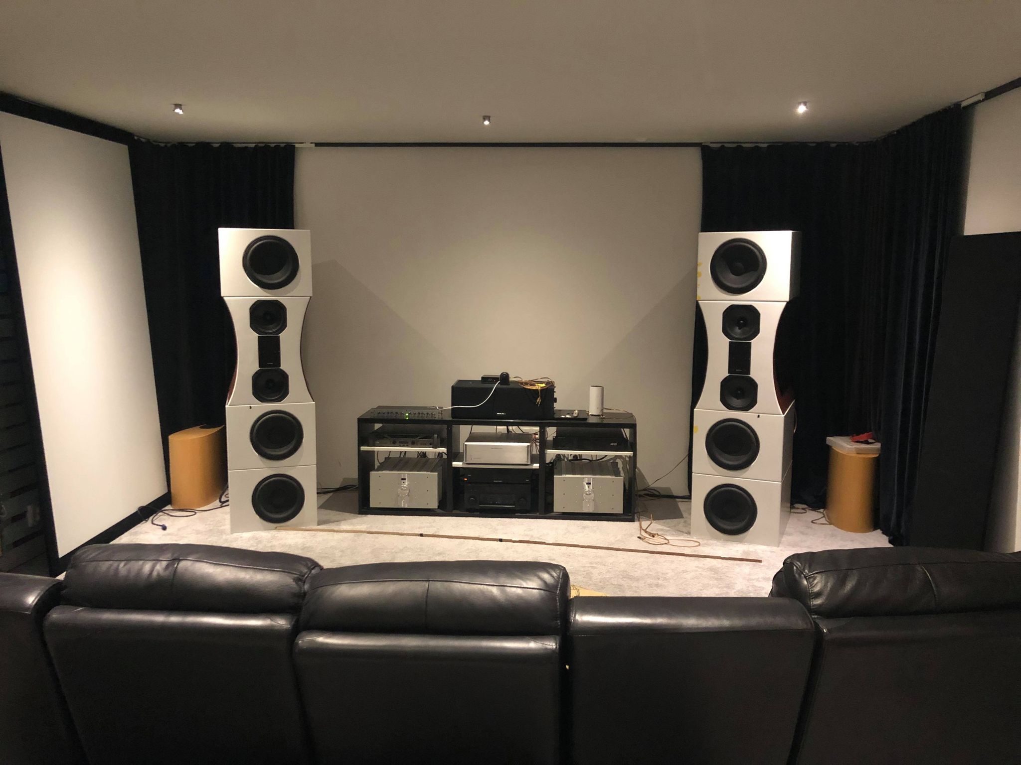

Latest DIY was with Audax HM210Z10 in MTM with Mundorf AMT29CM1.1R, HM210Z10 from 300-1850hz.
But that DIY was more for maximal SPL capacity (because im a 110dB listener) and wanted to have great headroom.
So systems can play 127dB with almost "top notch" Hi End qualities.
And HM130Z0 is a better "musical"midrange but with 92-93 dB sensivity if that is enough, Audax HM210Z10 is 99dB so it suited the Mundorf AMT29CM1.1R at 100dB better.

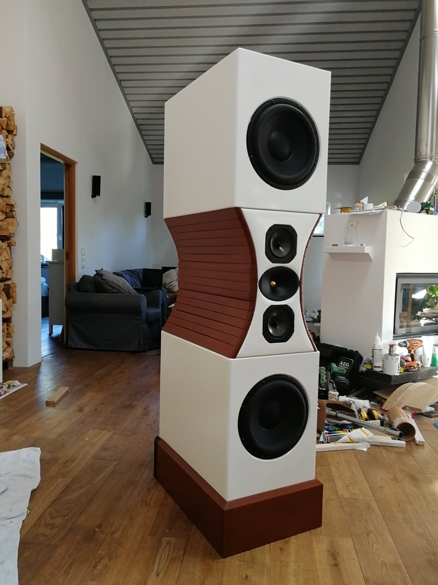

Epic build! very jealous of your wood skills.
do you prefer the PR170MO over the HM210 and HM130ZO?
Ive put denim foam in the enclosure for the audax mid. the mid enclosure is fully isolated from the woofer cabinet. I should probably try melamine foam in there and see which i prefer! ill also try to mod the audax mid with various methods.

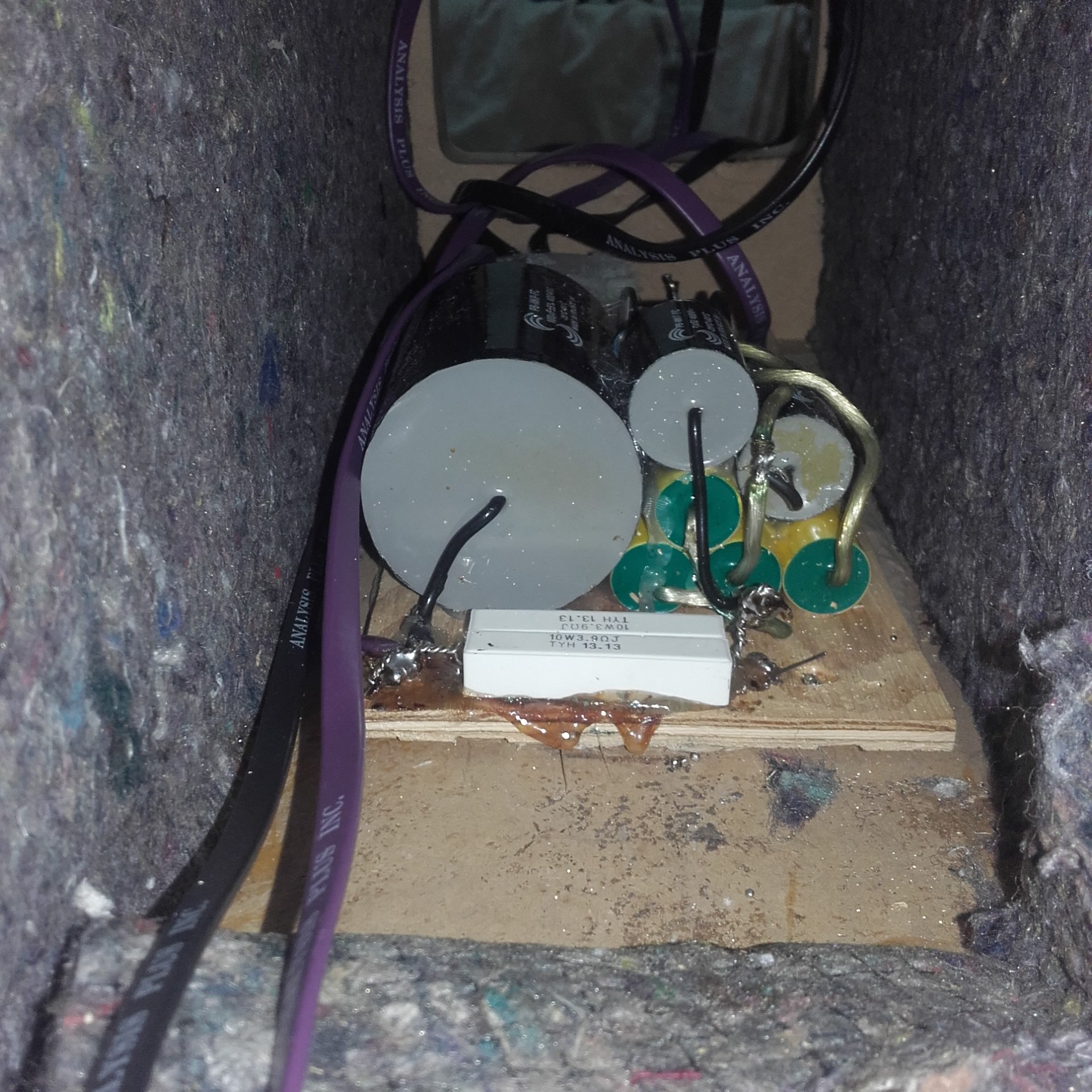

And this is what happend with the Audax HM130Z0 when you are a high level listener for 4-5 hour´s (and drink whiskey 😉)
Last time i blow up all 4 of them in my MTM ( test with Wiavave SRT-7 tweeter), but they played insanely good to the end.
And thats why i had to start the 2xHM210Z10/Mundorf-MTM-project.....Headroom!
/Jawen
Thanks !

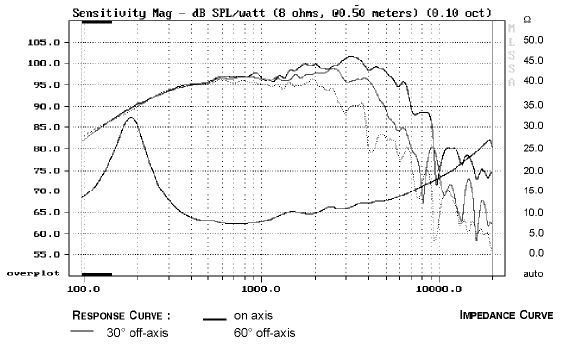

Xmax only +-0,5 mm so like a "stone", and MMS is 9,17 grams against HM130Z0 how is +-2 mm and MMS 5,9 grams
Only down-side to the HM130Z0 is "nominal power handling" at 50 W against 100 W for M0
