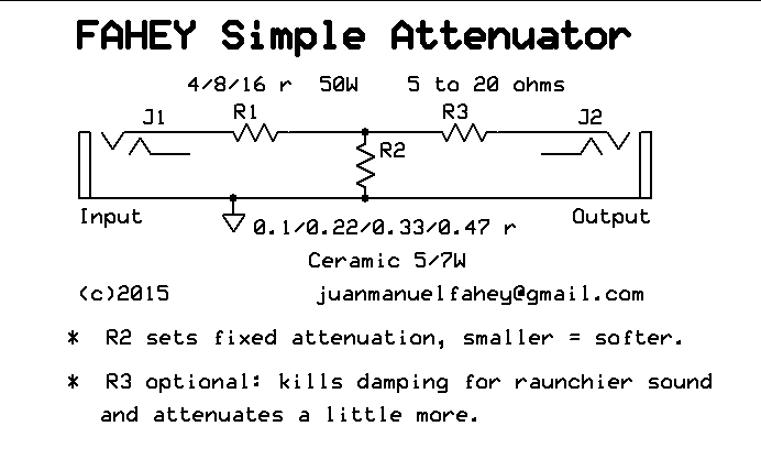

Try my "3 A.M" Simple Attenuator, lets you play full blast at 3 AM with the baby sleeping on the next room.
This one is for 30/40W amps, you can use a 25W main resistor ... or just use a 50W one and play it real safe.
Mount the main reistor on standoffs allowing air circulation around it and place it inside a perforated case for ventilation, it becomes quite hot.
The others ... no big deal.
You can build it "fixed" or use a rotary switch to change attenuation.
I´ve sold over 100 of them, very useful in the modern appartment life with "sensitive neighbours" 🙄

Reading this thread (post #18 and JMFahey's implementation) I understand that the resistor approach has proven effective. My question is, since the values depend on the output impedance of the amp, so they would vary from amp to amp (or even presence setting for the ones that alter the NFB path for this - perhaps to very little effect of course), isn't it an amp-specific design?
Could the design I attach be more effective in actual use in that it would cover more amps?

Depends how golden your ears are. The amp designs varry, NFB verses non-NFB. Why is it some say this speaker sucks and another it is fantastic? Part is the NFB keeping the amp well behaved (at least below clipping) where you get a non-NFB amp trying to keep power constant in a varying impedance therefore getting a rise in response either end. For the purists (Go to the Marshall site) you have a lot of tweaking. "Oh the treble is a little down", well turn the treble or presence up on your amp. "I don't want to do that." Well, then you need a more complicated attenuator.For some of us a simpler attenuator works fine. I just want an attenuator with two reductions settings.
I was posting in this thread before, but my attenuator designs have moved along so im posting again. Adding a reactive coil, in the right way, helps a lot to maintain the responsiveness of the amp as you play harder and softer, as well as the basic tone, and its not expensive (the coil is about $10)
If you are building, and on a budget, check out our thread. Its 82 pages but just look at page 1 post 1, and the design M2. Its been build dozens of times now, and its about $100 in parts for the full version. It has been tested on many amps of many types, and it seems to adapt to them, maintaining the tone very closely right down to very low levels

I doubt thats a good idea, as with such a transformer, you change the load to the guitar amp. the whole idea is to lower the SPL without changing the load to the amp.
