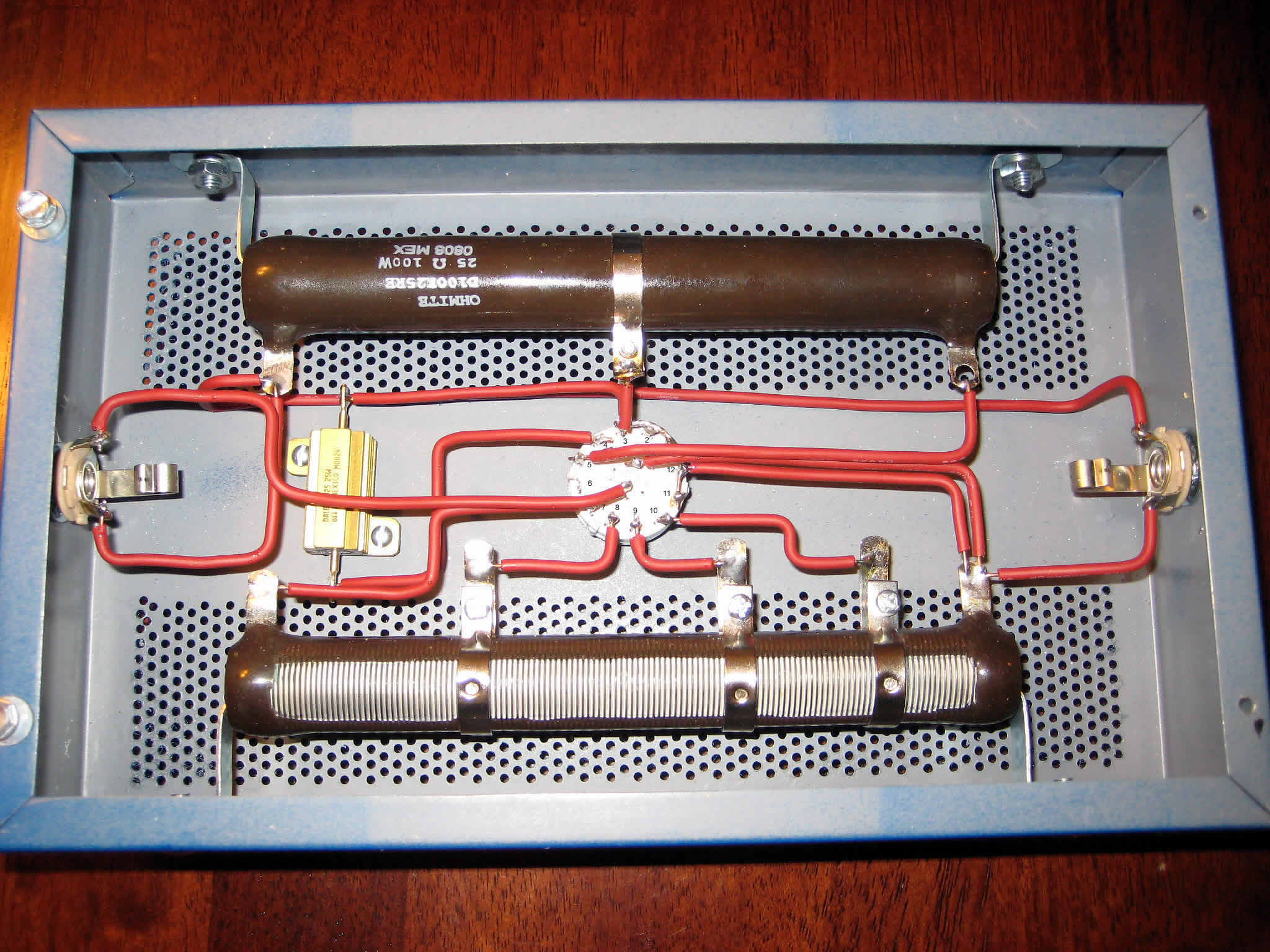

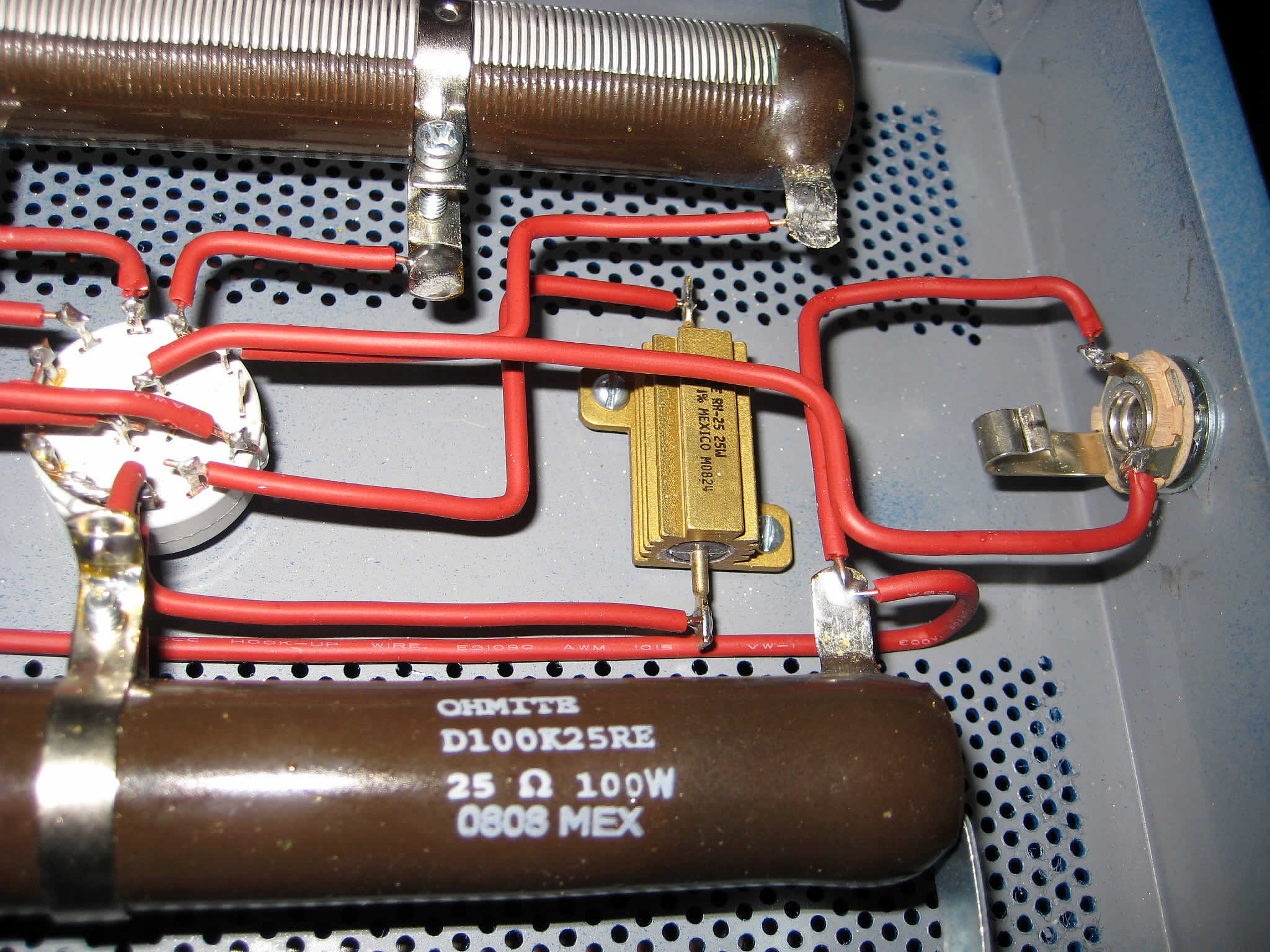

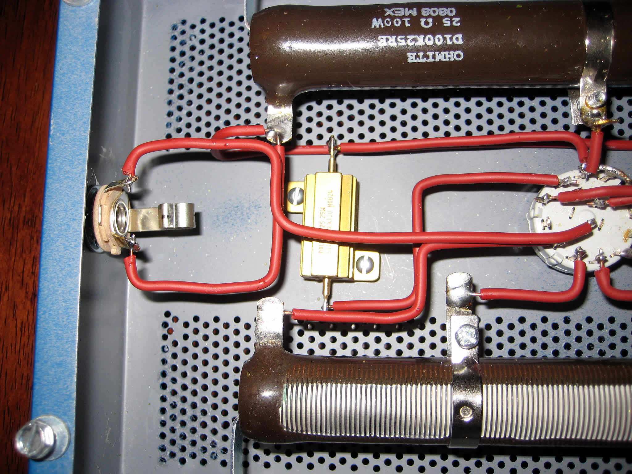

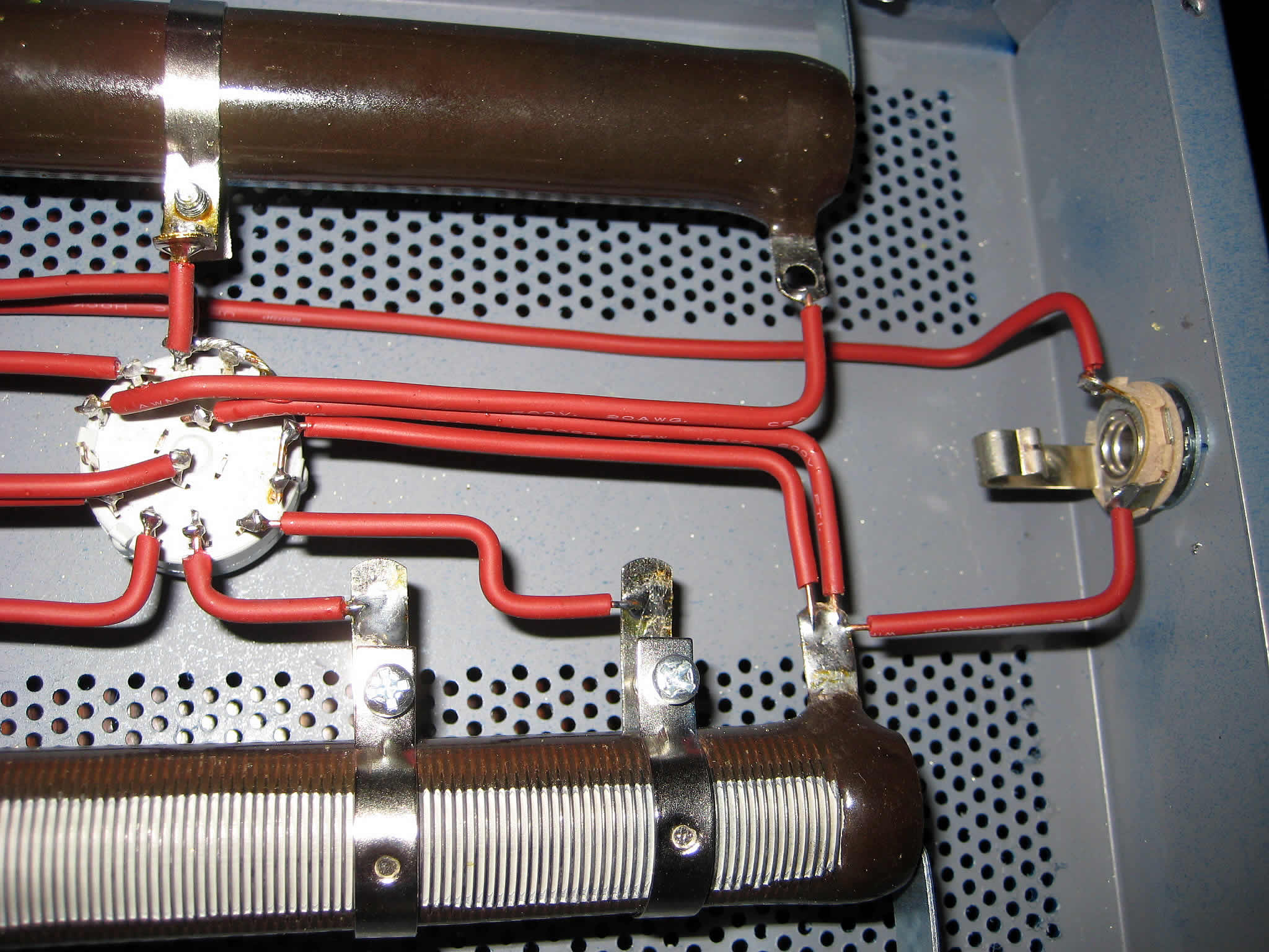

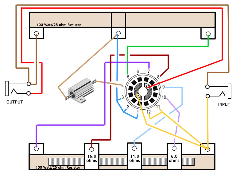

Try my "3 A.M" Simple Attenuator, lets you play full blast at 3 AM with the baby sleeping on the next room.
This one is for 30/40W amps, you can use a 25W main resistor ... or just use a 50W one and play it real safe.
Mount the main reistor on standoffs allowing air circulation around it and place it inside a perforated case for ventilation, it becomes quite hot.
The others ... no big deal.
You can build it "fixed" or use a rotary switch to change attenuation.
I´ve sold over 100 of them, very useful in the modern appartment life with "sensitive neighbours" 🙄
I really like this one🙂, and I am thinking of going with that design, amp will have 8 ohm outputs, but I would also like to experiment with 16 ohm attenuators, and also add some mods to it like coils and caps so it could sound more "natural" and I also found a vintage yougoslavian pot-switch which could also be used!
Well, in any case it´s simple and inexpensive, so try it.
For testing you don´t even need a case or a board/terminals, just solder all 3 resistors together and place the 25/50W one on a brick or a couple stacked bathroom/kitchen tiles so as not to burn the table.
If you like it, then put it inside a suitable case.
Good choice! And if you look closer at post #18 by JohnDH, you'll see that what he proposes is essentially the same attenuator JM Fahey suggested. The basic network is a "T" of three resistors that does three things at the same time: provides the right load impedance to the amplifier, provides the right amount of attenuation, and lastly, provides the right (high) source impedance to the guitar speaker.I really like this one🙂, and I am thinking of going with that design
This last requirement is the one that is often forgotten - but look at the thread JohnDH linked. He made the measurements to prove that this is all that's required to make a really good attenuator that has only very slight effect on the EQ of the signal being fed to the speaker, which is what we want. No change in tone, only loss of SPL.

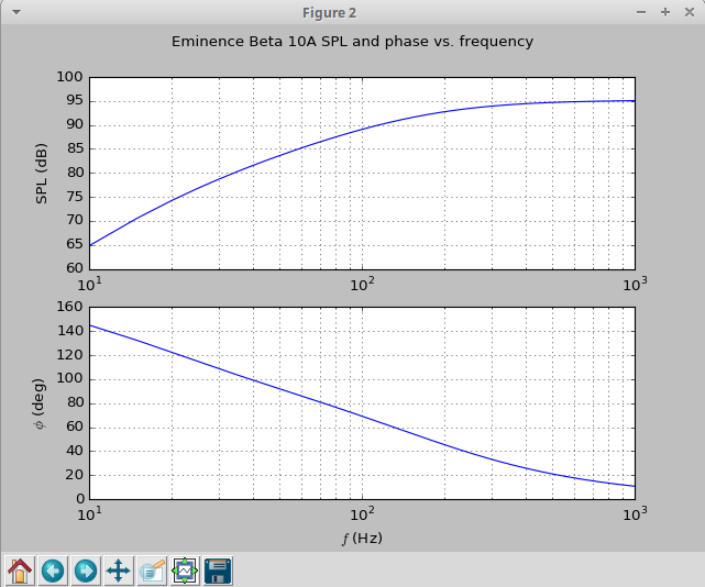

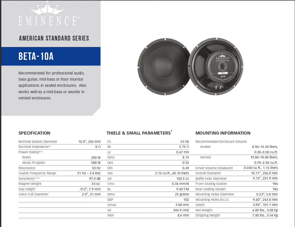

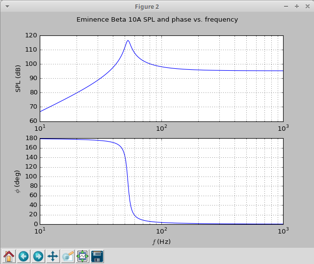

I think the low resonance from the speaker that you get when driven from a highish impedance source compensates quite well for the roll-off in low end that you get in published frequency response speaker data. (such as from Celestion etc). All of that happens with the right output resistance from attenuator, no need for extra low-end resonance circuits after the amp to get the basic tone right. But amp tone, presence/resonance controls, high/low inputs, EQ in the loop etc, can be used to tweak the tone to taste if wanted.
Attached are three images:I think the low resonance from the speaker that you get when driven from a highish impedance source compensates quite well for the roll-off in low end that you get in published frequency response speaker data.
1) A factory datasheet for an Eminence driver
2) A calculated free-air frequency response for that driver when driven from a solid-state amplifier with essentially zero output impedance
3) A calculated free-air frequency response with the speaker driven from an amplifier with a 50-ohm output impedance (which is in the ballpark for a typical 15 W push-pull valve amp with no negative feedback).
The enormous difference between the two frequency responses is clear to see.
This particular speaker is too heavily damped for free-air use when driven by a solid-state power amp; no surprise, since it's designed to be used in an appropriate sealed or ported cab. In free air, even though Fo is a low 53 Hz, acoustic response starts to fall off below about 120 Hz. In the proper size sealed (or ported) cab, the bass response will flatten out and extend lower.
When driven by a 50 ohm source impedance, on the other hand, the "Q" of a speaker rises from Qts to nearly Qms, because there is effectively no remaining electrical damping from the currents induced in the voice coil. There is only mechanical damping (from the losses in the cone surround, spider, and "goop" applied to damp the edges.)
For this speaker, Qms is around 8. A Q of 8 doesn't give you a broad, gentle bass hump. Instead, it gives you a tall narrow spike in the frequency response. This is not going to blend nicely with any kind of open-back cab; no matter what you do, you will get boomy "one note bass" at about 55 Hz.
To behave even reasonably well when driven from a 50 ohm source impedance, a speaker needs a very low Qms, with a value of, say, 1.5, or 2. This would require a *lot* of mechanical damping in the spider and cone surround.
I don't know if traditional guitar speakers really do have such a low Qms. Manufacturers never seem to publish any Thiele-Small parameters for them. (And we know why, because the high source impedance of a valve guitar amp makes nonsense out of most of the TS parameters anyway. For example, Qts and Qtc become irrelevant.)
