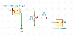

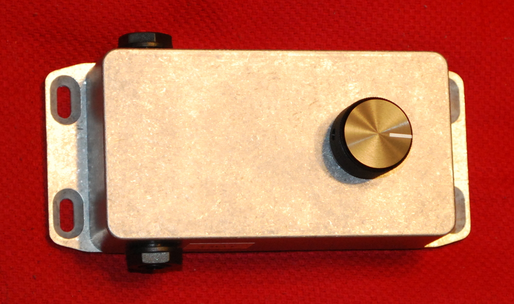

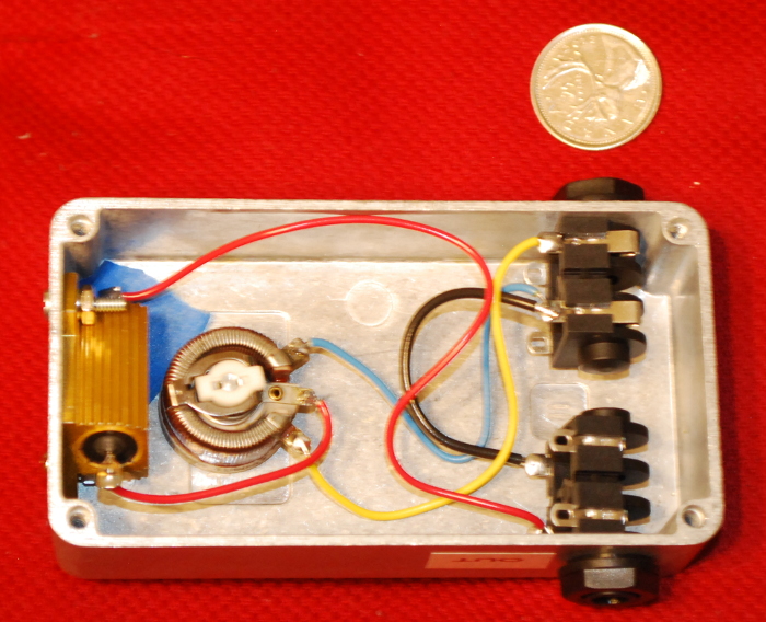

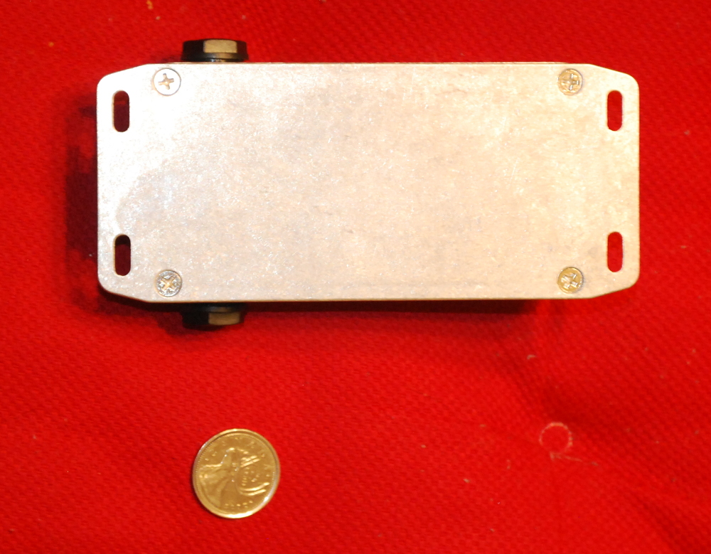

I just finished building a little attenuator around the 12.5 W Ohmite rheostat. I figure it will handle my little 2 W 6AK6 push-pull amp, and probably anything up to Champ territory, say 5 W RMS. It's built into a little Hammond box of the size typically used for guitar FX pedals, roughly 60 mm x 110 mm, or 4 1/4"x 2 1/4".
Input impedance is close to 8 ohms with the rheostat at full and an 8 ohm speaker. At other settings, input impedance is between 8 and 10 ohms, depending on speaker impedance and rheostat setting. Output impedance is always close to 39 ohms, plus or minus about two or three ohms.
-Gnobuddy
That looks really neat! I see you have adopted the T-pad arrangement, using the single rheostat and a fixed resistor, in order to maintain an (almost) constant impedance to both the amplifier and the loudspeaker.I just finished building a little attenuator around the 12.5 W Ohmite rheostat.
It's worth pointing out that an L-pad control, like the one from Parts Express, actually consists of TWO rheostats. One rheostat is in series with the loudspeaker while the other is in parallel with the loudspeaker, and their resistances vary inversely as the wiper is turned.
Used on its own, an L-pad control will present a constant impedance to the amplifier but NOT to the loudspeaker. Clear photos and a useful calculator for fixed resistor values and, crucially, power ratings are to be found on this site:

However, I would encourage guitarists to adopt your circuit rather than simply use an L-pad control on its own.
Exactly!I see you have adopted the T-pad arrangement, using the single rheostat and a fixed resistor, in order to maintain an (almost) constant impedance to both the amplifier and the loudspeaker.
A few years ago, before I'd twigged to the fact that valve guitar amps have high output impedance, and that this affects the speaker frequency response audibly, I'd made a couple of "L" attenuators with fixed-value power resistors, and a couple of switches to select different amounts of attenuation.
There were two problems with that setup: first, some "tone suck" at high attenuation levels, and second, that annoying issue of never having exactly the right amount of attenuation. One switch setting would be a bit too loud, the next a bit too quiet.
In this thread, both JMFahey's "3 AM Attenuator" (post #9) and John DH's work (post #18) pointed the way to what I thought was an elegant solution: Make the first two resistors in the "Tee" one single rheostat, so attenuation is continuously adjustable, rather than stepped. And make the second resistor much higher value than the rheostat, so that varying the speaker level has very little effect on either input or output resistance.
The values I chose provide about 15 dB of attenuation with the rheostat at maximum, and an 8 ohm speaker. So about 160 mW to the speaker with 5W input, or 67 mW to the speaker with 2 W input. I'm hoping this will be properly in midnight apartment guitar-playing territory.
The 39 ohm resistor can be reduced to 22 ohms or so if more power is required, still with only slight change to the input resistance. Output resistance will drop to roughly 25 ohms, but this is still much higher than the DC resistance of an 8 ohm speaker voice coil, so I suspect there won't be much change to bass response.

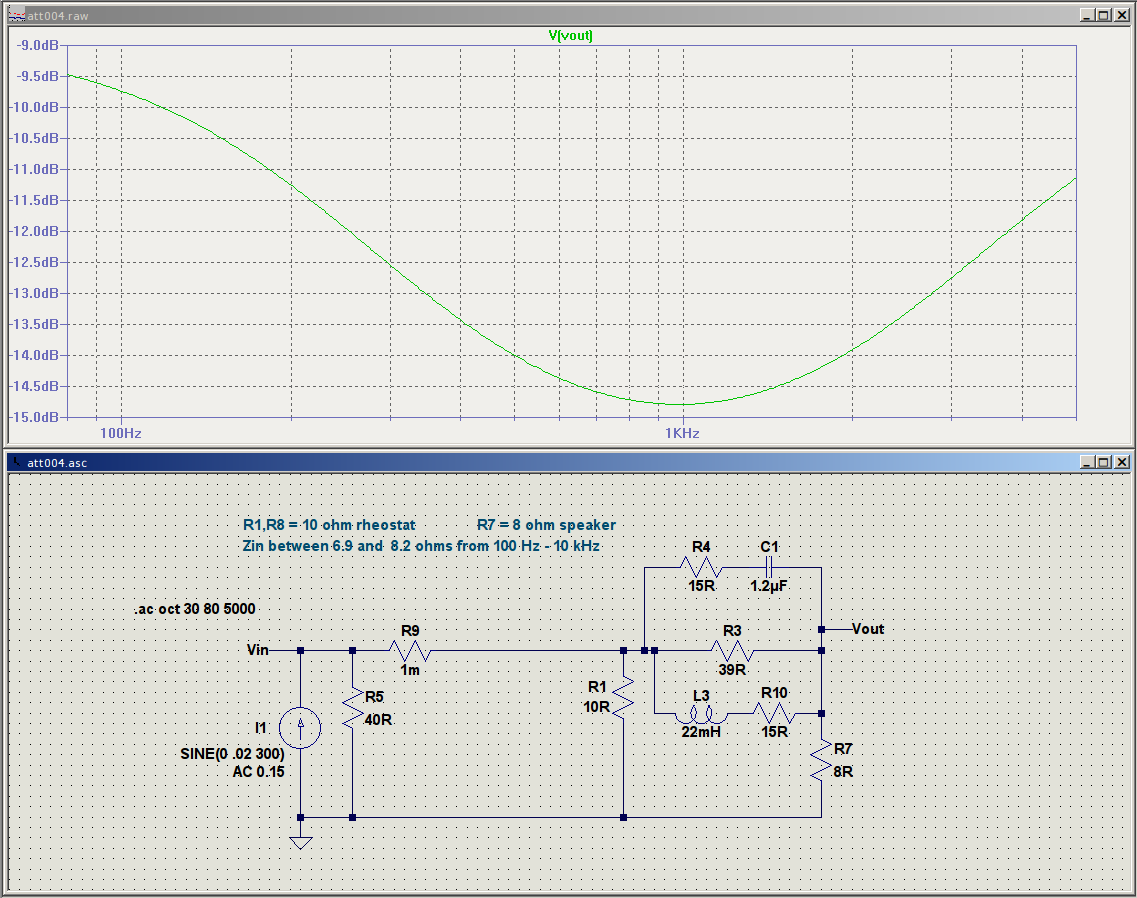

The attached image shows the circuit I plan to build.I look forward to seeing how you go about implementing the refinements quoted above!
L3/R10 produce the bass boost. C1/R4 produces the treble boost. LTSpice doesn't have a switch model (!), but you can imagine an SPST switch in series with C1, and one in series with L3, to allow switching out either part of the EQ.
Current source along with R5 simulate a guitar amp output with 40 ohm source resistance. The 1-milliohm resistor R9 is an LTSpice trick to allow measuring input current into the attenuator, which in turn was used to computer input resistance of the whole circuit (not shown in this screenshot.)

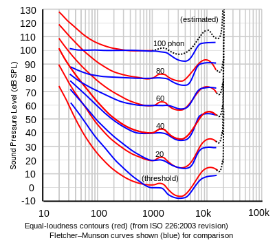

The target bass boost is the loudness compensation from ISO 226, revised 2003 (image from Wikipedia attached.) I'm estimating that usable guitar SPL levels in an apartment are probably between 40 dB ("babbling brook"), and 70 dB ("vacuum cleaner"). Keep in mind there are no guitar frequencies below 80 Hz.
Treble boost is trickier, particularly as guitar speakers peak at about 3 - 3.5 kHz, and then roll steeply off above that. So I'm just taking a wild guess at what might be an appropriate treble boost. Capacitors are cheap, so if it doesn't work, no big loss.
Input resistance is still very well-behaved, between roughly 7 and 8 ohms from 100 Hz - 10 kHz.
Output resistance is no longer as nearly constant as before - but the purpose of high output resistance is to create bass and treble boost, and in this circuit, even as the output resistance falls, additional bass and treble boost are being applied.
Will it sound good? I don't know until I try it. My guess is that the bass boost will be welcome, but I'm less sure about the treble boost.
-Gnobuddy
May be my failing eyesight, but I don't see R8 - where's the 'T' gone?
Or, are you modelling for the wiper at the top of its travel?
Sorry, yes, that particular screen-capture was done with the wiper at full-up.Or, are you modelling for the wiper at the top of its travel?
There are only very slight changes in frequency response with rheostat setting, because the source impedance from a 10 ohm rheostat (fed by a 40 ohm source) is quite low compared to the 39 ohm leg of the "Tee".
LTSpice doesn't seem to have a built-in potentiometer element. I've modelled them with two resistors for a while, but that doesn't look like a potentiometer on a schematic. I also tried to follow a Youtube video on making your own LTSpice potentiometer model, but I must have done something wrong, because one of my pot parameters disappeared along the way. I'll get it right one of these days.
Frequency response isn't by any means an exact match to the ISO loudness standard curves, but is in the general ballpark.
I found reasonably priced 22mH, ferrite-core inductors at one of the usual suppliers. Current and frequency ratings seem quite adequate for this particular application.
-Gnobuddy

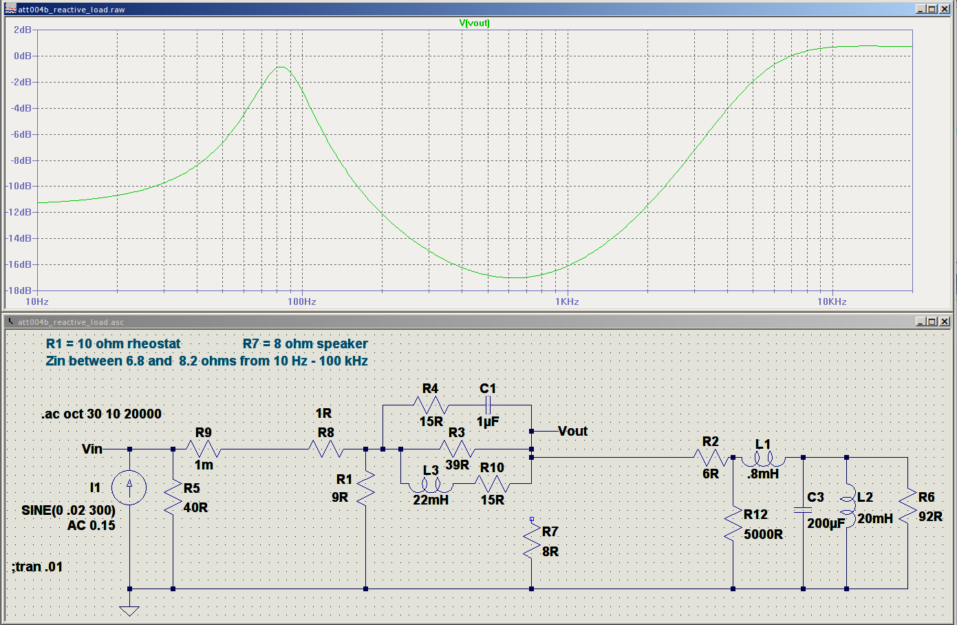

Nice project! A few observations come to mind:
The -15db max volume, with a 2W amp gives about 60mW. On my designs, my lowest setting is -27db, running with my 40W amps, which is 80mW. Very close. Im finding that's a good setting for quiet playing, though Im going into 12" greenbacks so speaker efficiency needs to be mixed into that comment. For very quiet use, Ive got another -7db stage available, but I find the MV on the amp is enough generally to tweak from there.
On the modelling, I note the issues with potentiometers in LTSpice. Ill put in a plug for the program I use, which is 5Spice, which is a free download. You can have pots and sweep them 0-100%. Its also a somewhat cleaner looking more modern drag/drop interface.
Ill be interested to see how your FM circuits turn out when you try them. I haven't gone there myself, I find that give Im using big-amp speakers, Im very happy with just a good linear tone response, with the high output Z to let the bass and treble develop.
I target 20ohm output Z from the attenuators, to match that measured from my Vintage Modern. My other amp has no NFB circuit, and has a higher output Z, maybe 50 ohm. Measured and calculated, using 12" speakers (8 ohm with L= 0.35mH), there's about a 1db difference in high treble and bass peak in speaker response changing from a 20 to a 50ohm output.
I've been modelling the speaker reactance too, usually using Aikens equivalent. If you added that to the Spice model, maybe it would show some additional interactions with the FM circuit?
Good luck!
ps - Im still messing around with a reactive front end on my designs, and Im still finding that provided the simple resistaive impedances are controled, as you and I are doing, the reactive parts make virtually no difference even though I can use them to let the amp 'see', very close to a real speaker impedance. If it makes any difference at all, its when the power stage is driving very hard, but its not really much different, or actually 'better'.

Thanks for your comments, John!

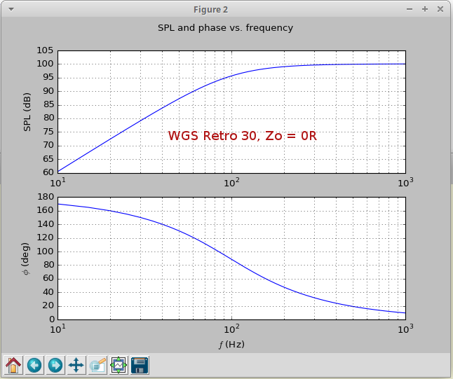

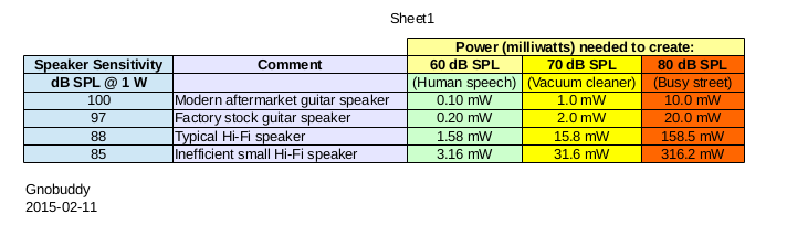

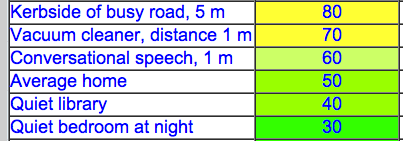

Unable to use either of my guitar amps, I was experimenting with an old Jensen speaker and a DIY audio function generator, when I made the shocking (to me) discovery that I could very clearly hear ten microwatts of sinewave power at 1 kHz. 😱
Convinced I'd made a mistake, I decided to do a little math, so I calculated the SPL that would be produced if you drove 10 microwatts into a 95 dB/W speaker. The answer turns out to be 45 dB SPL at 1 metre.
I looked up online loudness tables of everyday sounds, and 45 dB was compared to things like "babbling brook" and "moderate rainfall". Quiet, sure, but very definitely audible.
Okay, no mistake. We really can hear a guitar speaker driven with only a few microwatts of power. That was an eye-opener, so it got me thinking about low-power guitar amps.
Referring again to those loudness tables, I decided that apartment-friendly SPL levels would probably be between 40 dB and 80 dB, roughly corresponding to the SPL of light rainfall, and very loud traffic, respectively. 40 dB for midnight, 80 dB - maybe - if it's daytime on a holiday weekend, and your neighbours are very easy-going.
The next step was to convert some of those SPL levels into the corresponding amount of power you'd need to drive a speaker to get that SPL, assuming various efficiencies. The results shocked me, because they were orders of magnitude lower than any guitar amp you could buy. The two attached images show some of what I found.
-Gnobuddy

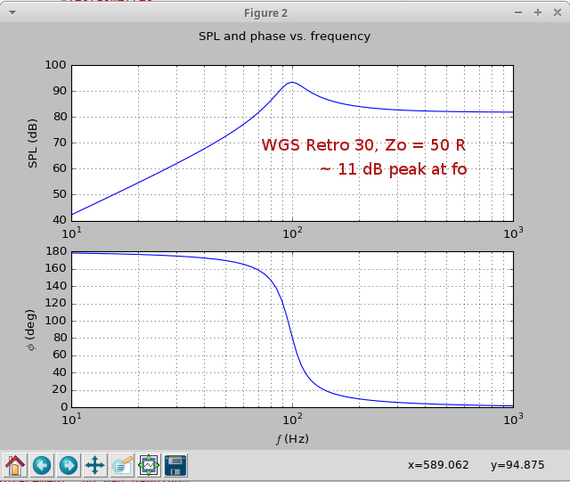

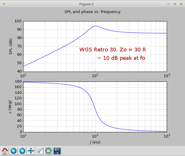

Very interesting! So we now have several measurements on several different kinds of valve guitar amps, with output stages varying from single-ended 6V6 to quad push-pull EL84, but all without global negative feedback.Solving the maths gave an output resistance of the amp of 50 to 60 ohms.
<snip>
The same tests again on the DSL401 (4x EL84 with no NFB), was 90 to 100 ohm.

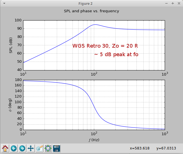

And so far, all output resistances have measured between 40 ohms and 100 ohms.

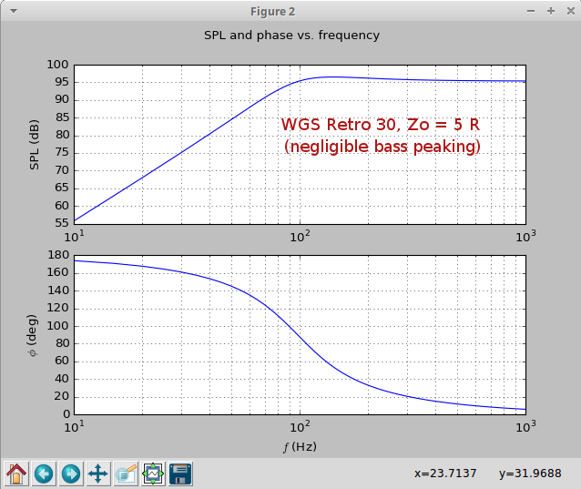

Even the lowest of those effectively raises the Q of a speaker's fundamental resonance up to nearly Qms. I've only seen Thiele-Small parameters for a handful of guitar speakers, but in all those cases, Qms was in the vicinity of 8 to 10. Meaning there will be a tall, narrow peak in the bass response, not a smooth bass-enhancing EQ bump.
Merlin Blencowe suggests that tube guitar amps that do include global NFB, may have as little as 6 dB of it. Randall Aiken suggests a 10 dB upper limit. Those figures would cut the output impedance of the corresponding guitar amp by roughly a factor of two or three respectively.
So we can estimate that many valve guitar amps that do have global NFB may have output resistances in the range of 12 - 50 ohms. Even the lowest of those numbers is about twice the DC resistance of an 8-ohm speaker, which means most of the electromagnetic damping is lost, and the speaker Q will approach Qms. Qms is the (much higher) Q that's set by the mechanical damping in the speaker (rubbery surround, lossy spider, "goop" that might be applied to cone and surround edges, etc.)
The exceptions would be those few valve guitar amps that had ultra-linear output stages. Those probably had much lower output resistances, since the anode resistance of a pentode often drops an order of magnitude when triode-connected or wired for UL operation (which is heavy local negative feedback.)
I've never seen one one of those UL-ouput guitar amps, and it seems they are a fading footnote in music history. There seem to be a number of contemporary amps that can be switched to triode-mode to lower output power, but I can't get my hands on any of them to measure output resistance. It may not be very relevant anyway, because few guitarists seem to like the sound of triode output guitar amps.
Incidentally, today is Thanksgiving in Canada. So Happy Thanksgiving, everyone!

All signals were recording nice smooth sine waves coming back out of the amp.
One can also surmise that the extra treble from increasing a presence control is not just from the reduction of NFB, but also the resulting higher output Z allowing the speaker impedance to boost treble more.
This VM amp has a PPIMV, which is right in the middle of the feedback loop. all frequencies get feedback but the presence control adjusts it for the high frequencies. So at low MV settings, NFB is cut right back, and, we measure higher output Z (30Ohms), not dependent on frequency or presence settings.
All of this gives me some confidence, because I had arrived after much fiddling and testing, and with growing understanding of what was happening, at around 20 Ohms as the best target output Z for my attenuators. It turns out this is a good value to match my target MV setting of about 6 for this amp.
But it may mean that the best attenuator component values to use depend somewhat on the amp type and favoured settings. But at 20 Ohms, it is most of the way there, within a db or so, even if a more perfect value for a given amp is say 50Ohms.
I was curious how much change there is in speaker bass response as the amplifiers output impedance (Zo) continues to rise.But it may mean that the best attenuator component values to use depend somewhat on the amp type and favoured settings. But at 20 Ohms, it is most of the way there, within a db or so, even if a more perfect value for a given amp is say 50Ohms.
We can guess that there will be very little change over a range of rather low Zo values (when Zo << DCR of the speaker), and also very little change over a range of rather large Zo values (when Zo >> DCR of the speaker). But I wasn't sure how big Zo had to be before it stopped having any more influence.
So I ran the series of simulations in the attached images, all using the Thiele-Small parameters that Printer2 posted for the Warehouse Guitar Speakers Retro 30:
Code:
#3----Thiele-Small params for a WGS Retro 30----
v0 = 2.83 #volts, drive voltage, 1 W into 8 ohms
f0 = 98.0 #Resonance freq, Hz
w0 = 2 * math.pi * f0 #rad/sec
BL = 13.88 #Tesla-metres
m = 0.02769 #kilos; mms, cone + air
Rs = 6.9 #ohms
Rs = Rs + 40 #Add 40 ohms amp output impedance (valve guitar amp)
rspkr = 5.5 * 2.54 / 100.0 #12 inch dia speaker, 11 in piston dia, converted to metres
sd = math.pi*rspkr*rspkr #piston area, square metres
Qms = 15.53 #open-circuit mechanical Q at resonance
k = m*w0*w0 #k is m w0^2, since k/m = w0^2
gamma = m*w0/Qms #in a mechanical damped osc, gamma = [sqrt(m k)/Q] = m*w0/Q
#--------End Thiele-Small params----------------------------
-Gnobuddy
