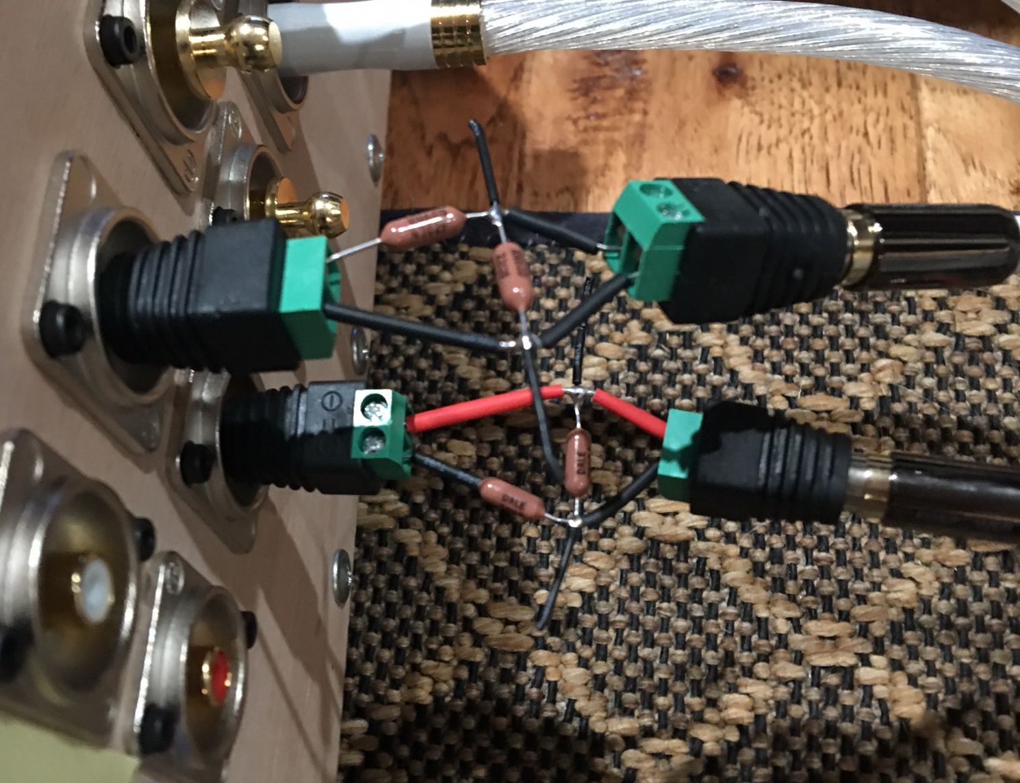

I took Rayma's suggestion in Post #2 and added an L-Pad to the output of the preamp. Series Resistor was 47K and Parallel Resistor was 22.1K. Those were the closest values I had on hand that matched the resistors the L-Pad calculator suggested for an impedance of roughly 65,000 ohms and a 12 dB drop. Adding those L-Pads pushes the noise below the audible level even fairly close to the amplifier. I am still evaluating the sound quality but my first impression is it sounds fine. However, I think 12 dB is a bit too much attenuation since I think the gain of the preamp is only 10 dB. It isn't actually a problem but I thought I would try listening with less attenuation from the L-Pad. But I can't seem to find an L-Pad Calculator that lets me put in resistor values to calculate attenuation. They all seem to only take impedance and attenuation and output resistor values. Does any one have a calculator that lets you put in resistors and impedance and get back attenuation?
Also, I'm really in the dark about what impedance I should be using for the calculator. The preamp wants to see >50K ohms from the amplifier and the amplifier says it has an input impedance of 100K ohms and I found one post that suggested the preamp has an output impedance of 600 ohms. I used 65K ohms in the calculator because that gave me resistor values I have on hand but the truth is I have no real understanding of impedance in amplifier design.

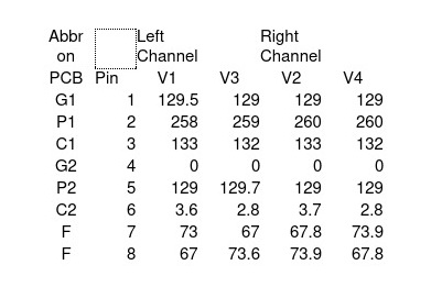

Per your request here and by PM I measured all the pins referenced to ground for all 4 6SN7 tubes. I think the PCB has flipped the pin assignments for G1, P1, and C1 with G2, P2, and C2 from what is shown in the schematic or the board is mislabeled. Since I though they were symmetrical in the tube I doubt that matters.
Volts DC Measured Against Ground
Abbr on Left Channel Right Channel
PCB Pin V1 V3 V2 V4
G1 1 129.5 129 129 129
P1 2 258 259 260 260
C1 3 133 132 133 132
G2 4 0 0 0 0
P2 5 129 129.7 129 129
C2 6 3.6 2.8 3.7 2.8
F 7 73 67 67.8 73.9
F 8 67 73.6 73.9 67.8
I can't figure out how to make that table format correctly so I am also attaching a JPEG of that table.

BTW I was cringing looking at the way the RCA jacks were wired up and that u-shaped common ground for both the input and outputs. That's what I would be looking at. Here is a good video explaining tube amp grounding. Mark's channel is full of great info.
