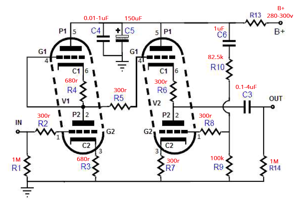

Since B+/4 where you would get 70-80v on pin 7 and 8. Measure the voltage the same way as other pins. It's cathode

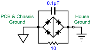

The IEC/mains filter inlet is connected directly to Audio GND. This is causing a ground loop. The metal chassis should be connected directly to PE but the Audio GND should be connected to PE via a 10 Ohm 2W resistor/diode bridge/CL60 thermistor as done in many popular devices. If you want 100% safety and you want 100% hum free, then this is the method.

PE is Protective Earth.......If you ask why elevating Audio GND from PE makes stuff different you have to look up "ground loop". PE is for safety (mandatory, not "nice to have") and it is nice for mains filters and shielding. Audio GND has no business with PE but a connection of sorts is needed when things don't go as planned.

The Aikido does have house-ground circuit. However, I tried IEC ground to either one didn't make any different.

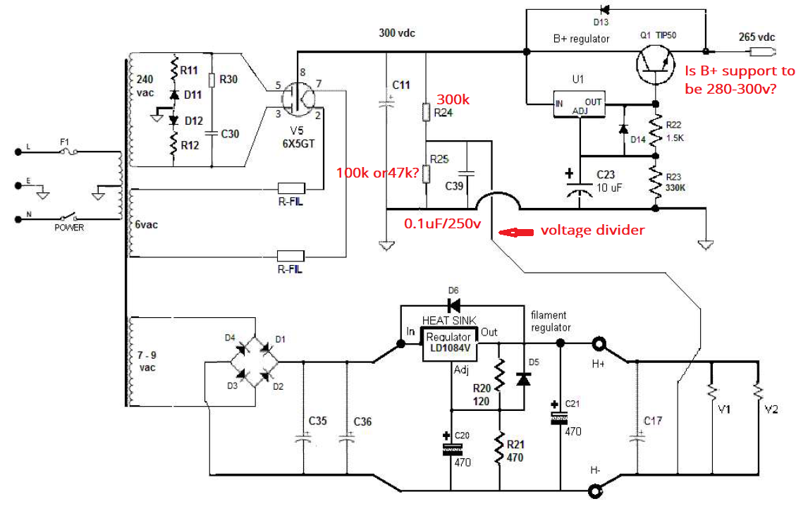

The Aikido uses 1 heater for all tubes at 12-12.6v while your pcb may have 2 filaments, 1 for each side.

By looking at your pcb, I am not sure if it has voltage divider or not.

Please use correct terms so PE (for safety, primary side of the PSU) and Audio GND (or GND/ground) for the secondary side of PSU. "IEC Ground" and "house ground" don't make matters more clear in an area where grounding and PE already are rarely understood.

Adding an 8 ohm 100 watt resistor (thats what I had on hand) between audio ground and power earth ground had no impact.

I did check all caps and resistors value before solder too, the caps don't have to be exactly the same but the resistors MUST. It's true that if one of the resistor is bad or lower value, you will get a completely different voltage on both sides. When I replaced the bad resistor on left channel, not even the voltage change in left but also change on the right as well when all resistors have same value.

I don't know if all the values are identical but you are correct, the 6SN7 part of the designs is identical. The power supply schematic does appear somewhat different.

Yours is Aikido Rev D i think. The schematic and values are for 280-300v
Do not remove R10, however; change C6 to 10uF. According to John from Aikido, he said "The higher the capacitance, the lower the noise null goes in frequency" so he told me to buy this and no problem at all.

The PS does have voltage divider but I am not sure the value of R25. Mine is 47k. So when it connects at 300v, the pin 7 and 8 would be around 75-81v. At 100k, it probably shows 140-160v which it's too high. So 47k would be correct. Sorry, mine is 1 filament for 4 tubes while yours is 2 filament, 1 for each side so it may be different.
