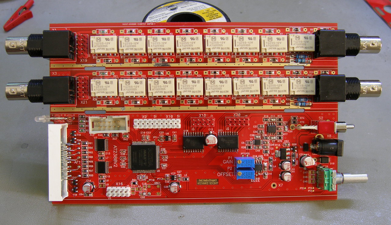

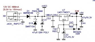

Just, I completed the board and test as pdf described.
PT13 & PT14 is OK
PT15 is not, it reaches until 3.3V not 5V.
I am looking the area of LT317, resistor values are OK.
D19, D20 are OK
The only part that I don't use the BOM List was the D1 MBR0540, I use a LT8716 B140 that I had.
From what I looked the difference is to the IF 0.5 vs 1A.
Hello,
It is curious to measure 3.3V on P13 if there is no higher voltage on PT15.
Can you measure voltage on X6, and across R64 (you must have 1.25V) ?
What did you use as voltage source ?
About the diode, i don't know LT8716 and i don't find datasheet.
Can you give a link to look this ?
Frex
Frex, thanks for help.
In a couple of hours I will check again all the points and everything that to suggest me.
It was a used diode, with LT8716 there is no any info but with the B140 it seems to be like this: https://www.diodes.com/assets/Datasheets/ds13002.pdf
As a voltage source, I used a Rigol DP832 lab psu with 50mA current limit. At 5V of input, the current was 50mA about.
After 3 hours from last soldering, the voltage was OK!

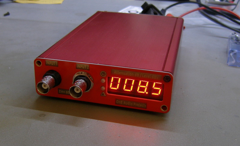

I upload the fw of CPLD and I done and the last work, shield and display fiberglass.
It seems OK.
The leds aren't light on, probably I used wrong type of led or I have a different legs series (- + - or Cathode-Anode-Cathode). I checked them with the multi-meter diode test and lights on normally.

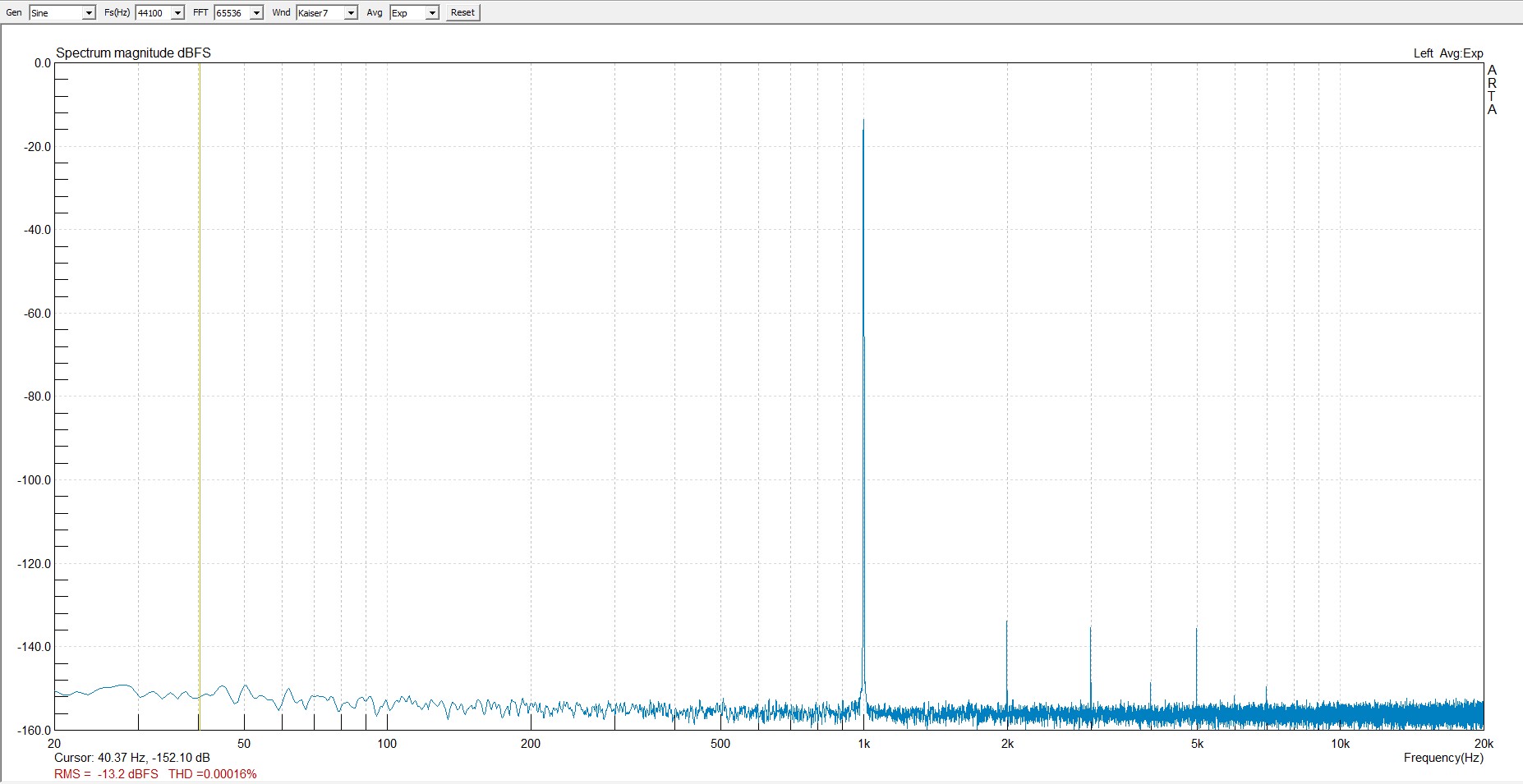

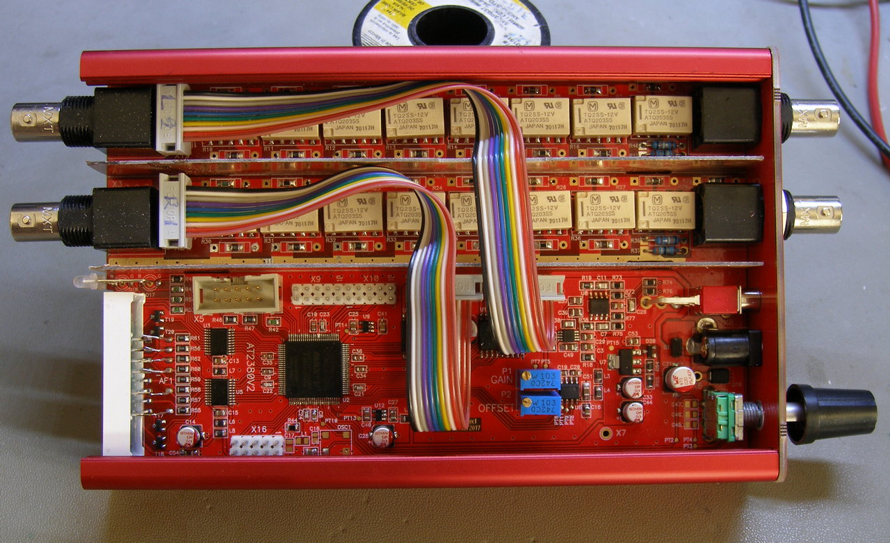

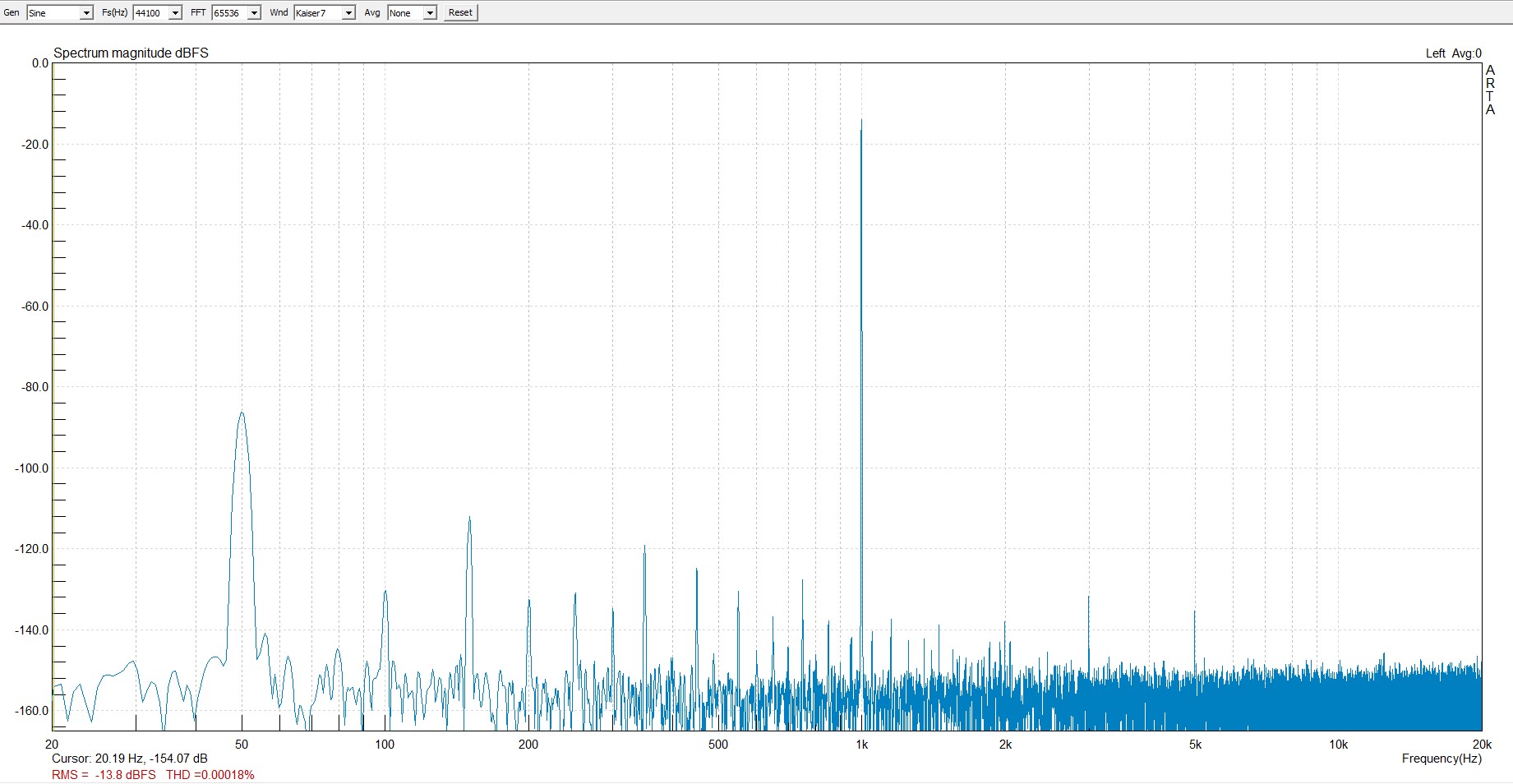

Today, I make a real test with RTX6001
*) The generator produce each time a sine of -3dB (bnc), to Channel-1 and Channel-2.
*) The AT2380 attenuates by -3.5dB the signal and the output goes to RTX6001 input (xlr).
The cables are,
Generator -> AT2380 = bnc to bnc
AT2380 -> RTX6001 = adaptor bnc to rca and rca to xlr (mode6 on RaneNote Guide, with the shield to the air on RCA)
I see that the Channel-2, this is not tracking (it had a very good result at the Attenuator Level Test(ALT)), goes awesome.
I see that the Channel-1, this with tracking (it had moderate result on ALT) have a ground loop issues.
I have enclosed the bottom of my AT2380 for this reason.
Frex, what you suggest about this?

Hello,
First yes, the tracking channel is loaded with the differential amplifier impedance.
So because output impedance of attenuator move from 0 to 300 Ohms, there is little
contribution on the overall attenuation.
If greater gain accuracy is required, it is possible to choose higher resistors value
for the differential amplifier (U8).
So about the ground noise you measure on CH1 ;
What is the power source used ? (Always DP832 lab PSU ?)
Does the enclosure is closed ?
Is there only one channel connected to RTX6001 at same time ?
What is the signal source ? The RTX generator ?
Regards.
Frex
Hello,
So because output impedance of attenuator move from 0 to 300 Ohms, there is little contribution on the overall attenuation.
If greater gain accuracy is required, it is possible to choose higher resistors value for the differential amplifier (U8).
Then, the small deviation that observed on Channel 1, is normal under these circumstances. I see now.
Are you talking for R73,75 about?
- Yes, always with the DP832
- The rear with the main case, not the upper and front
- Yes, each time one channel connected
- RTX was the signal generator

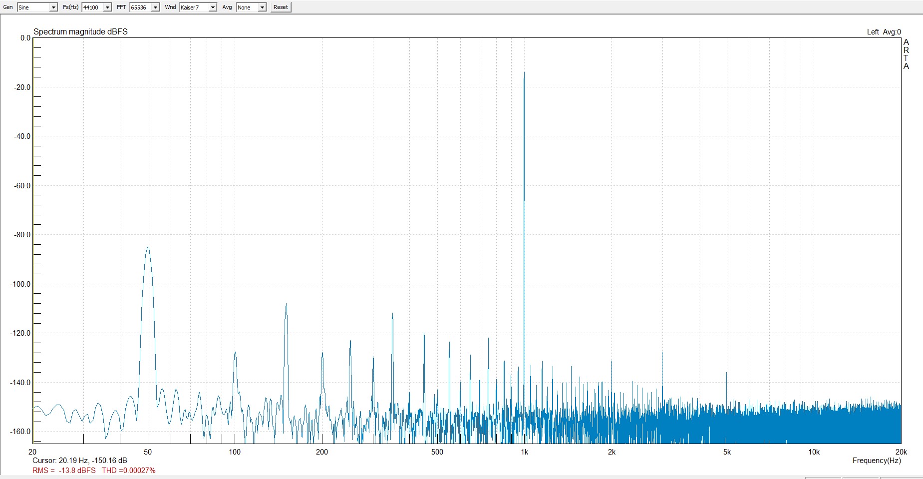

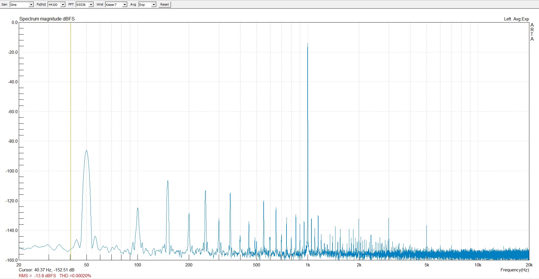

It sure that there is gnd issue noise on Channel-1.
Just I done the following.
With the pcb out of case, return it up_side_down and take a measurement on Channel-1 with the same parameters as before.
Of course the noise now is a little bigger and the THD jumps from 0.00020 to 0.00027%, but just I bridged the gnd of channel-1 with the gnd of face with a screwdriver, there was a little improvement to 0.00018%
