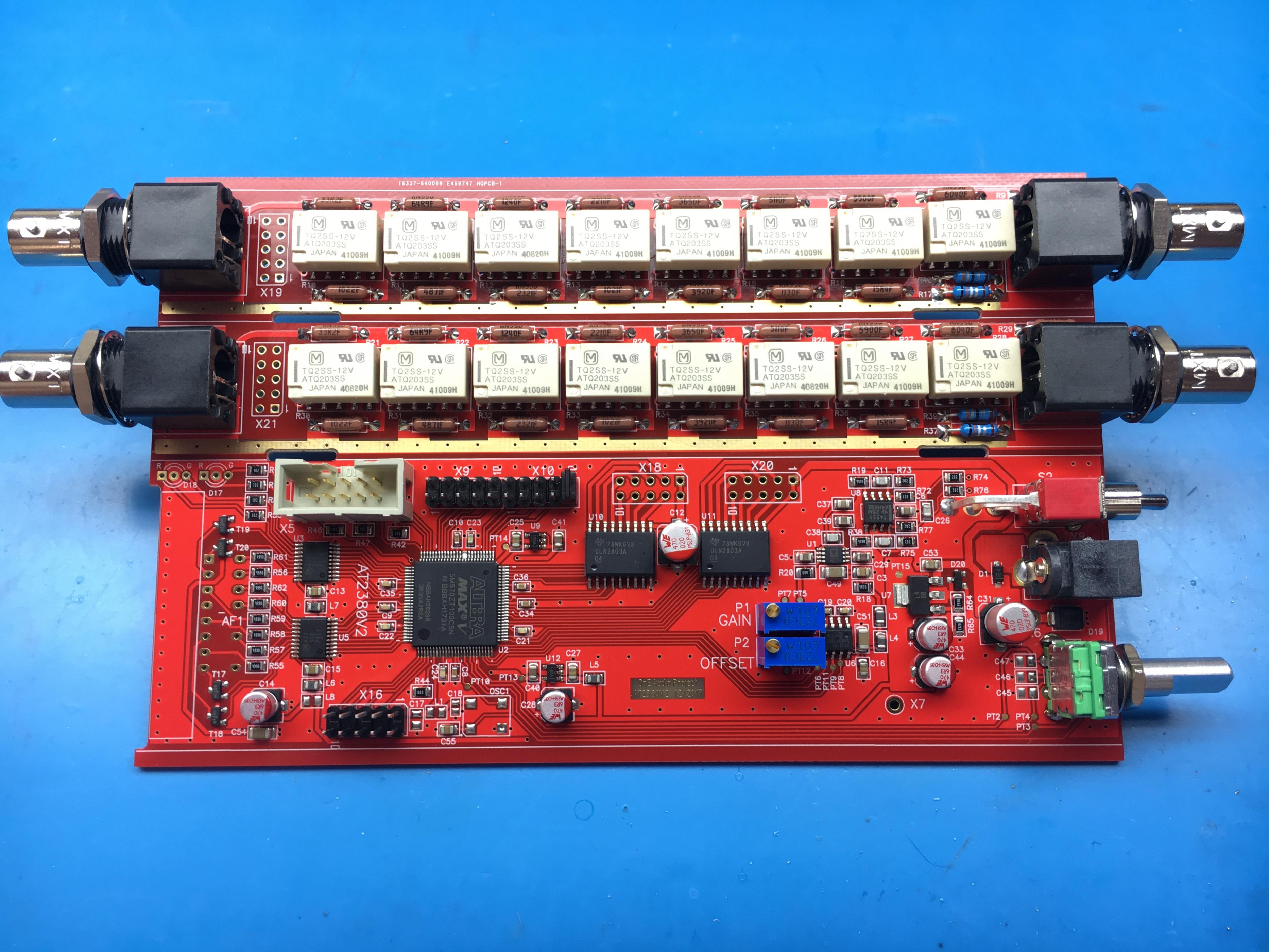

I have mine up, but not running.....
Voltages and current draw check OK as per the build instructions, I can program the MAX V without error, and the first power-on went OK (display of version, then attenuation), but after say 10 seconds the lights went out, and that is it... ?!?!
On power-on, I can hear the relays clicking, but no display, and no LEDs. No reaction to the rotary encoder, nor the disable clock switch.
In my desperation, I tried frequent power-cycling, and for one time the attenuator started as expected, but after a couple of seconds - lights out again.
Any suggestion would be greatly appreciated, since this whole MAX V thing is way over my head, I am a kit builder ;-)

Hello hallodeletue ,
No worry, we will try to figure out your issue.
If the board don't power on each time, maybe the first think to do is to check very carefully all soldering joints, in particular the CPLD.You must of course use a magnifying lens !
For any doubt during this check, use a multimeter in Ohms range to verify if it's shorted or not.
Then, i think you can check all voltages at test points during power-on and until you see the display and leds lights out. There is maybe a voltage that become wrong after some time after startup (short circuit).
Note that the Quiet mode switch can switch off all lights (7seg display and 2 leds) so if this pin is not properly connected you can have bad behavior.
To test this, you can try to put your finger on the CPLD pin. If a pin is floating, you may see display blinking.
I hope that will help, i let you to try this and post your results.
Regards
Frex
(What do you use as power supply ? can you post an high res pict of the board ? )

I have built up two units and see a very similar problem. They behave as if the Quiet mode is always on (btw, it would have been very useful to label the off position of that switch). One PCB did not get recognized by Quartus, needs to power on/off several times until the Altera is found.
Main symptom is that the 7-segment and dual color LEDs are always off, the encoder does not trigger anything. As if the internal clock of the Altera is dead - or the Altera did not boot at all.
Voltages are present, flashing v0.23 did work. I tried to reflash, this time did not remove L8, and voilà, all LEDs are fully lit during the flash process. So basically a proof that power is there and something could be shown on the display.
I have the parts for Tracking mode on the PCB, but did not enable it (no audio connection and no R44). That shouldn't cause all this, right?
I will do some more checks today trying to find out more.
