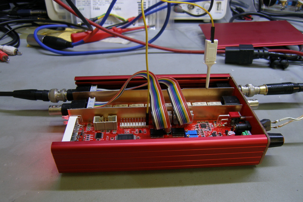

I tried a 12V battery to feed the AT2380.
I remember to you, that the tracking is to the Channel-1

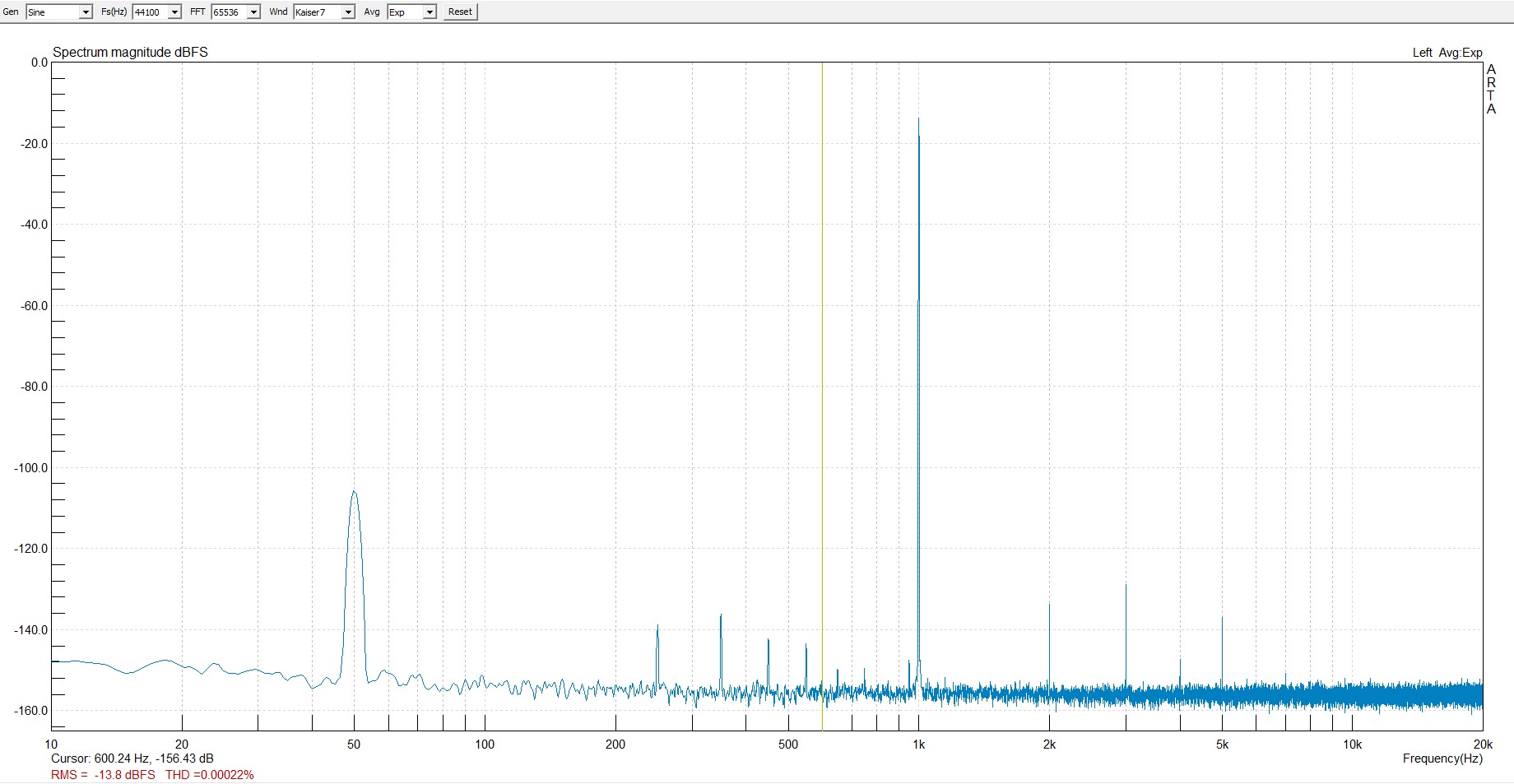

The most noise has gone, remains only the hum of 50Hz and some spikes but in lower levels.
At the next, I joined the gnd of enclosure and the rear panel on channel 1, now the spikes has gone almost, but not the 50Hz of hum (decreased a little).
I don't know if it is my fault, but at the Build Instructions Manual at the page 4 says "For proper shielding, the enclosure and the panels must be connected to a signal ground. To avoid ground loop, each attenuator channel have it’s own ground, but only one of them must be connected to the enclosure.
If you want to tracking the Channel-1, according to this instructions (see the Shield Table at the page4) you must join only the Channel-2 as shield and not this of Channel-1
But, I see if you joined and the Channel-1 the spikes eliminated!
Frex, I think to investigate what is happening with 50Hz hum. This appears either battery or external PSU and at the tracking channel not to the other.
I think to remove the D1 diode at the input and jumper this.

Hello Lemon,
I'm very busy until next week-end, so then I will look also on my side.
I don't remember all i do in my measurement setup.
Did you have tried to put the AT2380 enclosure far from the top you desk ?
(By putting an isolated box between, for example).
Do you have a source near the setup that radiated 50Hz field ?
(Like a main transformer).

Hi Frex,
Take your time, we have a lot time for our love (diy).
For your questions, yes I have tried many things but they didn't work. No, there is no any strong source of 50Hz that radiates the equipment.
All my others equipment that it is close to AT....no problem with 50Hz.
Don't forget that the other channel, the Channel-2 that isn't tracking hasn't any 50Hz, it is very clean (post 97).
In the meanwhile, I am going to done some other mods (like D1) and update here with my results

I searched a lot the 50Hz hum.
There is no any cause from on board reg or other equipment of supply. I bypassed the LT317 and feed outside the 5V and there is no any improvement.

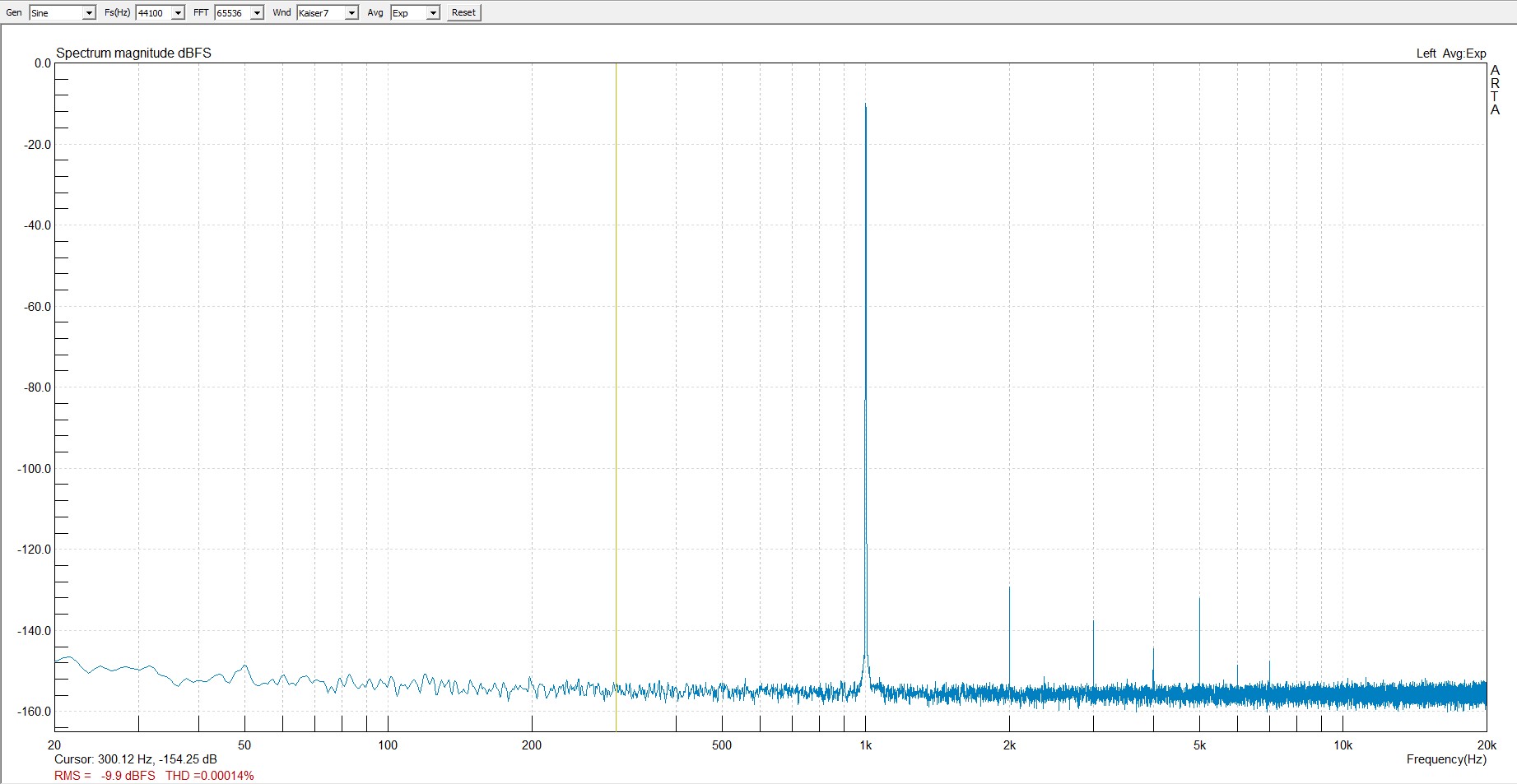

Finally, in my situation the solution was done with a connection of gnd of digital pcb with the Channel-1 shield (see the follow picture the yellow cable).
With this solution, the tracking channel-1 works fine without hum or spikes, like the Channel-2 with no tracking. This capture was done with Rigol PSU.
Now, it's time to concentrate with the calibration and how the auto tracking works because is somewhat difficult but I will wait and other members like hallodeletue and bk856er.

I did a precisely calibration and I make the target 0.00/-80.dBV with the two P1/P2 trimmers.
You must not turn a lot of one trimmer, but a little each trimmer at interval time of two leds.
Now, auto-tracking works fine and the dBV level also.
I must to say, that I followed the opposite series at interval time of two leds. Otherwise, I had an opposite result!
