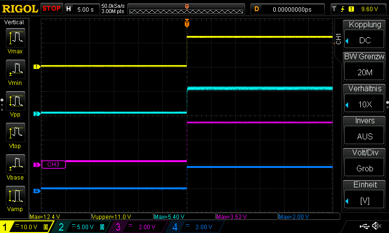

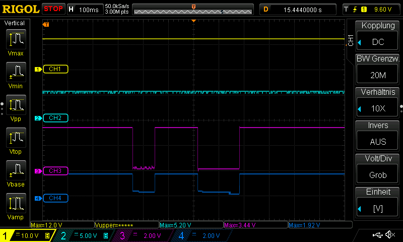

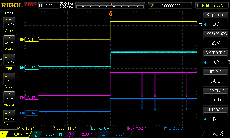

I tried to troubleshoot according to Frex' guidance:
I desoldered the wire bridges to the relay/attenuator section, to isolate the problem, but obviously to no avail.
I then learned how to do a coordinated 4 channel long term measurement on the oscilloscope, but the voltages showed nothing of interest (see 1st attachment).
Interestingly enough, accidentially shorting 3.3V to ground while probing supply lines on the oh sooo tiny leads of the MAX V restarted the FPGA in normal mode, but only for a couple of seconds, then lights out again (attachment 2 and 3).
But, as I said, the thingy starts up ok now, I have to resolder the wire connectors to the relay section, and then I can calibrate it.
Thanks again, and best regards,
hallodeletue

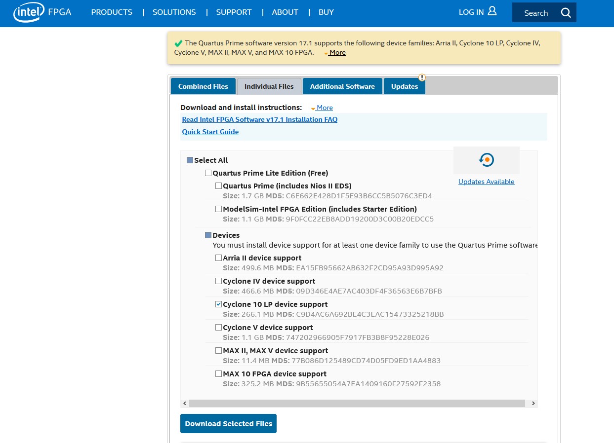

You do NOT need to download the whole Altera Gigabyte crap! On one of the Download tabs you find a stand-alone programmer, only 280 MB. This one includes the driver for the USB Blaster which has to be installed manually. Then everything works.
Usb Blaster has received and the package from mouser.
Is that choice, that are you propose to me?
I see that needs an myAltera account email address to login for the download.

Hello Lemon,
It seem to be possible to download only the programming software for any Quartus version.
For the 16.1, you can look here :
Download Center
Go down the page and search stand alone software "Quartus Prime Programmer and Tools ".
Yes, you need to create an account.
Regards.
Frex
That's a nice trick to install just the programmer tool. Is there any advantage to versions >12 SP2? The full package was a surprisingly lengthy process to download and install on my Win10 machine. However USB Blaster was recognized without installing any driver. Seems ready to go.

Just, I download and install the QuartusProgrammerSetup-16.1.0.196-windows, follow the Frex's directions.
What silly idea from Intel, to must install the Akamai down-loader software for downloading!
