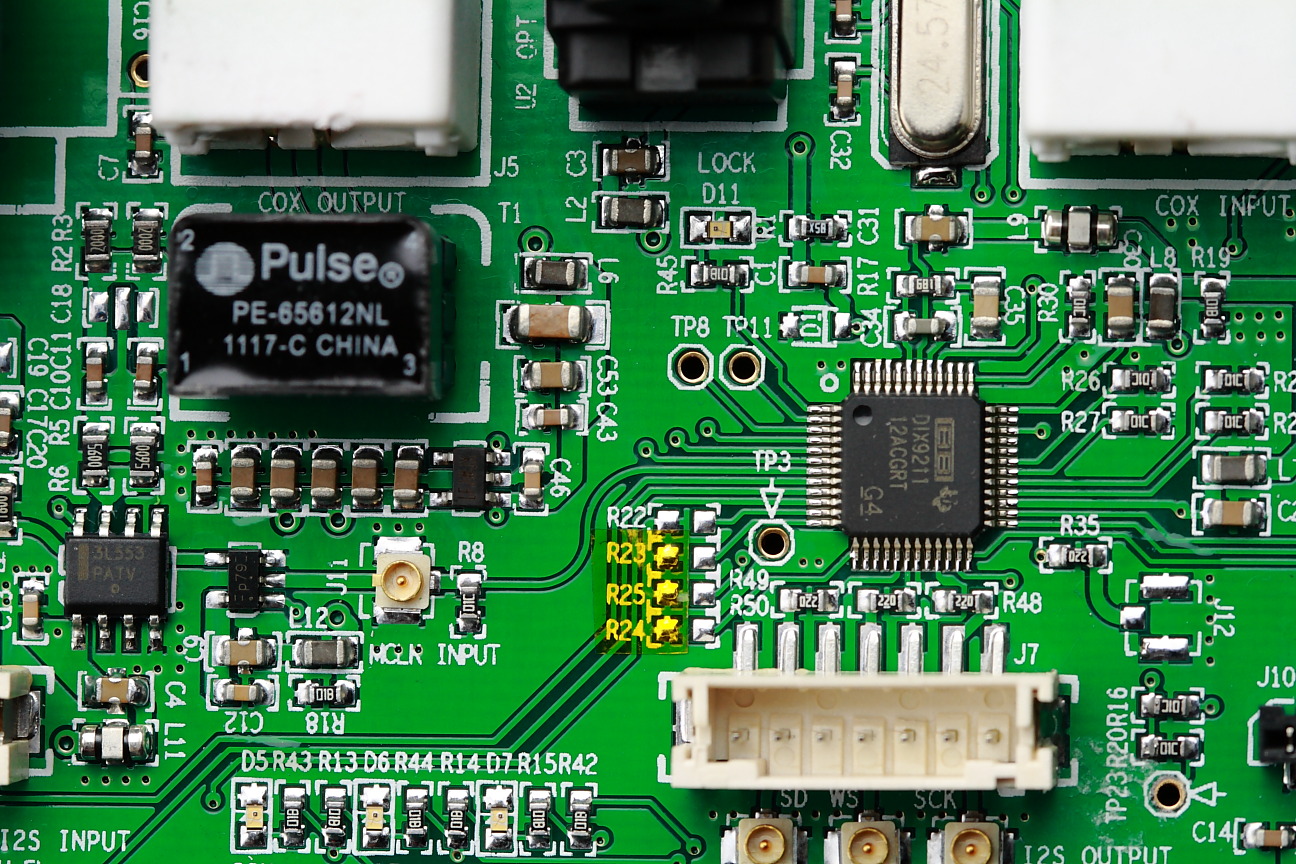

backdoor
Step1: Remove R22, R23, R24, R25 from PCB. SMT soldering station is recommended tool, but normal solder iron is still OK.
Setp2: Cover the GND pads of R23, R24 and R25 with fine cut high temperature tape to avoid signals short to GND.
Setp3: Solder the 4P SMT PH2.0 header, Pin1 (WS) to R24 signal pad, Pin2 (SD) to R25 signal pad, Pin3 (SCK) to R23 signal pad and Pin4 to both R22 signal pad and GND pad,
Step4: Cut the solder mask paint beside the both GND pads of the header appearing small area of GND copper plate, please be careful no touching any other circuit route.
Step5: Solder the support pads of the header to the appeared GND copper plate. Solder iron with higher power may require. For enough support force, applying compound of strong glue (such as epoxy) is highly suggested for double support.
Step6: Make an I2S cable to introduce an additional I2S input source.

Hi Ian,
Do I read allright that I have to ground (short) the signal- and the grnd pad of former resistor 22 ? I found out after I placed the connector. But if I shoud short the two, I can make just a grnd connection with pin 4.
Please could you confirm?
Thanks!
Ed

Yes, R22 short to ground by pin4 of the connector.
Ian

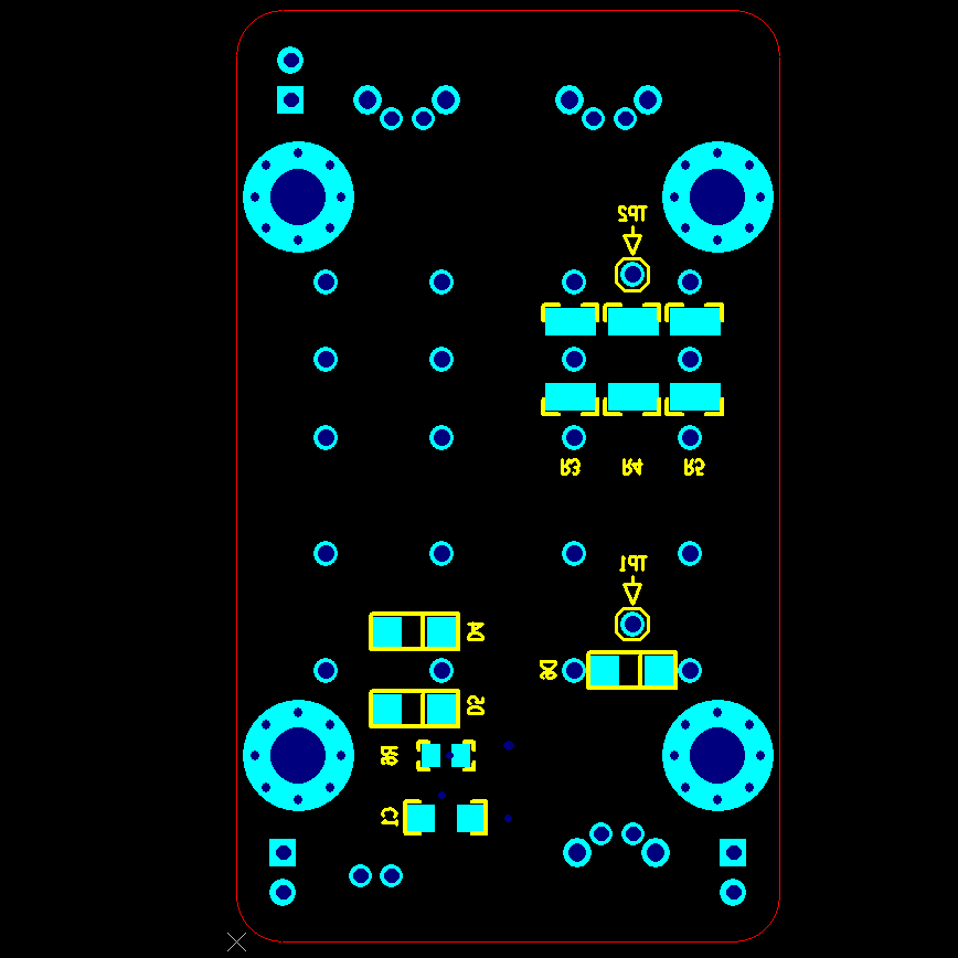

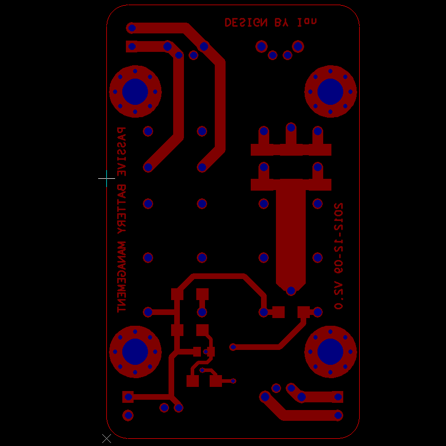

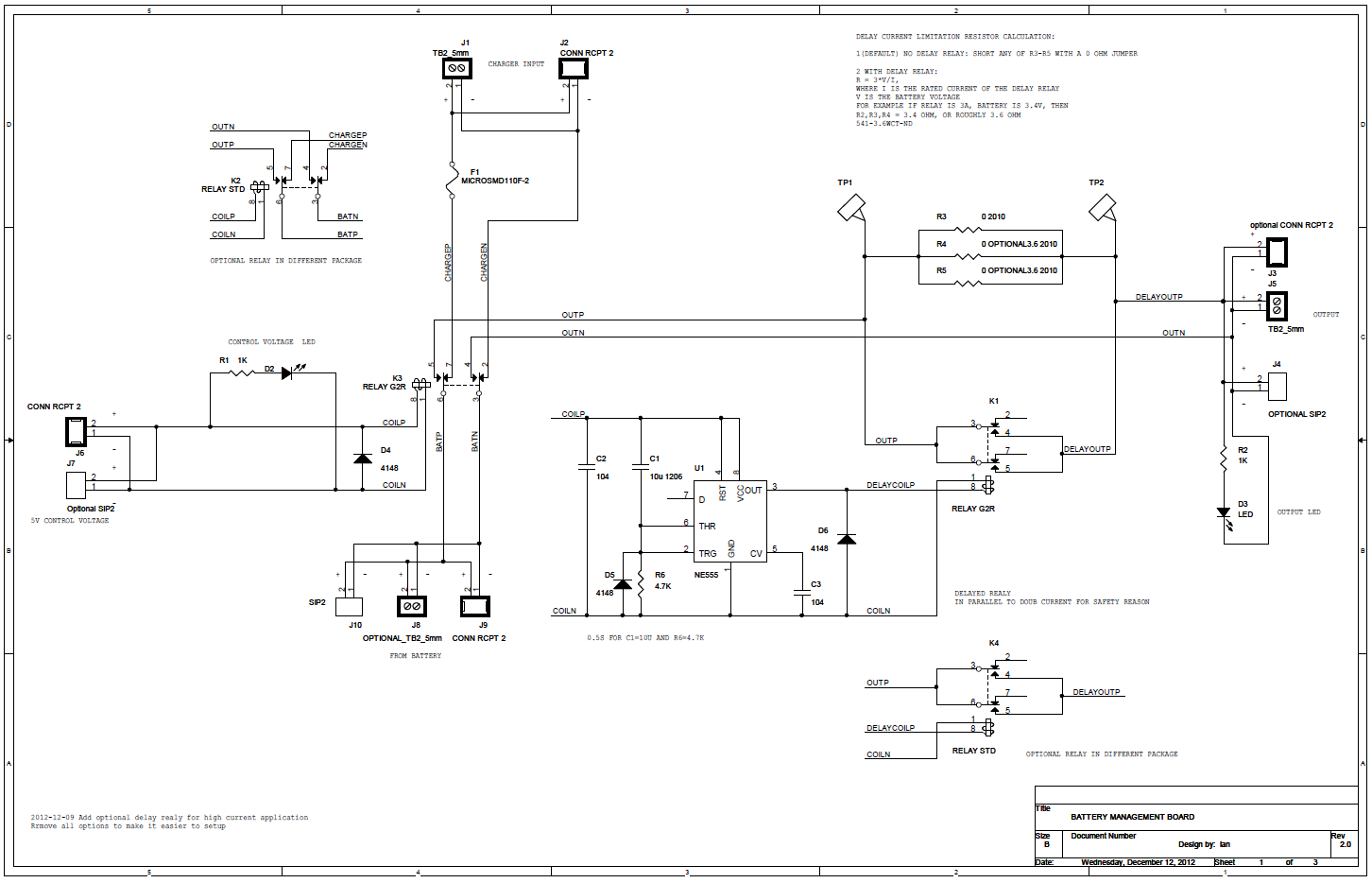

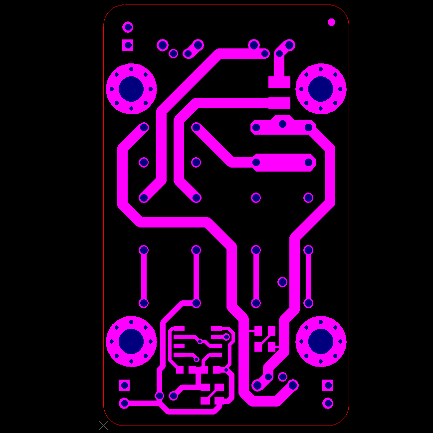

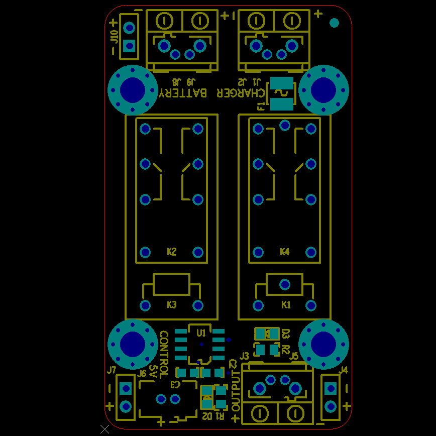

Battery management board PCB V2.0 with an optional dealyed realy
1. I understand the application of the passive battery manage board may not be limited to powering the clock board. To avoid any damage by the power on surge current of charging big capacitors, I include an optional delayed relay to limit the possible high surge current. Even for a clock board, the surge current may still go high if there are some low ESR capacitors on board. The delay time now is 0.5s, but it’s adjustable.
2. Remove some options on V1.0 which may not be used for normal configuration. That makes it easier to setup, clean and less confusion.
3. To make it easier setting up battery arrays, I placed the battery and charger connectors on one side and the output and control voltage connectors on the other side. Stack on top of each other is also available.
All physical dimensions keep same no change.
Hopefully this passive battery management board V2.0 will be available together with the Si570 clock board.
Please let me know for any suggestion and comment.
Ian

Ian,
If only clock board is powered by batteries and delayed, is it possible for that to be the problem? Usually clock is the one that has to be powered up first before any other digital circuits? I think I recall info that DAC could have a problem if it powers up before the master clock?
Ian,
Hi AR2,
You are right, the clock should be running priori to all other section of the system before the gone of the reset signal. However, the delayed realy will not delay the power up, it just limits the high surge current for a very short of time (the main realy already switched on). So, I don't think it will cause problem on the start up time of clock board. But I'll double check and make some real measurements on the power on time of the clock board after I get the PCB prototype.
The delayed realy is just an option, if the main relay can handle the surge current, then you may not need the delayed one. But for high current application such as powering a DAC analog power, the dealyed relay will help.
Ian
