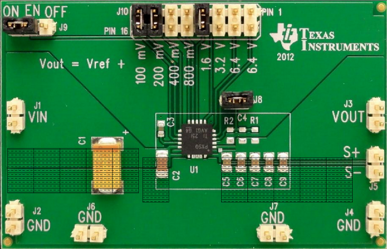

I'm aiming to use the tps7a4700 evalboard in a project and is looking to replace the X5R caps with Panasonic SP's.
After some handywork this is what should be the available space if mounted next to each other but most likely there will be some spacing.
Not shure that this is the right thread for this but since there is disscusion about both the caps and the reulator so........
For C1 and C5-9 there will be panasonic sp caps. I'm not shure about C2, suggestions anyone ? Probably another sp I think.
This comes from the user guide:
Nothing said about input capasitance values, there is 47+10uf mounted now.
Is there any reason to increase on that ?
no its not the correct thread for discussion of the regulator on the demo board to power a completely different DSP/DAC to what is under discussion here.... which is not even a dac, nor is the board under discussion the regulator demo board
I must admit to being confused with your use of this regulator after a raw supply and before placid shunt regs, did you not buy the correct voltage power transformer? adding all this extra caps for low impedance storage when you are following with a shunt reg makes no sense to me; it seems like you are replacing proper measurement and design with overkill
It's in the pdf documentation for the eval board on page 2😉
NOTE: The positive input lead and ground return lead from the input power supply should be twisted
and kept as short as possible to minimize EMI and source inductance. Additional bulk
capacitance in the form of a Tantalum cap (47 µF; 35 V) has been added to the EVM at C1
to counter source inductances that may cause ringing on the load transient waveform during
higher current transients. This bulk capacitance should not be necessary in a typical
application circuit.
