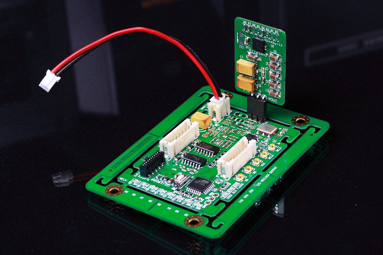

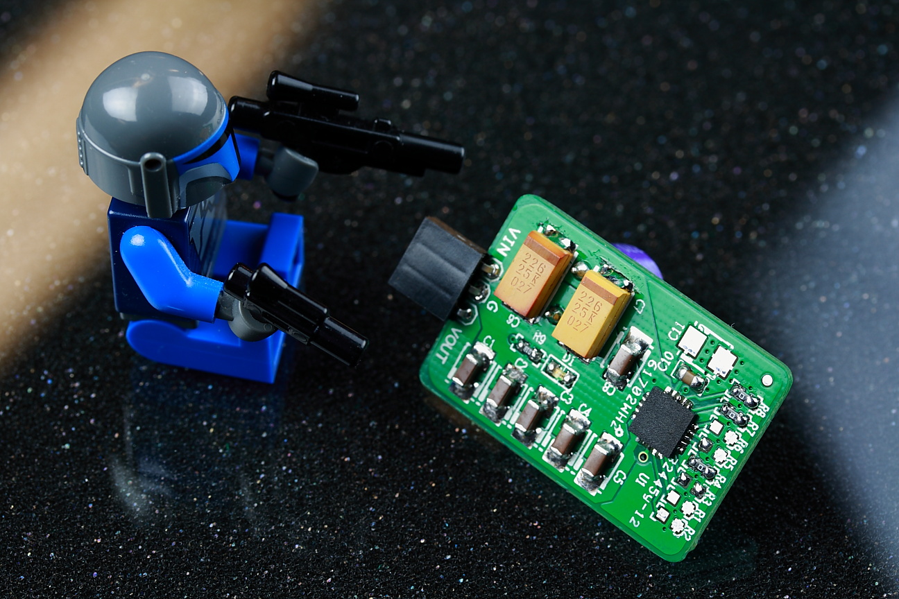

Thank TheShaman for you reminding. TPS7A4700 reg confirmed very good. Beat all LDOs I tested previously 🙂. I have quite a few of PCB may try to supply some to those who need them.
Since people expressed they want to do something rather than just receiving free samples, so I need figure out how.
Regards
Ian

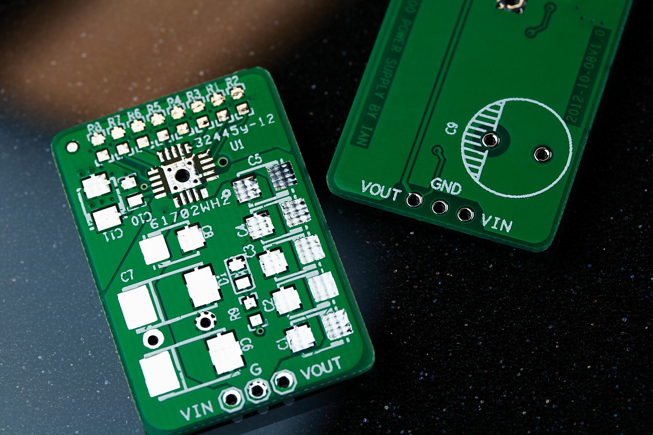

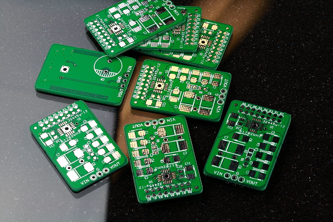

TPS7A4700 low noise reg PCB samples are available for donation now
TPS7A4700 reg was confirmed good in the past a couple of weeks. I ordered 50 PCB samples J. Somebody may need them for their project.
I understand you more will to support my R&D rather than just receiving free evaluation samples. So, in this case, I’ll supply this PCB with opening for donations.
If you want the PCB, you can make some donation to my Paypal account: iancanada.mail@gmail.com. You can ask for more than one piece with putting note on Paypal payment form. But to leave more chance for others, it would be better no more than three pieces if you don’t really need that many. TPS7A4700 PCB will be shipped to your Paypal address in a letter. Or, you may include your GBIII order number if you have to ship them together. But please do not mix up with GBIII payment, I may easy to get confusion. I thank you for your donation no matter how much it is J.
Slodering the QFN may need some skills, This youtube video may help:

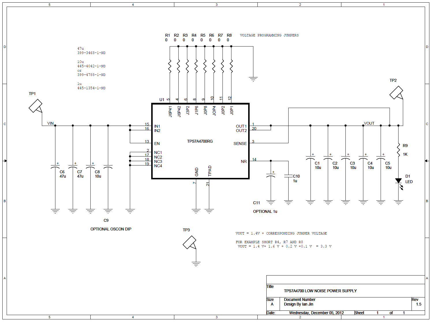

Datasheet: http://www.ti.com/lit/ds/symlink/tps7a4700.pdf
Schematics attached below

Did you see the TPS7A3301 it's a nice negative LDO very close to the TA4700 in specs. Will probably use this one on the IV stage of my next DAC
TPS7A3301RGWT Texas Instruments | 296-34830-1-ND | DigiKey
A TO220-7 case is available for this one but sadly the TPS7a4700 in not available in this package... It could have been a very nice and simple bipolar 1A supply design

fridrik, i'm not sure these regulators are that suitable for an IV stage, LDOs in priciple and across the board generally rely heavily on their output capacitors to provide for transient current demands ie. their transient response is directly proportional to the output capacitance; by themselves while the noise is good and low, the transient response is usually pretty ordinary.
this is fine for things that have low, or stable current demands that can be supplied by lowZ decoupling at point of load, but IV stages though not having huge current demand (most of them), do have transient current demands that may be enough to deplete local decoupling.
what do you think Ian?
