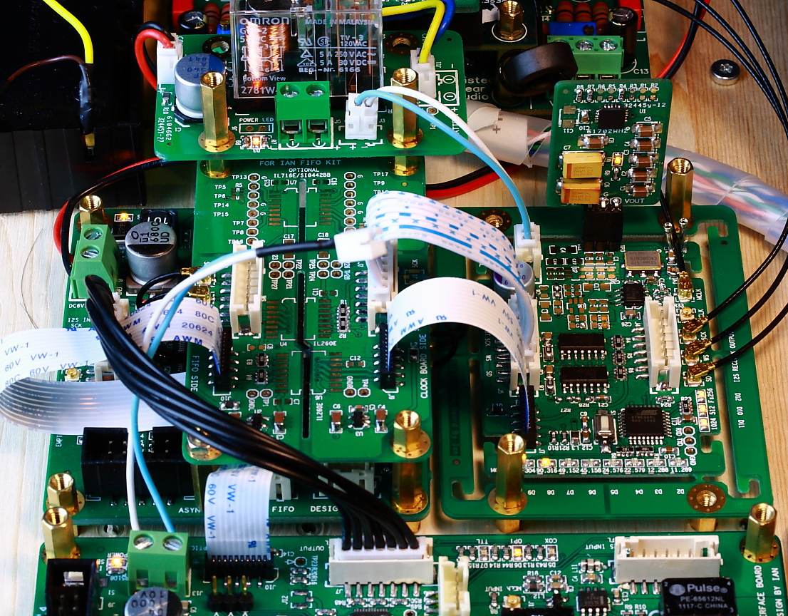

FIFO not locking - help please
Hi All,
I'm having an issue with the FIFO "locking".
I have TP48 connected to GND.
Im feeding the FIFO with I2S 16/44.1 from a QA550 SD card reader.
Whats strange is that it was working last night if i touched the Altera chip in the center of the plastic package...
Any advice anyone?
Thanks.

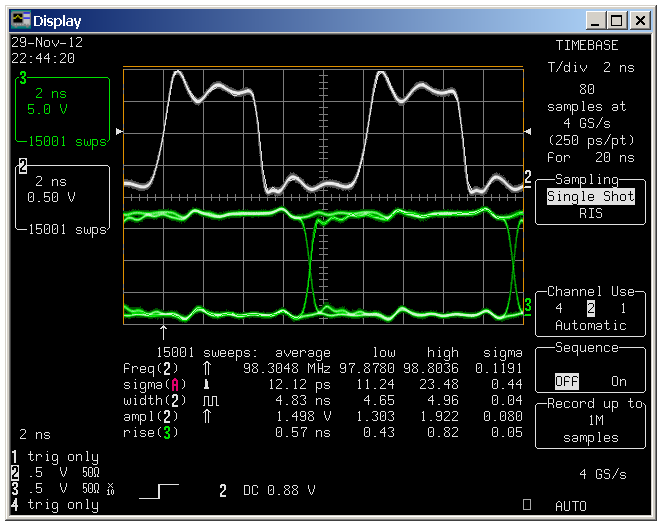

Testing report of running ESS9018 with inverted MCLK
Running ESS9018 with inverted MCLK is an interesting topic. Somebody thinks it’s important, while others seems don’t much care about it. So, I did some real test on this issue with Si570 clock board V2.0 and my BIII DAC today.
Si570 prototype clock board V2.0 was configured into both normal and inverted MCLK mode. Please see the screen shoot pictures below of the waveform testing result. The white waveform is the ESS9018 MCLK running at 98.xxx MHz, the green waveform is the “eye” of I2S BCK (or SCK, WS and SD as well) signal. We can see, with normal phase MCLK configuration, changing on I2S signals follows the raising edge of MCLK. While with inverted MCLK configuration, changing on I2S signals follows the falling edge of MCLK. With the Potato 74G74 being as the re-clock FF, the delay Tpd is around 2ns and the raising/falling time is around 0.6-0.7ns. Si570 clock board was powered by an external TPS7A4700 reg PCB with a battery pack as the DC input.
The interesting thing is they really sound a bit different. But I’m not quite sure which one is better. The normal phase MCLK already sounds very good, when it turns to the inverted MCLK, feels the background a bit more quiet and dark. It’s more obvious running at 45.xxx/49.xxx MHz then at 90.xxx/98.xxx MHz. Maybe I already got familiar with the sound of normal MCLK, feels wise, the normal MCLK sounds a little bit rich. But, overall, I still think the inversed MCLK plays positive.
Based on my testing result, I think I have to include this normal/inverted MCLK feature into Si570 clock board V3.0 design. But my question is which one is better to be as the default configuration?
Ian

Hi Ian, i tried another source, same problem. 🙁
Although if you give the Altera chip a tickle on the right side halfway up; it starts locking with the "lock" and "empty" leds flashing...
Could it be a dry solder joint?
On close inspection of the Altera chip i noticed a very small amount of solder half way up one of the legs nearly touching the leg next to it, this is the same place described above. Solder was removed, but the problem remained.
Sorry for my ignorance, this project may just defeat me! So very close though, its playing me sweet music right now.. just had to tickle it... i know its weird.

You could try to reflow all the connections on the chip. You could do it carefully by touching every leg. It might help if you add tiny amount of solder why you doing it. Check any other connections as well, because it might happen that while you are rocking chip, some other connection is acting, and it falsely appears as if the chip is at fault. Maybe wires to and from board?
