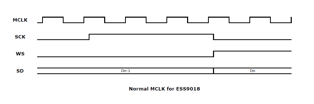

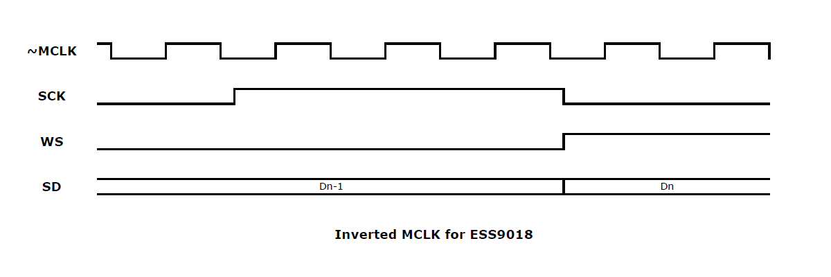

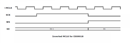

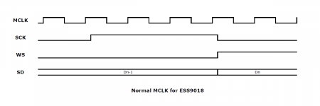

Inversed MCLK for ESS9018 in asynchronous mode
glt mentioned that inversed mclk would be better for ESS8018 running at sync mode. I read the ESS application note, it really make sense.
I think we need include this feature into the Si570 clock board Ver3.0.
Here I attached the waveform of I2S with normal MCLK and inversed MCLK. The difference on timing in between is very clear. I’ll do some real measurement on this issue later on.
Ian
According to this app note: http://esstech.com/PDF/Application_Note_Component_Selection_and_PCB_Layout.pdf on page 5:
"If operating with a synchronous MCLK, it is recommended to use an inverted MCLK. The inverted synchronous MCLK ensures that the Sabre noise is as low as possible."

Thanks glt for the good suggestion. This issue might be connected to ESS9018 internal ASRC architecture and timing. As ESS application note recommended a inverted MCLK to ensure a lower noise at sync mode, I think 9018 was optimized to the inverted MCLK. I'll give a try on Si570 clock board.
Ian

I know nothing about inside of ESS dac. But from the timing, You can see with the inverted MCLK, the changing on I2S signal has more delay from the raising edge of MCLK than the normal one. I guess this may give ESS9018 a bit more "clean time" before issue a DS pulse. But I might be wrong 🙂.
Ian

Now that is an interesting concept Ian. Is the transition from high->low 'softer' also?

I havent done any experimentation, not sure I trust my ears to pick up the difference, but it should technically be better for the reason you suggest, that the switching is done more in deadtime in relation to the other signals
