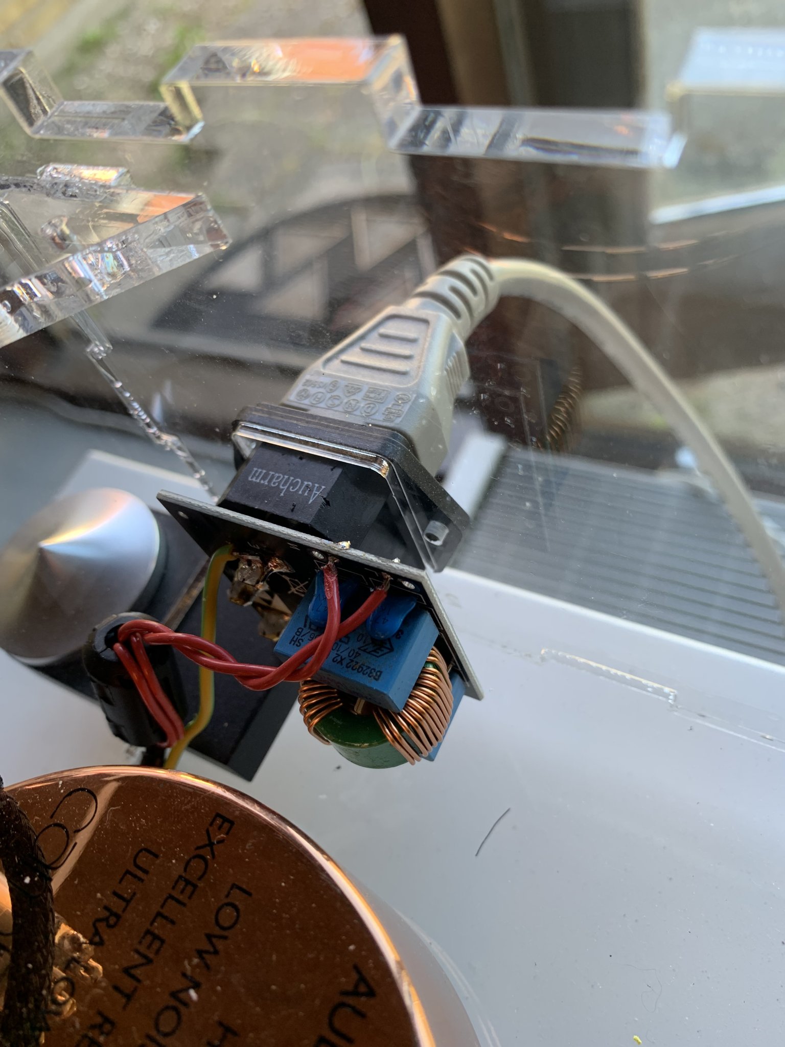

I am using a basic CLC filter with an attached socket and build in fuse.I will have a fuse between transformer and 230V input. Was thinking of buying another one with filter that I have for my 3D printer as well.
It's not even in use right now, so could borrow it for now.

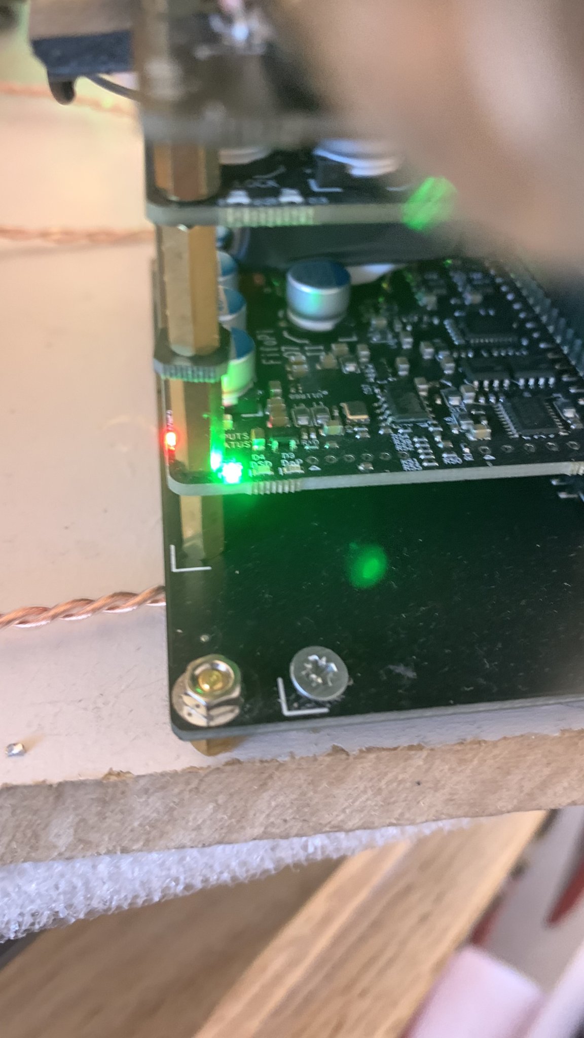

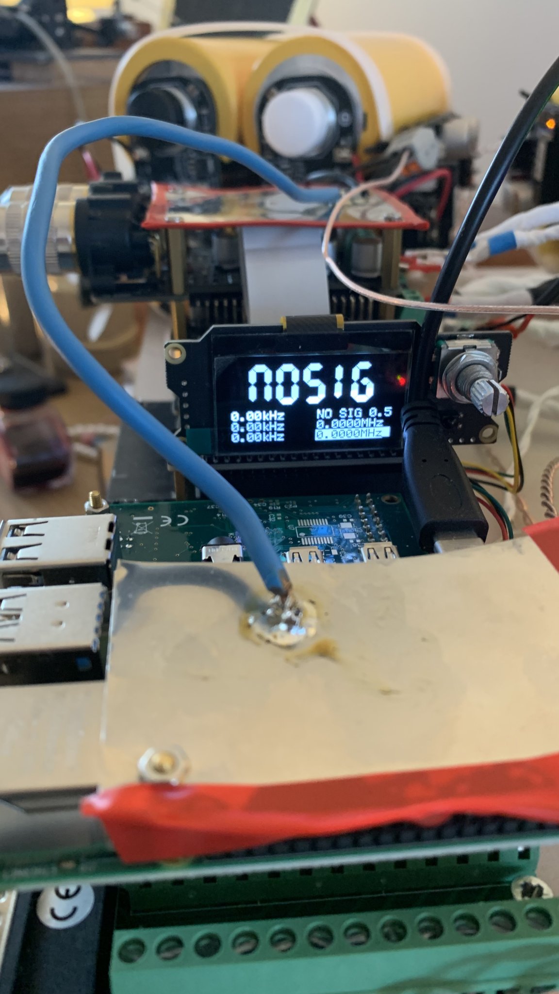

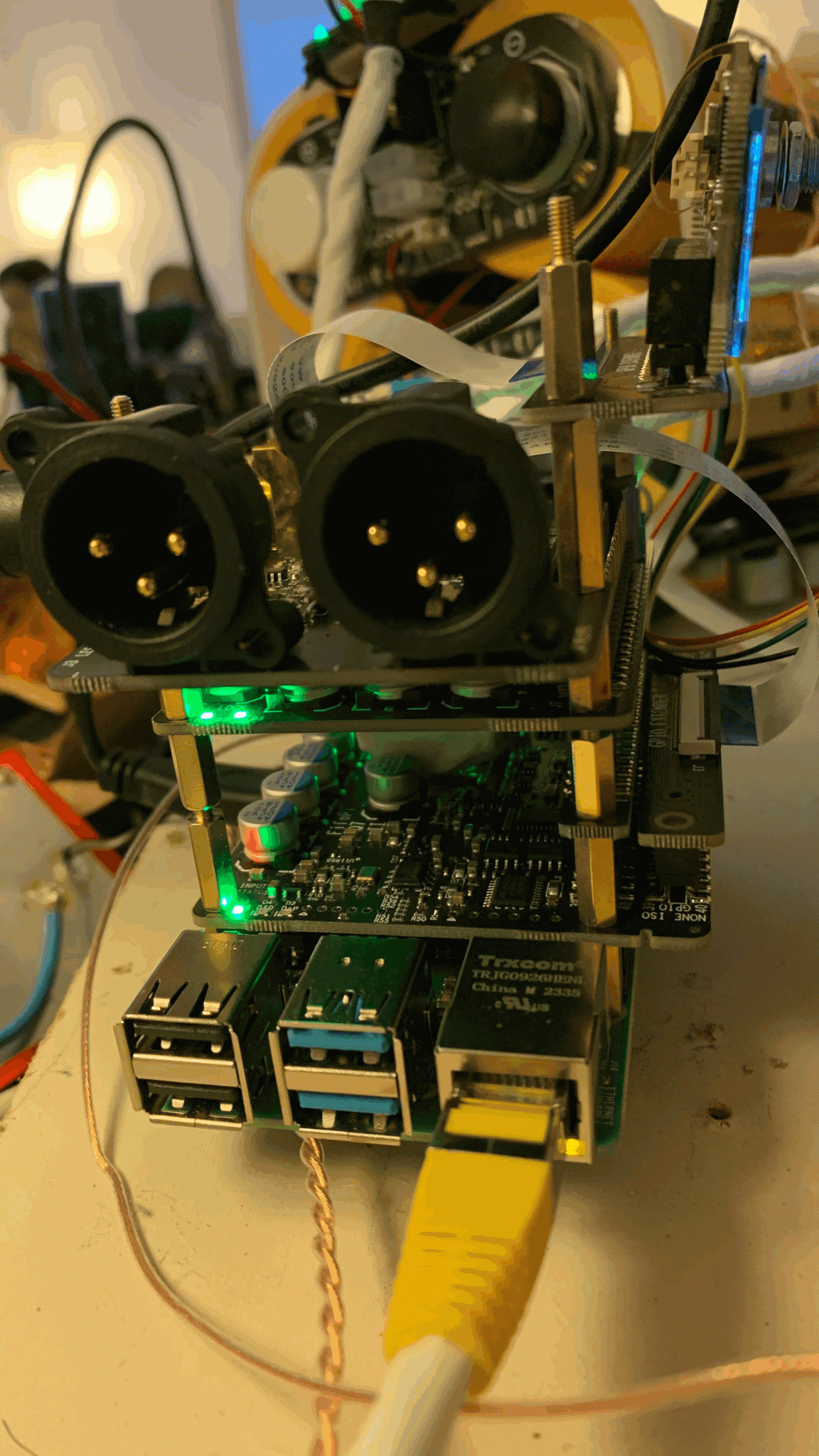

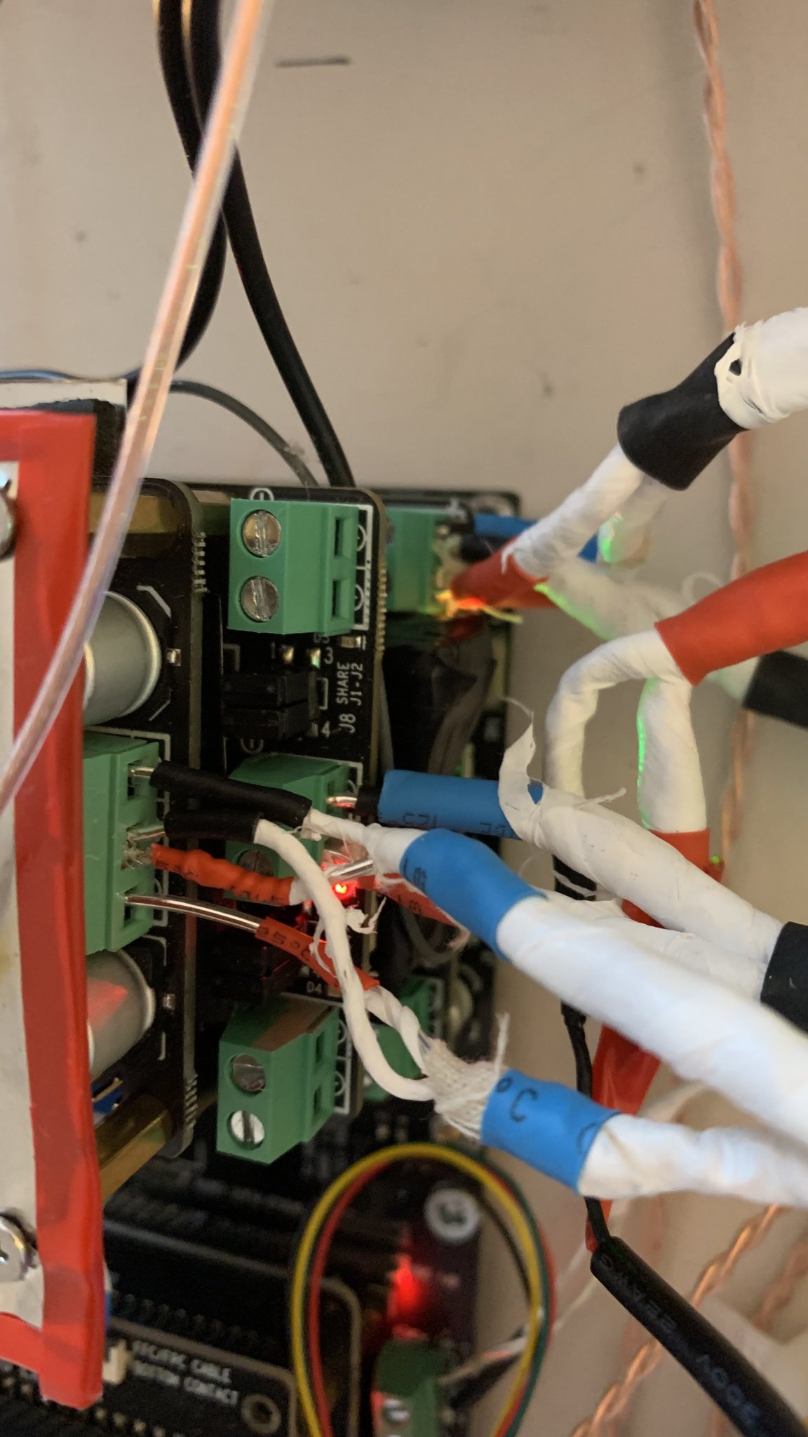

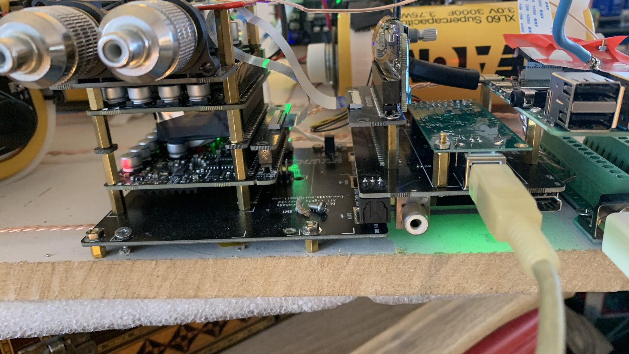

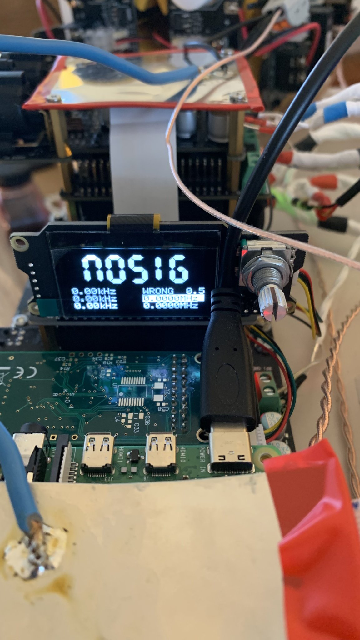

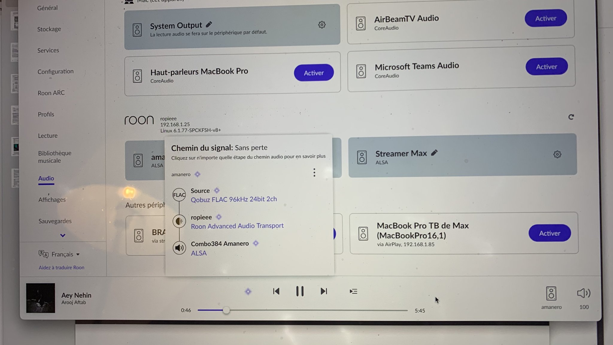

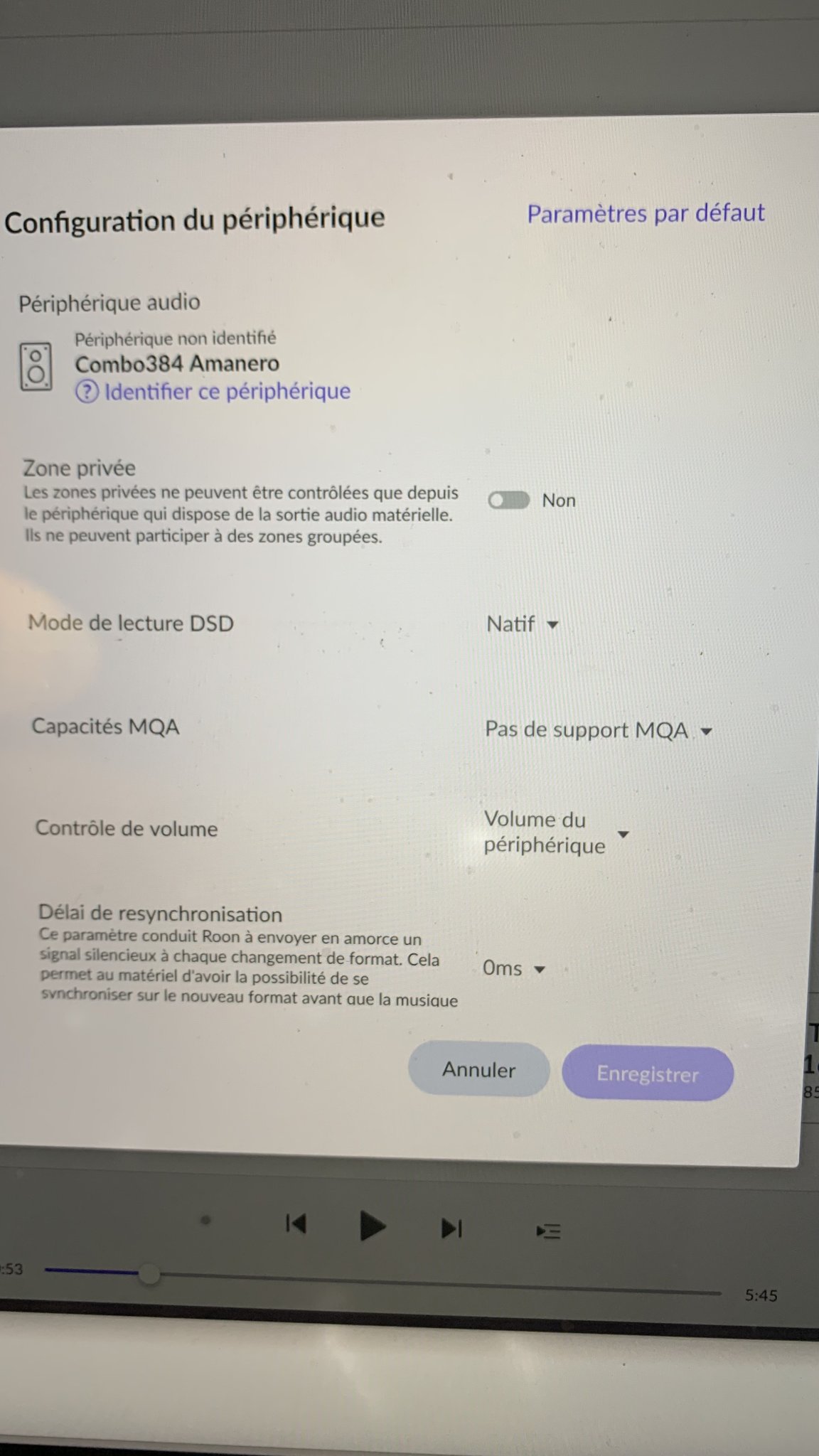

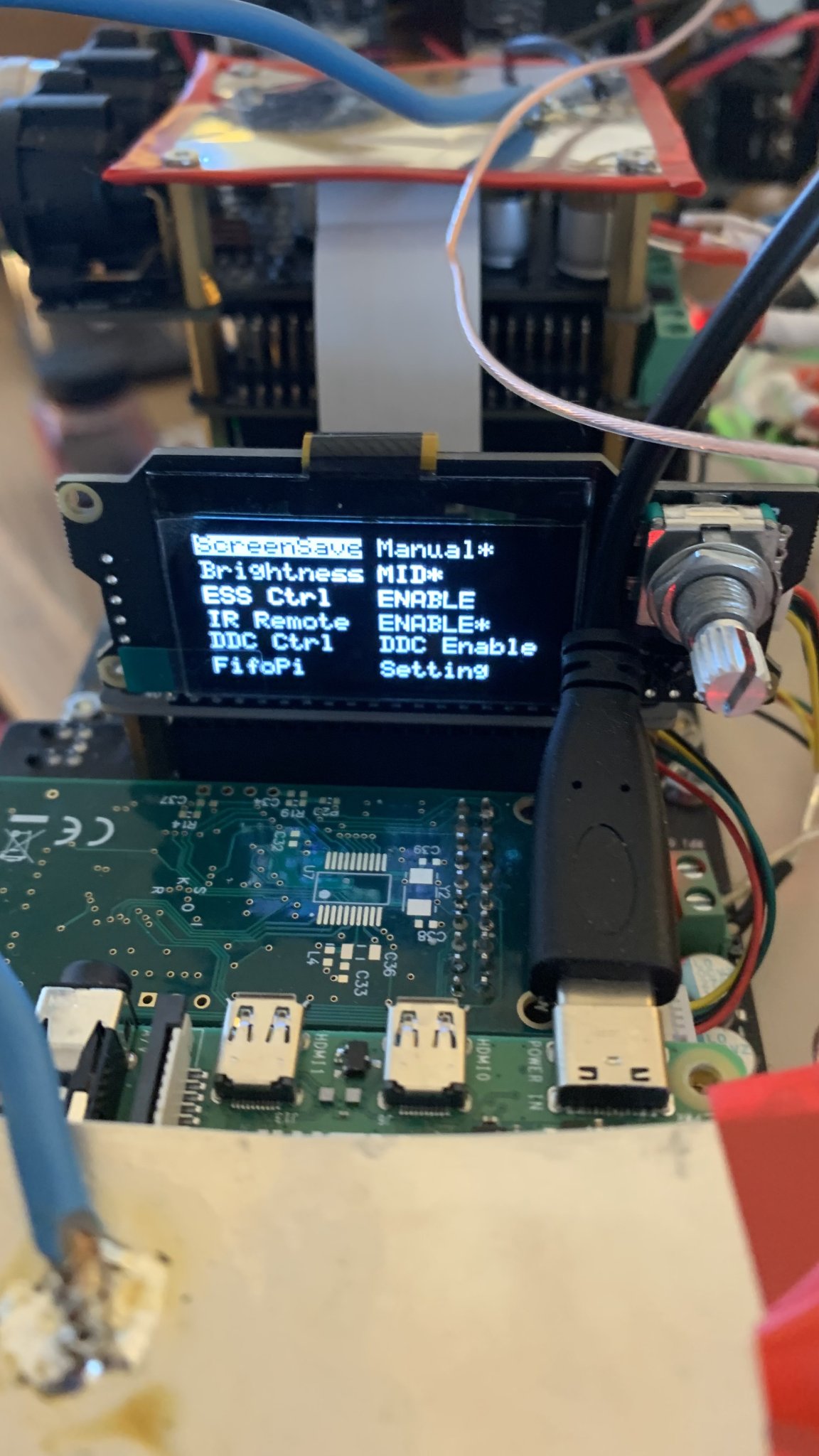

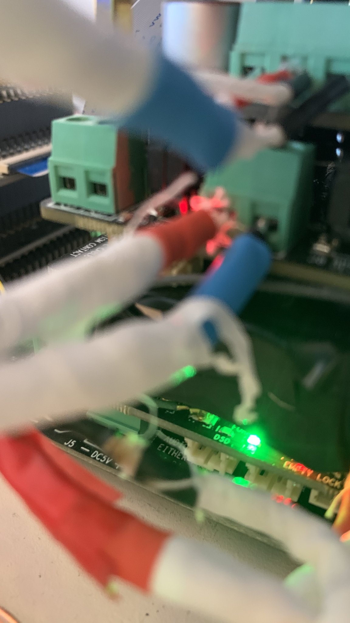

Hello everyone,
I purchased #92B project from @iancanada as well as Original Amanero Combo384 USB digital interface. Everything is powered by different UcPure 3.3V and 5V. I use Roon Core on Mac and an RPI4 as a bridge. As shown in this thread, I connected a USB cable between RPI4 and ReceiverPi DCC. I mainly use Qobuz streaming but I have a few DSD albums that I want to play via Roon Core. I also plan to plug TV to ReceiverPi DCC through optical.
Here is my problem that I cannot resolve: whatever my tests and my setup choices, no signal is perceived by MonitorPi Pro (only attempt Qobuz).
It is obvious that I lack knowledge that I cannot find. Do you have any ideas ?
Thanks in advance.
Here are some photos to help see what's wrong:
Thanks in advance.

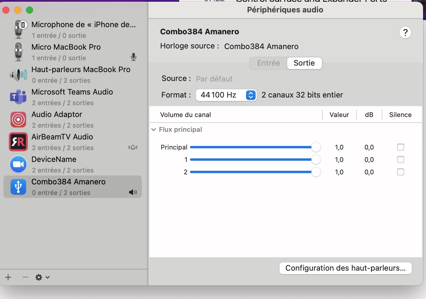

Could you try connecting the usb cable directly to your Mac -> Amanero?
Make sure you see it in MIDI settings at your Mac.

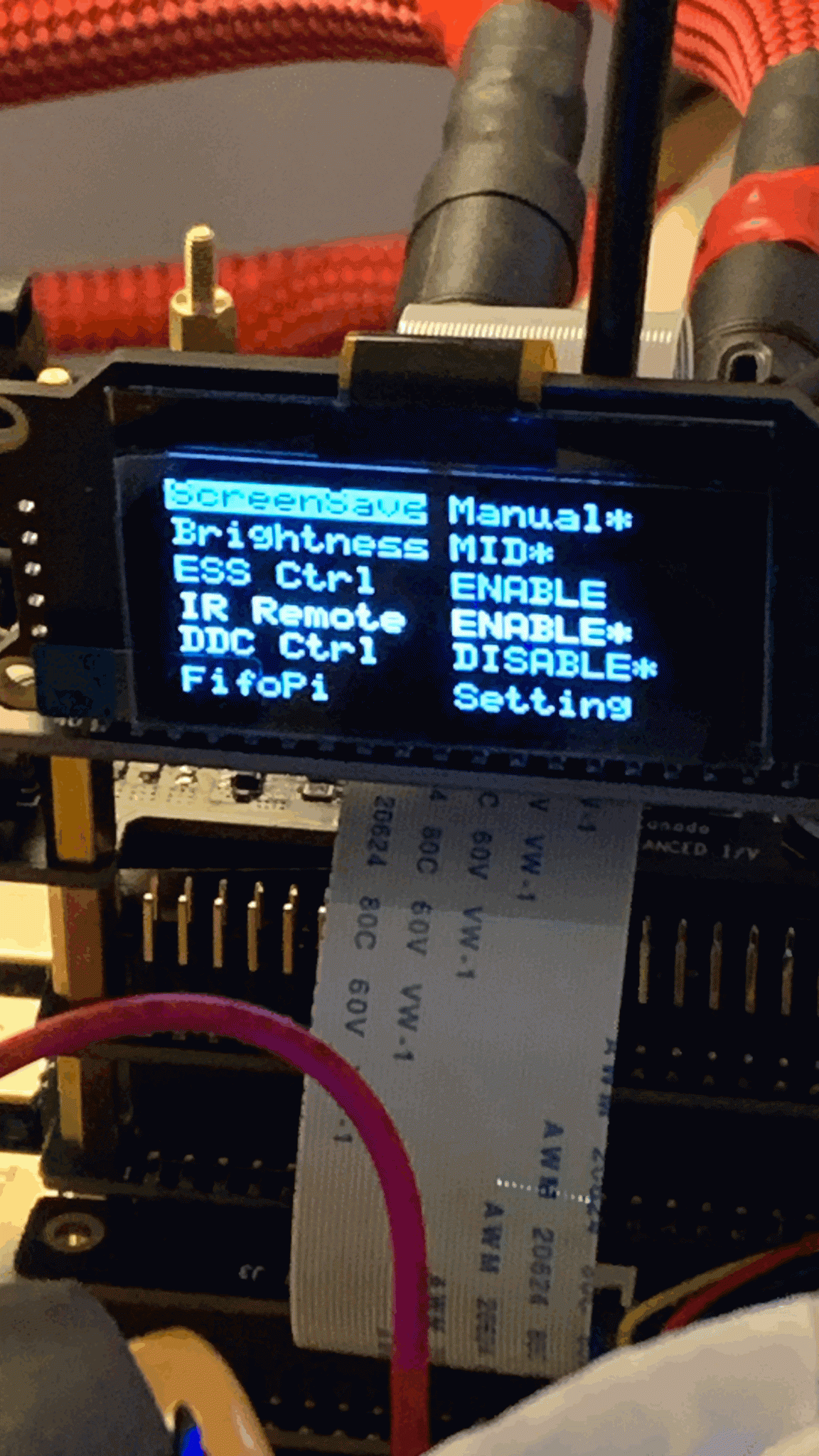

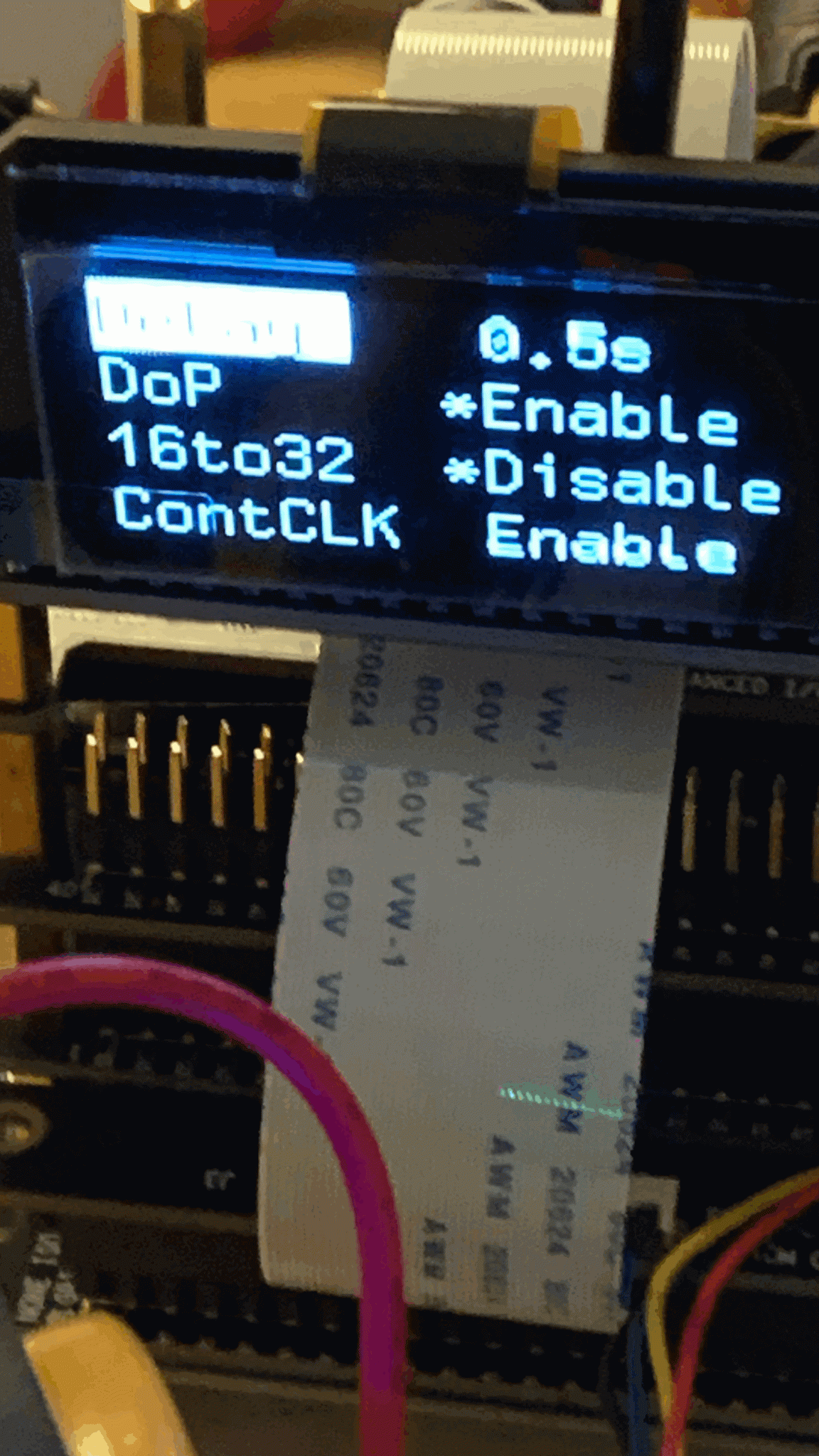

Can’t remember the receiverPi exactly but is the amanero input selected at the MonitorPi Pro? Have you enabled the receiverPi/DDC settings in MonitorPi pro?
Not an easy one…

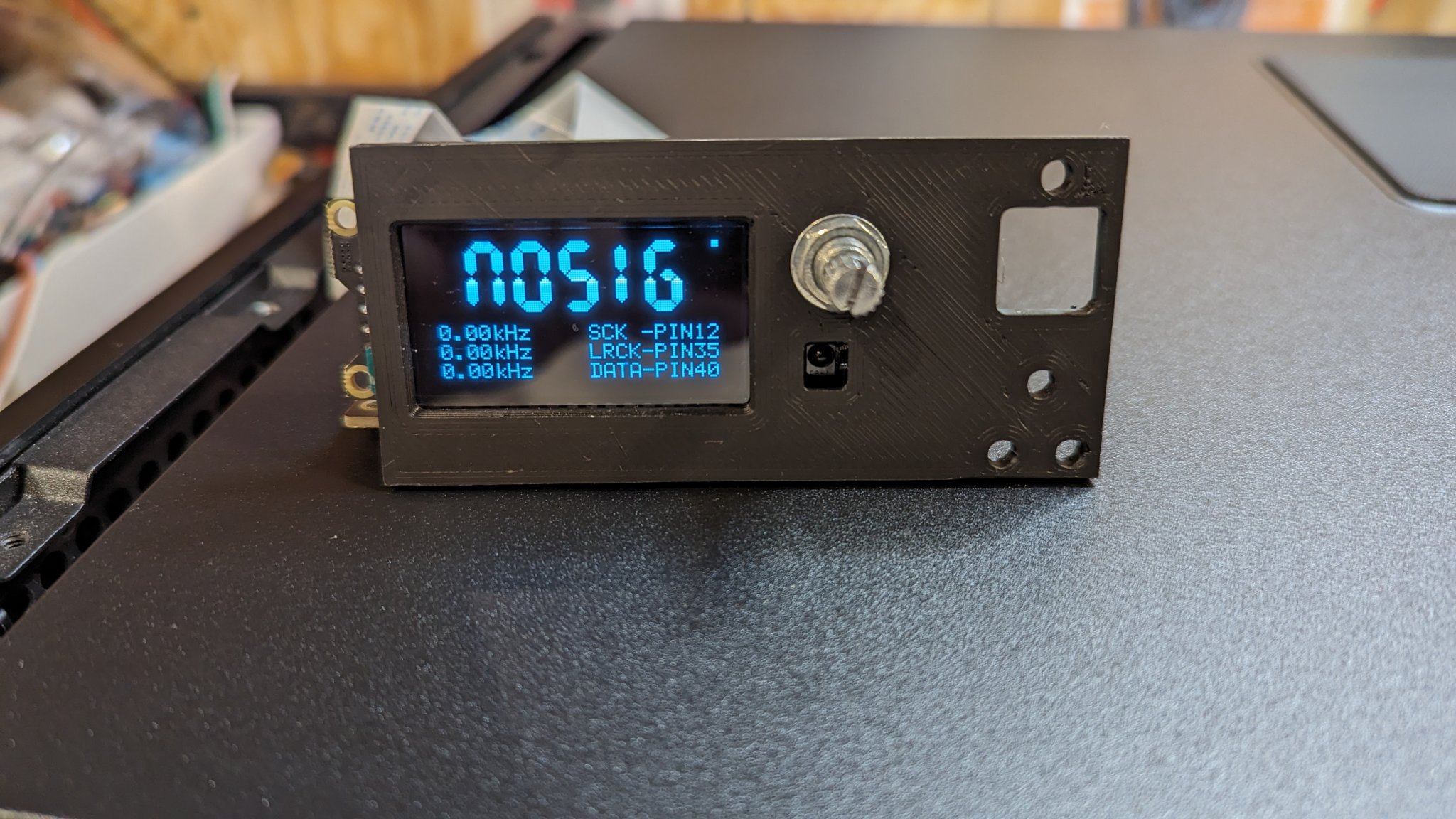

Looking at picture 13, it looks like you have connected the jumpers on the StationPi. That’s correct right? And then using a single supply to power both the DDC and dirty side of audio side?
Have you tried other inputs? Optical or spdif?
" it looks like you have connected the jumpers on the StationPi. That’s correct right? And then using a single supply to power both the DDC and dirty side of audio side? "
Totally correct : I bought the project built and tested from Ian. But I had to add Amanero for USB input. Optical or spdif, not yet. My cables are short and TV is far. I will try tomorrow night. Thanks a lot.

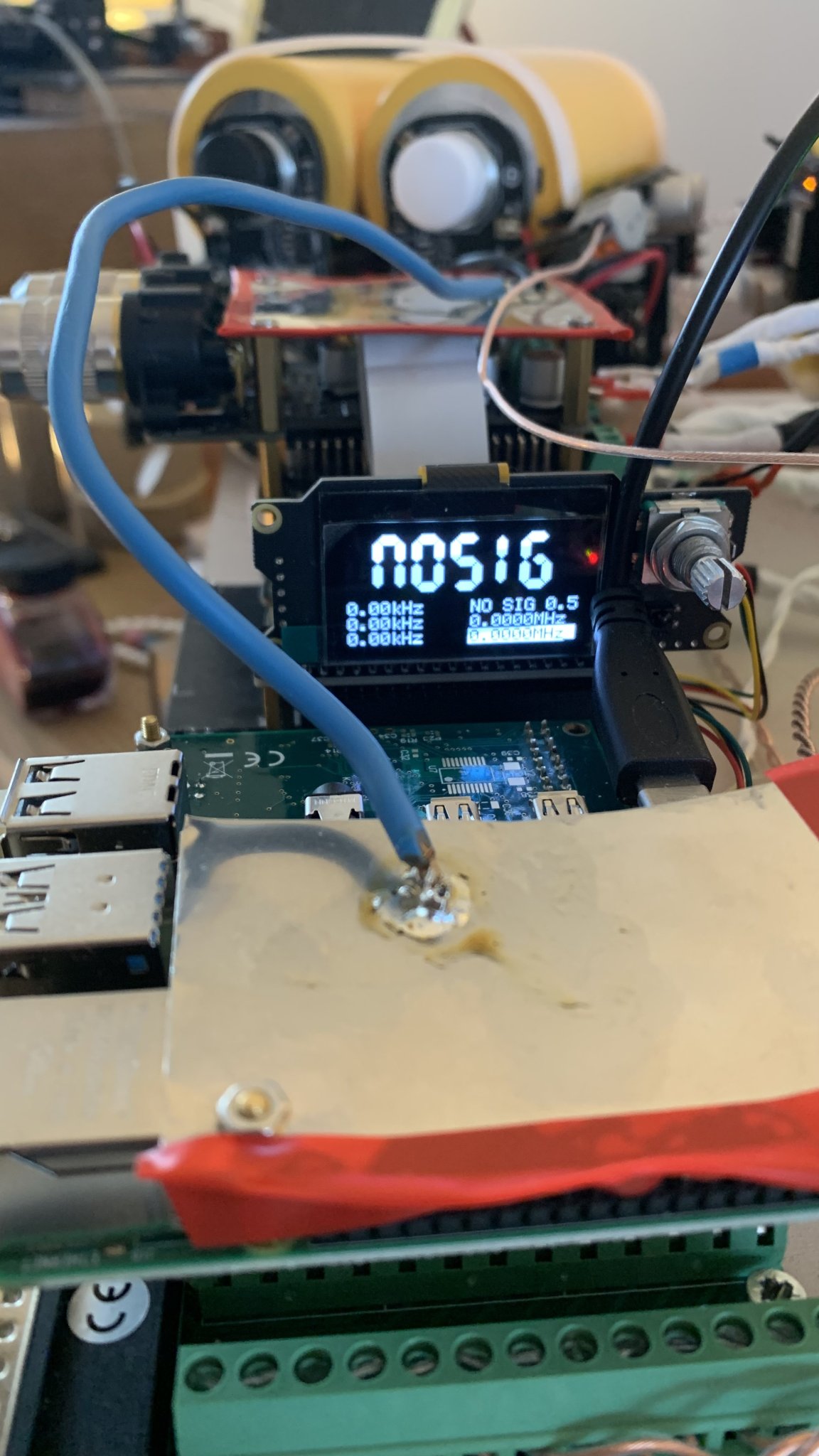

Maybe a clue, red from receiverpidcc manual :
« 3. Works with a Raspberry Pi
The ReceiverPi DDC needs to be installed in to the GPIO of a RaspberryPi when works with it. The supplied 17mm standoffs will be used to mount them together. ReceiverPi DDC will be powered through the RPi GPIO,
so J9 must be kept un connected under this mode.
A GPIO spacer may need to be installed to J1 of the ReceiverPi »
Let’s try it tomorrow night. I will let you know. Thank you @miklau

Have you tried measuring the voltage at the input terminals of each board?
I would try the other input first, just to see if you can get some music and then work back from there with the amanero and later with the RPi -> USB -> Amanero.
Sorry to ask basic questions, but just to rule those out☺️

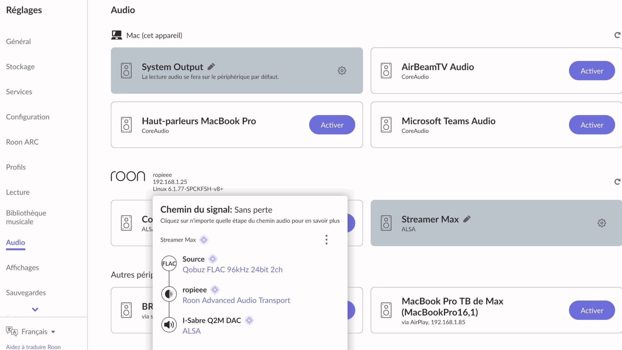

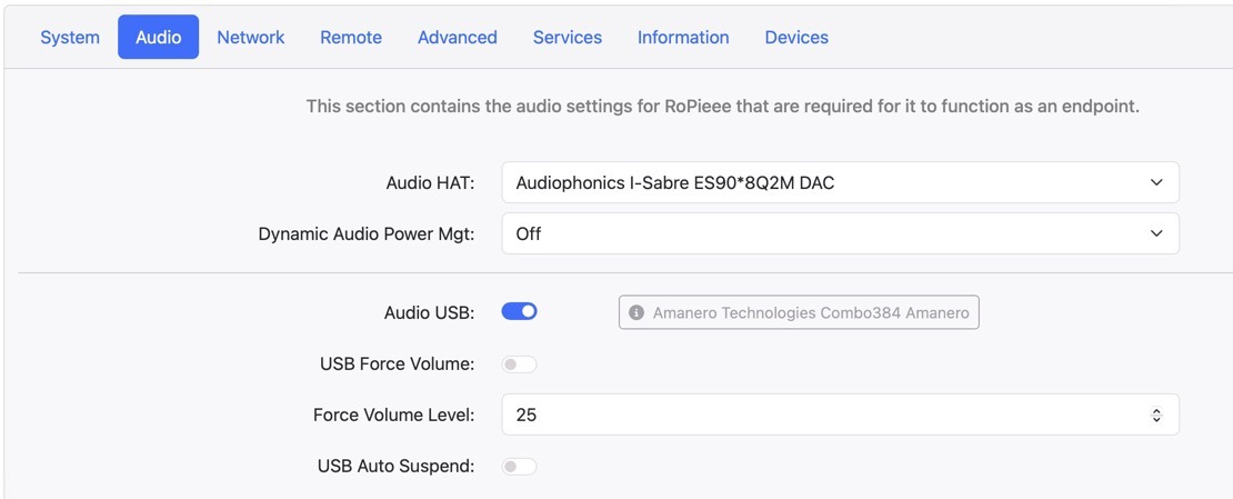

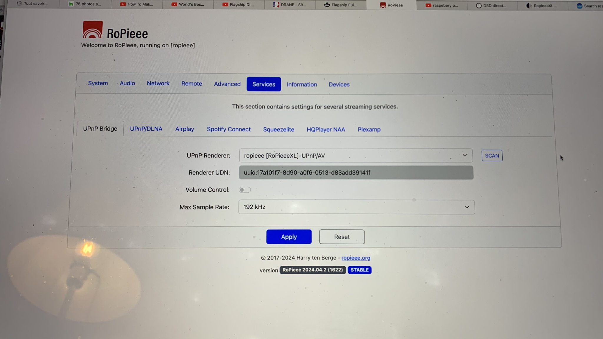

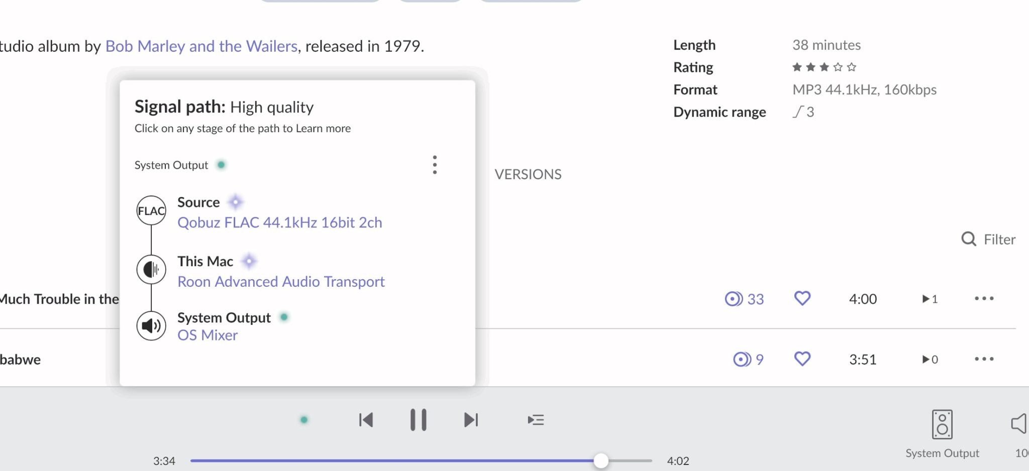

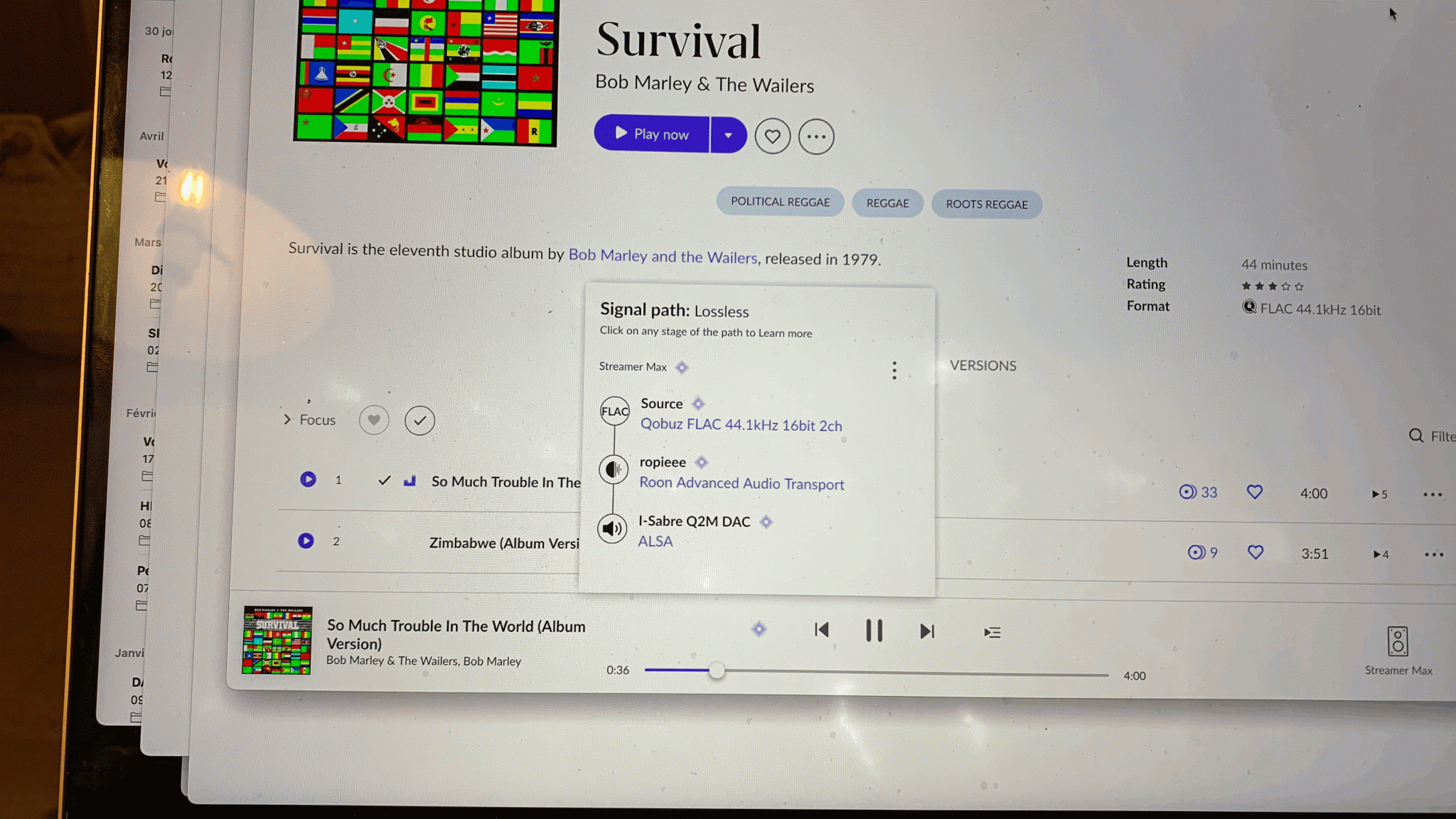

In the process of building my next gen DAC/Streamer, I have the need to try out the new MonitorPi Pro (MPP) for case fitting purposes. To test it and see what the new options are, I used another streamer I had built that was using the ESS Controller with the FiFoPi Q7, along with a RPi for network playback. Using the ESS controller, that system (a roon end-point) works fine, and displays the pertinent information. To test the new MPP, I simply unplugged the ESS controller from the non-isolated GPIO header and plugged in the new MMP. I powered up the system, and the startup banner scrolled across the screen, and then displayed NOSIG. See image below.
This was as far as I got. The end-point wasn't displayed as a configurable audio output device in roon. It was my understanding that the MPP has an integrated ESS controller, and should be a plug-n-play replacement display. I proceeded to look at the menu system on the MPP, but even with trying different settings, I was never able to change the behavior of the MPP, or get the system to be recognizable in roon. Nothing else would be displayed, as the system was not seen by roon. In order to get anything displayed on the MPP, I had to plug back in the ESS controller, and move the MPP to another the DAC GPIO header. When I did that the system 'booted up' properly and I was then able to get the corresponding data from the DAC (Ian DUAL mono). So, the only thing that changed was adding the new MPP. BTW, I am using the extension kit to bring MPP out so I can see it and use it to test. I'm sure I'm overlooking something that I can't see as obvious, or have a setting that's wrong. I was expecting to see more information, yet it seems it have broke my system. Obviously, Ian didn't design the MPP to have to be used together with the ESS controller. Page one of the documentation states that. I need to know the secrets of the MPP, because I am planning on using it in the new build. If there's another board I need to add, I need to know that - but I suspect not.
Eureka! After re-reviewing the docs I realized I had not change to the Audiophonics I-Sabre roon configuration map. It works. 🙂

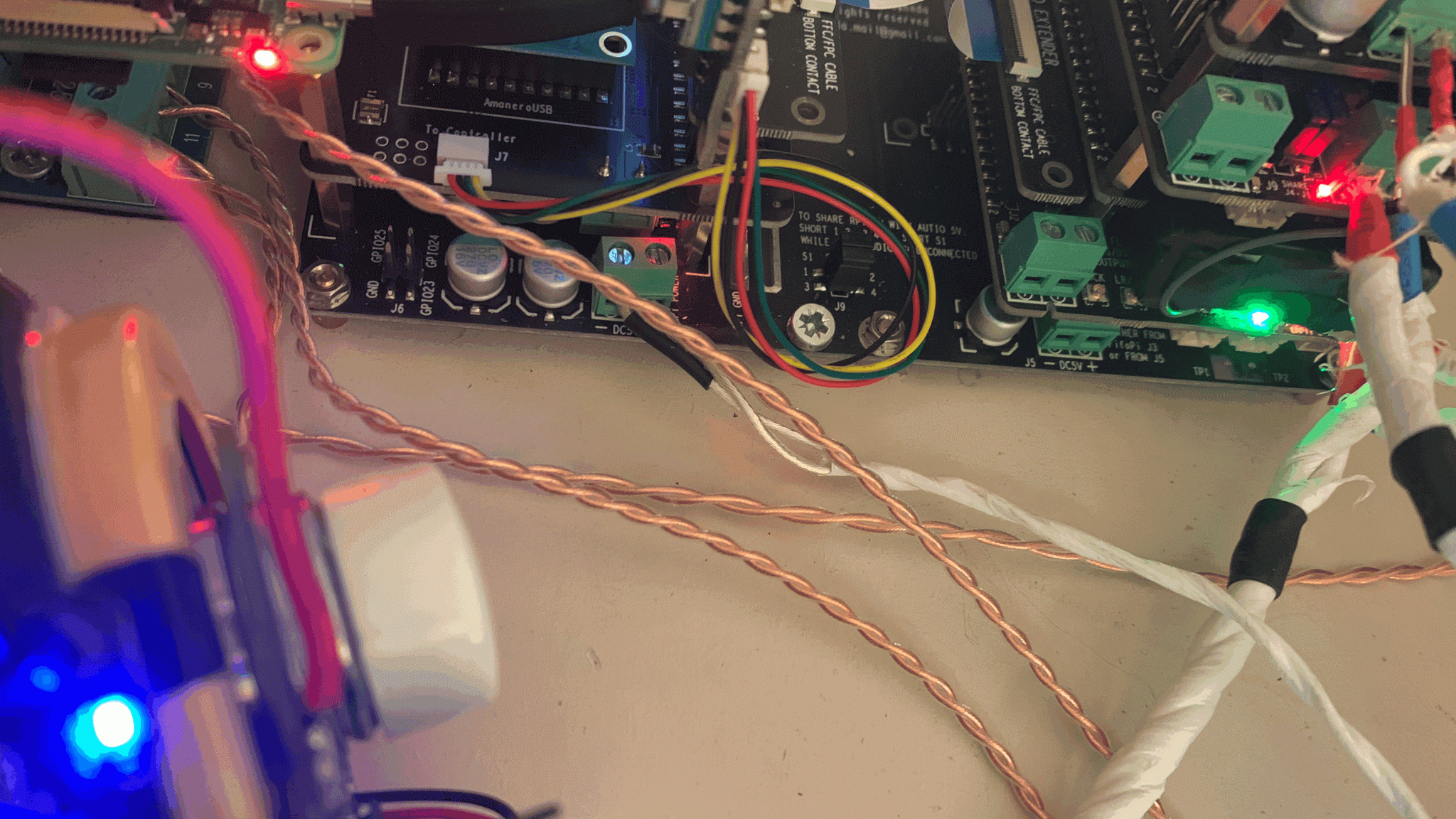

Please, don't be. Everything is helpful. First off all : many thanks
“Works at either RPi free mode or with a RPi”
I will feed it with my Mac
"Have you tried measuring the voltage at the input terminals of each board?"
Yes I did it. Everything is ok (3.1V at Q7 clean side too low ?) . All cards are powered with UcPure ( 50VA Toroidy transformer to each card)
"I would try the other input first, just to see if you can get some music"
During the weekend, I will try with optical from TV
" and then work back from there with the amanero and later with the RPi -> USB -> Amanero."

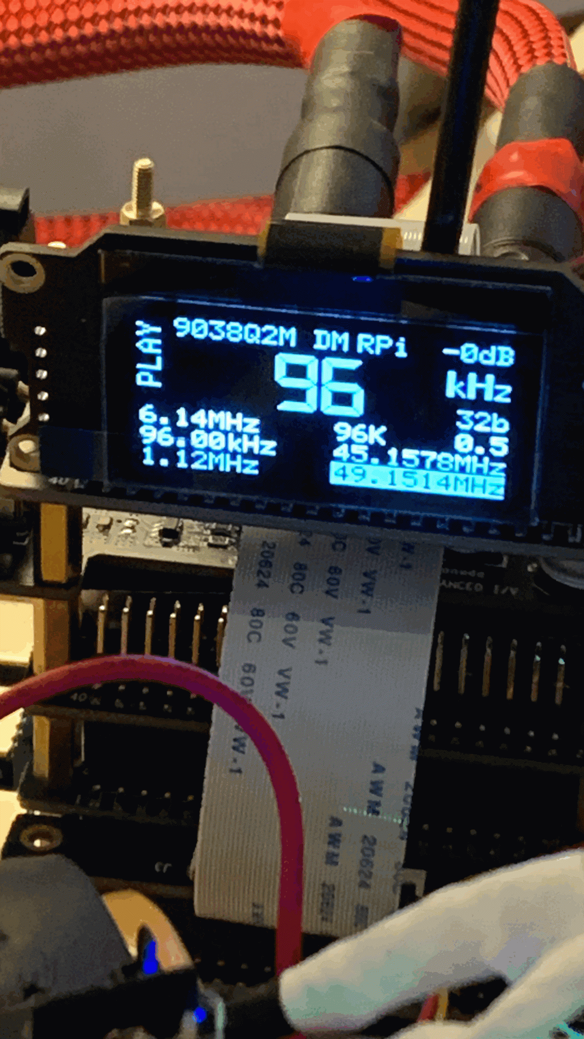

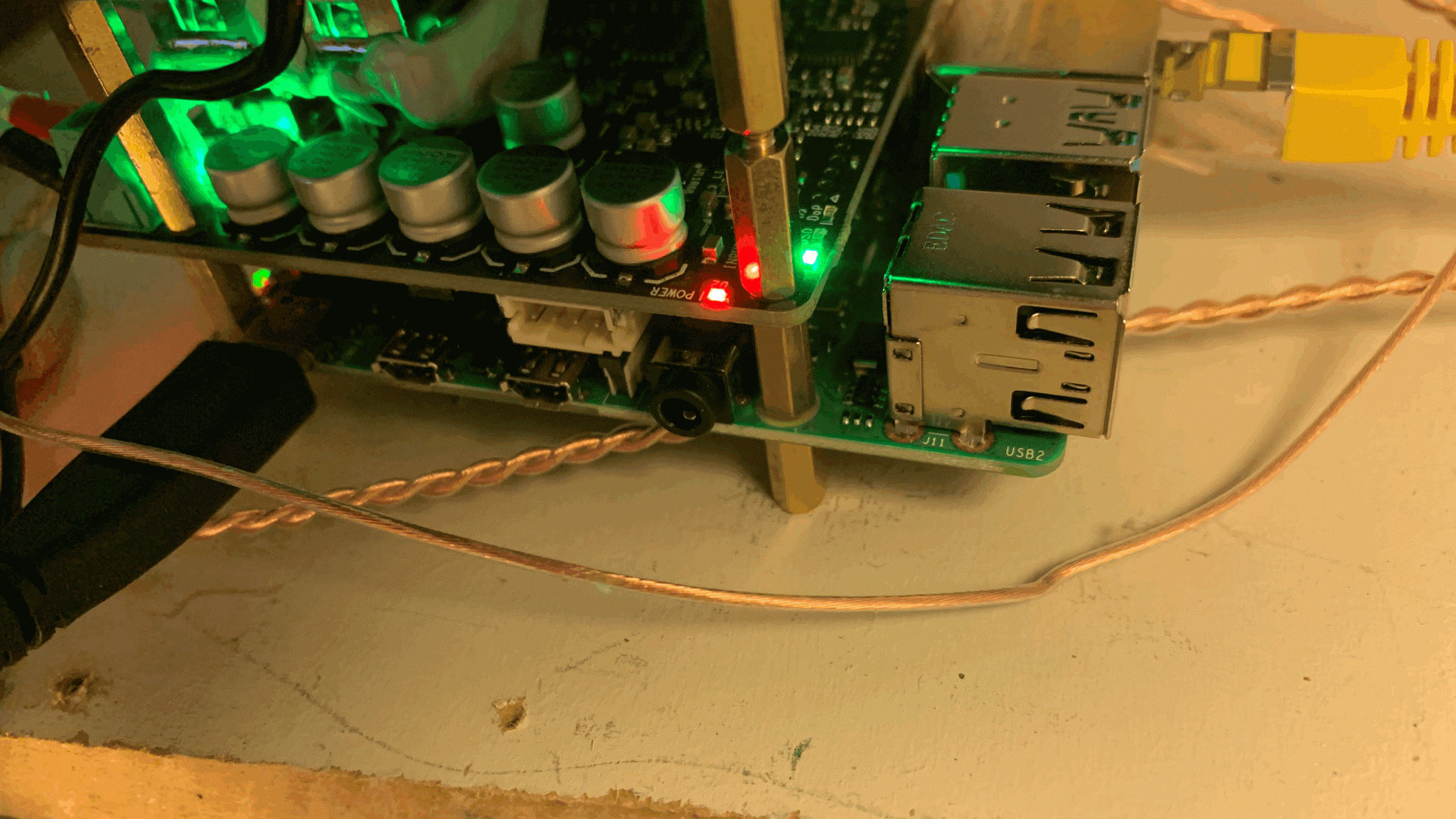

I tried simpler setup : RPI4, Q7, ESS, OPA. Q7 and DAC seem to be locked. But still no sound out at all.
Here is some pictures :
Correction !!!! I've got it : 3 mistakes.
1. ReceiverDCC must be on RPI plugged through GPIO
2. Amanero was upside down
3. ESS jumpers was 90 degrees rotated wrong (D4 less brightness gave me the clue)
Everything will be ok now.
First listening : so easy, so pleasant

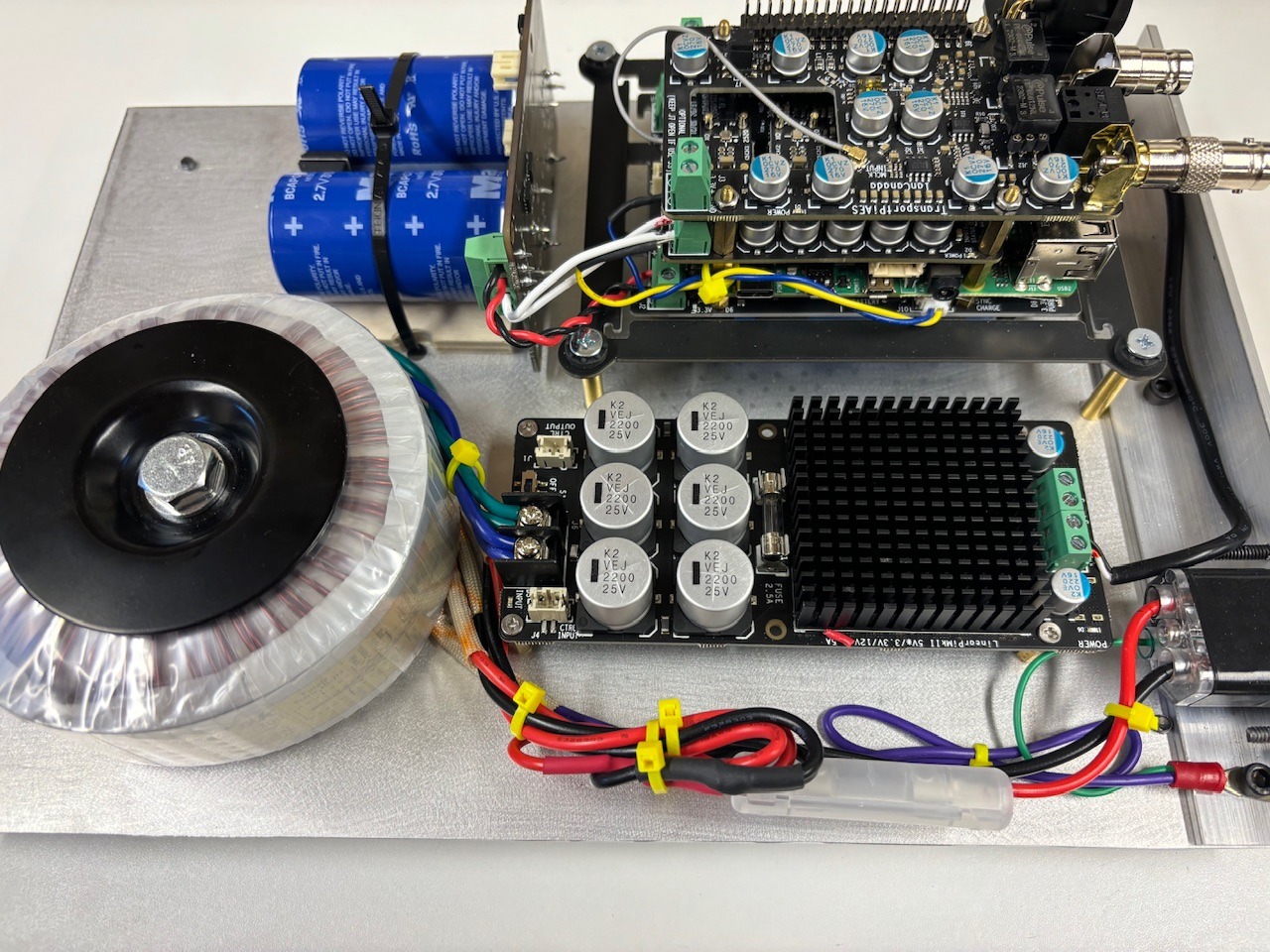

@MaxB_70
Glad to hear you’re got music playing🙂
It looks like you got some interesting cabling done at your build. What are you using ?
Feel free to share any good recommendations and how well it improves sound quality🙂
I am using some simple 99.99% OFC 1.25mm2 copper cable between my UcPure and DAC stark. As short as possible. I think it is hard to fit much larger size cables in the Phonix Contact connectors. A 1.5 mm2 would probably also work…[/USER]
