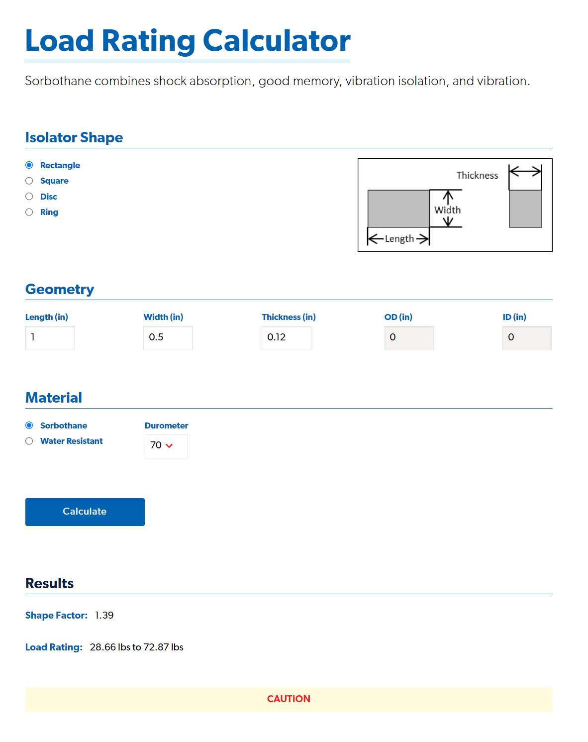

And regarding the Sorbothane, I just stated that:
a) mixing different dampening materials for the same unit/part will likely yield suboptimal results
b) optimal loading factor for Sorbothane is relatively high
For example, Sorb. sheet with Duro 70 for one clock with your used thickness should be loaded between 30 - 70 lbs and I guess in your case it's realistically below that at least in order of magnitude (source: https://www.sorbothane.com/technical-data/design-guide-calculators/load-rating-calculator/ ).
That's the reason why I chose to stick with the Moongels for clocks, as I find at extremely close to Sorbothane absolutely speaking.
Otherwise yes, given if Sorbothane is optimally loaded, it has slightly cleaner bass and dismissively blacker background, but the real difference is in my opinion/experience so small that it's worth pursuing just in a highly-tweaked / ultra-fi setup.

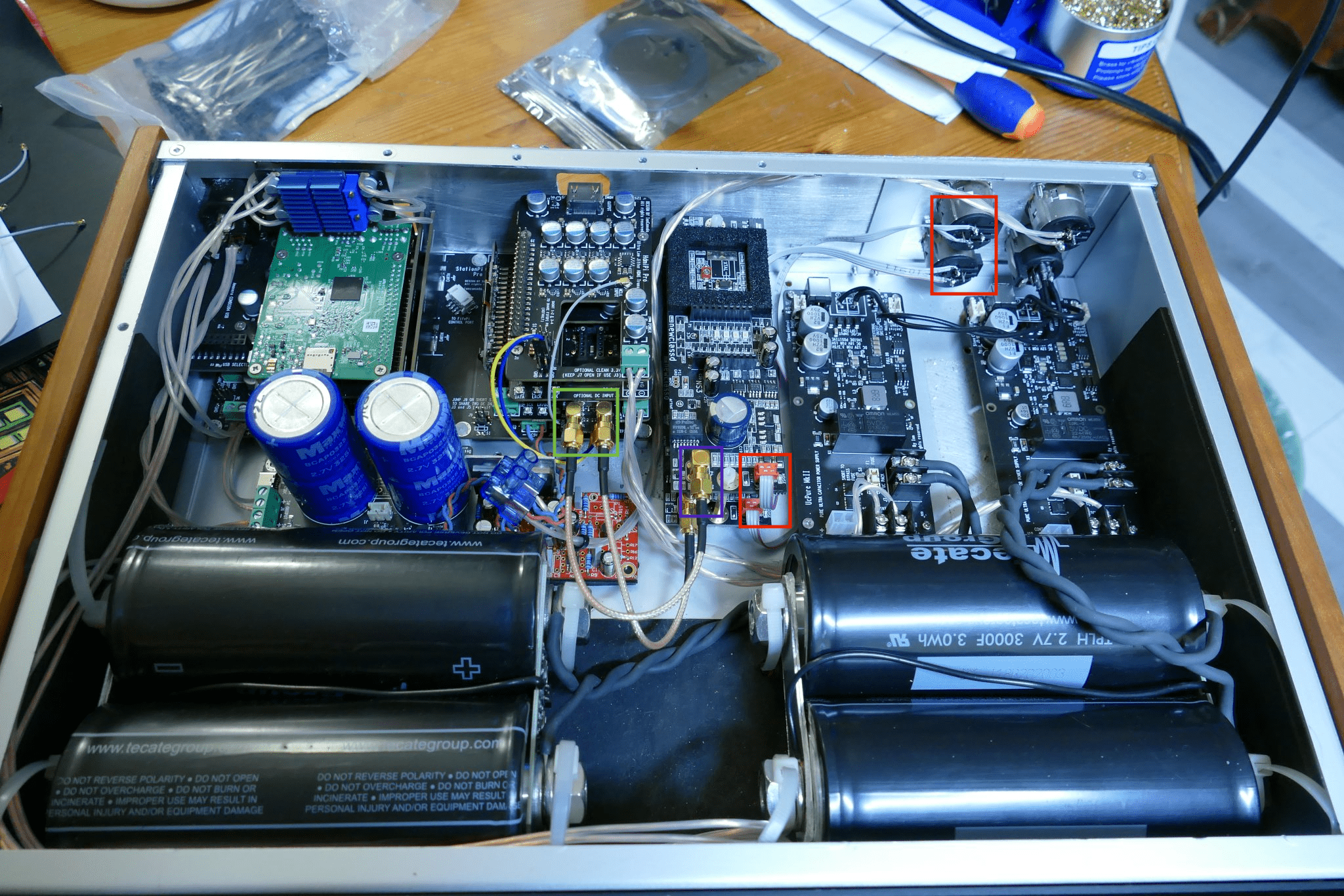

It looks like you got some interesting cabling done at your build. What are you using ?
Feel free to share any good recommendations and how well it improves sound quality🙂
I am using some simple 99.99% OFC 1.25mm2 copper cable between my UcPure and DAC stark. As short as possible. I think it is hard to fit much larger size cables in the Phonix Contact connectors. A 1.5 mm2 would probably also work…[/USER]
Thank you.
The cabling : OCC silver plated solid core 0.5mm diameter, between UcPure and DAC stack. High density PTFE banded to avoid skin effect and twisted very tight too avoid noise. As short as possible too. My setup has 8 UcPure, so the platform is pretty big 45cm X 43cm. The longer cables for dirty sides, shorter for 3.3V cards.
The improvement I heard :
Deeper and wider soundstage. With Ian's stack, it is king of huge.​
Notes are much longer : piano on London Grammar Shyer (on If You Wait Lp) shows that so well.​
Big cables with OCC provides good and tighten bass as they provide big current when it is needed.​
Silver combined with copper make feel sound so rich too.​
Reactions: miklau

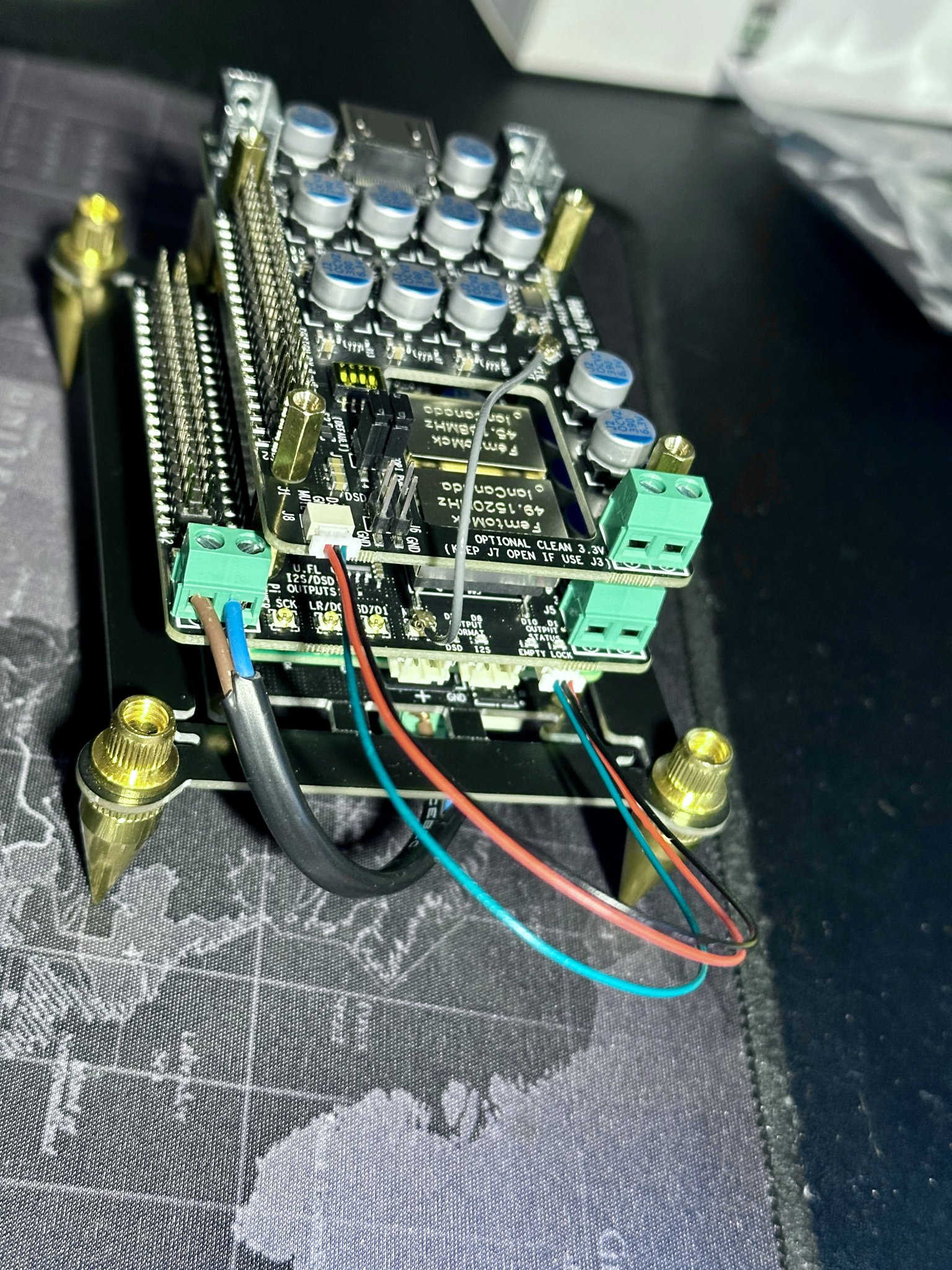

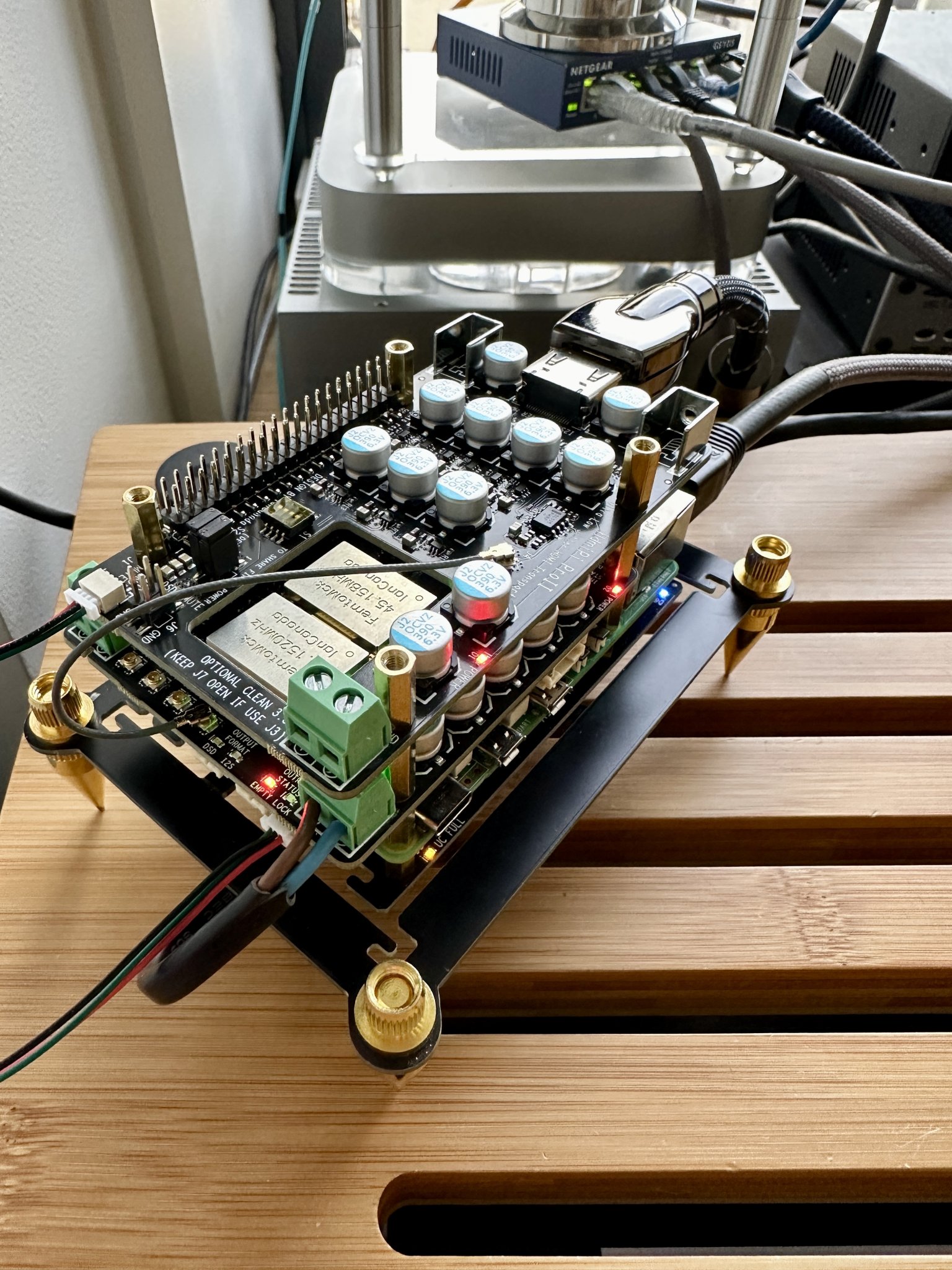

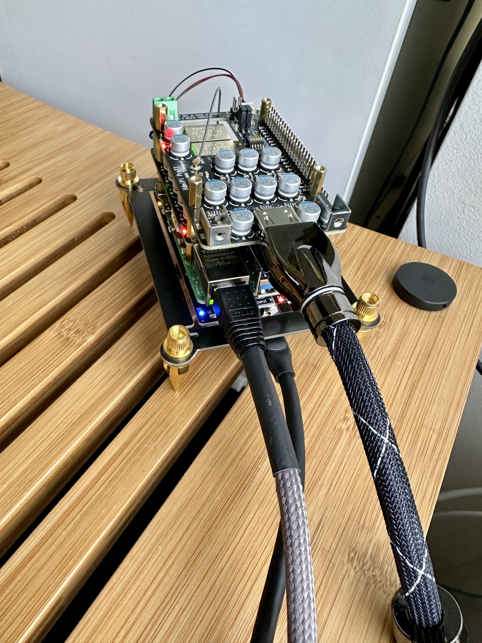

Hello everyone,
I purchased #92B project from @iancanada as well as Original Amanero Combo384 USB digital interface. Everything is powered by different UcPure 3.3V and 5V. I use Roon Core on Mac and an RPI4 as a bridge. As shown in this thread, I connected a USB cable between RPI4 and ReceiverPi DCC. I mainly use Qobuz streaming but I have a few DSD albums that I want to play via Roon Core. I also plan to plug TV to ReceiverPi DCC through optical.
Here is my problem that I cannot resolve: whatever my tests and my setup choices, no signal is perceived by MonitorPi Pro (only attempt Qobuz).
It is obvious that I lack knowledge that I cannot find. Do you have any ideas ?
Thanks in advance.
Here are some photos to help see what's wrong:
If it's not already set properly, you'll need to change the roon-bridge overlay to the Audiophonics I Sabre - in either Ropiee, or roon-bridge (DietPi) whatever one you are using with the RPi.
  • Thank You
Reactions: MaxB_70

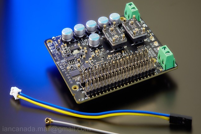

I have a question about the Sync cable between the PurePi sync port J10 and the MUTE output J14 on the FiFoPiQ7.
I see both have the same kind of connector but the cable supplied with FifoPi has the correct connector (white color) on one end of the supplied cable but the other end (black connector) will not fit.
Does anybody know the exact model or type number of this white connector ?
This way i can hopefully find an assembled cable (approx. 20 cm) or build it myself.
P.S. talking about the connections to be made; if I understand the manuals correct:
On the FiFoPiQ7 I only need to connect one wire (be sure to use the MUTE pin, the other pin is the DSD pin) and the other wire at the cable should be connected to signal ground at FiFoPiQ7 ?
On the PurePi the polarity for the SYNC port is not relevant.
Can somebody also confirm if I have the connections correct ?
Thanks in advance.

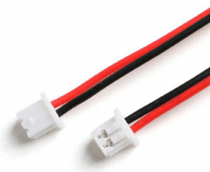

These connectors are known as PH 2.0. You can make a cable by yourself using a kit like this PH 2.0 kit You’ll need the correct crimping tool.
Ian also sells them on his webpage. Didn’t you receive a cable with the PurePi you can use?
Reactions: Oystein and MaxB_70
@miklau
Thank you very much for the type of connector.
PH2.0 is from JST and can easily bought locally.
I bought the first version as shown on my picture with the PH 2.0 connector only at one end of the included cable.
The FiFiPiQ7 MKII has a cable with this PH 2.0 connector on both ends.
To order only one cable via IAN and ship to the EU will be costly but I found this cable of 15cm for only 0,45 Euro each :

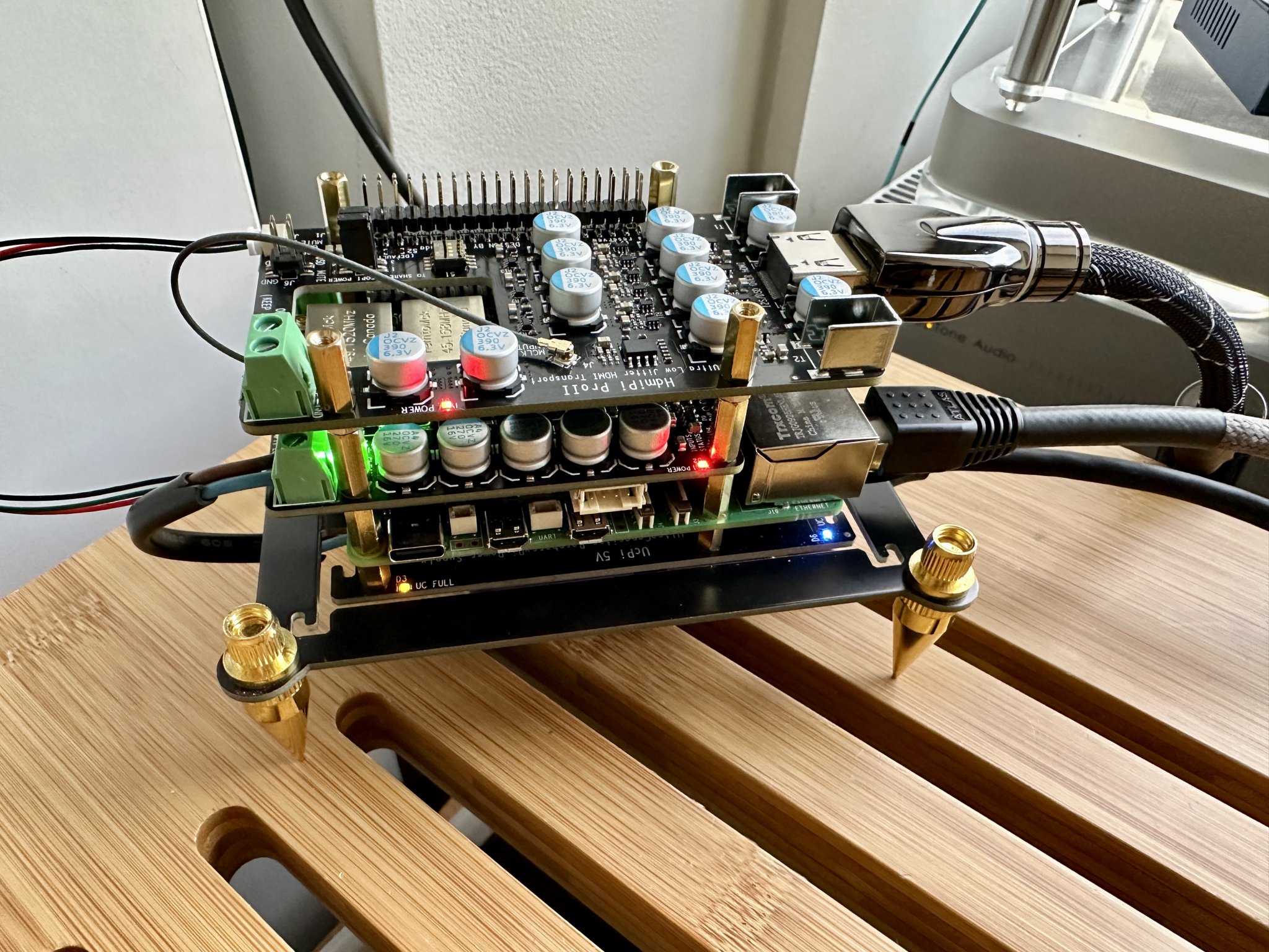

I have bought the following and installed on my Pi4 ….
IAN CANADA FIFOPI Q7 II FIFO Reclocker Module I2S DSD DoP Syncrhonous
IAN CANADA HDMIPI PRO II Ultra Low Jitter I2S LVDS HDMI Interface 32bit 1536kHz DSD1024
I am using Ropieee software, for USB connection to my dac Ferrum Wandla and not issue at all, however, for i2S it can’t find my dac.
I am sure my Ferrum Wandla is fine as it is working with my PS Audio Airlens.
Did I do anything wrong on connection, and do I need to connect the DSD and Mute signals from FifoPi to J6 of the HdmiPi Pro ?
Thank you
