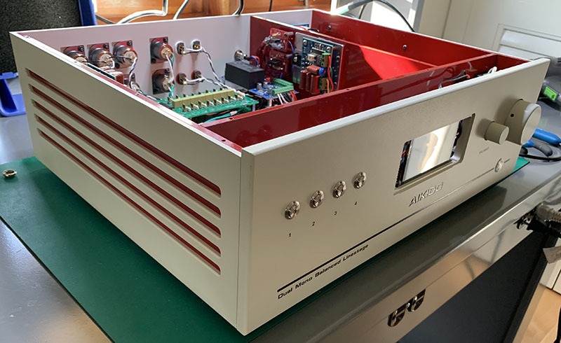

I'm building a custom enclosure using panels from Front Panel Express. I wanted to get everything in one box (including seven UC Pure supplies with fourteen 3000F caps) and didn't want the box to be any bigger than absolutely necessary (it's already going to be fairly large at 489mm W x 401mm D x 185mm H). Much bigger and it wouldn't fit on my rack.Which enclosure(s) are you guys using? I need to find something that can house UCPure quad.

@NeoTheOne - I'm using a 10mm front panel, 8 mm bottom panel, 5mm back and top panels, and sandwiched side panels which equal 10mm total. The sandwiched side panels are mostly for aesthetics to match the look of my preamp (see photo below). The inner side panel is 6mm and the outer panel is 4mm.
There are also a number of internal panels that range from 2mm to 5mm. I have some custom brackets to hold the UCPure supplies and mounting plates for the transformer. The custom transformer plates are design to provide sorbothane dampening to the chassis.
Similar to my preamp, there is a divider that spans the width that separates the front panel from the rest of the circuitry. I have a RPi4 with 7" touchscreen,, IsolatorPi, and HDMIPi Mk II mounted to the back of the front panel.
There is a separate enclosed sub-chassis (basically another enclosure built using 3-5mm panels) that houses the ReceiverPi DDC, FifoPi Q7, HdmiPi Pro II, ESS DAC, and OPA861, so the front-panel mounted streamer communicates using I2S over HDMI to the DDC/DAC. The separate sub-chassis provides both electrical shielding and mechanical isolation from the main chassis.
I like using powder-coated panels for my builds since they look nice and are much more scratch resistant so I'm less likely to damage the panels during construction. But all the panels are electrically connected so provide good chassis grounding.
I'm still working on the enclosure design so I've only had a couple of the panels fabricated so far.

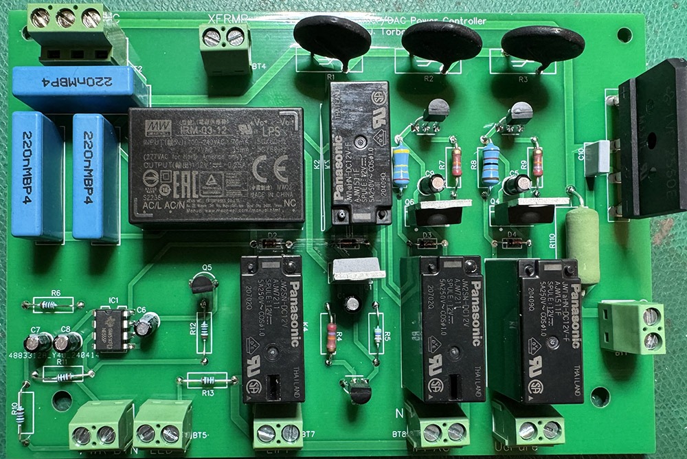

I just finished assembling my power controller board which will mount under the Toroidy transformer. This provides a soft start, low-voltage connection to lighted push-button front panel power switch, and power sequencing for the power supplies to make sure the DAC is powered up after the FifoPi and the RPI4 is powered up after the IsolatorPi.

I designed it myself using EasyEDA (free pcb layout software) and had it fabricated by JLCPCB.@Jaytor I like that power management board. Did you do that PCB or did you find it somewhere?
