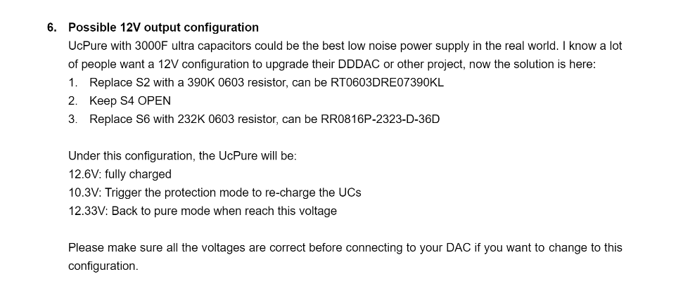

Hi @iancanada is it possible to change the version 1 UcPure please so that it can output 12v?12V configuration for UcPure MkII/MkIII
UcPure with 3000F ultra capacitors could be the best low noise power supply in the real world. I know a lot of people want a 12V configuration to upgrade their DDDAC, So the solution is here:
1. Replace S2 with a 390K 0603 resistor, can be RT0603DRE07390KL
2. Keep S4 OPEN
3. Replace S6 with 232K 0603 resistor, can be RR0816P-2323-D-36D
Under this configuration, the UcPure will be:
12.6V: fully charged
10.3V: Trigger the protection mode to re-charge the UCs
12.33V: Back to pure mode when reach this voltage
Please make sure all the voltages are correct before connecting to your DAC if you want to change to this configuration.

Thanks Simon but my question was regarding the original mark 1. You’ve sent me the mark 3 manual which has the same text in it that I quoted in my post. Ian did mention both the mark 2 and mark 3 in his post that I quoted
… but not the mark 1 … hence the question. Apologies if I’ve missed your point though.
Sorry for any confusion......Its my understanding it can be any version and Ian just updated the MK3 manual as the latest offering. He uses resistors to select the 3.3, 5 or 12V which is the same theory over all the versions. The newer versions just deliver new features and not changing the core workings as I understand it
Just keep in mind not all equipment or DACs running at 12 Volt will work fine at 10-11 Volt for example. The trigger point at 10.3 volt is pretty low for some applications. For my dddac it will not work properly. At all time you need 12 - 12,5 Volt. Just saying. For the MK3 version, it might be a good fit, as it is fed with 9 Volt. in This case you must configure it to run between 8.5 V and 9.5 Volt
Yes, that’s a good point. Thanks. I was thinking of powering an AMD CPU and I wonder if the tolerance for running at 10.3 is there!
