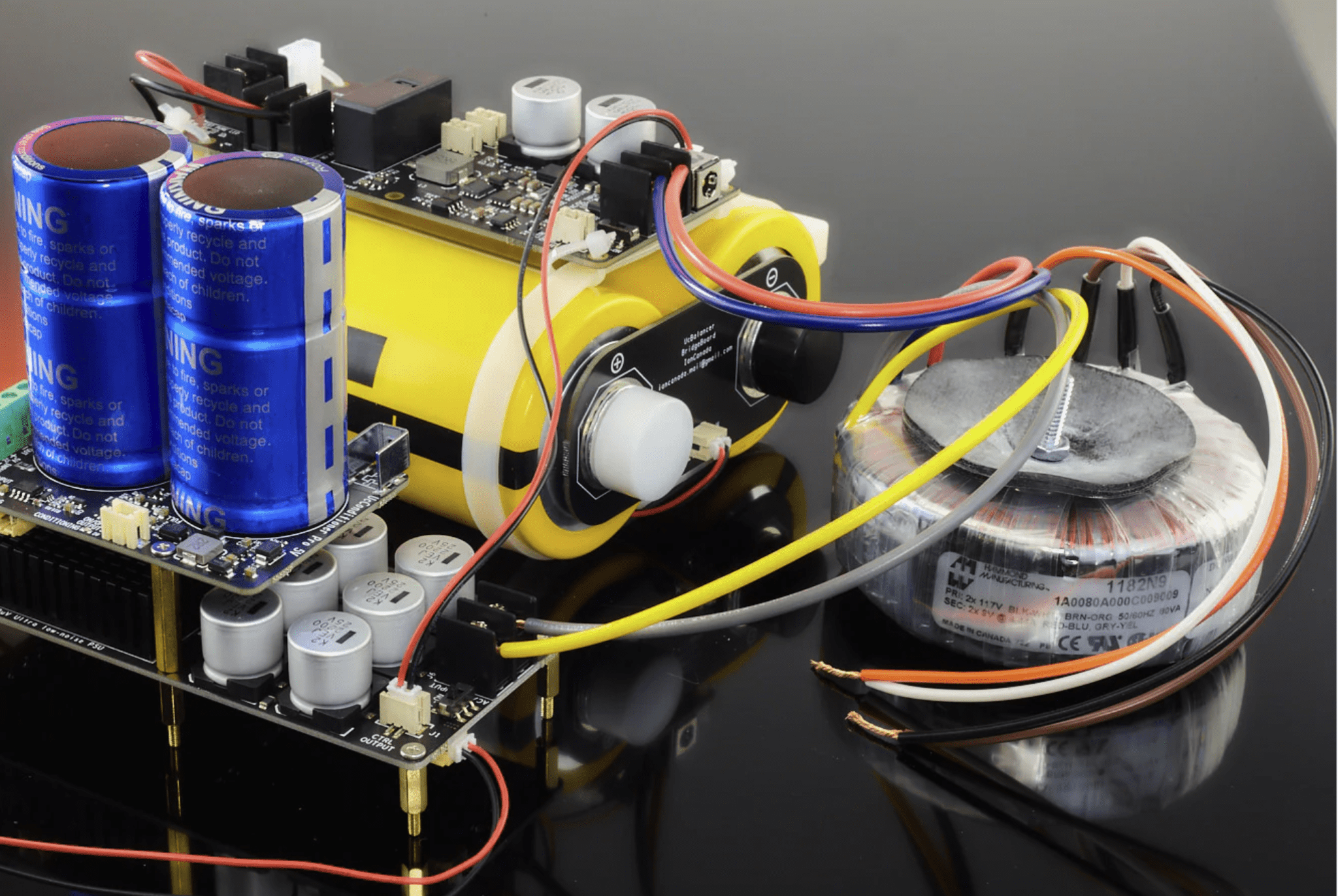

How big of a gap is there between UCPure and (LifePO4 Mini + Ultracap) for the Dual mono dac board? Anyone tried this? Especially if you want to provide 3 independent power supplies to the dac board.

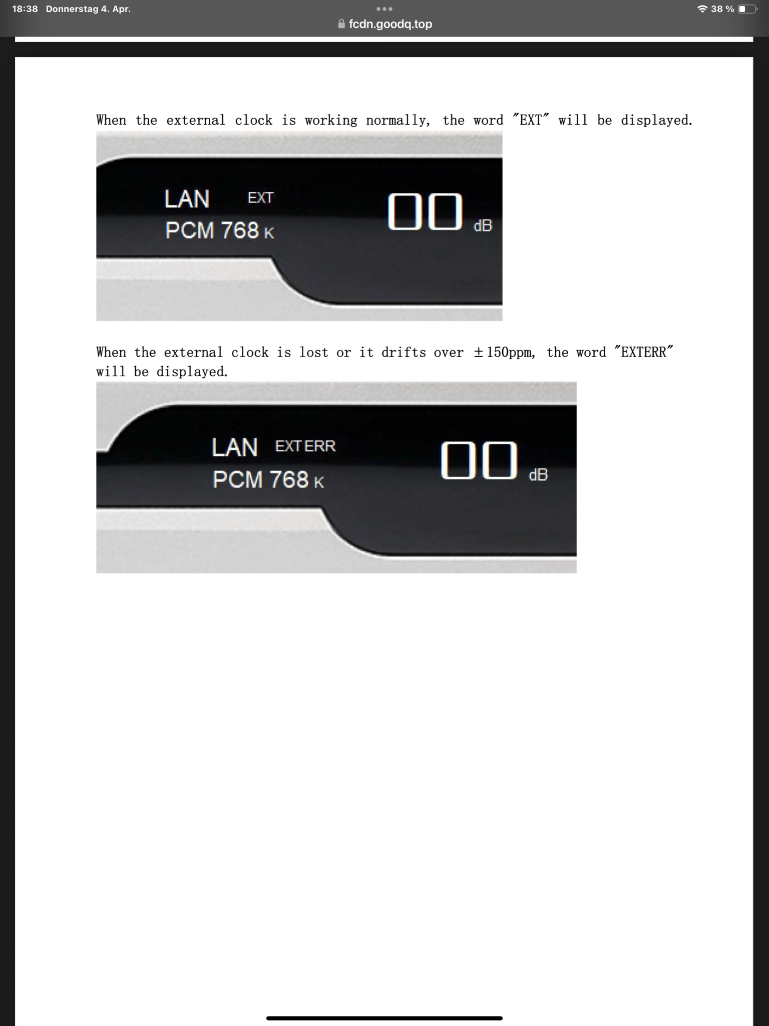

Hello I have a problem with the issue of 44,1khz about qubuz mconnect upnp. There's no tone.
Everything over 44.1khz is perfect.
It runs perfectly over Aiplay.
The display of the Gustard R26 is on.
See screenshot .

@LongLong00 you need to enable 16 to 32 bit conversion in order R26 to accept the input. Please see FIFO Pi Q7 manual page 10. I've been through that with exactly the same equipment.
Thank you so much, now it's going.

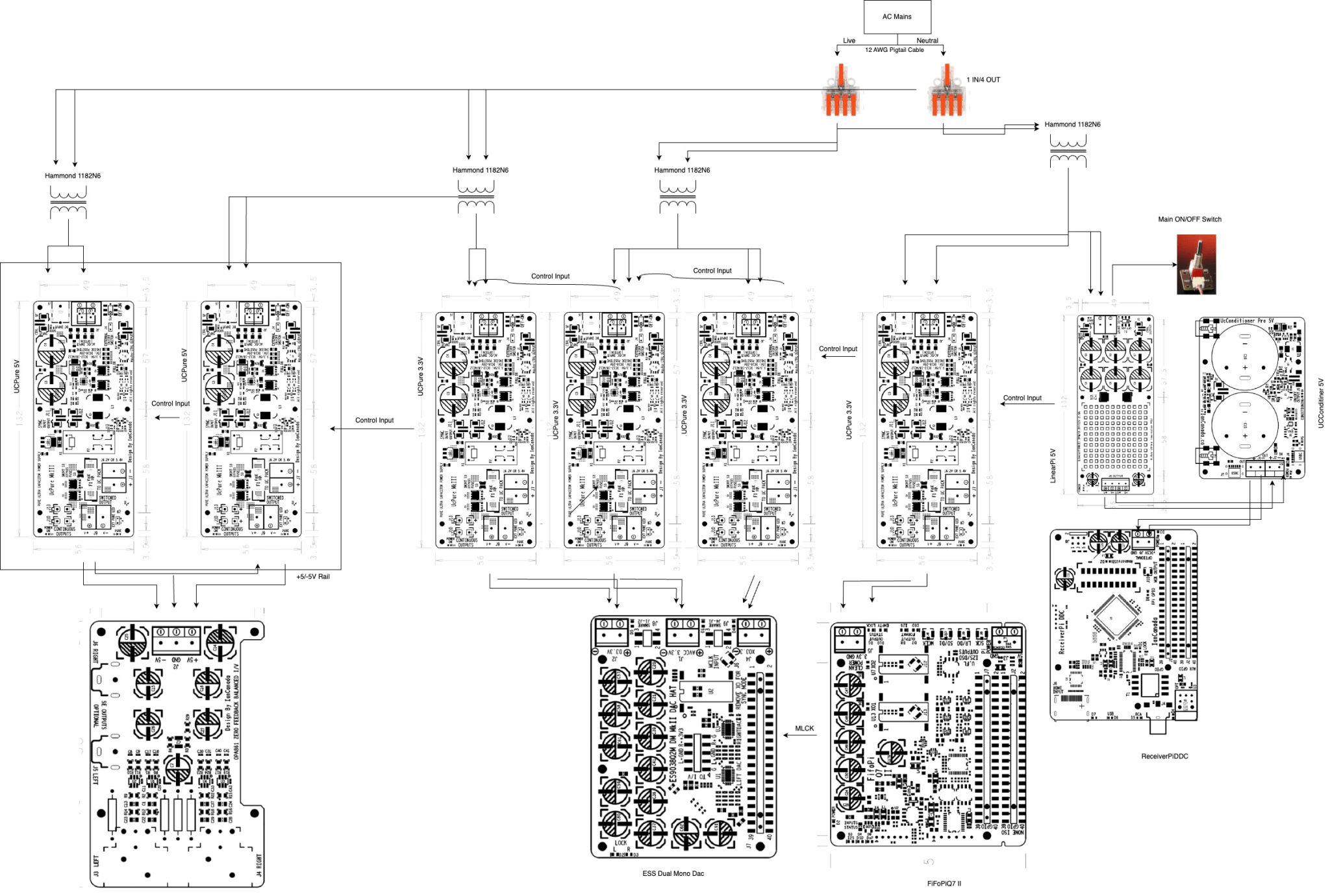

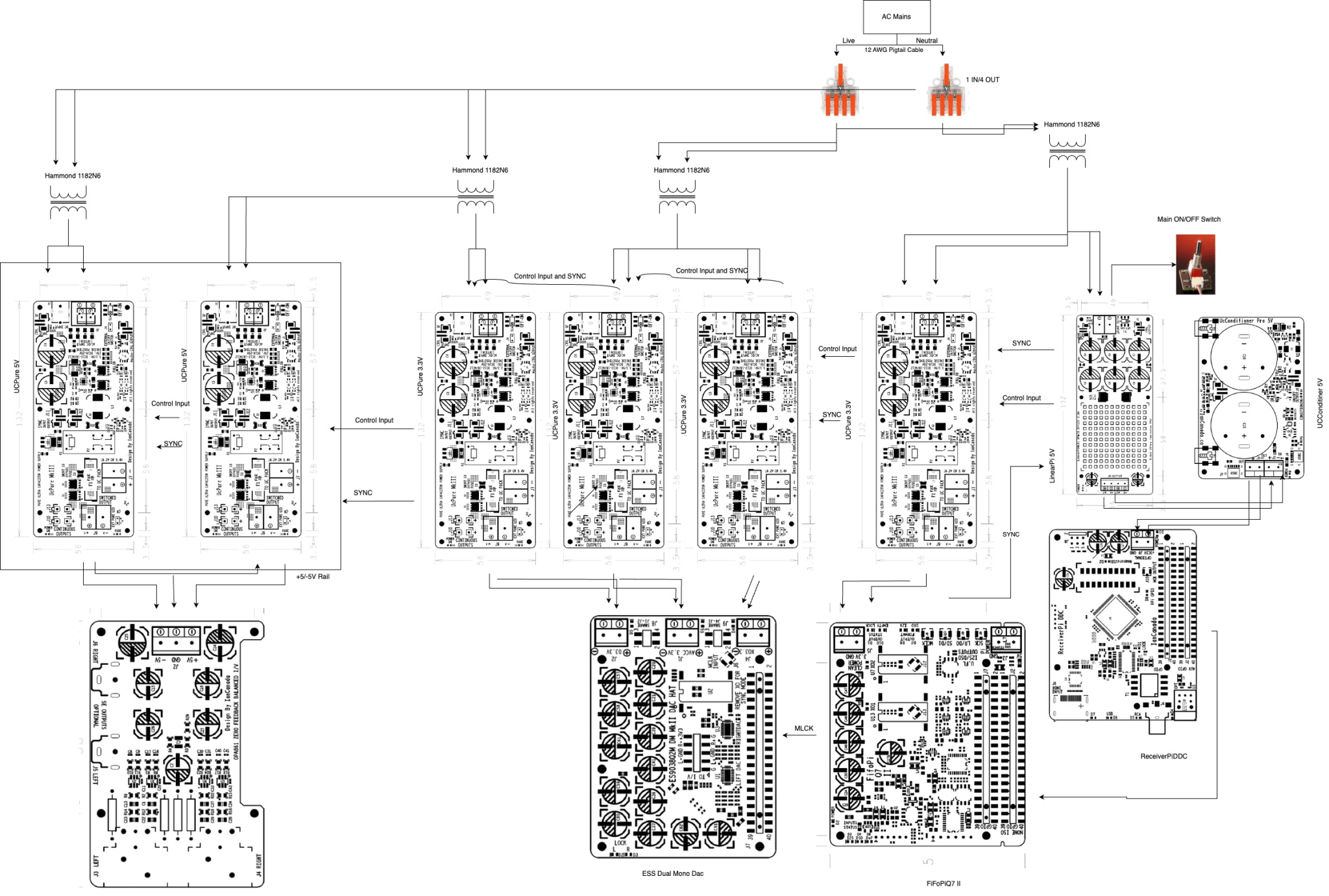

Hi Guys,
I'm thinking of building a full stack ESS Dac. Here is the design I came up with. Wanted to verify if this setup would work or are there other considerations that is needed for adding 4 input transformers?
@NeoTheOne you don’t need a 3.3 vdc on the XO J4 on the DAC, if you remove crystal and connect the MLCK from the FIFO.
@NeoTheOne and i’m running the OPA861 on 2 lifepo mini 3.3vdc and the DAC on 2 shunt reg from Tentlabs with 2 7vdc PS from diyinhk, the FIFO is supplied from Purepi.
It looks like you may be sharing the transformer secondaries between multiple UcPures. Each of these needs a separate secondary coil, as does the Linear Pi.Hi Guys,
@Jaytor IIUC, according to the images in the project page these transformers seem to have independent dual secondaries?It looks like you may be sharing the transformer secondaries between multiple UcPures. Each of these needs a separate secondary coil, as does the Linear Pi.
Also the transformer used by @Gabster 2000 in his videos [1][2] seem to suggest that those transformers can also be used in dual secondary configuration?
@NeoTheOne - That may work, but the specs on this transformer indicate that all windings should be engaged. With the UcPure, there is no current draw from the secondary most of the time, so you will likely have situations where the current draw from the secondaries is significantly unbalanced.
But since Gabby (sp?) got away with it, you should be ok. This might result in more than typical mechanical hum/vibration though. Are you planning to mount the transformers in a separate enclosure?
EDIT: I see that Gabby used a different transformer, although the Triad transformer specs also indicate that the secondaries are not designed to be used independently. It seems that other builders have gotten away with using them to drive UcPure supplies though. I think the most likely risk is increased heat and vibration, but I'm not much of an expert on transformers.
Eventually yes. But for now I'll separate them on different wooden board and use something like these brackets to cover the transformers.Are you planning to mount the transformers in a separate enclosure?
Looks absolute correct 🙂 No sync to add to linearPi though. It is always “on”. I would assume you would also use the LinearPi to feed the dirty side of Q7?
Personally I wouldn’t add 3 x UcPure to the DAC.
I did feed my es9038 mk2 with three separate 3,3v rails from a LifeP04. I didn’t have noticeable that much of improvements, but that just me. The UcPure is also a better supply so maybe more to gain…
