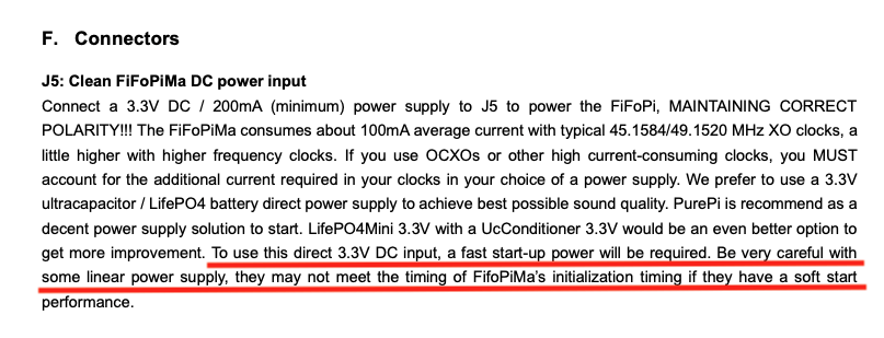

I read that part as well. I'm going to try it first with two 5V UcPure connected to the dirty and clean side of the StaionPi just to get it working. That's been reported to work just fine as long as you use the switch controls.
After that I'll use one UcPure connected to the dirty side of the StaionPi and share it with the clean side. Then I'll power the DAC and clean side of the FiFoPi with their own 3.3V UcPure supplies. We'll see what happens
