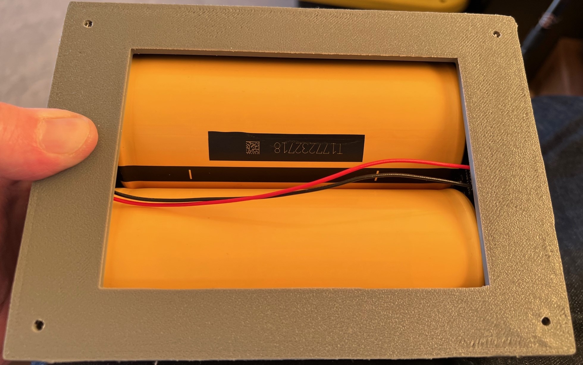

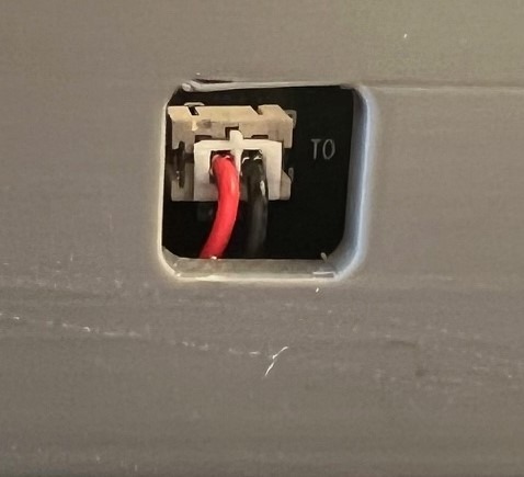

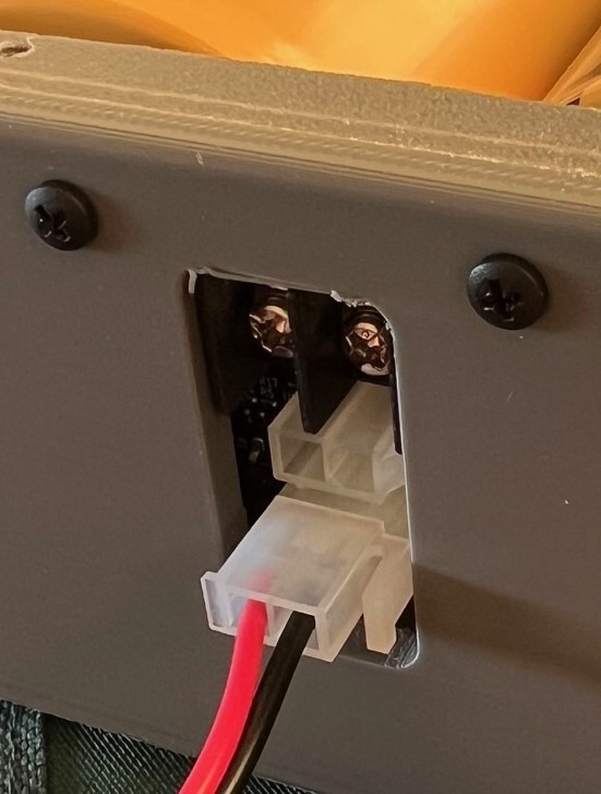

Everything fits, and I can easily connect and disconnect the connectors. There's room for the wires using the solder pads or the terminal block for J1.I am not sure by looking at the picture but I suspect one may have a problem putting a connector through this whole and even bigger disconnecting it. There is a "clip" you need to "squeeze" with a palm in order to disconnect.
