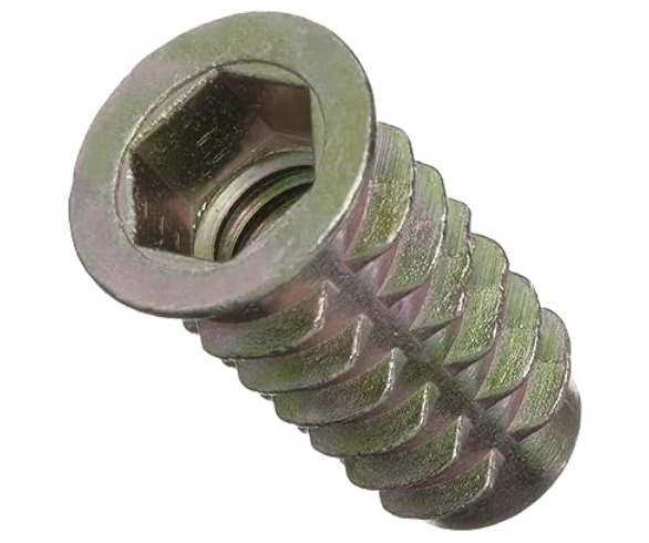

Don’t know by the Hammond transformer you put at your schematic, but many transformers are supplied with two pieces of rubber and a big washer for fastening.How to mount toroidal transformer on a wooden cutting board? I'm planning to start with wooden cutting board for my dac build to make things a little easy for me. But I'm not quite sure how to mount the toroidal transformers on the wooden cutting board. It seems there are a few mounting brackets available on aliexpress but wanted to check here first if there are some good solutions that already exist.
I want to make sure the transformers are secured on the cutting board.
Then bolt you transformer to the wooden board. Preferably with a non magnetic screw like brass.
How do you bolt that screw through the wood though? Drill a hole in the wood first (which tools would be needed)?Don’t know by the Hammond transformer you put at your schematic, but many transformers are supplied with two pieces of rubber and a big washer for fastening.
@NeoTheOne Standard drill bit for wood and I use these kind of insert (pick the size/thread required for your bolt:

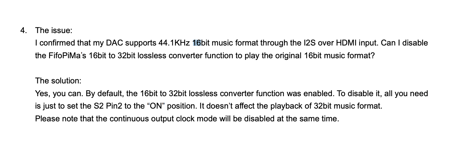

@iancanada, When powering the latest PurePi II via the USB-C port, MUST you use a PD capable charger, or can you simply supply +5 and GND to the port? IOW, does the newest PurePi II, use or rely on, any of the PD communications protocol of a suitable USB-C charger?
Have you tested with different resolution/bit depth as input to your streamer?@Spacejack everything is in my previous 2 posts.

In the FifoPi Ma manual i saw this. Maybe, 16 to 32 bit is enabled and needs disabling?@Spacejack everything is in my previous 2 posts.

Unfortunately yes, 16, 24, 32 bits and up to 192khz, step by step. Jumpers for DOP also tested. At home have AlloDigione and Pi2AES rev 1.2, and everything is working perfect... Thought that maybe I need to use 22/24 clocks ( in stock are 45/49khz) but nope, that's not this case. Tested as well. Also have accusilicon AS318 clocks and they don't work too. Led from signal lock on DAC is blinking, ones per 3-4 sec, but no sound at all. MonitorPi is showing proper resolution, ECT, all LEDs are lit on both boards ( from proper I2S signal ECT) also checked different UFL cables... (got 2 with Reclocker and AES transport)Have you tested with different resolution/bit depth as input to your streamer?
Reclocker + ProtoDac is also working properly (on both sets of clocks) cant test Transport without FifoPima so... Well. Don't have ideas what to test/change next 😉
Back to BASIC...Is there any differences in the way you connect these DACS? Cables or connectors?Issue: I have a signal and proper sound from Holo DAC, and AKM 4499 DAC, but no sound at all from my 2 different 1541 DACs, like MHDT Orchid.
Nope, totally nothing using the same BNC/Coax cables even. Just changed DACs in the same system.
