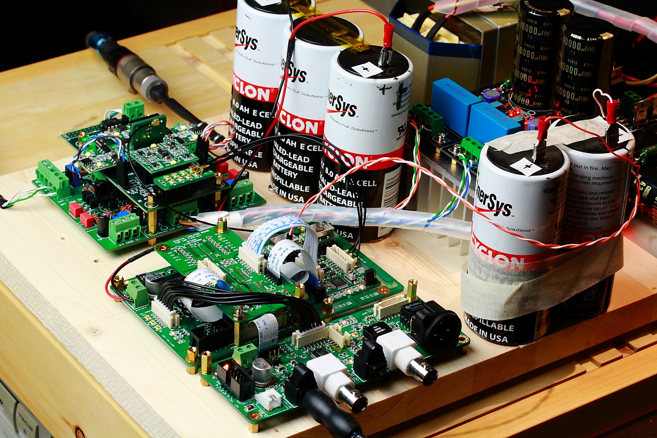

FIFO isolator board is working

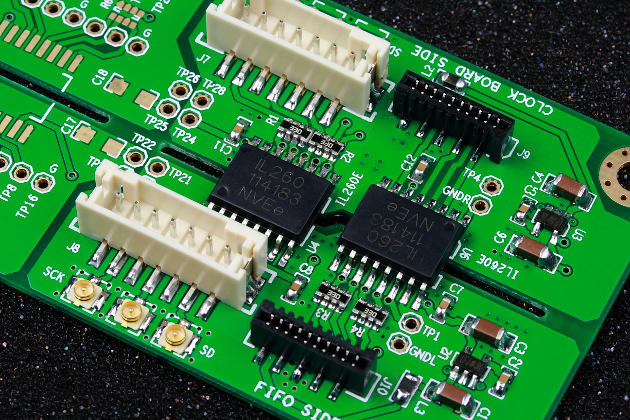

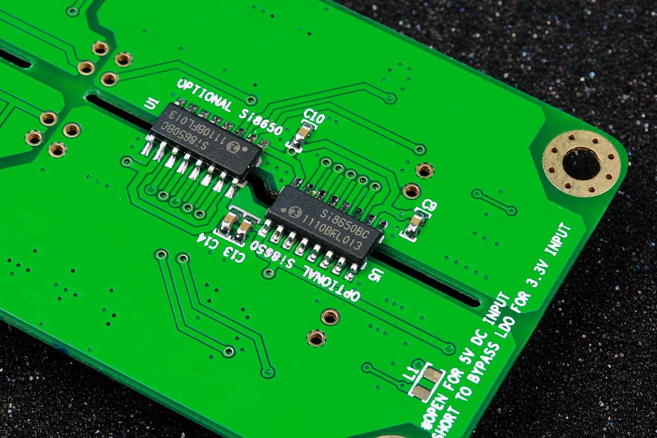

I assembled two isolator boards today. One uses IL260E, and the other uses Si8650BC. IL260 mounted on top of the PCB. Si8650 at the bottom.

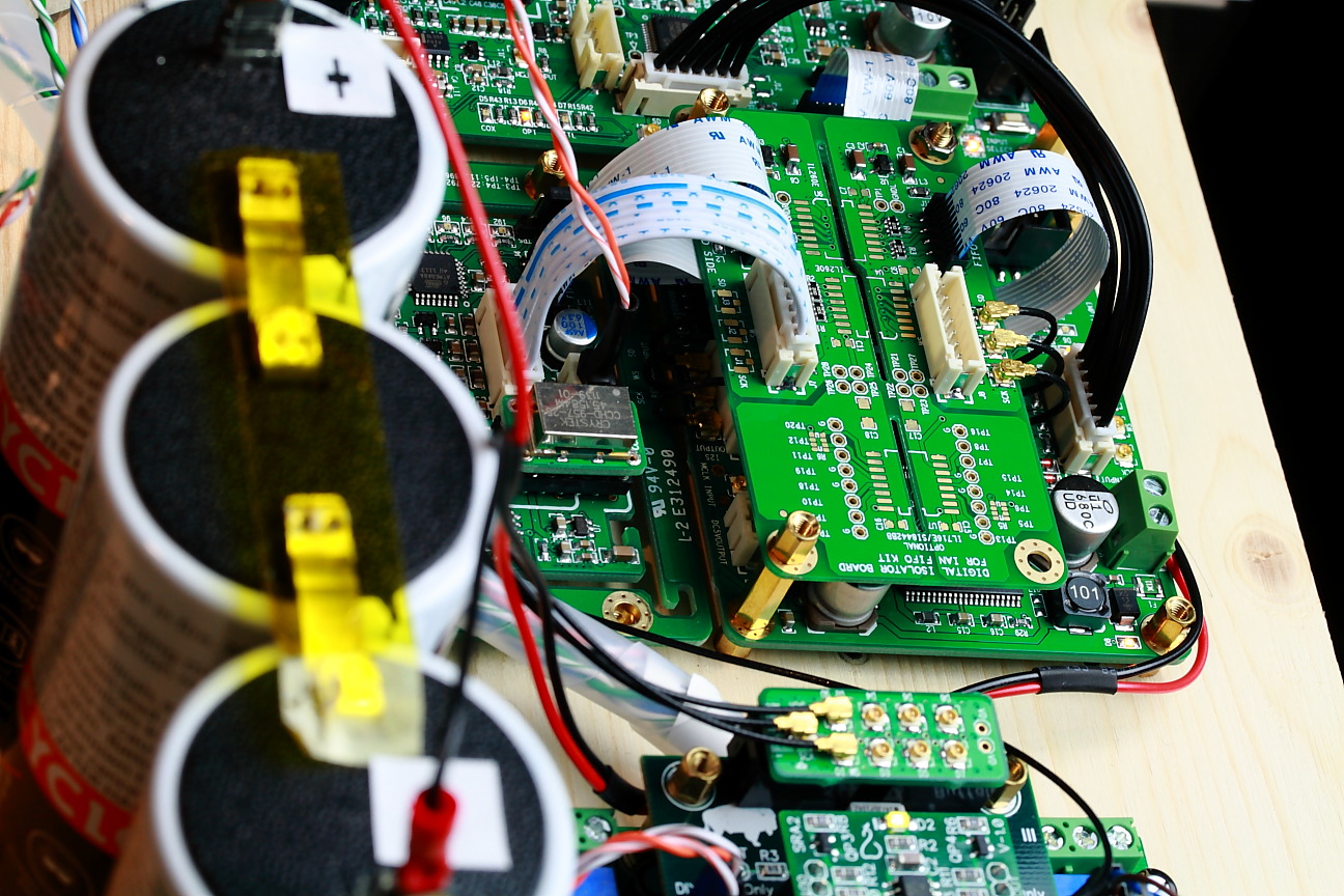

I stack the isolator board on top of the FIFO board just as I posted. One 6”FFC/FPC cable and three 4” u.fl cables connected to the isolator board from FIFO side. Clock board side was as same as the old connections between FIFO and clock board.
Two independent battery packs were employed powering the dual xo clock board and the FIFO board from both side. There was no any galvanic connection in between. Clock board belongs to the DAC 100% now.
They started running right away on my BIII ESS9018 DAC with SYNC configuration. 32 bit Loop test passed without any problem. Bit perfect confirmed. It sounds wonderful. All results are positive. But I don’t want talking too much about that. I’ll leave this part to the testing group.
I did some comparing between IL260E and Si8650BC. No significant in difference. But it feels like Si8650BC a little little bit better, very tiny. I know it was most probably my psychological factors. However I noticed that 8650 comes with higher speed (150 MHz) and less propagation delay.

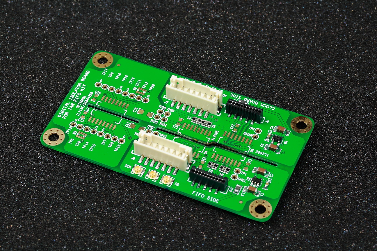

This small isolator board makes it possible that powering the clock board with independent low noise battery based power supply, while the FIFO board just from a normal regulated power. It would be much easier having a supper low noise PUS just for a small section of circuit. Longer battery life and less EMI noise from other section.
Next step, I’ll test the passive battery management board together with this isolator board to see if there is any possible achieving higher audio performance.

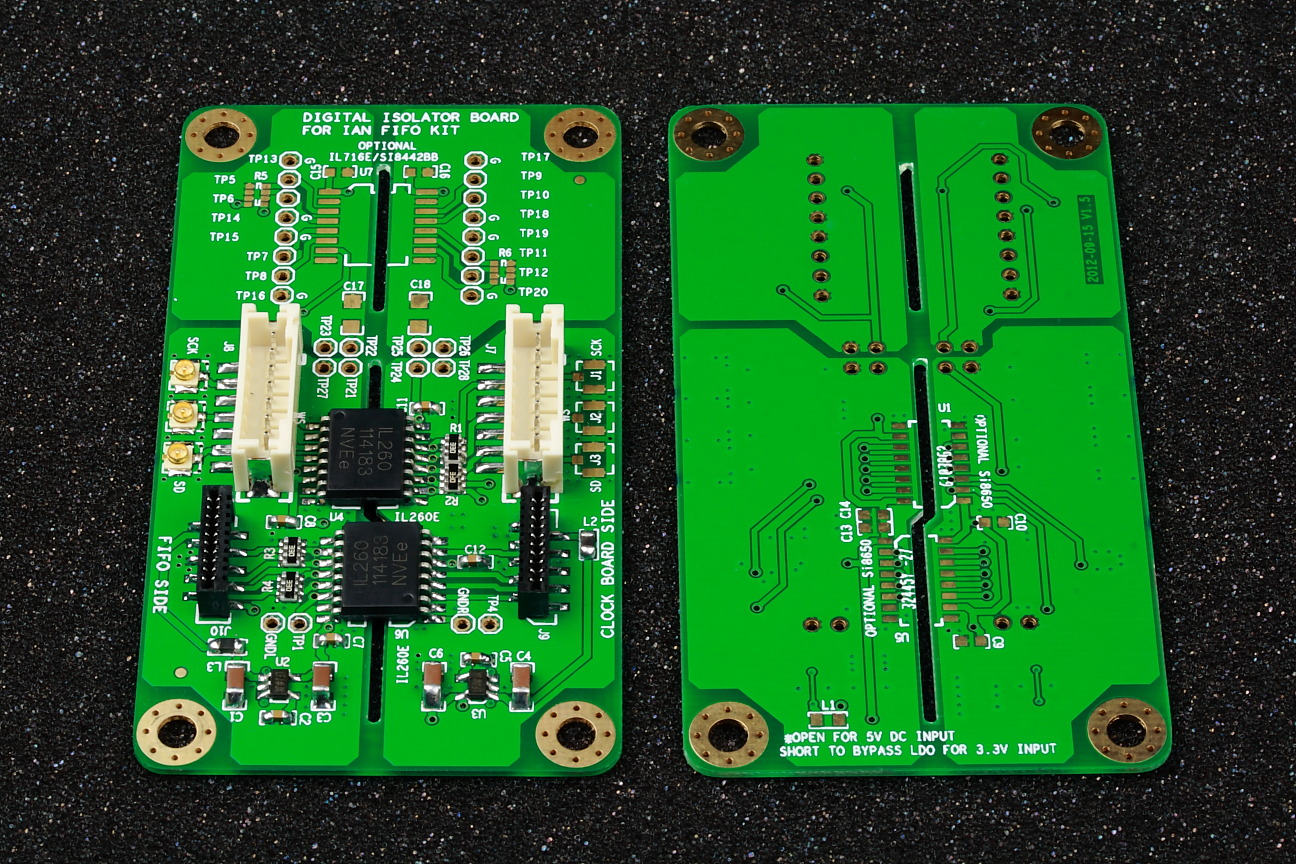

Please refer the pictures and picture names below for more details.
Since the isolation board is confirmed functional, I’ll send them to the testing group for evaluation on this weekend. 6" FCC cable and resistor packs will be included.
