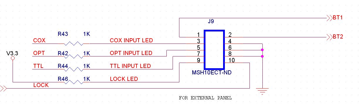

Ian, I am finally getting to the case work. Regarding the LEDs to indicate "locked" and the source selected (TTL, Coax, Optical), can the board power 20mA LEDs, or should they be low current types (i.e., 2mA)?
Thanks,
George
why would you want a 20ma LED in a low noise environment? I presume its blue or white too? these are the highest noise too. very doubtful it would run it, not many receiver/logic chips have power for 100mA in LEDs...
the noise isnt a huge deal, but it all adds up, just seems unnecessary. do you know how annoying blue LEDs that bright are?
Thanks qusp,
The current limitation resistor on the s/pdif board is 1K for each LED. So, theoretically the current limitation would be 3.3mA. Roughly, if your LED is 2V, the working current will be 1.3mA :). Small enough? Recommend high light version LED with color other than the white and blue.
Ian
