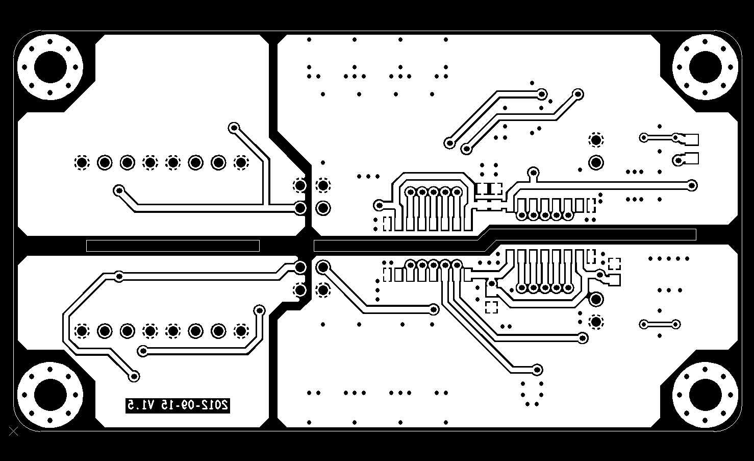

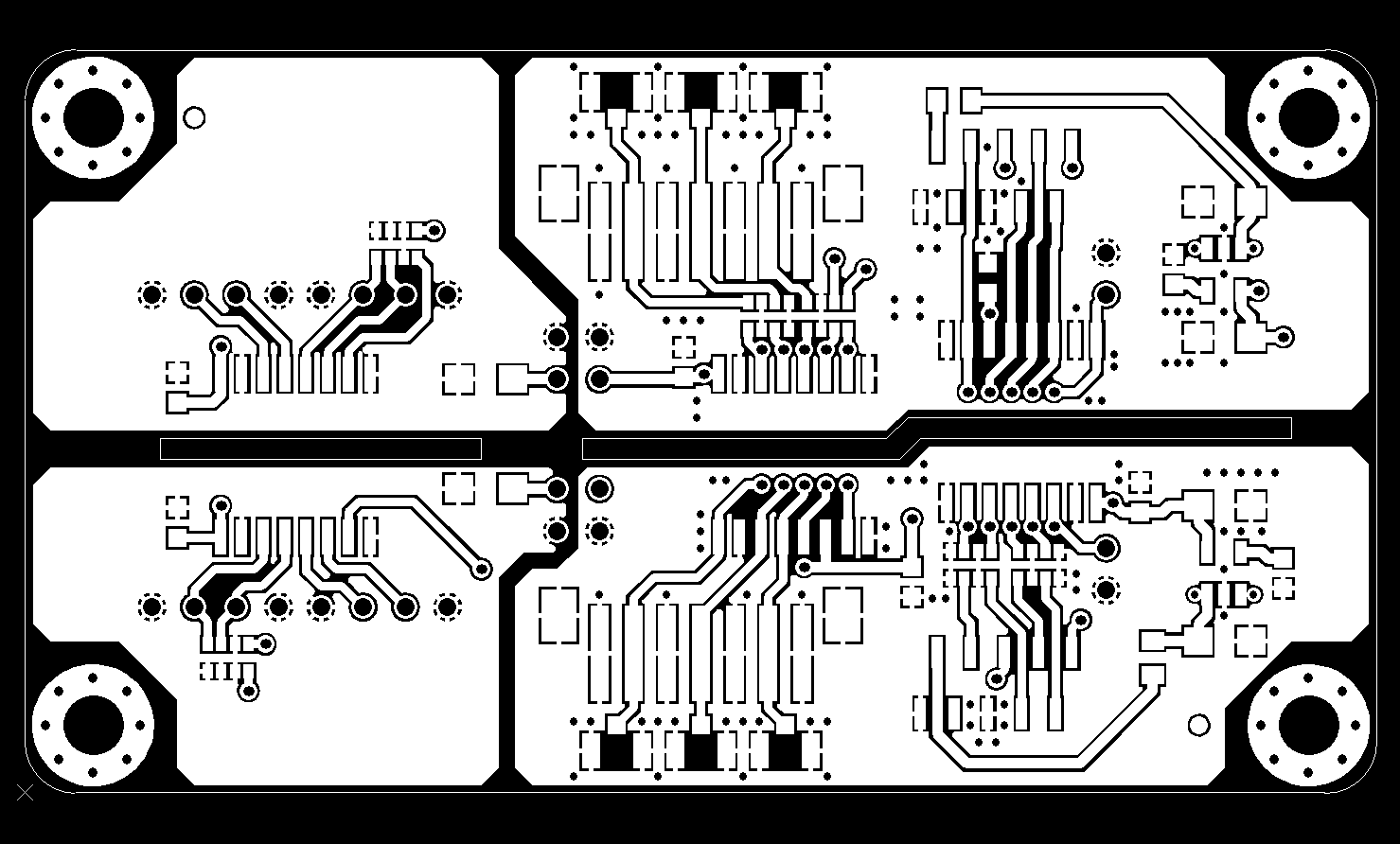

Digital isolator board PCB revised to V1.5
Another bug fixed. I placed a optional universal isolator at the empty space, but I forgot isolating the ground plates. The PCB design was revised for this issue. Now it becomes V1.5.

Ian,
How are the isolators powered? Having independent supplies on FIFO and Clock board is easy as they both have independent power connectors. The FIFO board has a second power connector which can be used to power one side of the isolator board. Where would you tap the power from the clock board?
For application bridging the FIFO and the clock board, isolators will be powered by the FPC/FCC cables from both side. You don't need power the isolator with additional connectors, you just need power the FIFO and clock board with different PSU 🙂.
