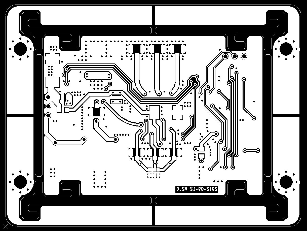

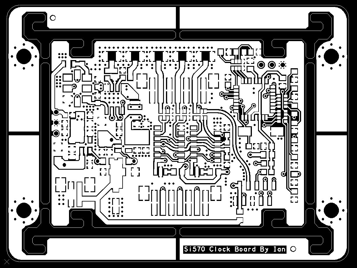

Revised Si570 based clock board PCB V2.0
Hi guys, good eye! PCB revised with route keepout. Please let me know for any suggestion. Thank you.

1. The hirose datasheet suggests removing ground plane from beneath the signal portion of the u.fl receptacle (see attached extract from hirose datasheet), it looks like your boards have the gnd continuing through this area? Is this a concern? I am far from knowledgable on these things just asking a honest question here.
The signalpart of the connector goes underneaath through that areato the central pin of the actualconnector, if the solder resist is a bit flakey it can short out. I would reccomend adding a keep out area to the actual footprint if your CAD package allows it, as it is one of those things you'll forget with this device otherwise, next time you use it! I know I have done in the past

The Si570 board progress looks very promising indeed! I have two questions though and I'm not sure if either or both have been covered previously.
2. Is it possible with the Si570 that the output stream may select a different *MCLK based on the input Fs?
Yes, it is. By taking the advantage of Si570, this board was specially designed with capability of output different MCLK frequency for a patiqular input Fs.
I have a DAC (ES9023) that I would like to use Fs*512 for Fs<=96kHz and Fs*256 for Fs>96kHz. Is this a possible configuration option via serial port? I will have either a microcontroller or an arm based linux board in the DAC enclosure so will be able to leave either of those permanently connected to the FIFO kit for 3rd party control if necessary.

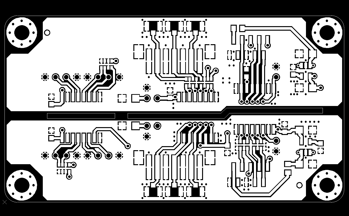

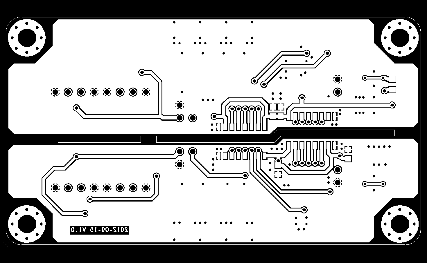

PCB layout of the FIFO digital isolator board
Except the isolators for bridging the FIFO and clock board, I placed a universal isolator at the empty space for some potential applications. That isolator chip could be IL715/IL716/IL717, or alternatives from Silicon Labs Si8440BB/Si8441BB/Si8442BB. The PUS could be independent from FIFO and clock on both sides by jumper settings.

Nice. For this application, the Silabs devices are best choice because of their much lower cost.
I designed isolator footprints for both NVE and SiLabs. You can use either of them on each position. Kind of backdoor again 🙂.
They come from different technologies. NVE has chip transformers, while SiLabs is based on CMOS capacitors. For FIFO application, only isolation performance will be important. Of course SiLabs is less expensive (at least from digikey 🙂 ).

Fortunately isolators from ADI have compatible pins and footprint, I think they could be use also on this PCB.

To isolating the DAC from front end ground is a good idea. Many high speed ADC or DAC did this way.
