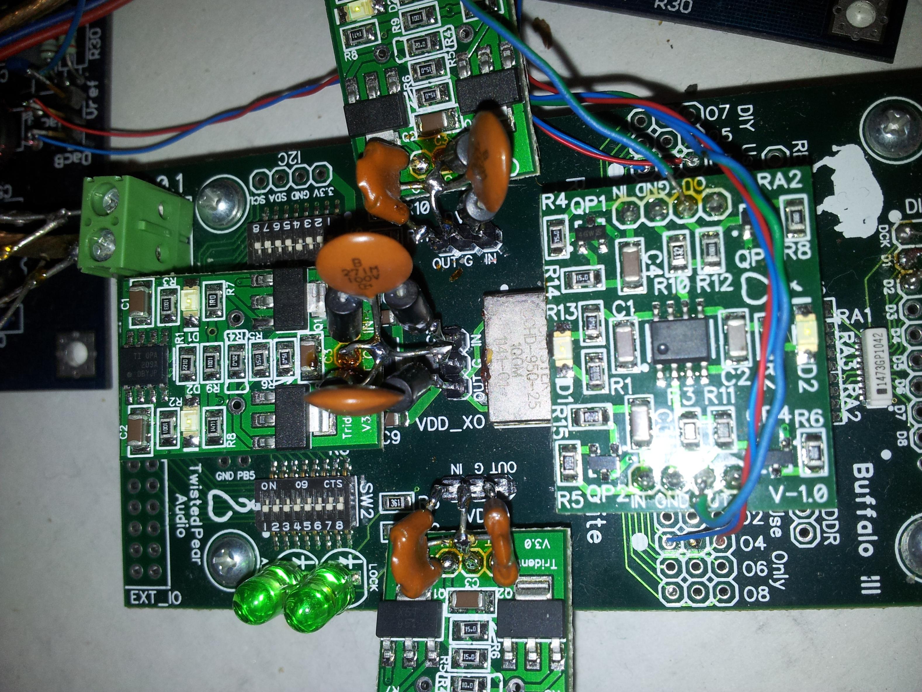

Sorry for off topic. But I did perfect tunning of Buffalo DACIII its tunning very, very, improves sound! This is related to a decrease electrical noise for ESS9018.I assembly on all in and out Trident Buffalo DACIII 18dB/oct Murata 100MHz filter.This reduces internal jitter ESS9018. Enjoy 🙂

you know this reduces jitter how?

at marce: you said it....particularly when there is murata LC network (SMD) that would have just soldered directly across the inputs… thats if it was something really worth doing. the above is quite a contrast to the 'MODs' of the thread subject. those filters look more like noise aerials (lightning rods) connected directly to the clock power supply and ground to me.....

I thought the board already has ferrites on all the supply lines. This has been standard feature in all the TPA boards since way back...

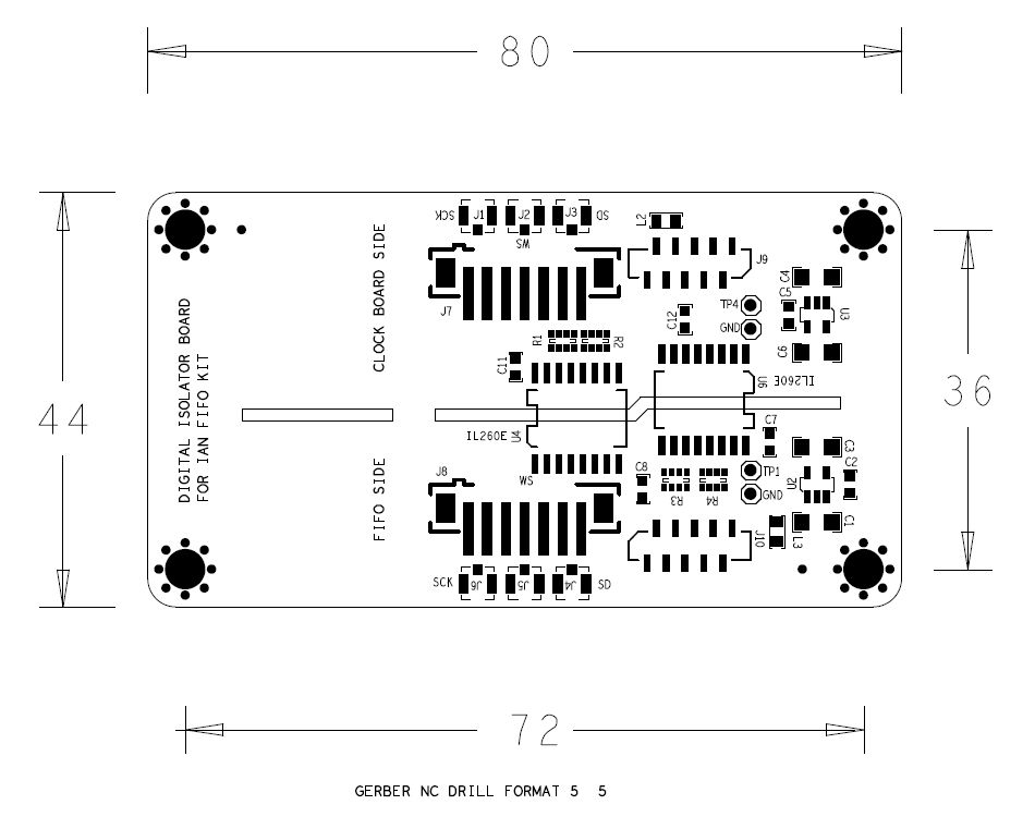

Digital isolator board for FIFO KIT
A small digital isolator board, providing 100% isolation between FIFO board and clock board. Making the clock board works as a local part of DAC with all EMI noise isolated from digital front end.
The Fmax could go up to 110MHz with IL260E or 150MHz with Si8650.
It can stack on top of the FIFO board, or to be the base of the clock board.

Ian
