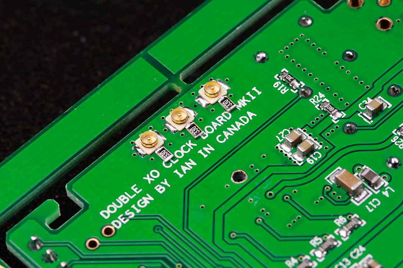

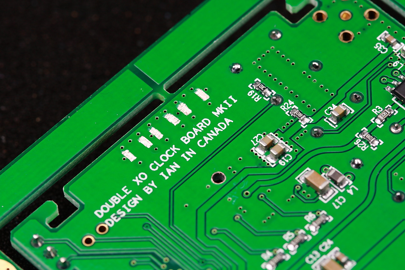

FIFO clock board solutions for dual mono configuration
Somebody ask me how to configure the FIFO and clock board to drive the ESS9018 at dual mono mode. I was not quite sure because I have only one BIII and couldn't confirm it by myself. According to my understanding, a dual mono setup is nothing special, just feeding the same I2S and MCLK signals into two BIII DACs with one set to left and the other to right. So, basically we only need duplicating the I2S and MCLK signals into the two DACs.
Since we already have two u.fl MCLK output sockets on the Dual XO Clock Board, so now there is no any barrier for the clock signals. To duplicate the I2S signals, I think there are two solutions:
1, We already have two I2S outputs on the Dual Xo Clock Board, one from the three u.fl sockets and other from the 7P PH2.0 connector. We can just simply connect them into the two 8018 DACs, everything will be fine. However if we consider similar u.fl cables into the two DACs would be better, the following solution will work for you.
2, Scratching 6 small areas corresponding to the u.fl sockets on green solder mask at the back of PCB, appearing the copper as the u.fl socket ground footprints. Assemble three SMT u.fl sockets with SMT solder station. Connecting I2S signals from the outputs of the flip-flop at top side by flying wires, please don't forget the three 33 ohm impedance matching resistors. Try to make those resistors as close to the FF output as possible. Then, we get two equal groups of u.fl I2S outputs for the dual mono DAC.

This is great Ian.
Any chance you will modify the dual XO clock board too for GBIII ?
