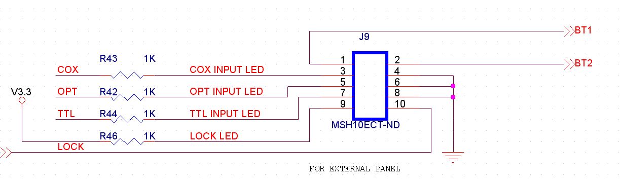

afaik most status LEDs and switching are available on the J9 output header
selecting button is pin 1-2
coax LED is 3 + 4 -
optical LED is 5+ 6-
TTL LED is 7+ 8-
spdif locked LED 9+ 10-
for using external button i'm not sure other than I know it can only cycle through the selections, no direct selection, so you would have to press to cycle just like the onboard, or program multiple presses for one press with arduino etc.

Ian, before I get my hands busy, a few questions if my understanding is correct. My configuration: Lightharmonic USB to I2S board, ES9012 DAC, FIFO board with S/PDIF board and dual clock.
1. If S/PDIF board is used, does using I2S signal from my USB board, is possible only through additional I2S input port on S/PDIF board?
2. My assumption is that DAC would work the best if used in synchronous mode with FIFO? My USB board also allows to be used as slave ( in master mode uses two clocks with automatic switching) Is it possible to send clock signals to both DAC and USB board? For slave mode I would need to send both clock signals? Or I would be better to leave USB board and just to sync DAC?
3. If I am to use front panel mounted input switching, do I replace your switch with any momentary switch? I need to allow for switching between two sources - S/PDIF and I2S from the board. I will not be sending any S/PDIF signal out.
4. What are the specs for LEDs or your board if I am to replace them with front panel mounted LEDs? I am thinking of taking off LEDs from the board and run wires to the front panel mounted LEDs for input markings.
5. Lastly, I am thinking of buying clocks in the following speeds for the dual clock board - 45.1584 MHz and 49.152 MHz, are these OK for ESS 9012? I am aware that FIFO board doesn't cover 384 KHz, but it goes up to 192KHz.
Here are few images of USB board and front panel board that already has switches and LEDs, that I would like to utilize. That board was preexisting and I am able to utilize it withs some modifications. That is explanation for questions No. 4.

Panel interface schematics just for reference.
