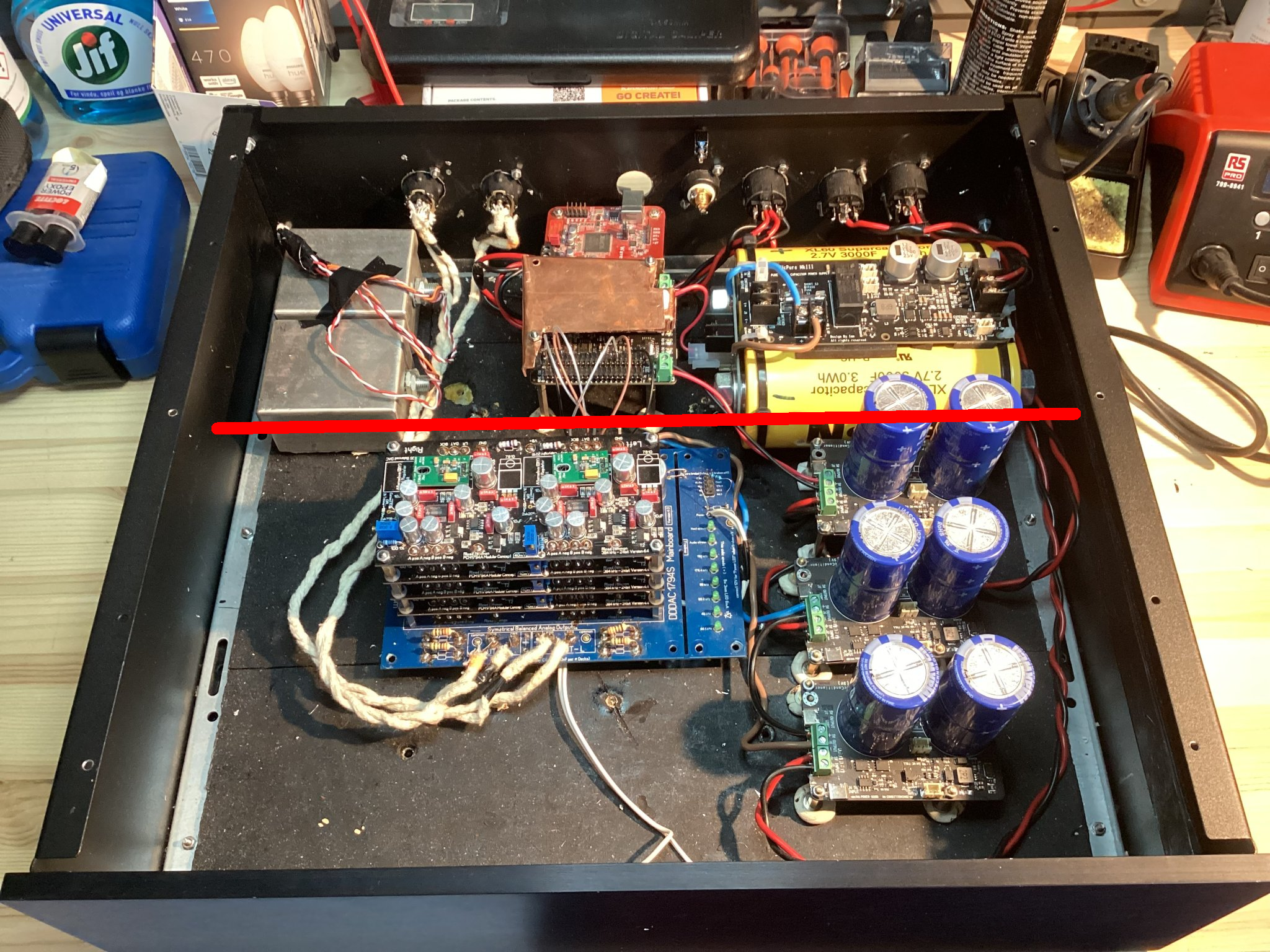

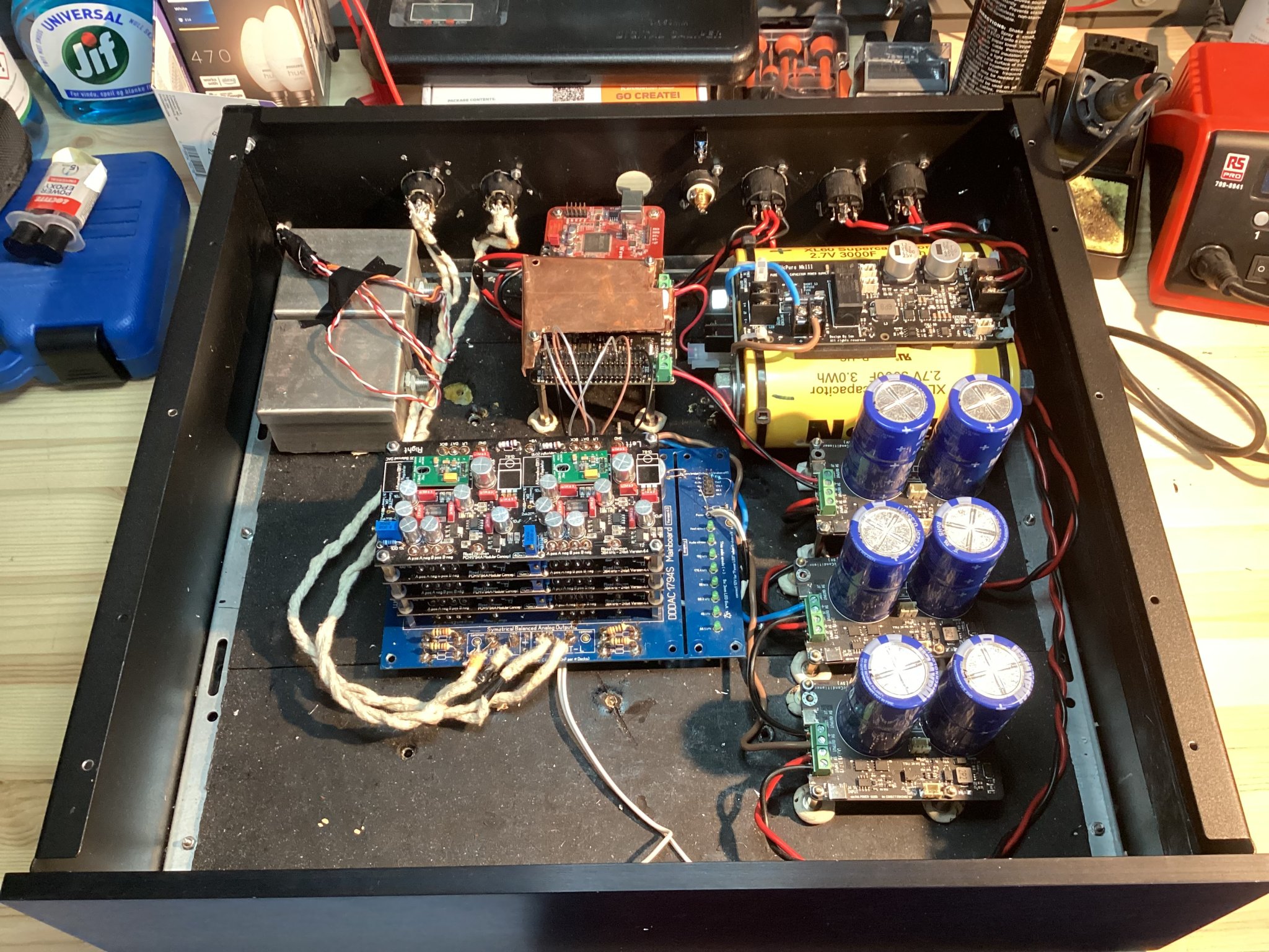

You might try putting a big, full height, 18-gauge steel plate across the inside of the case to seal off the dac from the RF coming from the RPi and the USB board. Maybe where the red line is below:
It depends though. I would have to hear the dac to say how far off it is.

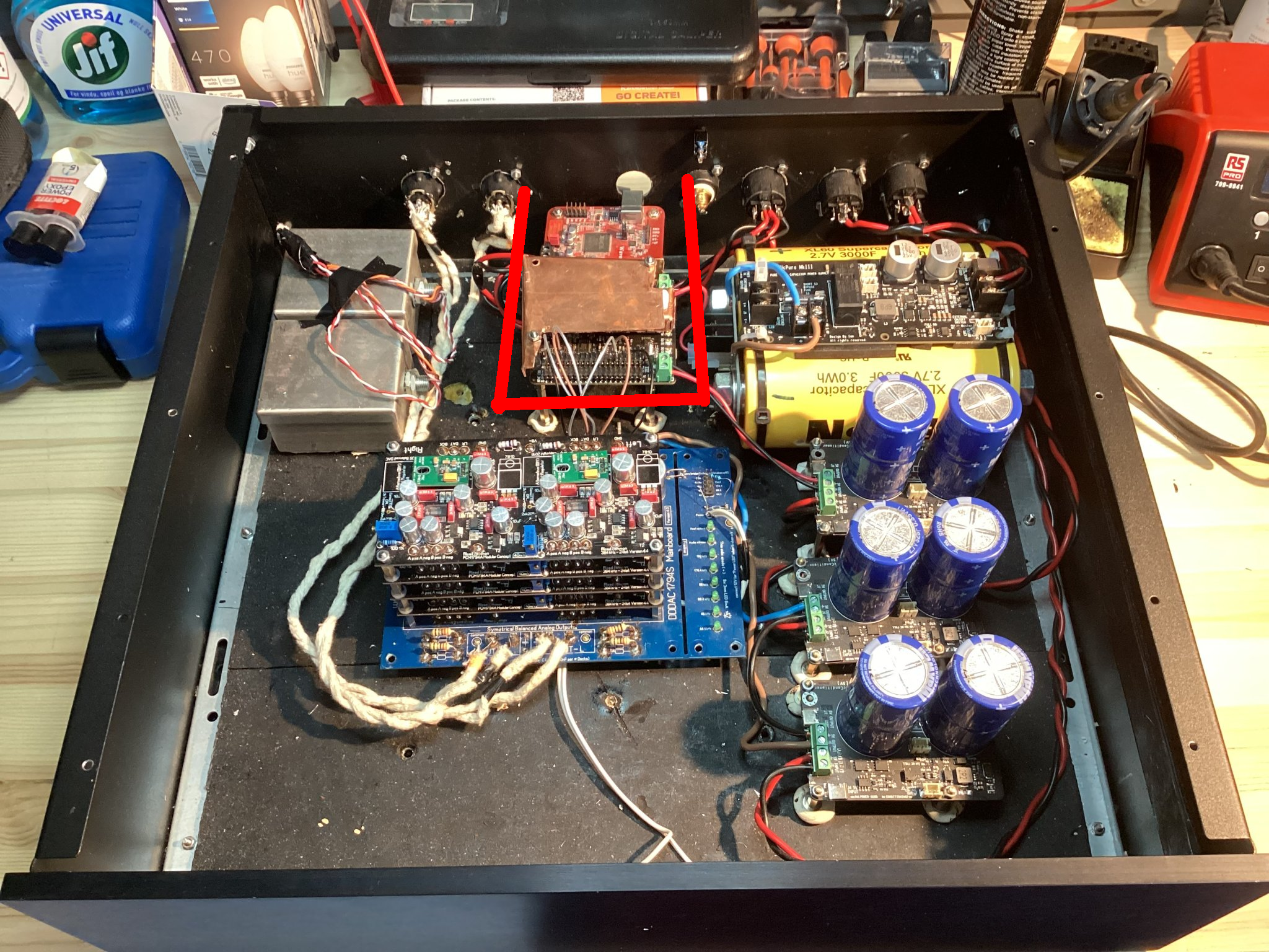

Maybe even better to put a steel divider or maybe a thick copper divider around the RF source area:
The difference between steel and thick-enough copper is that steel is lossy, and copper is reflective. With a box that close around some of the components I would probably rather see copper. It should be a few to several skin-depths thick at the lowest frequency of interest. The box should ideally not have any holes in it at all. In reality it will need some opening for wires to get in and out. Try to keep those openings to a minimum and consider they will form antennas. Make sure they don't radiate where you don't want RF going.
Also, don't know how you are clocking the dac. Hopefully the clocks are very close to the dac and you are sending a buffered copy of the master clocks to the RPI and USB stuff to keep the system synchronous.
In addition, I2S signals are definitely RF. Running single wires with one shared ground is asking for trouble.

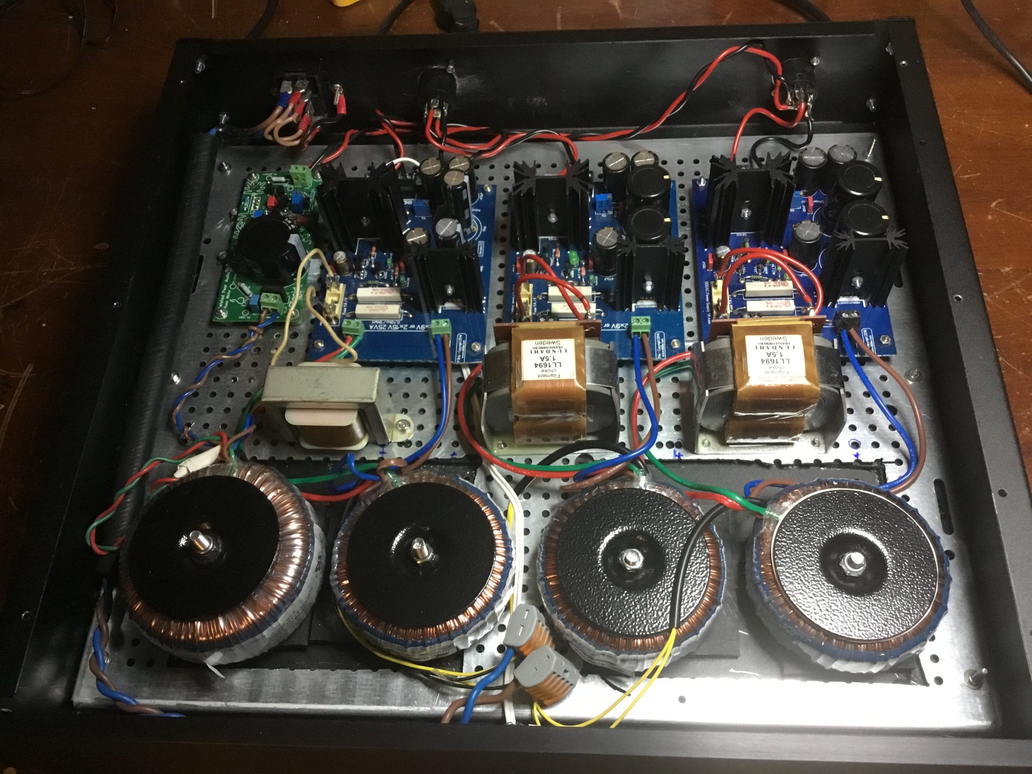

Hello, you could try twisting the ac wires coming from the transformers and letting them run towards the power supply boards on the right side. Now the choke is kind of surrounded by ac wires which is probably a bad idea.Main psu
All the power supply connections seem yo be rather long.
Of course you could also go for choke input, remove the 7810 regulators and not use the regulator at all.
Or just wait for the mk3 Dddac!!
When i am back home i will design a seperate box for the Raspberry and get it connected with hdmi. It seems to be the biggest offender in the box
Greetings Eduard
Thx Markw4.
There is no rpi in the dac. I use Aurender streamer. Every i2s wire have it’s own ground wire, and I have soldered all of them for maximum connection.
FifoPi Q7 with Ian’s new sc clocks works it’s magic under the copper shield. I think it is important that the hook up cables from UcPure and the supercaps boards are as short as possible.
I will buy new cabinets and place everything as optimal as possible, and also work on shielding.
