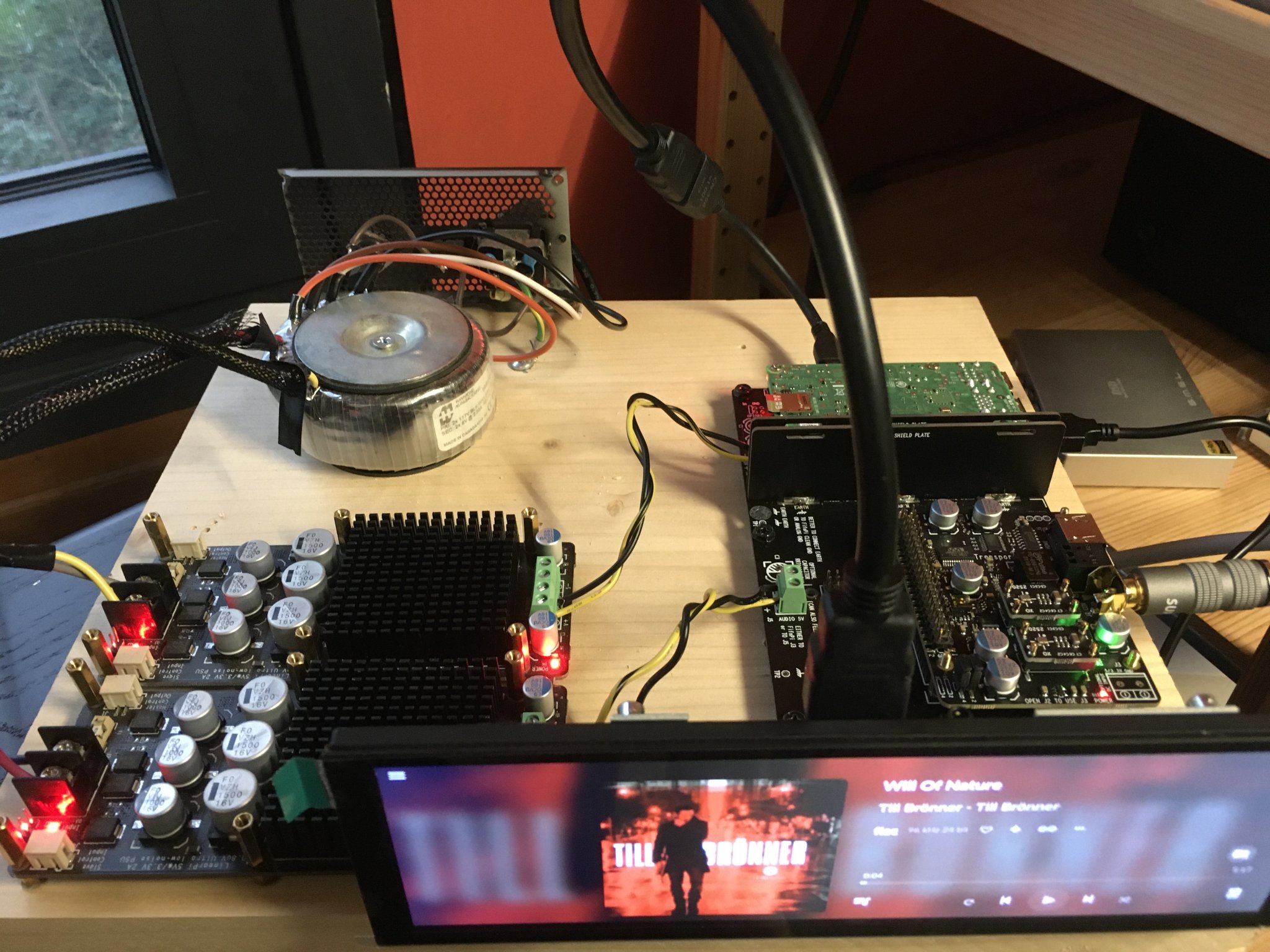

In the mean time, it's a plank with a touchscreen !
Good project
Congratulations!
What screen and software are you using?

The screen is a Waveshare 7.9" HDMI LCD, the viewing angles are atrocious but it was cheap. It's powered from the Pi USB. Software is the Touch Panel plug-in from GVolt included with Volumio ( use a mirror, the standard repo is broken), and configured as described on the Waveshare wiki. I do need a better solution for the HDMI cable.Good project
