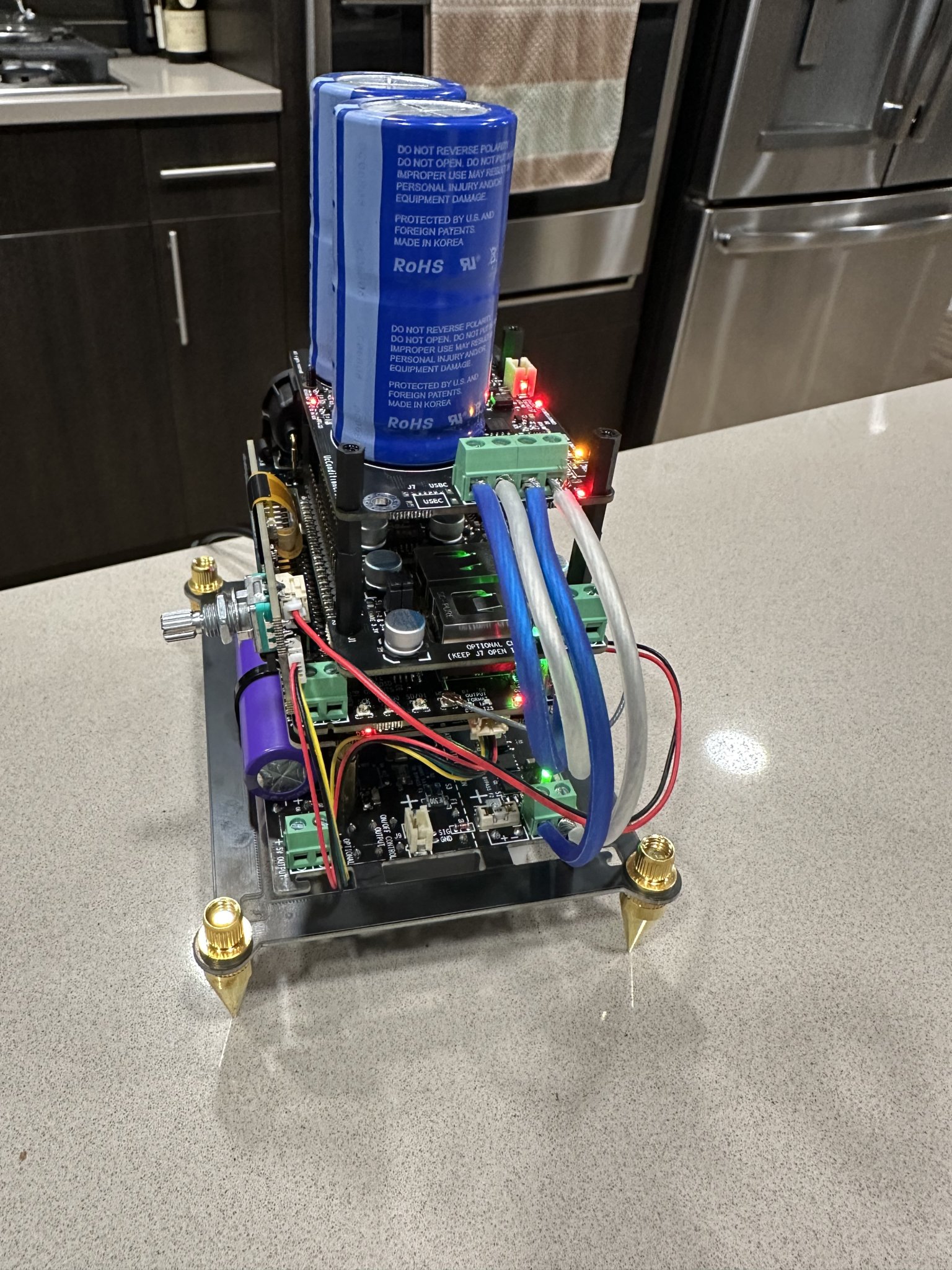

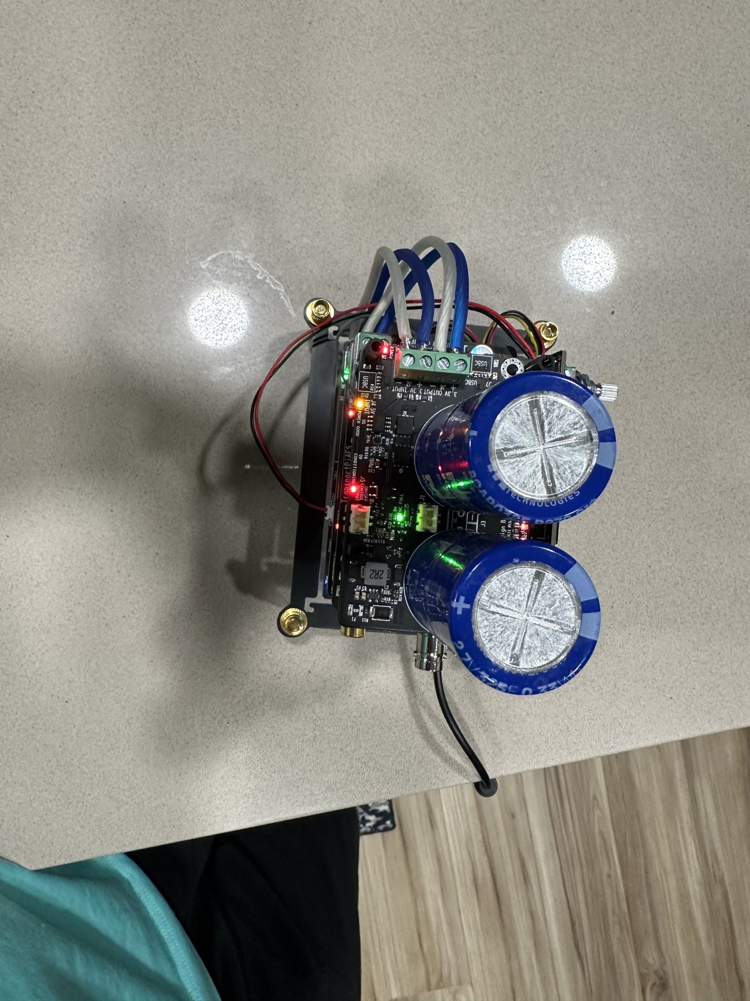

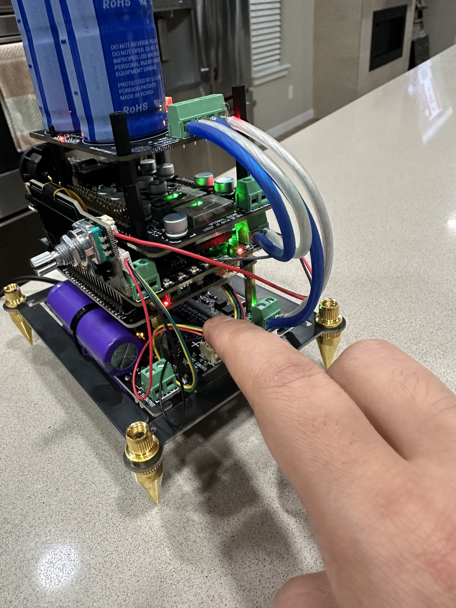

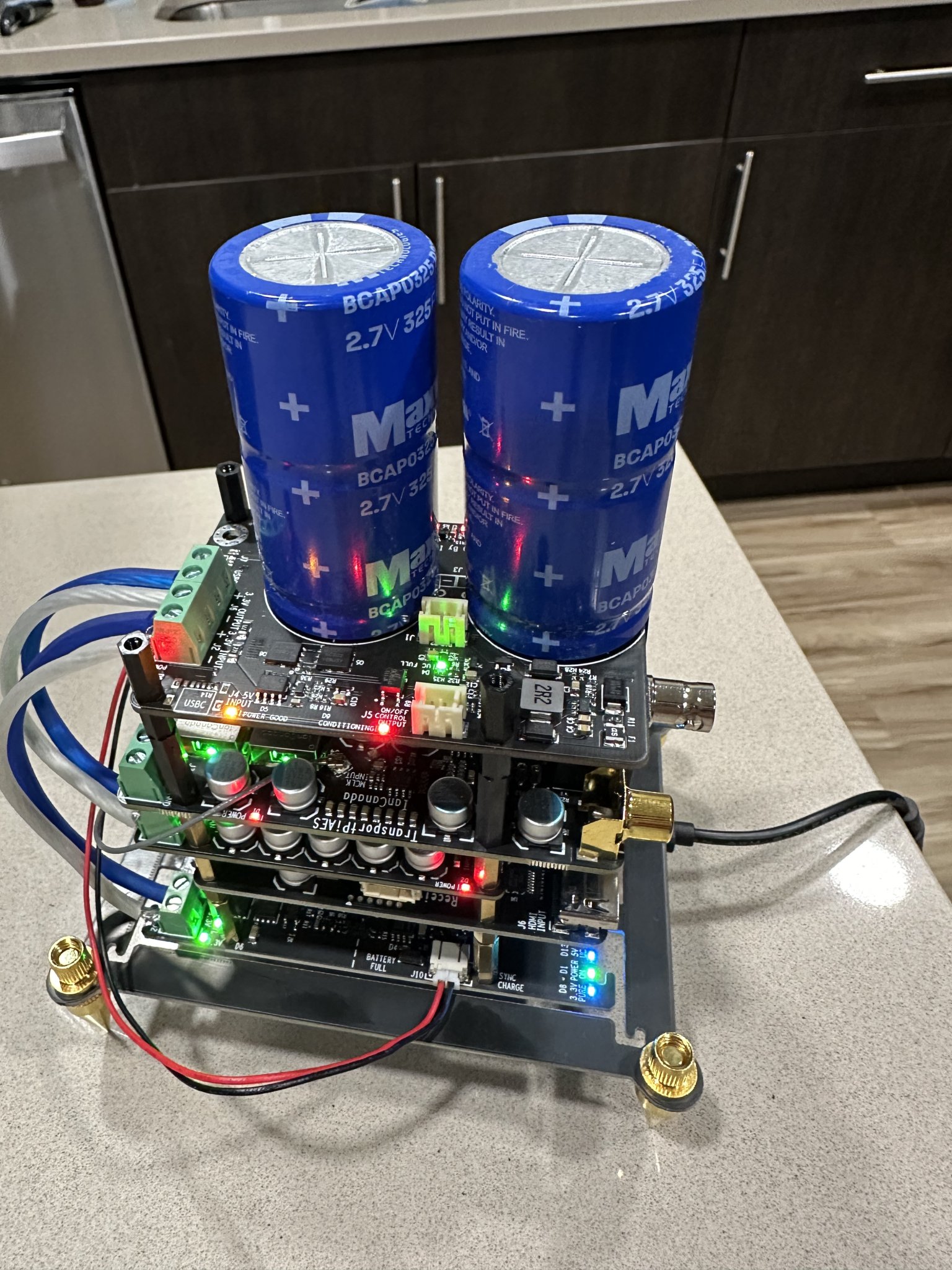

Not sure where to post this. I just recently bought an Ian Canada system including a PurePi II, Monitor Pro, ReceiverPI DDC, 9038Q2M Dual Mono II DAC, and FifoPI Q7. I built it following the Gabster D6 build except that I added the ReceiverPI. I finally got the system working and was listening to everything last night and it was wonderful. All of a sudden the sound changed alarmingly. There was huge amounts of static, the sound only came out of one speaker and you could barely hear the music underneath all of the noise. I did nothing to change anything. If anyone has any insights I would be most greatful. I am really upset about this build.
@theaddies
Please no worries, I'm here to help. Can you please send a picture of your system showing the configuration and connections, to me at iancanada.mail@gmail.com. Let me try to figure it out.
Ian
Ian
In case anyone is still interested, the conundrum is solved.Hello Ian, I’ve been fighting with this for a week now, and I am sorry to report it’s still not working. The clocks do light up now, and switch depending on the input, but there is no output from the optical (haven’t tried the coax) . Plugged into each other everything works fine. I think I’m going to abandon this and find another solution do connect everything.
The stationpi-transport combo does NOT work with the Pi 5. As soon as I replaced the 5 with a 4 everything worked. (note : it doesn't even work with point to point wiring)
I have a sneaky suspicion it has to do with the higher power demands of the 5, and the fact that if the system does not detect the new 5A power brick designed for the 56 on its USB-C input, the 5 switches to some sort of 'low power mode'. The 5 can be tricked into going full power regardles, but as I am using Ian's 2.5A linearPi's I didn't see the point.
Next stop is getting the Waveshare to work with Volumio.
Pete

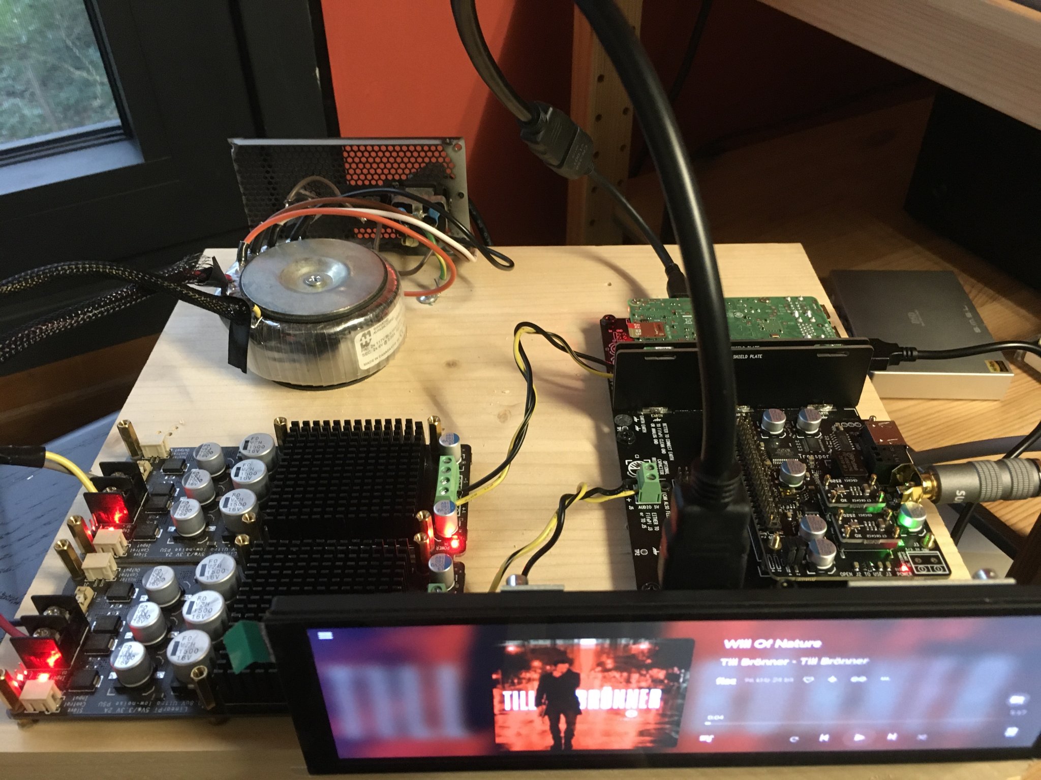

I think what the ecosystem needs is some kind of power distribution system for the pi and the modules. The use of the infernal USB-C plugs for HATs, PI's and associated devices in general does not make for an elegant solution in a HIFI like enclosure.
I don't generally like the enormous stacks of HATs.
I think I'm going to try and figure something out with the Station PI with a flatcable attached to the HAT side, and the HATs themselves in a separate section of the enclosure. I also need to find a way to elegantly break out the Pi USB, HDMI and so on to the rear of such an enclosure.
Furthermore I think that although power supplies are important, far too much community attention goes to ever bigger batteries, supercaps, more supercaps, supercaps with batteries, and so on.
In the mean time, it's a plank with a touchscreen !

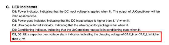

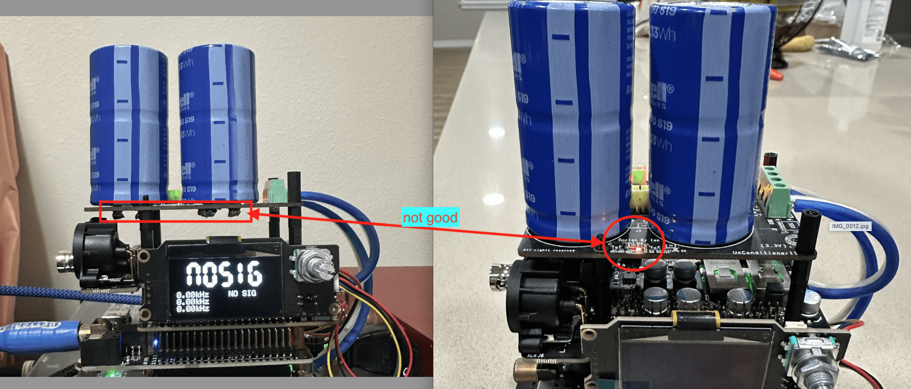

I don't know if anyone has already suggested this, you need to fix this.Hi Guys,
Need a bit of help. I assembled the DDC without RPi. But after powering on, the MonitorPiProII id not turning on. Any ideas what might be going wrong hereView attachment 1253418View attachment 1253419View attachment 1253420View attachment 1253421View attachment 1253422View attachment 1253424
is just a well-intentioned tip.
