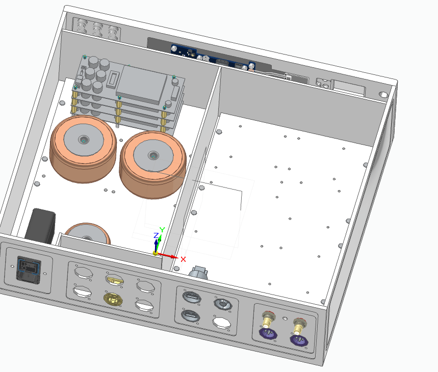

Hi first time poster. I’m at the electronics store trying to buy wire for this project’s streamer/DAC build power connections between boards as well as ground wire. I read a couple posts about 14 gauge solid core but I haven’t had any more time to research. Can anyone steer me in the right direction? Sorry for rookie question!
Hi , can you stack 4 Linear Pi power supplies on top of each other with a Gap of about 20mm, gap above each Power supply . need to do this for Space will it cause any Issues ??, I could put an aluminium shield between each one not sure it that would help, I have an image of what I want to do
Way too large wire, either 20 or 22 gauge solid is fine. Twist the hot and cold wires together.
Simply put, if you're serious about resulting SQ, you ought to put all toroids away from the digital circuits, to the separate enclosure altogether and dampen it properly.Hi , can you stack 4 Linear Pi power supplies on top of each other with a Gap of about 20mm, gap above each Power supply . need to do this for Space will it cause any Issues ??, I could put an aluminium shield between each one not sure it that would help, I have an image of what I want to do
