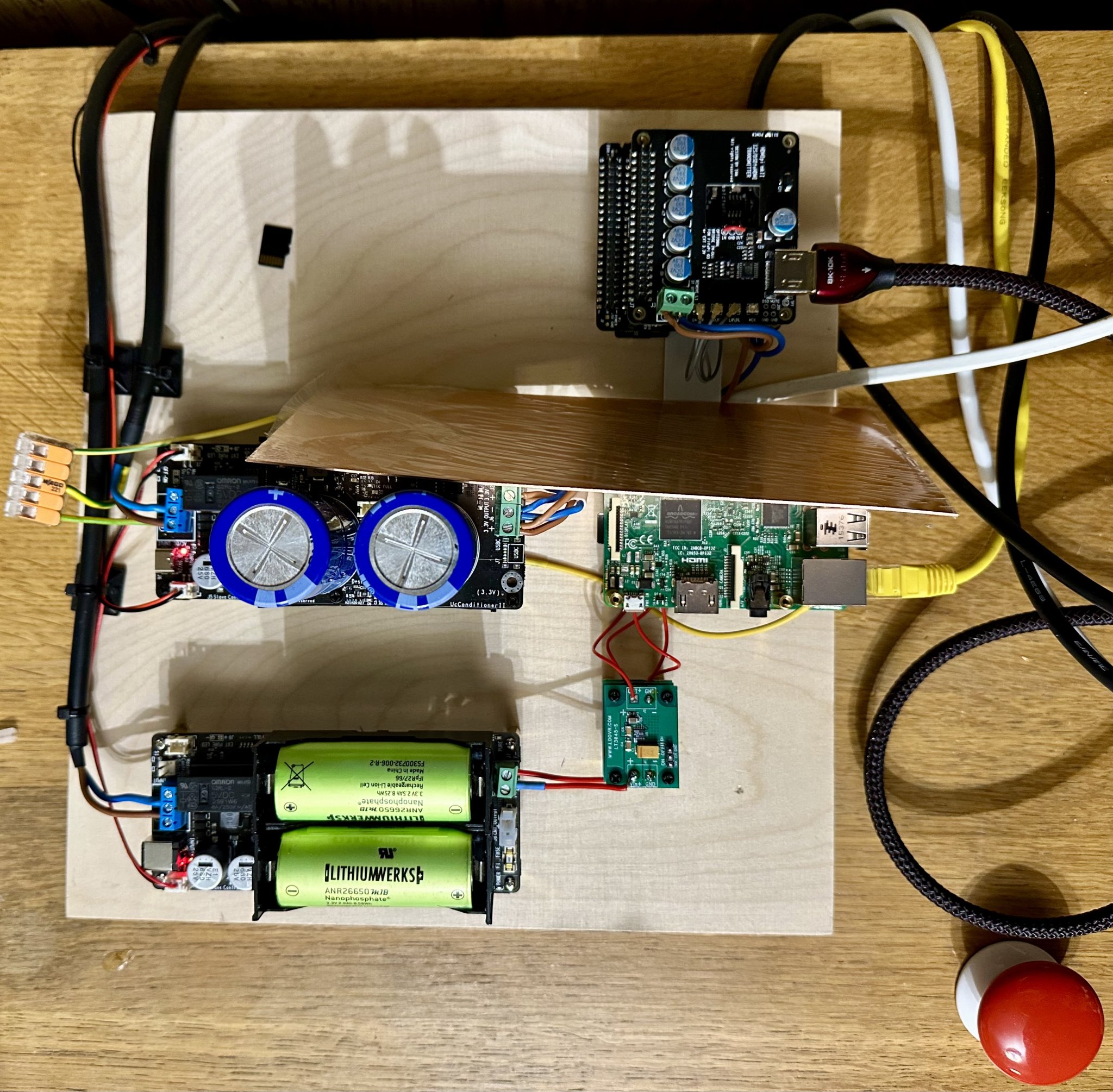

Nice build Spacejack, glad to hear you're able and willing to tweak it further.Hi,
I made three changes to my setup. Each of them led to improvements.
1. Moved the IsolatorPi II + HDMIpi MKII away from Rpi and installed a copper shield between them.
View attachment 1248028 View attachment 1248029

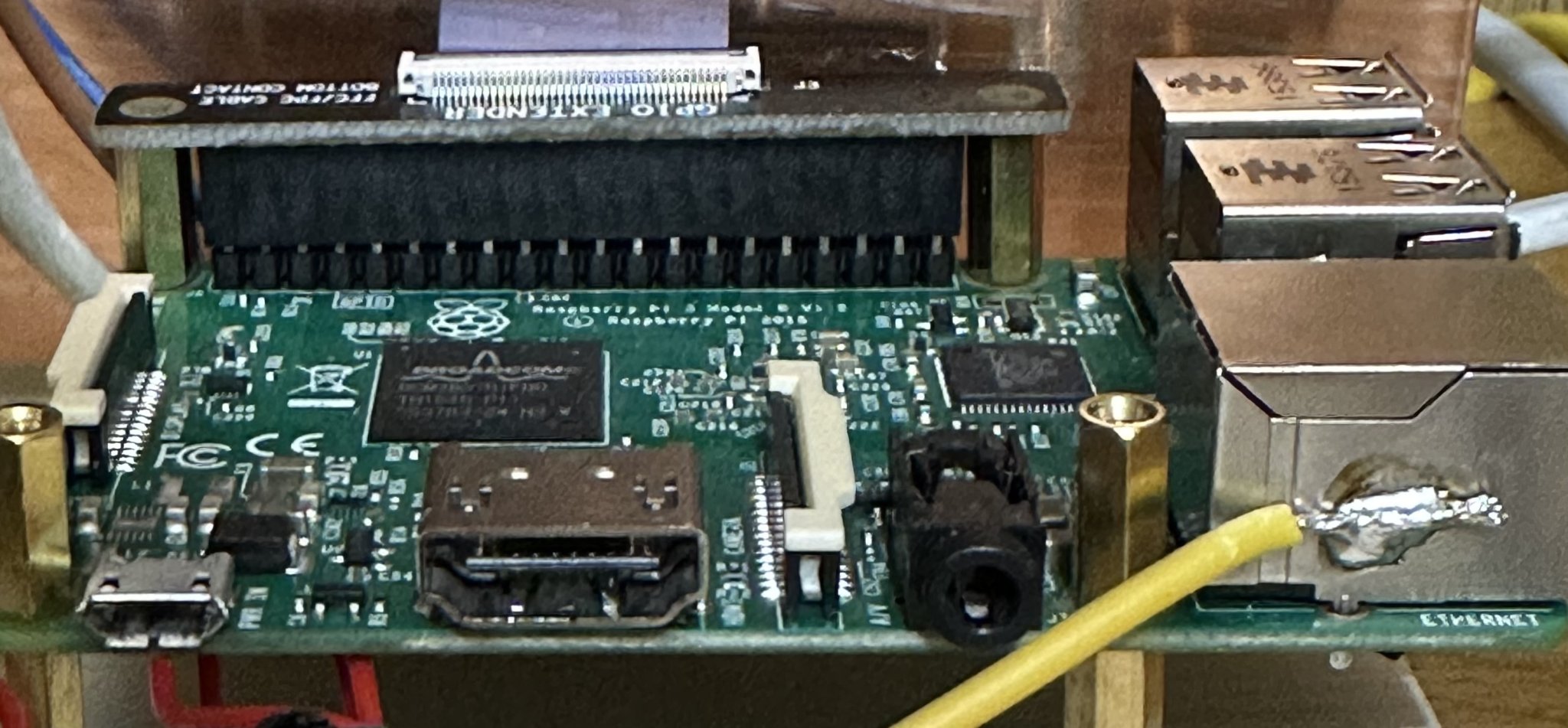

This was an educational experience. I connected the shield and Raspberry Pi ground to the ground cable, but I forgot to connect the cable to the actual ground in the socket. This has deteriorated the sound. Once I connected the ground cable to the ground, the sound improved. Moving Rpi away from the rest of the stack and/or shielding is worth the effort.
2. Added dumping to the ScPure clocks using Moongel as described in this post
https://www.diyaudio.com/community/...eapon-to-fight-the-jitter.192465/post-7479537
I have used one layer below and three layers on top of the clocks. This was a jaw-dropping experience. Just try it.
3. I saw advice from @badd99 (and others), that two separate UcPure power supplies for Q7 and Dac board provide improvement. This reminded me of a post I read about the noise that can spread from DVCC rail: https://www.diyaudio.com/community/threads/es9038q2m-board.314935/page-346#post-6512356. I did a test. Since the Dac board runs in True Sync mode, it can run without power supplied on the VCCA rail, so I removed the J9 jumpers. AVCC is the most critical power rail, so I left it running from UcPure 3.3v (shared with FifoPi Q7) but have connected the "noisy" DVCC to a separate LinearPi + UcConditioner 3,3v (after removing J8 jumpers). To me, this is an improvement in SQ.
Maybe the experience of the SQ getting by running FifoPi Q7 and Dual Mono Dac from two separate UcPure relates to eliminating the noise from DVCC rail influencing the operation of FifoPi/Clocks? At least it is easy and not expensive to try.

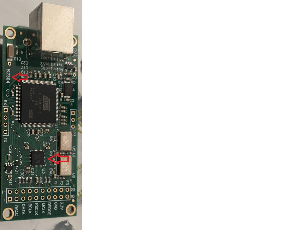

So after writing to Amanero support, I have received the information from Domenico that my version of Amanero CPLD - B2304 requires a version of the flashing tool that is unreleased (yet). He was kind to provide this version (update118new) and after flashing the Amanero with it I can play PCM 384 and DSD512 native from RPI/Moode.I have installed Amanero Combo384 (original) on the StationPI PRO, in order to test also the DDC function with my FIFOPI Q7 and HDMI PRO. I Have successfully tested it with the default firmware (PCM384 and DSD256 DoP) and then decided to flash it with CPLD_1081_SWAPPEDSD and firmware_2006be11.
After this the Amanero is recognized/detected by remote OS (tested it connected to the RPI/Moode and Roon Rock) and also I see the Native option in Roon. I have however no output and I have noticed that D1 led ("USB connected") does not lit up (to be honest I did not check if it was lit with the initial firmware). Tried to switch back to original firmware (according to Amanero CPLD_for_1080 and firmware DSD512x48x44), however now I have the same behavior - no sound and D1 not lit.
(all tests were done with J14 PIN7 and PIN8 shorted; leaving PIN7 and PIN8 open I can play from RPI without issues)
Any ideas?
Hope this helps others if they come across this until Amanero publishes the version that can flash both old and new CPLDs.
