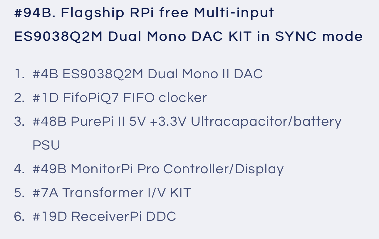

So not possible to add the Pi to this stack?If you want a DDC and DAC all-in-one solution, you can install a HdmiPiPro II or a TransportPi AES under the DAC PCB in the #94B configuration
As I understand from your website the 94B stack is best to add a Amenero board for my macbook usb in and a seperate Pi stack. Is a Pi + HDMIPi Pro II sufficient no other tweaks or add ons?
So in that case only a ifi power for the dac stack and 1 for the Pi stack would do power wise?

Can you let me know what outputs you want? and What inputs you want?
So that I can figure out which could be the best suitable solution for you.

Thanks for the input.
I thinke #94B with an RPi installed under the TransportPi DDC and above the PurePi will be your solution.
https://iancanada.ca/products/flags...citor-and-battery-psus?variant=47628835389740
With this configuration: you will have
Inputs: USB (need Amanero), RPi, OPT,RCA,HDMI
Output: analog XLR
Power supply: 5V in USB-C connector
Please let me know if you have more questions
Ian

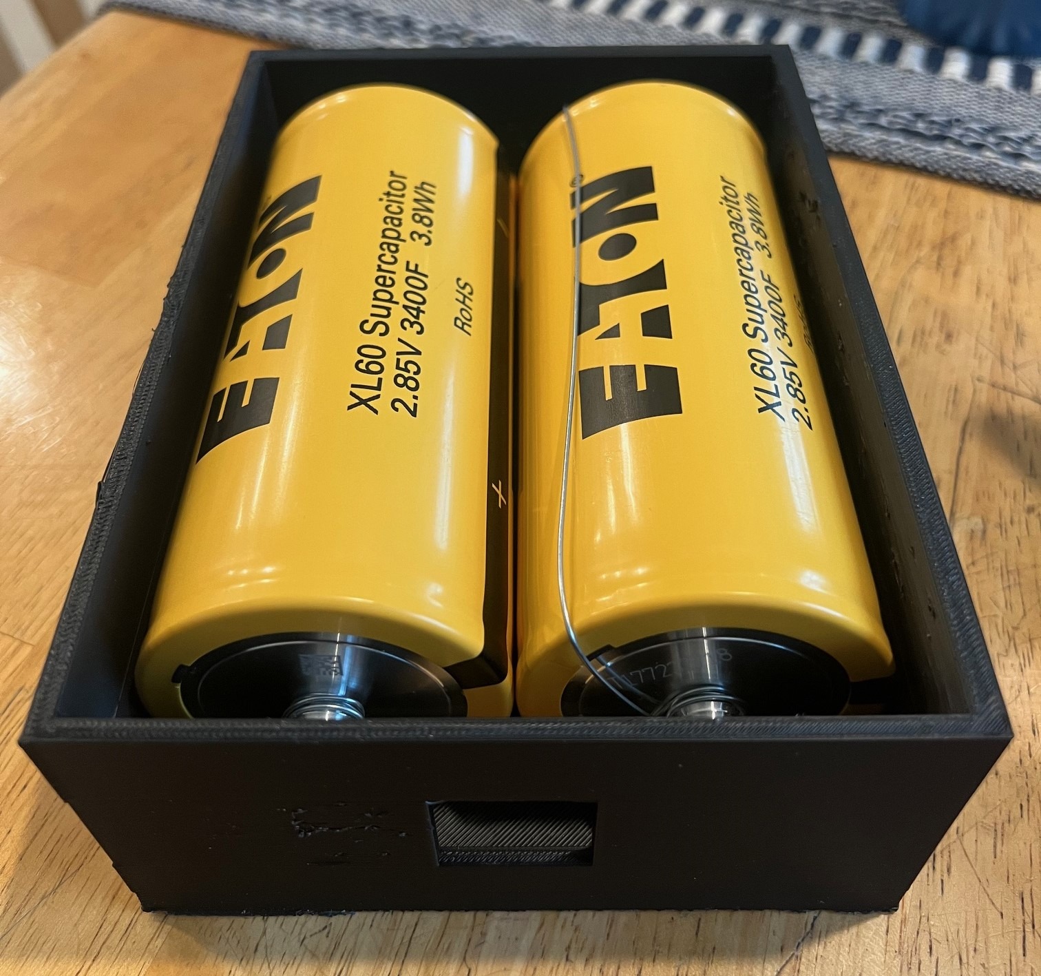

Here's my first try... It's definitely useable the way it is but I didn't center the cavity right and the caps sit 4.5 mm higher than they should. I'm going to center it, change the square opening to a circle, then drop the caps so they're about 2mm under the top of the box. Then I'll design a bracket for the PSU board.I just redeemed my CC points for one of these

Thanks! That was my first try. I'll make it better. Tinkercad has a learning curve.@svelyo
You did a good job! Very interesting.
Ian
