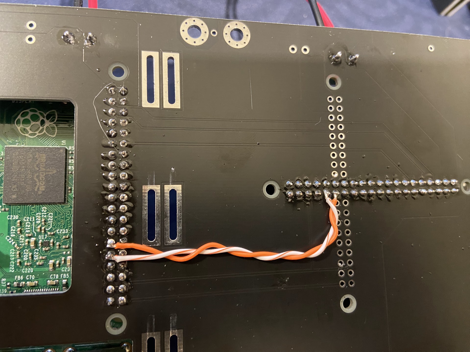

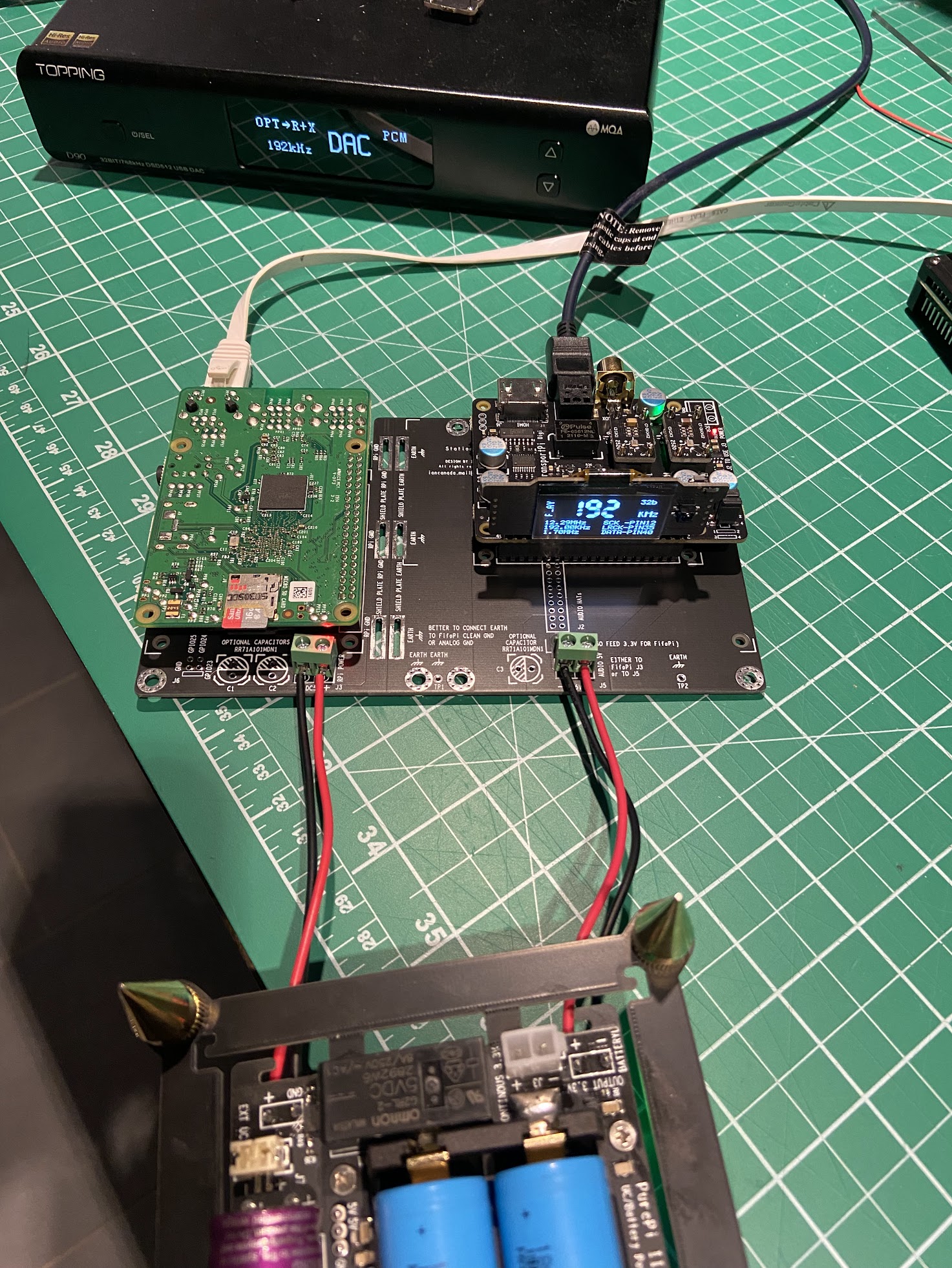

Hi Pete,
I have a good news for you.
Last night, I did a test myself with the same configuration and figured out the issue.
Reason: TransportPi Digi works in master clock mode which needs two additional hardware connections for the clock selection, but the StationPi doesn't provide such connections.
Solution: Solder two wires at back side of the StationPi PCB to connect both pin29 and pin31 between GPIO socket J1 and connector J7, please see the picture.
Result: Works like a charm no longer has any issue
Thank you so much for reporting the issue. Sorry for my late solution. Good luck to your project.
Ian

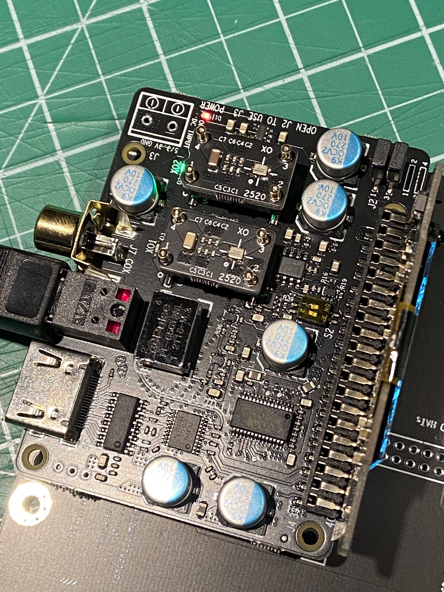

Hello Ian, I’ve been fighting with this for a week now, and I am sorry to report it’s still not working. The clocks do light up now, and switch depending on the input, but there is no output from the optical (haven’t tried the coax) . Plugged into each other everything works fine. I think I’m going to abandon this and find another solution do connect everything.
@Iandiepete,
"The clocks do light up now, and switch depending on the input, "
That means the clock selection issue was fixed. It should be no problem now, but really don't understand why you still don't have output.
Please try the coaxial output and let me know if you have an update.
Or, if it is possible, install a MonitorPi to the GPIO of the TranportPiDigi to ensure both Music format and data are correct. MonitorPi would be a great help to debug the system.
Please let me know if your need my help to fix the issue.
Good weekend.
@landiepete
Just tested by myself on the same setup, it plays music to my D90 through both OPT and RAC without any problem.
As long as the you can see XO light switching and the red light comes out of the OPT transmitter, there will a S/PDIF signal.
Do you use the default XOs? Jumper settings on the TransportPi Digi still keeps default?

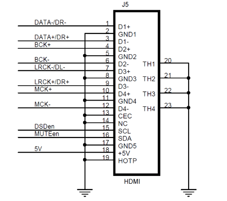

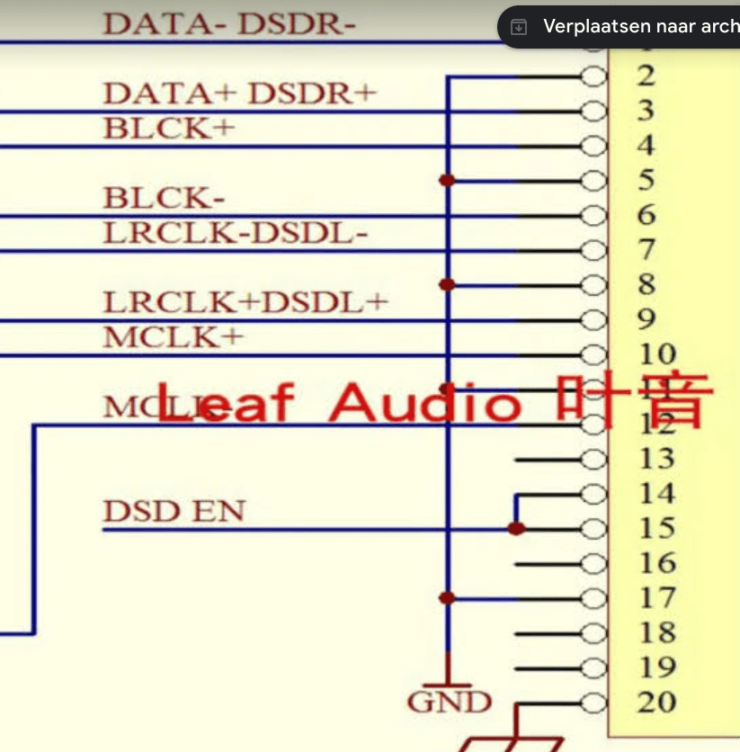

Thanks Ian. Comparing the HdmiPi Pro and my Leaf CMD27 DAC's protocols:
View attachment 1243945 View attachment 1243946
Do you see a discrepancy that explains the distortion with PCM176 and upwards?
Anything I could try? (Still waiting for a MonitorPi Pro...)
Am I wrong to think that the fact that everything plays well up to PCM96 shows that the I2S/hdmi formats are compatible?
I saw that some others experienced the same problem, maybe they could chime in, sharing info/I2S format of their DACs?
A total mystery to me, but good news!
Yesterday I received my MonitorPi Pro back from Audiophonics. I never had any screen activity on this but it worked without problem at their end. Today I plugged it in, mainly to troubleshoot my distortion problem, and there immediately was screen info! (Nothing had changed for the rest of the streamer in the meantime, except that I added an external on/off button for the Pure Pi II.)
And more mystery followed: I can now play higher resolutions up to PCM384 and DSD512 without distortion.
One thing you learn in this hobby: and that is accepting that one cannot understand everything. But I am happy 🙂

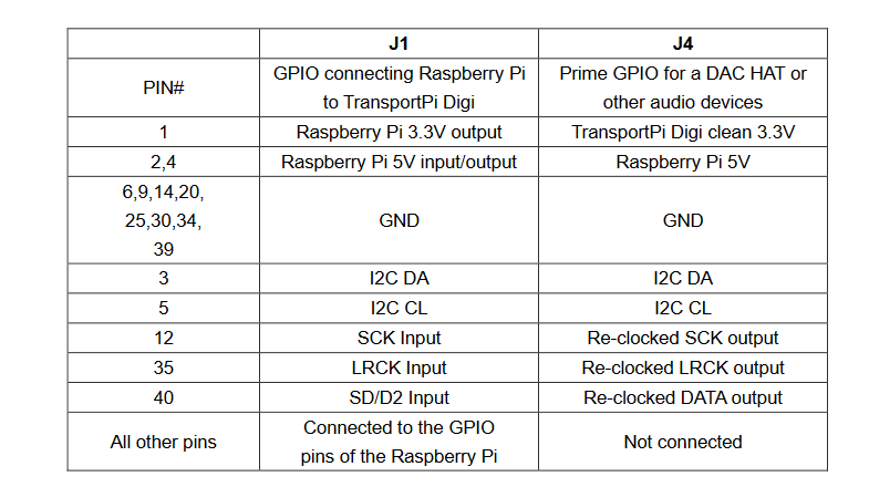

Ian,
could you kindly indicate which of the pins/traces on the GPIO are indispensable for the infernal thing to work ? Maybe I have a bad trace on the StationPi.
Pete

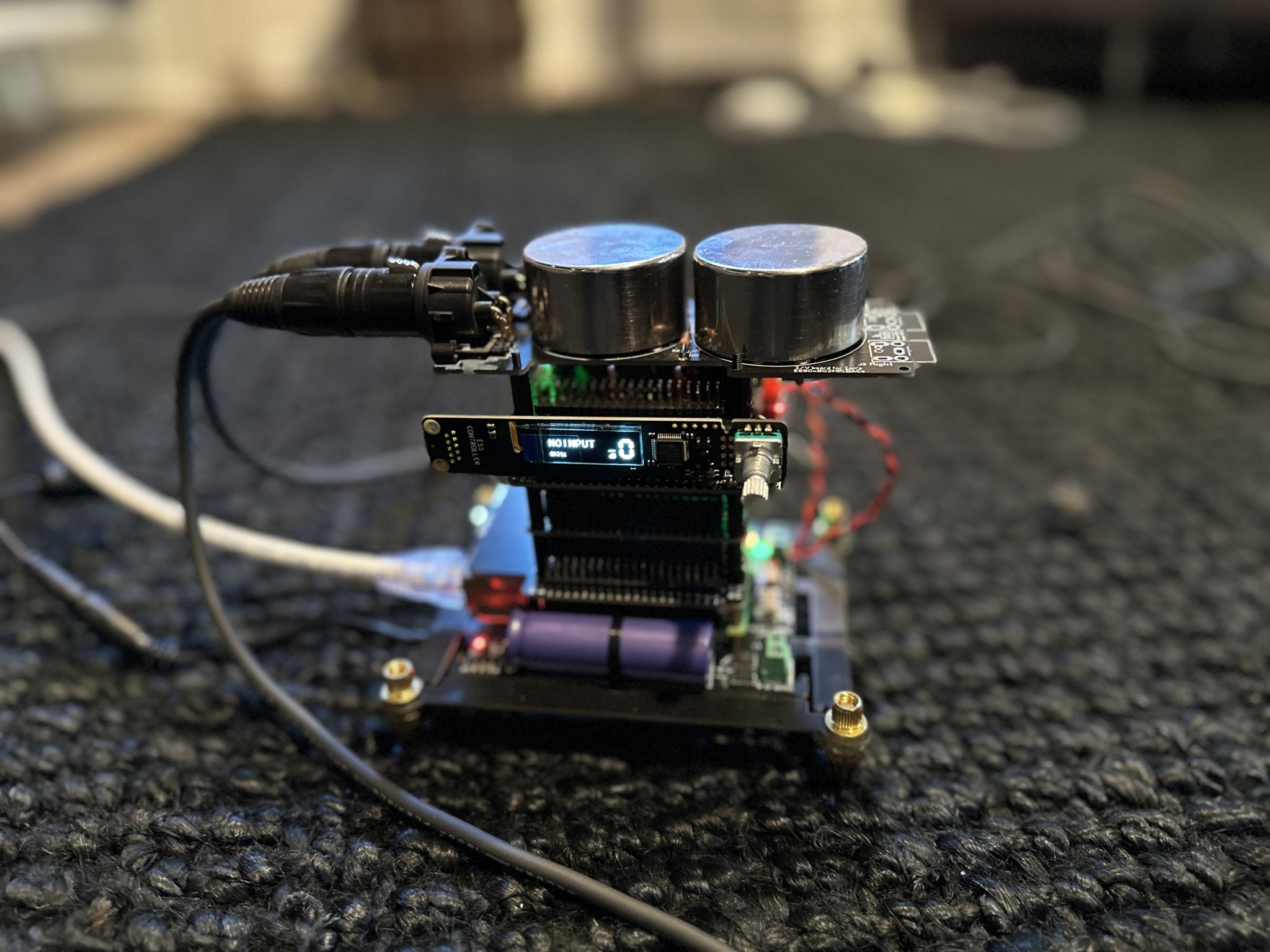

I finally assembled a few various IanCanada parts I had been using in a standalone DAC. The primary purpose will be to take toslink from my TV to be able to get Apple TV and other HDMI only sources to output into my stereo speakers. I may create a standalone streamer but the DAC is nice and compact.
I haven’t tried with unconditioner on top but will next.
@iancanada - there is a slight low level background noise (not quite a hiss) through the speakers when not playing music. It might be higher gain needed with the transformer output stage but do you have any suggestions based on this layout?
@stew1234
Your project looks great.
I use the similar setups to my system without any problem
Listening test audio configurations
  1. B&W 802 D2 speakers
  2. Pass XA 160.5 pure class A mono block
  3. Pass XP-10 Pre-Amplifier XLR input/output
  4. PS Audio P20 PowerPlant
https://www.diyaudio.com/community/...fight-the-jitter.192465/page-532#post-7520451
However, a Transformer I/V can pick-up noise from environment. More shield or better ground could be help. Yes, a ConditionerPi 3.3V will be another improve for sure.
Or, you can try a lower gain pre-amp if the current gain is too high.
Ian
Ian,
Pete
All the shared connections in the chart are necessary.
Debugging a system need some skills and patients.
Or you can send them to me if you really need my help to address the issue.
You can also send email to me at iancanada.mail@gmail.com
Good weekend.
