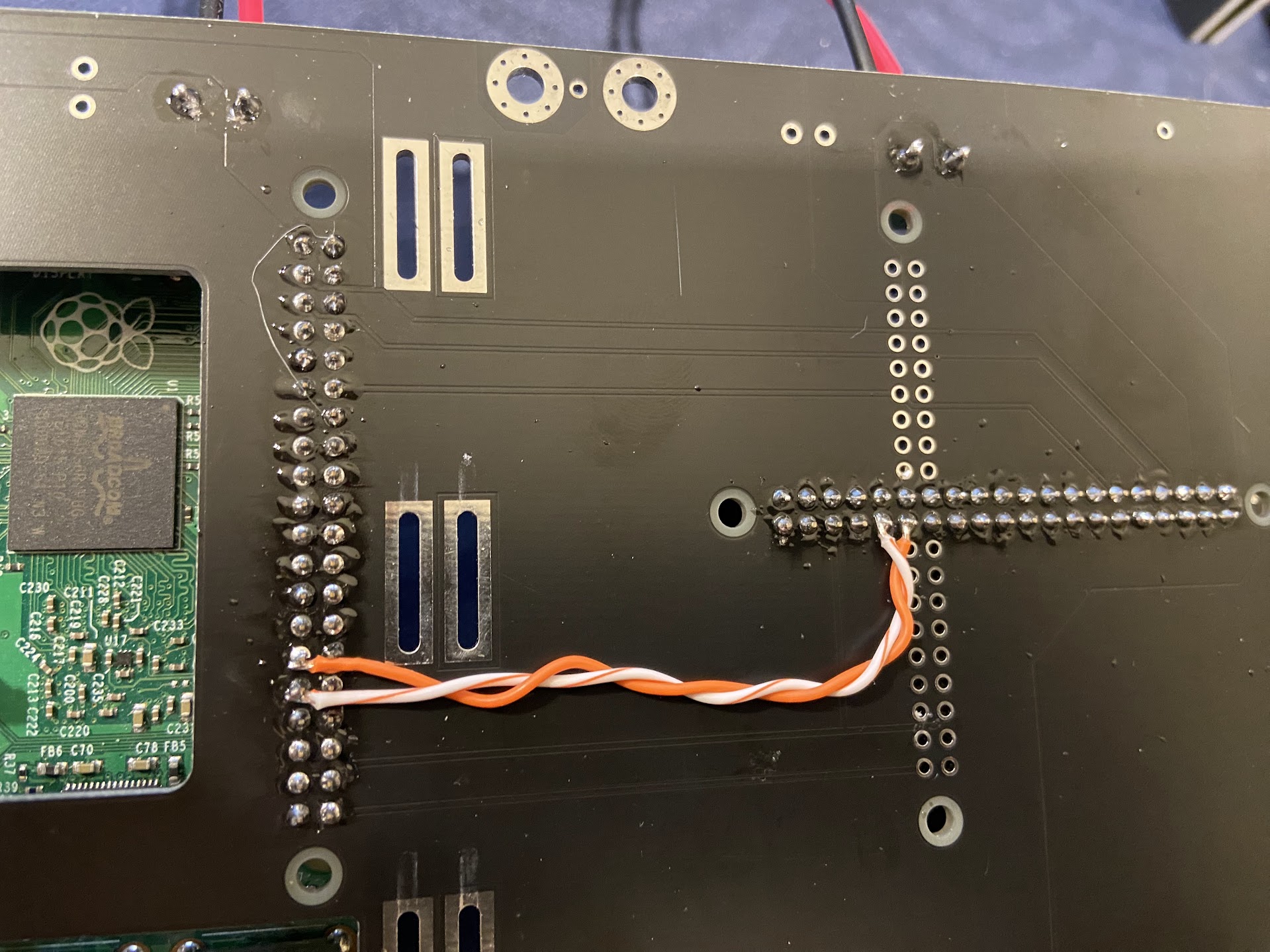

Hey Ian,
I have a Station PI, it is powered by two LinearPi supplies, one each side. The Pi is a Pi5, the transport a TransportPI Digi (I think I have the last iteration). The Transport is connected to a DAC (I tried 2 different ones). I've tried both Coax and Optical. I get nothing.
The software is Volumio. I've selected Digi Berry Pro + (as stated in the manual) as I2S (I've also tried the Allo one)
Running USB directly from the Pi works fine. I don't know where to start looking. Any ideas ?
Thanks,
Pete
Hi Pete,
I have a good news for you.
Last night, I did a test myself with the same configuration and figured out the issue.
Reason: TransportPi Digi works in master clock mode which needs two additional hardware connections for the clock selection, but the StationPi doesn't provide such connections.
Solution: Solder two wires at back side of the StationPi PCB to connect both pin29 and pin31 between GPIO socket J1 and connector J7, please see the picture.
Result: Works like a charm no longer has any issue
Thank you so much for reporting the issue. Sorry for my late solution. Good luck to your project.
Ian

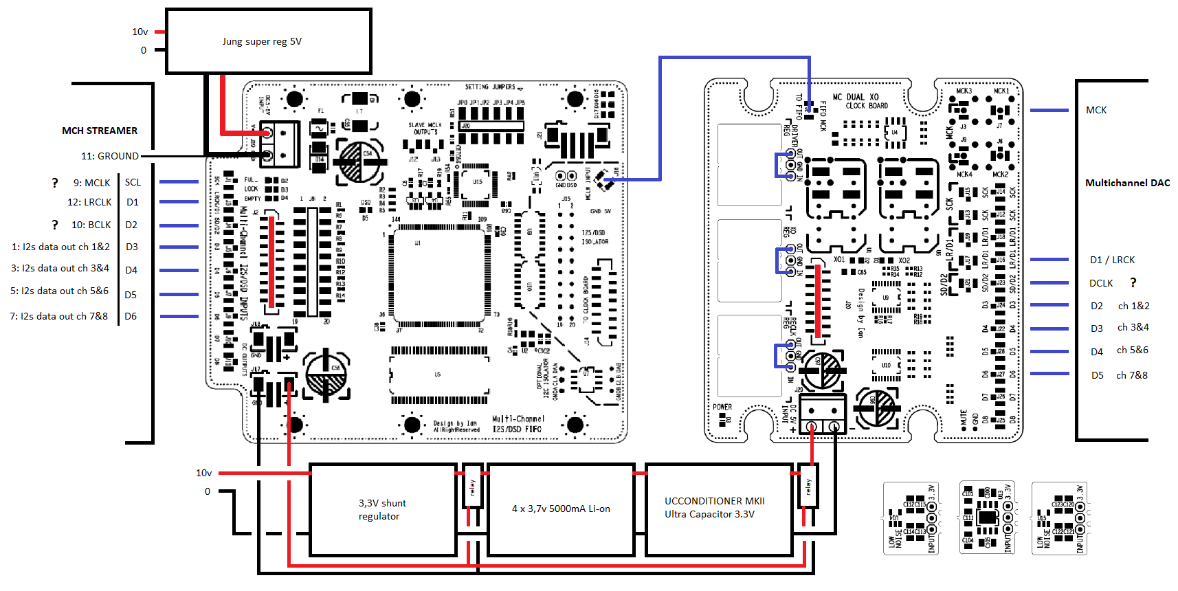

From the McFifo manual I got this:
-Master and slave controlled MCLK
McFIFO was set to master controlled MCLK mode by default. This is the normal operating mode of the McFIFO. In this mode, McFIFO will decide which XO is selected for MCLK according to input music.
However, McFIFO can also work with digital audio sources that have master clock mode. For example, USB streamer with two on board XOs. To implement this, we need to enable McFIFO’s slave controlled MCLK mode. In this mode,
Page 8 2017-6-15 iancanada.mail@gmail.com
XO selections will be controlled by digital audio source. SLAVE MCLK will be fed back to digital audio source from McFIFO as world master clock. Frequencies of SLAVE MCLK can be set by jumper settings. To do so, we need a couple of steps :
1. Enable slave controlled MCLK mode by driving SLEN pin on J8 to logic high.
SLEN=0 (OPEN without connection, default): master controlled MCLK mode
SLEN=1: slave controlled MCLK mode
2. Connect XO selection signal from digital audio source to XOSEL pin on J8.
XOSEL=0: XO1 is selected
XOSEL=1: XO2 is selected
(XOSEL pin can be left open if not in slave controlled mode by default)
3. Remove the two XOs from digital audio source. Connecting SLAVE MCLK from McFIFO to the finial output for that two XOs. J12 and J13 are equivalent (but with different driver), so either of them can be used for this purpose. U.fl coaxial cable is used to improve clock quality.
MCH streamer is also supposed to run as master so I belive this would be the way to do it.
One problem though, it might just as well have been in Latin 😕
