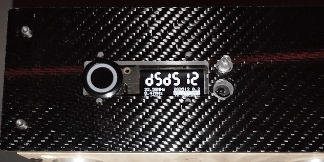

A total mystery to me, but good news!
Yesterday I received my MonitorPi Pro back from Audiophonics. I never had any screen activity on this but it worked without problem at their end. Today I plugged it in, mainly to troubleshoot my distortion problem, and there immediately was screen info! (Nothing had changed for the rest of the streamer in the meantime, except that I added an external on/off button for the Pure Pi II.)
And more mystery followed: I can now play higher resolutions up to PCM384 and DSD512 without distortion.
One thing you learn in this hobby: and that is accepting that one cannot understand everything. But I am happy

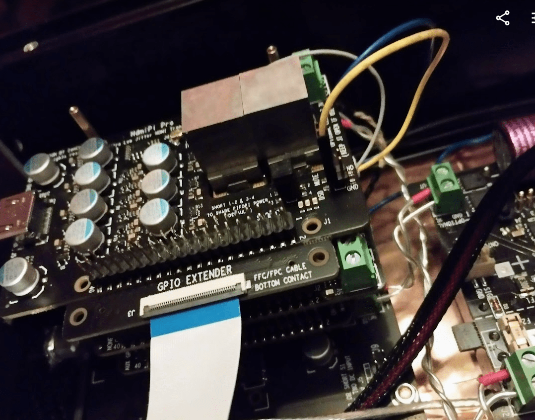

And I forgot to mention two other changes that I made since having the distortion problem: I added a second SC-Pure, the 49 one (not relevant I guess as DSD uses the 45 one), and I am holding down the clocks with Tungsten cubes. I found them a bit wobbly without the help of this extra weight. See pic.
Did the Tungsten blocks cure the distortion?
I am not going to test this as they are now firmly fitted. The case lid has some foam attached that barely touches them, so that they will stay in place even when I put the streamer upside down.

There is still some distortion above PCM96 I am afraid. Less than before, so something improved. But not yet what it should be.
Also, the higher the DSD rate, the less distortion. That is why I did not notice it at first with DSD512.
More tests tomorrow...

HQPlayer embedded on GentooPlayer with Diretta host, to GentooPlayer on the RPi as Diretta target. DoP indeed, as Passthru does not work. However see my previous post :-|

Alas not as wonderful as I hoped. The distortion is virtually gone, and that was the reason for my initial euphoria. However, with my ear close to the speaker, I can hear a soft continuous white noise starting when I hit Play with PCM 176 and above, and with DSD. When the music starts I can hardly hear this noise, but it compromises the pristine sound that I am after.
This behavior is regardless whether I use the internal I2S DAC or the Amanero board.
So the behavior w.r.t. distortion has changed. Why? I did make some changes recently, but hardly think they are relevant:
- rewired everything with thinner silver wire (Xangsane)
- added a second SC-Pure (49, I already had the 45)
- added Tungsten blocks on top of the clocks
- added MonitorPi Pro and mounted this to the front of the case using the GPIO extender
- attached an external on/off button to the PurePi II
- attached a ground box to the streamer
Now that I have the MonitorPi Pro working, are there any settings I could try to get rid of the noise? I would already be happy if I could have noise-free PCM192.
