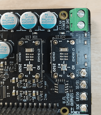

On the FiFoPi Q7, how can I tell which clock is the 45 one, the one at U7 or at U13? I see no difference between the two stock clocks.If yes, is it possible (for DSD-only use) to replace only the 45 one by an SC-Pure 45 clock?
Yes, it is possible. You can upgrade with only one SC-Pure 45 and keep the other 49 one.
I am asking so that I replace the right one with the SCPure 45 I purchased.
I am not home now but there is something written on the clock to mark the difference. I think you have to remove them.
Make sure you put it back the same orientation (pin 1 is marked with an empty dot on the board). Same thing with thew SC-Pure, there is an empty dot to guide you on pin No. 1. Don't use the words on the clock. You can see a few pictures here on this forum, look at pictures from @fusion360guy a couple of months ago.
On FifoPi Q7, it doesn't matter you install XO clock to which socket, U7 and U13 are all OK. But if you want to know which is which frequency, a MonitorPi or MonitorPi Pro can tell the real frequencies on the OLED screen.On the FiFoPi Q7, how can I tell which clock is the 45 one, the one at U7 or at U13? I see no difference between the two stock clocks.

I removed one clock but the backside has no lettering or marking, and the topsides seem identical.
The orientation here is indicated by a little half moon indent between pins 1 and 4: see pic. So that seems clear. The same indent is present on the board socket.
But I want to make sure that I remove the stock 45 and not the stock 49 before inserting the SC-Pure 45 -- so I still have to figure that out...
@iancanada :
In the absence of a MonitorPi: when produced, is the 45 clock always at U13 and the 49 at U7. I saw this orientation on a pic with Acusillion clocks. Or is the placement random?
And is there any harm done when I run it with two 45 clocks? If no, I could just use the trial and error approach.

More circumstantial evidence on page 504: in the pic with two SC-Pure clocks there, the 45 one is on U13 and the 49 one on U7.
But I guess the safest way is to just remove one stock clock. If the remaining stock clock can play f.i. 24/96, I will leave it in. If not, I will swap it for the other stock one. And next I will put the 45 SC-Pure in the other slot.
Default is 45 left and 49 right. But you have no problem to change the position. The default XOs are AS318=B 2025. You can see the frequency numbers on top using a magnifier.Thanks!

Sorry, being careful again...
At first it seems straightforward: the stock clocks have this orientation
1 4
2 3
where the half moon is between the 1 and 4 and the little hole ('o') is at pin 1:
The SC=Pure has no half moon, but does indicate the pin numbers:
1=DE
2=GND
3=OUT
4=3.3V
However it has an 'o' (top left) on the case above pin 2 :
Can I ignore the 'o' on the SC-Pure and just let the pin numbers decide?
