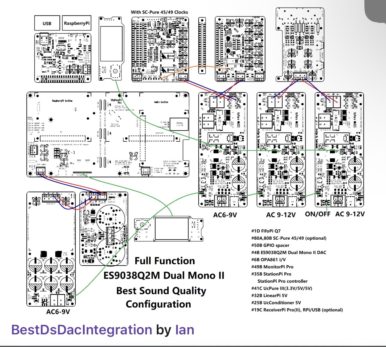

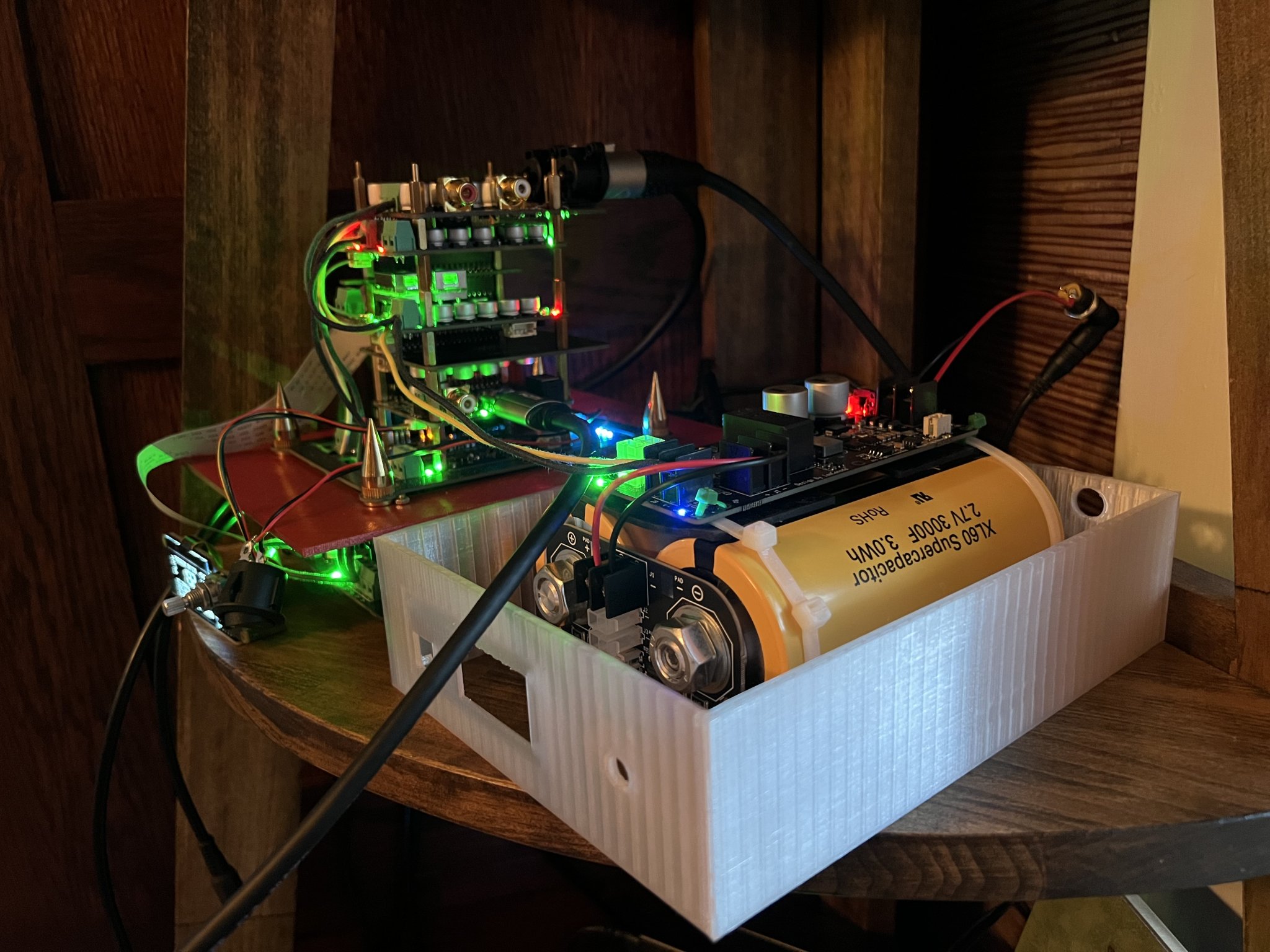

Check this out. Ian posted it not too long ago. I’m am using OPA861 IV powered with linear pi dual. And have the ultra caps with UCPure III to power the fifoPiq7 two SCPure clocks and the DAC board. Need to case it up. To busy listening 👂

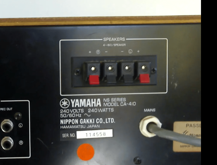

4 decades ago i started with the notorious Monster cables in combination with my Yamaha integrated amp. This device had one of these typical connectors in the days back then which on the interior where '' continued ' by very basic wires. Of course at my loudspeakers side situation was pretty similar.
Back then replacing the Yamaha terminal by professional terminal brand like Elma and upgrading the cable from circuit board to inside terminal gave more improvement than replacing my loudspeaker cable (a tad better than lamp post chord) by Monster.
If i show pictures to co workers who work on electric train power supplies they cant stop laughing!

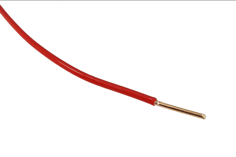

Good thought process on maxxing out the thickness of the cabling for the clocks. I only have UcPure MKI and MKII, but this should still apply.
I don't think there is a max guage on the J9 output as you can solder the thickest guage possible to the terminal if needed. But you do have to worry about the other end. For example, I use Keystone terminals which has a "Wire Guage Max" of 14AWG for the "Clean Side" of the Q7 and for the StationPi.
https://www.mouser.com/ProductDetail/Keystone-Electronics/8718?qs=%2BS1bAMbChF8qBANams/R5Q==
Because the Molex Contacts max out at 16AWG and my supplier does not carry 14AWG PTFE Solid Core, I decided to settle @16AWG PTFE Solid Core.
When I received the 16AWG wiring, I realised that the Molex Connectors I ordered a few years ago max out at 18AWG. But because I'm using solid core and the wire is super tight and compact, I was able to use the Molex Connectors that max out at 18AWG.
The Molex Connectors that max out at 16AWG is in my Mouser Project for my next Summer Project. So I was lucky this time around. But of course, the Molex Connector @16AWG you have in mind plus 16AWG is a great idea. But you have to account for the other end too as I don't know if the generic terminal can fit 16AWG as I use exclusively Keystone terminals.

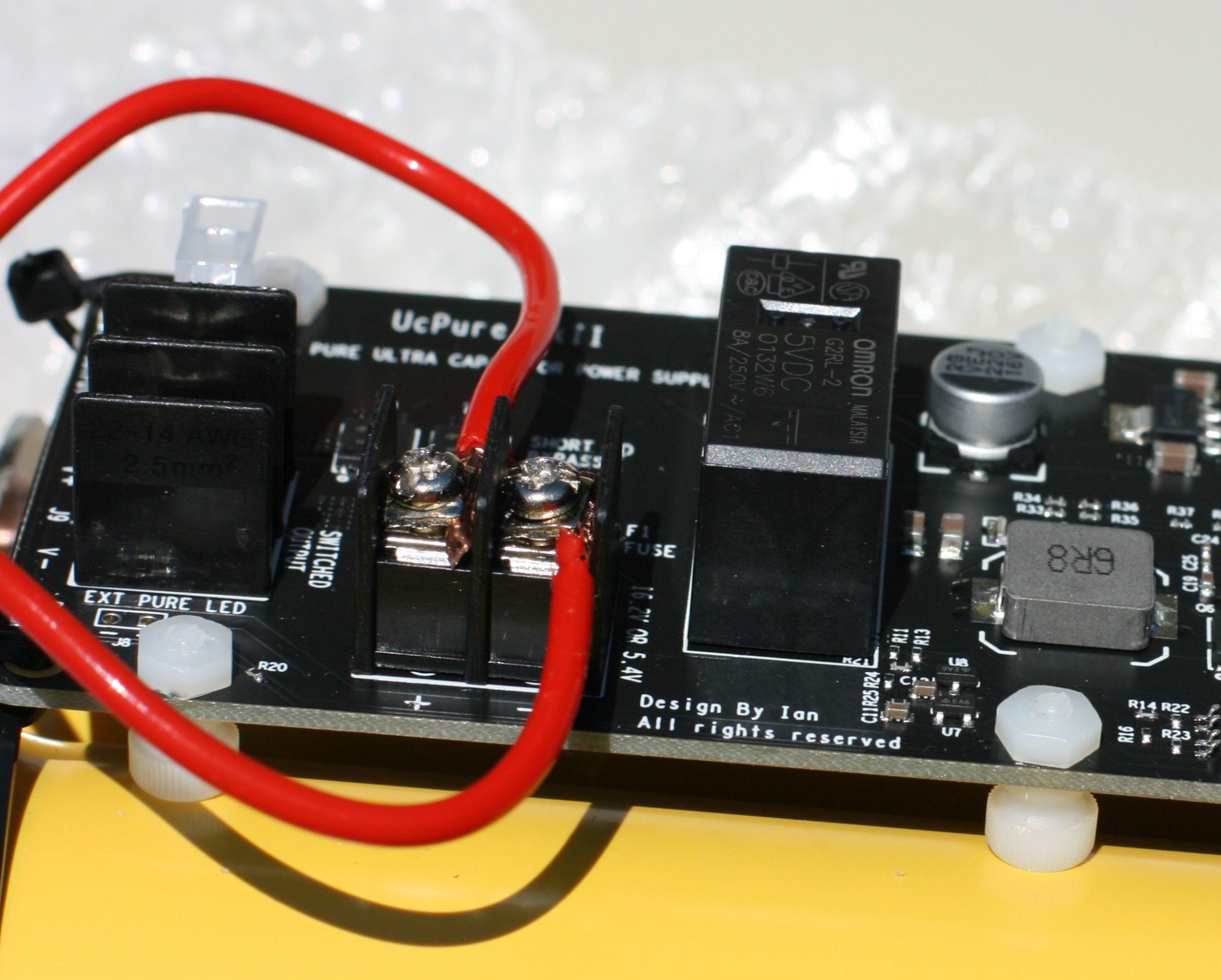

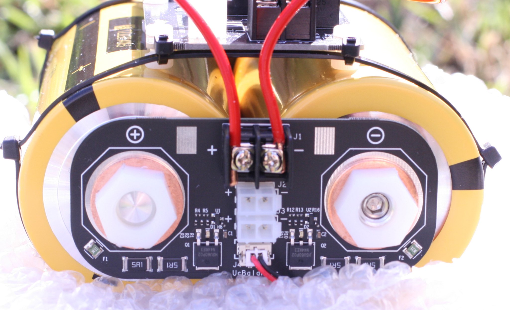

Even though it's securely screw torque-tightened on the terminals, do you think it's a good idea to also solder in the terminals on both the UcPure and UcBalancer?

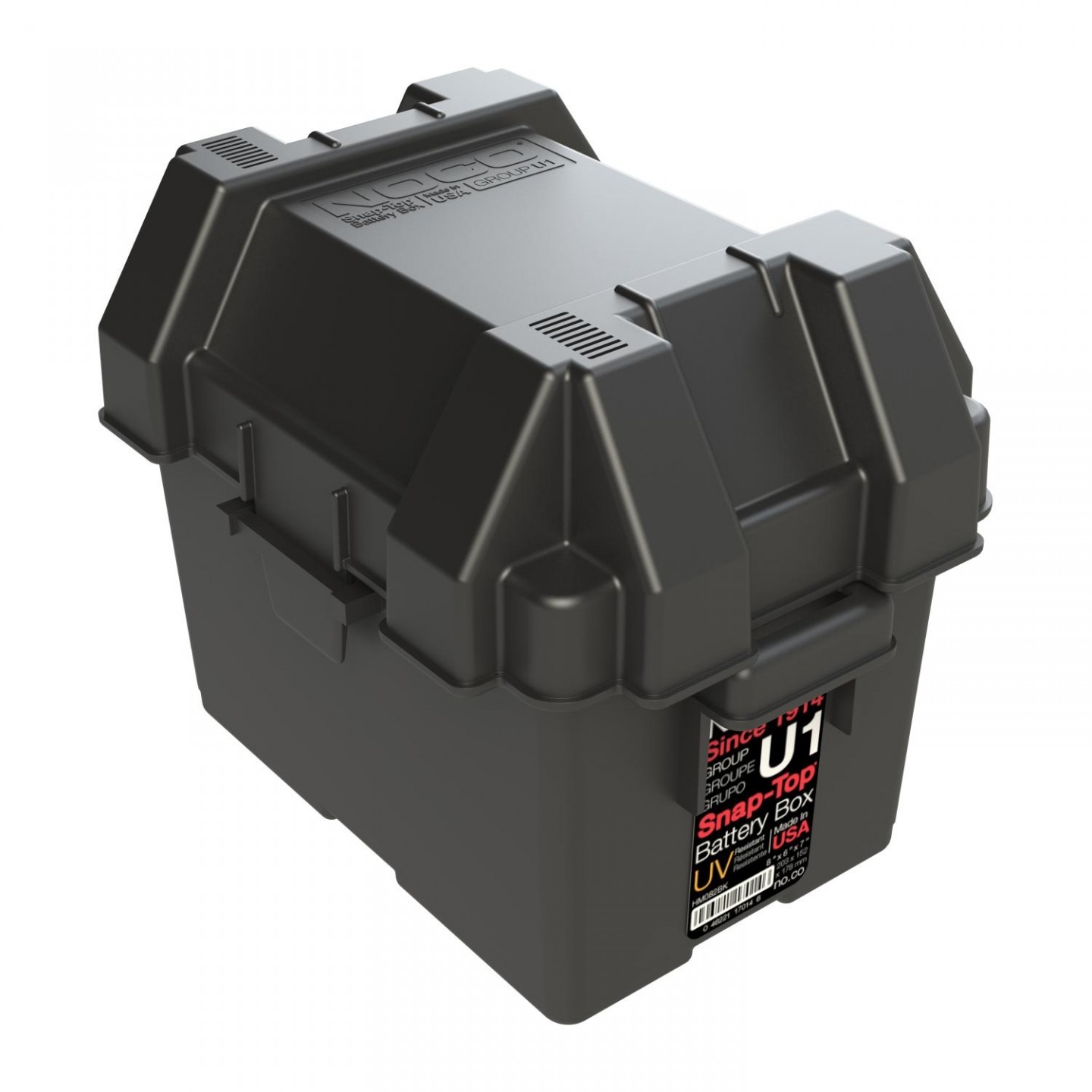

After I recieve my Battery Boxes, I'm ready to Production Freeze my UcPures and can solder the terminals if optimal. I plan to add a Power Button to the case:
That's why I run my own genuine highly heat resistant nylon standoffs, M12 Nuts, terminals, clock cables, etc. I don't take any chance something can be a knockoff or not of premium quality. All this work, I rather run geniune Hirose clock cables not to mention they are much more user-friendly to hand snap-in.
