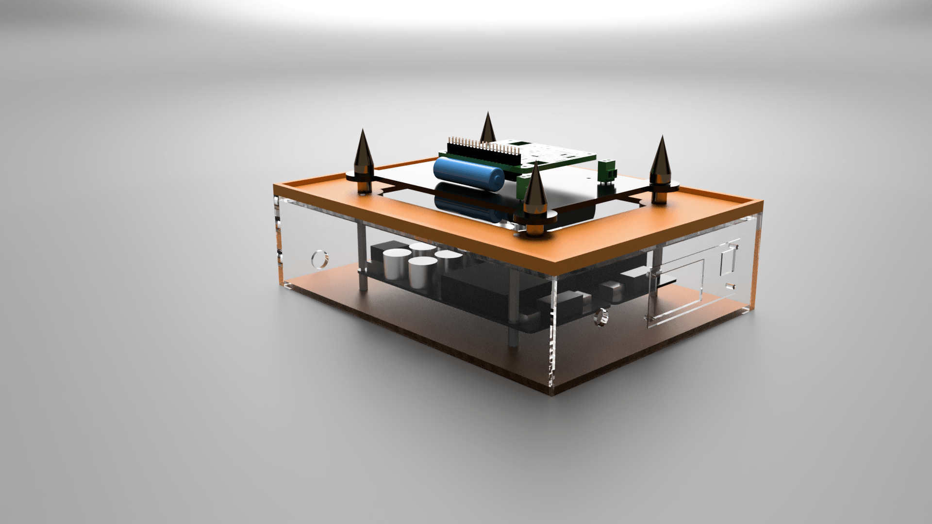

Hey all, I am working on a case based on the orange plate I made for the DAC Stack in this post
Dual Stacks
Here is a render. I just have the ReceiverPiPro partially modelled. Building the case down from the orange plate and then up with 3D printed custom parts I am making to measure. It will get narrower as it goes up. I have cutouts for monitor Pi Pro in the front and a power switch and at the back the 3 power feeds.

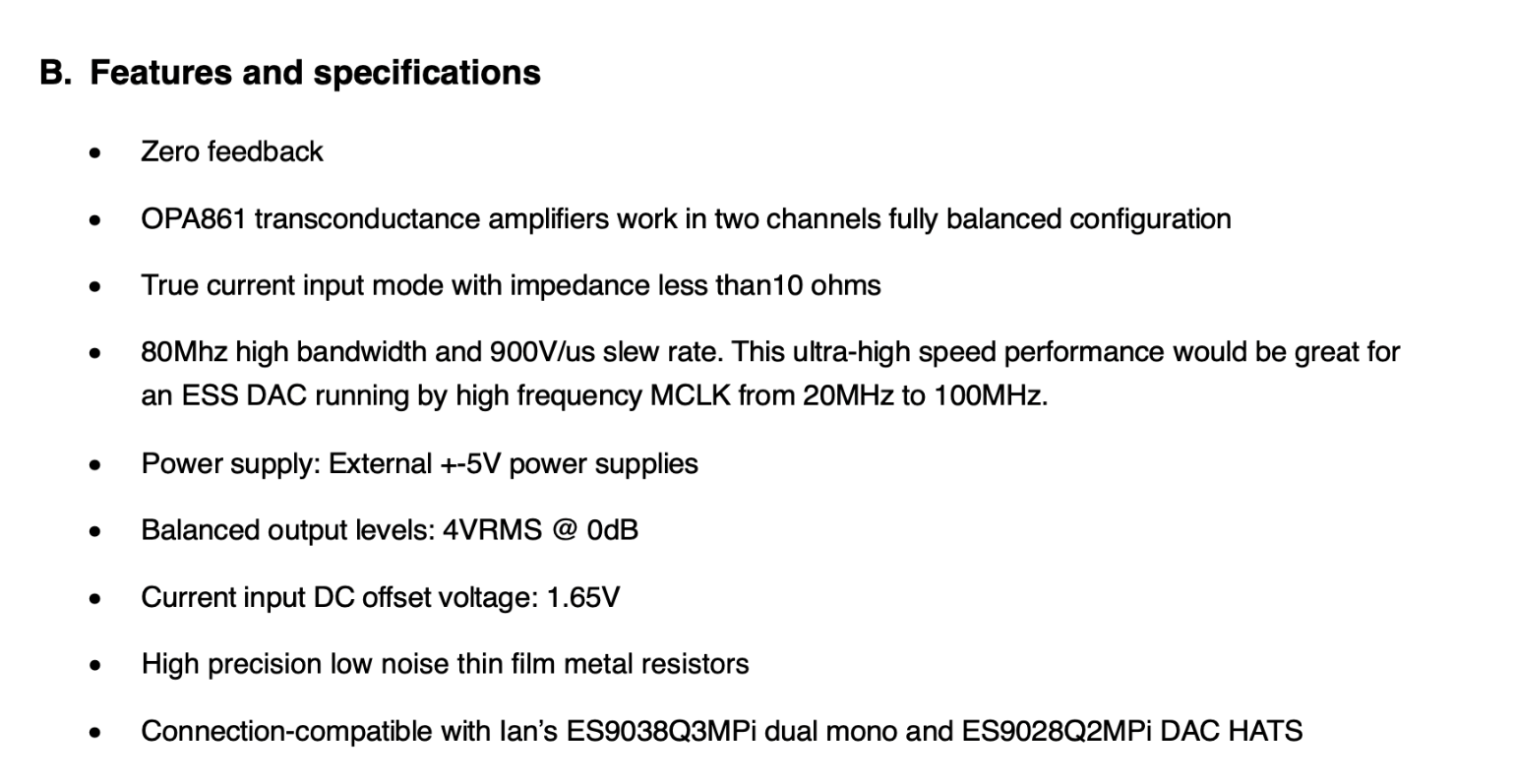

So for my analogue output board on the ian DAC (dual mono) I built (OPA861), it's giving me 4V out @ 0db (full ESS chip output) at XLR analogue side. So a pre-amp just gives me essentially a volume control to REDUCE the volume (voltage from 4 to something lower than 4V) before handing it to the power amp? Because power amp input voltage is 2-4V.
And I need a good pre-amp to preserve the dynamic range on the pre-amp side to be as close to the digital SNR of the DAC?
So what is benefit of the pre-amp? Isn't it just one more place to degrade the signal? Why not use MonitorPiPro volume control and go straight into a power amp if the OPA861 is able to give power amp input voltages no problem?
Dual Stacks

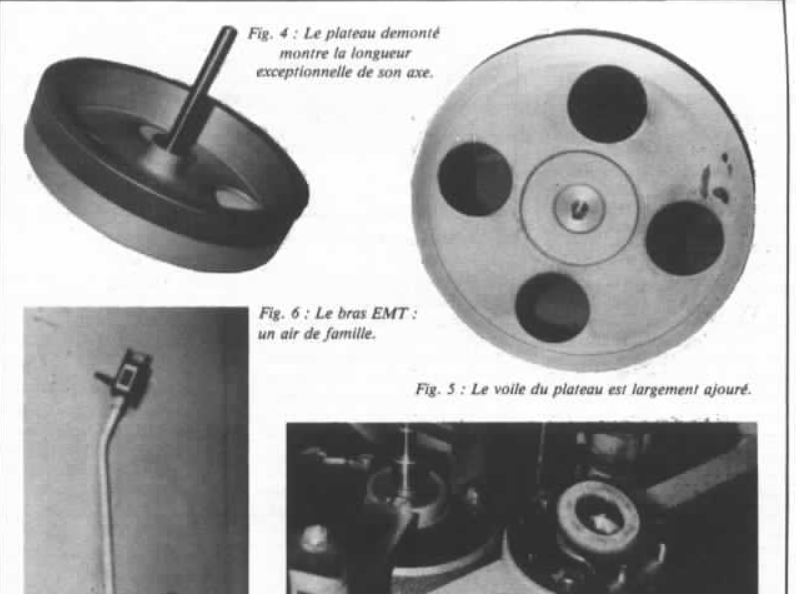

Hello,
Because you are going to use a 3D printer you might as well use a design principle used for the EMT930 turntable. Usually aluminium platter will sound like a bell when you '' hit '' them with your knuckles. What they did do is put most of the weight on the outside and add 4 big circulair holes.
Because people talking about vibration sensitive clocks using a material and a shape that will kind of absorb vibrations could be a plus.
It could be that two tin layers of a kind of polymer separated by a layer of sand could absorb loads of vibrations. Are clocks sensitive to vibrations in a same way like a turntable?
The Japanese have done experiments with building a loudspeaker enclosure with exactly the same dimensions just completely different materials. Very thick glass sounded very bad , just like concrete, steel. There were no vibrations in the lower frequency range ( below 600 hertz) but above that there were several '' peaks '' showing the vibrations introduced by a technical device were kind of transformed into higher frequencies turning the sound into a very aggressive kind.
Is there a way to determine which kind of vibrations are bad for the clocks.
Making your own housing could have more advantages then we would have hoped for.
Personally i think using 4 spikes to support something with a total weight of 2 kilogrammes is a bit weird. I would use just 3 and create a centre of gravity as low as possible. Because my construction will be inside my DDDAC mainframe i will probably for a kind of suspended construction using springs or some kind of elastic.

You guys are all so smart. I'm a mad professor. Good idea re the feet. I am also building a turntable (see other thread from me). But Re the DAC, I haven't yet figured out what I will put UNDER the case to support.
I think 3 spring loaded feet are a good idea. I will try this out on the prototype case. Thanks for the idea.

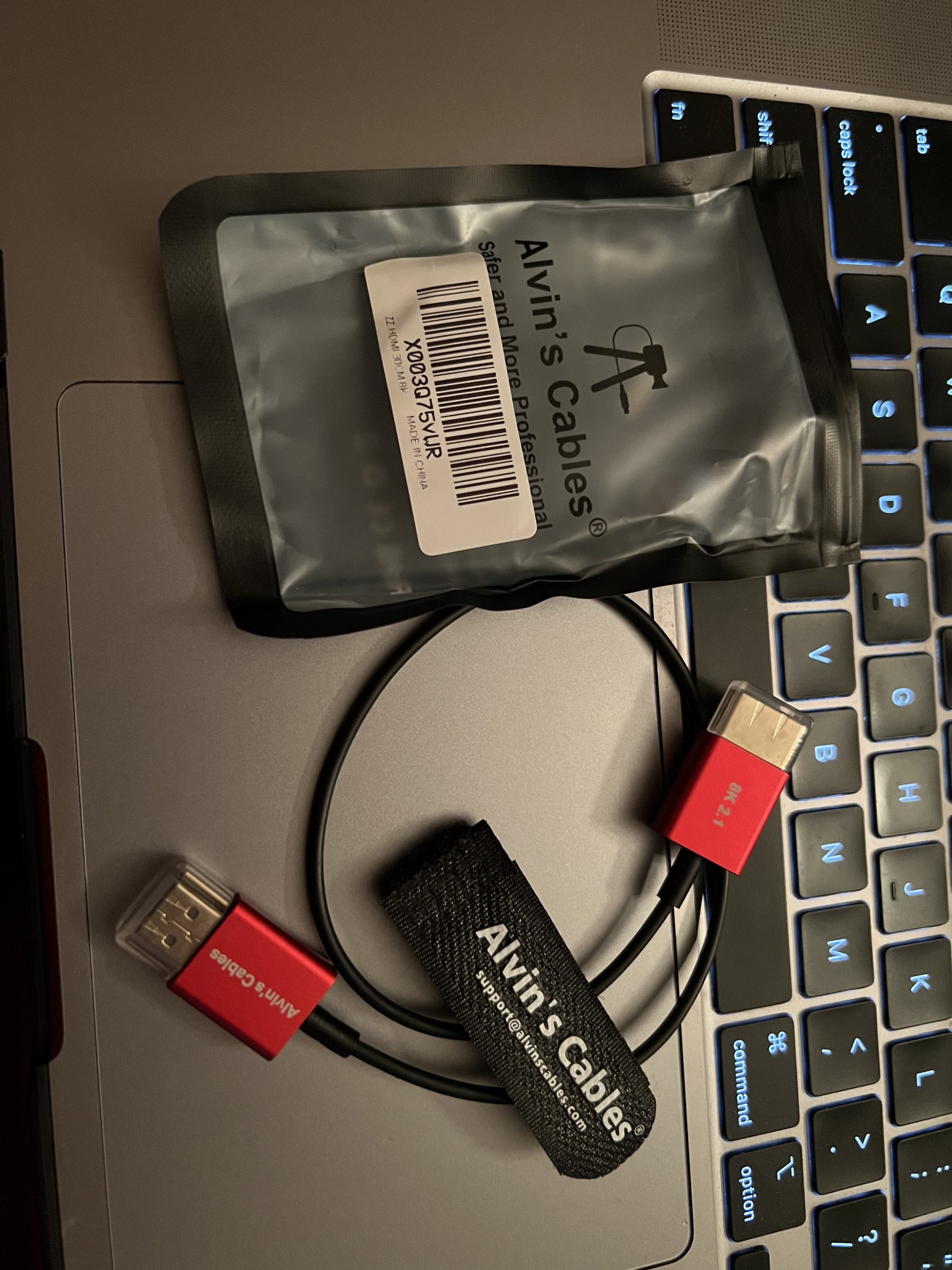

I got this nice little 12" flexible HDMI 8K 2.1 cable that seems to be co-axial to connect my IAN streamer stack to my ian DAC stack via i2s...
Anyone else used this type of cable? It's like 1/4 the size of the cable I'm using now. Is it OK for the HDMI i2s connection? Once i get them both in a case ill be able to use a shorter cable.

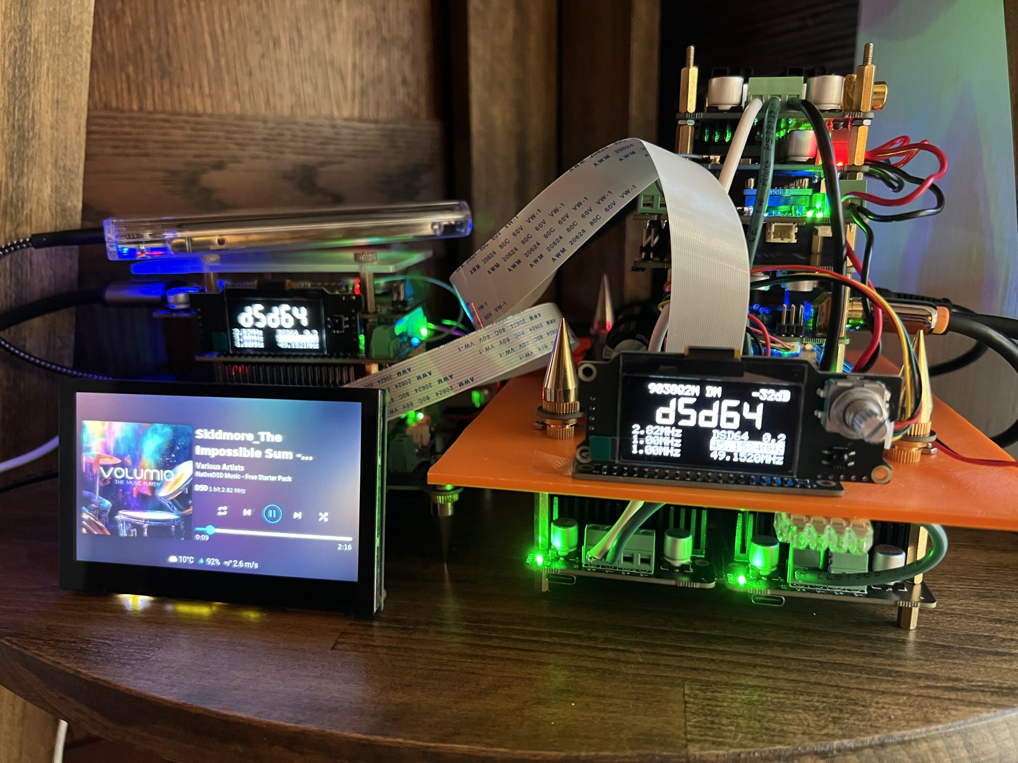

Hi @fusion360guy
You 3D design rendering looks good.
I am running a screen of my RPi similar to you. In my case it is a 1920x480 HDMI screen. That is powered together with the RPi off the 2A PSU from the LifePo4…
How is your screen connected to you system and have you experienced any decay in SQ with a screen connected.
Tried looking at your posts but couldn’t quite see how you wired everything…🙂
I am considering using a separate supply for the screen, but not shure it will matter since it is on the dirty side of the FifoPi…
(My system: StationPi -> Fifopi-> DAC -> Transformer)
Any thoughts from others are most welcome🙂

Hi Mikkel,
Thanks. It’s a DSI screen connected with the ribbon cable. I also have an SSD drive.
I am powering with an iFi X 5v/3A supply to an RPi4. I found with the 2.5A it would sometimes freeze (too little power?) but now all is good no more freezes. One day I may use a separate RPi just for display and SSD but I’m happy with it like this for now.
As far as SQ I don’t notice any noise or any difference in SQ. Somewhere I had a post that lists each element in the stacks including PS.
The DAC is separate stack PiLess and a 2.5ifi and a dui linear pi Ian board for the analogue opa861 power section.
Sounds incredible.
