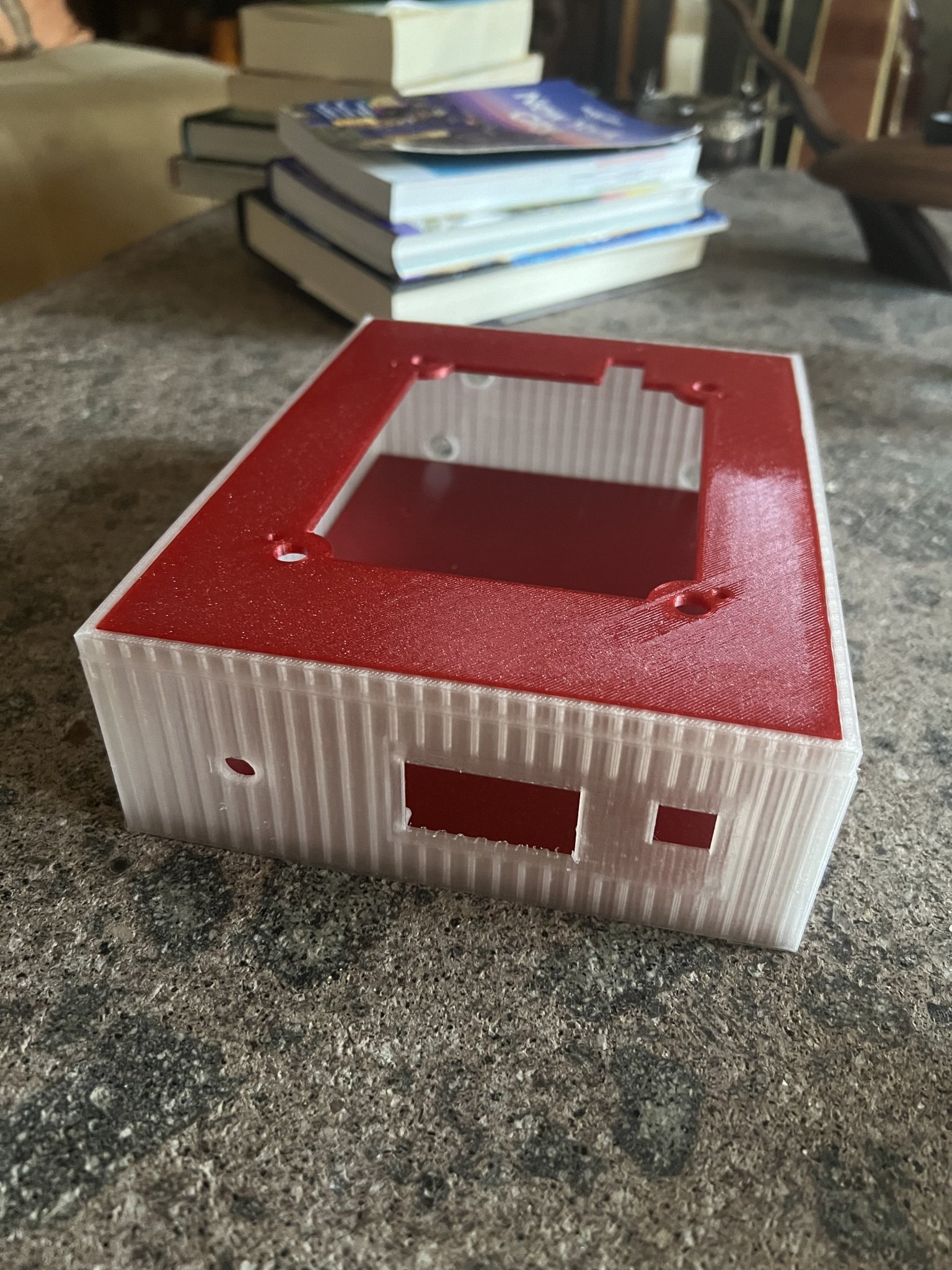

The prototype of the DAC enclosure (bottom part). Red and white translucent because I am Canadian and the DAC is Canadian! And to see the glow of the lights through it.
Have to make a small adjustment in the window for MonitorPiPro. Then design the top part.

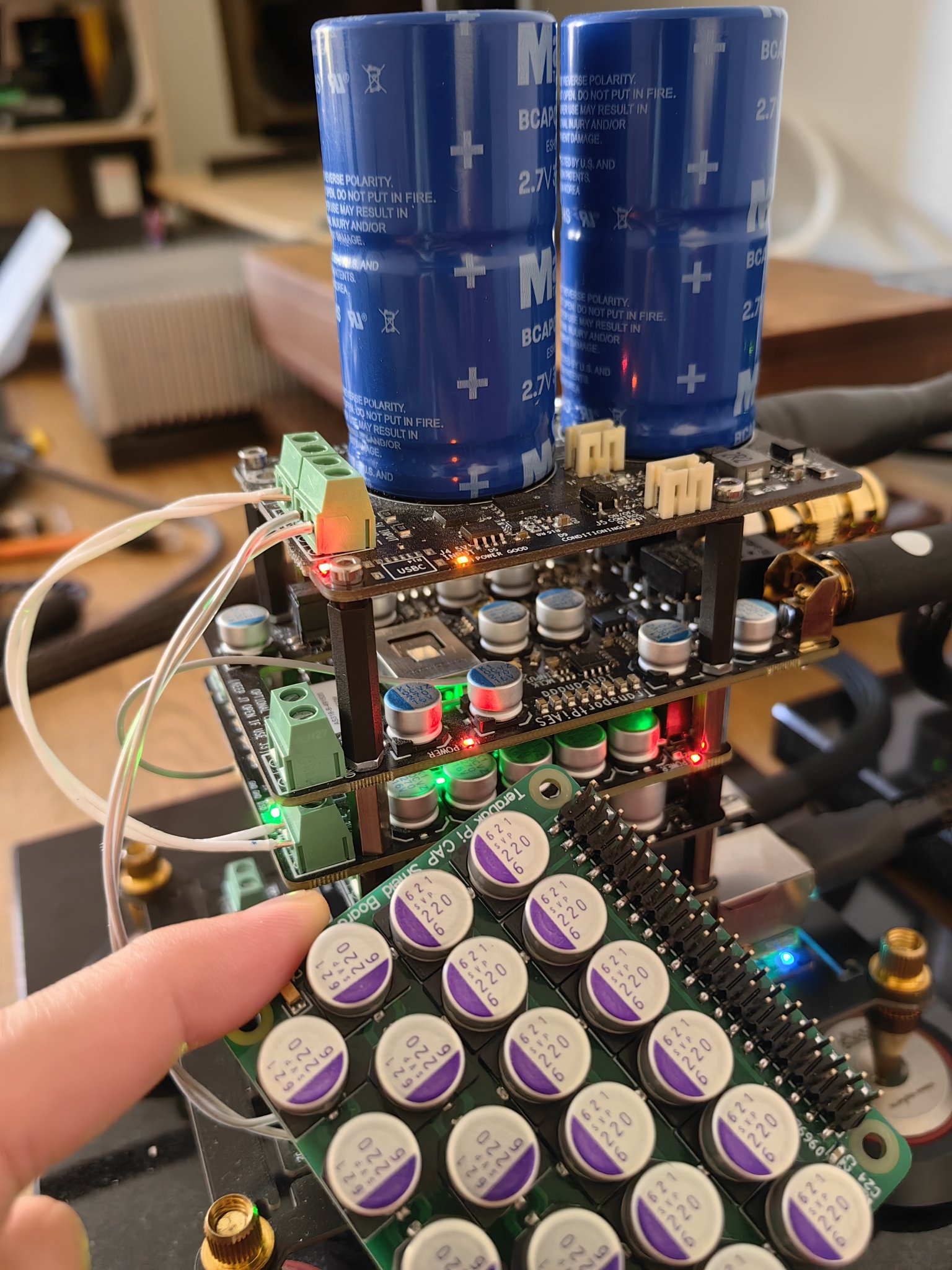

Hm, it's quite strange to me that someone just drops in brand new clocks and immediately finds much better SQ than with well run-in Crysteks/Accusilicons. Could it be possible that someone (or me) has got something wrong/different/damaged?
Anyway in my case, after just some 50 hours of SC-Pure 45MHz ticking, I still find my previous well run-in Accus better in highs, details, layering, depth, separation, reflections, reverbs, holographicity, etc.. But it is kinda expected after just two days - as with any conductor, I give it minimum of 150 hours/1 week before any judgement (and it might very well be even more for crystals), so let's see/hear later.
Just wanted to temper possible astronomical expectations right from the start and give hope to those still without the newest jewelry that it's possible to achieve stellar sound even with "ordinary" clocks via careful tweaking your existing setup ✌️
P.S. The only change in my setup is that I'm no longer using Teradak filtering board between FifoPi and TransportAES due to short cabling and different routing of the u.fl clock cable. Will cut longer cables from my latest Mundorf (white one on pic) and add the Teradak back to see/hear if that makes any significant change. Sometimes small details make a world of a difference.

If you will take a closer look at the green terminal or do a dissection you might get the idea to skip the terminal on one or if easy accessible on two interconnected boards.
So instead of the tiny pin of the connector being soldered to the board it will be the wire. Especially with a solid core wire that will be a piece of cake. The wire will be shorter as well because you dont need to end the connector on its side.
I don't think there is the need for a thick cable. I think the hole used for the connector soldering pin is something like one millimetre diameter.

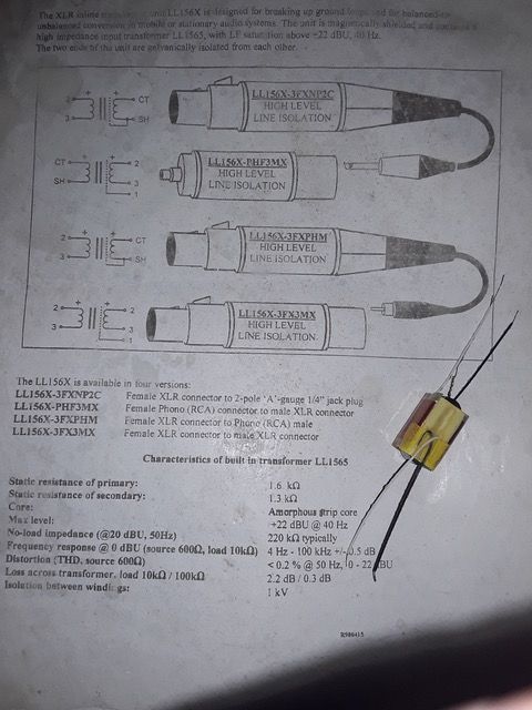

P.s found the Lundahl problem solver i mentioned some days ago
