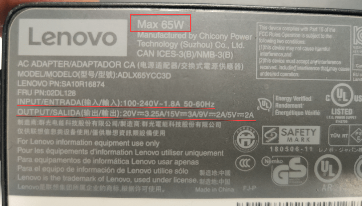

Could you please advise, Are we good to use below Type C adapter (input and output specs marked) to power PurePi/PurePiII or RPi3B+/RPi4B?
looking at 5V 2A I am thinking it should be fine with out any challenges.... need inputs from experts please. Thanks,
There are 4 voltages listed, 20v, 15v, 9v and 5v?
If you have and RPi you need 5v at 2.5 amps. If it’s a 4 you need 5v at 3 amps.
I would not use it. How can three voltages be output at once??

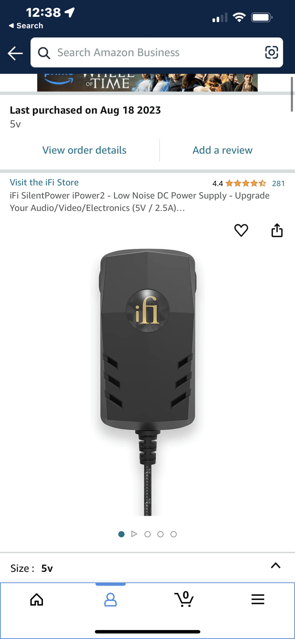

I use this to drive my PurePi II streamer stack with RPi3b
iFi power supply

This adapter got Smart Voltage technology : Its PD technology automatically detects and delivers 5V/2A,9V/2A ,15V/3A or 20V/3.25A as per the requirement, tested and reliable....
Looking at output option of 5V/2A, I also thought must be sufficient to serve PurePi/PurePiII or RPi3B+/RPi4B power scenarios. but thought of checking with expert members here before taking steps.
reason for me to look at this option is, if it fits and support well then I think it's quality will be much better than the normal RPi power adapters. It gives me the power including ground connection. Till I plan for linear power supply, as I am already having this, thought of utilizing this instead of normal cheap ones. please advise.
That voltage detection probably works by a resistor on the USB-C socket. You can try what it puts out with the USB-C connector removed. Usually 5V but that is not guaranteed. Anyway, I do not really understand why you are adamant on hooking up a SMPS to a PurePi when you are looking for ultra-clean power. Power networks with a SMPS supply can be very clean but most would look to some linear regulator.

Are you running a DSI screen and an SSD drive or other USB devices? RPi4b can draw up to 3A max according to manufacturer. I tried my RPi3b with the $100 iFi 2.5A adapter with screen and usb SSD - no dice. I had freeze ups. When I switched to a cheaper 3A supply freeze ups went away. Now I need to find a quality 3A or use some of Ian’s better power gear to supply the PurePiII with 3A of clean power.Hmm when exactly do you need 3 amps for Rpi4?

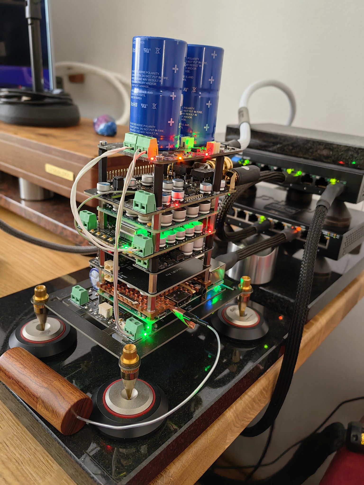

No, of course I'm not running screens or any other peripherals on my Rpi. I have it for audio purposes (endpoint only), not multimedia and I'm a purist, so everything unnecessary is disabled on kernel level. Still and again, my RPi / Purepi tower doesn't consume more than 1.5A even during the start of the battery charging and one additional network switch to power.Are you running a DSI screen and an SSD drive or other USB devices? RPi4b can draw up to 3A max according to manufacturer. I tried my RPi3b with the $100 iFi 2.5A adapter with screen and usb SSD - no dice. I had freeze ups. When I switched to a cheaper 3A supply freeze ups went away. Now I need to find a quality 3A or use some of Ian’s better power gear to supply the PurePiII with 3A of clean power.
@WladimirMXP ..purist here as well... like it..the wood-role is for grounding?
Especially your stacked D-Link switches I love (i personally use Paul Pang, as well an TeraDak with external linear PSU)...it makes a difference for me, for an "audiophile-grade DAC/Streamer" ;-)
Very cool stack. In my case the ssd is where I stream lossless FLAC from. So I need an ssd drive. I will get to purist mode one day and maybe separate the files from the enspoint. Been looking into Roon and such. Not there yet. In any case it’s the best sound I’ve had yet and the screen and drive work fine as long as the power is there and don’t affect the sound I am hearing.No, of course I'm not running screens or any other peripherals on my Rpi. I have it for audio purposes (endpoint only), not multimedia and I'm a purist, so everything unnecessary is disabled on kernel level. Still and again, my RPi / Purepi tower doesn't consume more than 1.5A even during the start of the battery charging and one additional network switch to power.
Wladimir mxp, could tou élaborate a bit on your stack? A purepi board seems to be the base power supply. You use an extra uc conditionner bevore powering the fifo? Did it improve things further? What dc cable did you use? As it seems that it may be an whole topic by itself. Did I see two shield pi pro? And the output is transportpi AES?
What « moves » were the more relevant in building this stack? What are the next steps in your purist approach?
