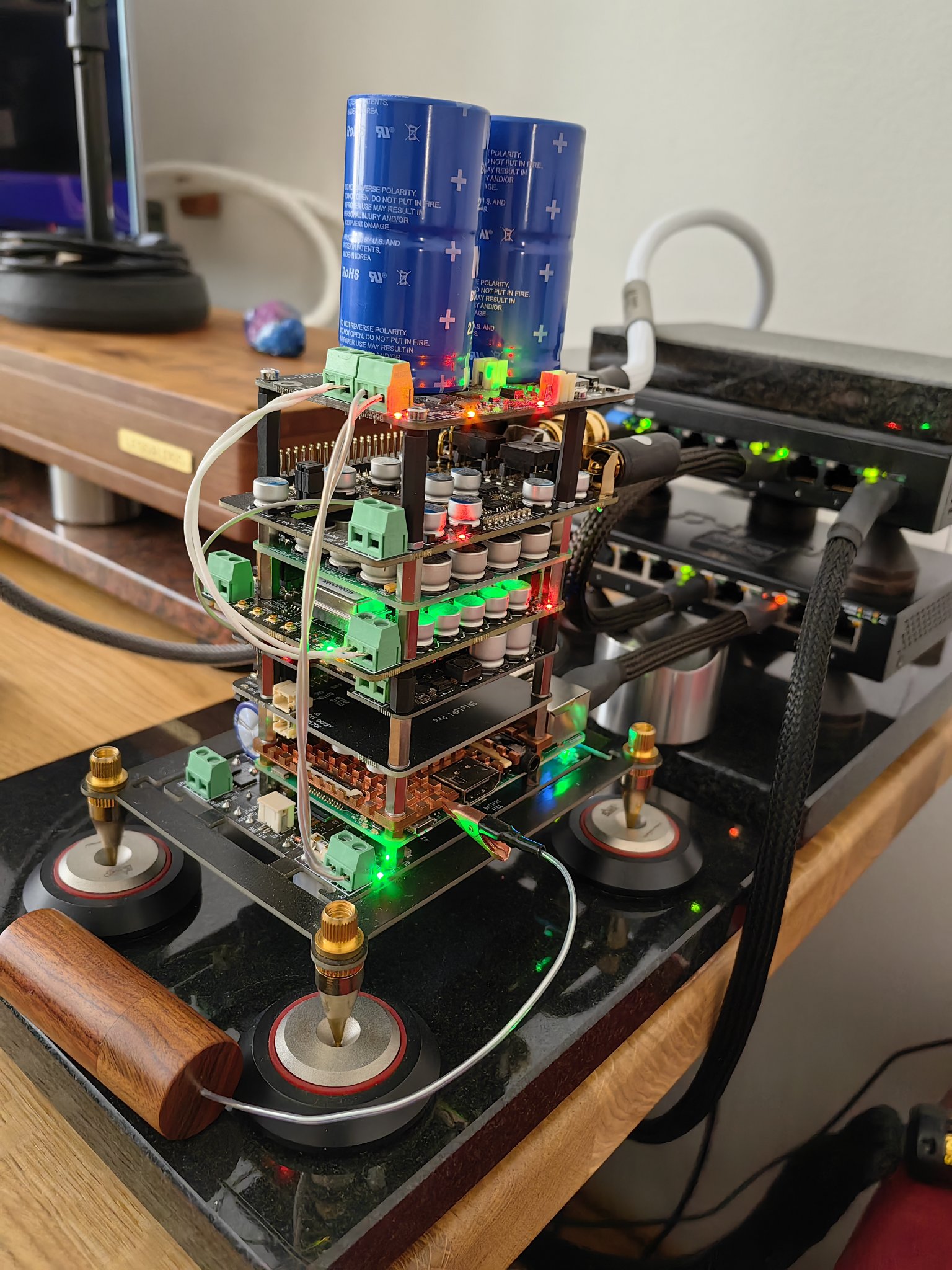

Hello friends,
wow didn't expect so many questions, I'll try to answer them.
The tower consists of:
PurePi
Rpi 3b (non-plus, just v1.2)
3mm copper cooling/shielding plate
Now onto Ians' boards:
ShieldPi Pro
Isolator II
FifoPiMa with Accus
Teradak shielding/filtering board
TransportPi AES
and obviously UcConditioner
DC cables are OCC copper/silver NEOTECH CU-AG-20-20 and now testing Mundorf Pure Silver/Gold 18AWG.
Plus there are some more important tweaks thorough and special care went to vibration isolation/absorption.
Also as @badd99 pointed out, Gentooplayer with Diretta is an important piece of it as well, especially when tweaked with kernel selection and other more tweaky tweaks :LOL: Benefits of having Diretta is like instantly having the best LAN cable out there and btw Diretta is free for playing redbook format. Other than an endpoint like this (or any other Rpi), you just need to set up a second source PC or RPi, connect those two on your network or directly as an server ("host") & endpoint ("target") and play :cool:

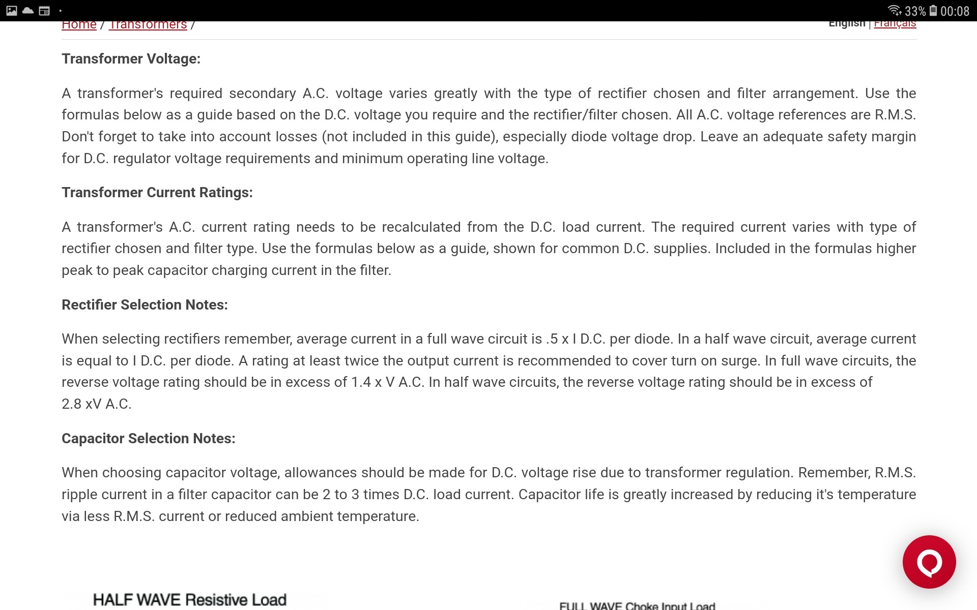

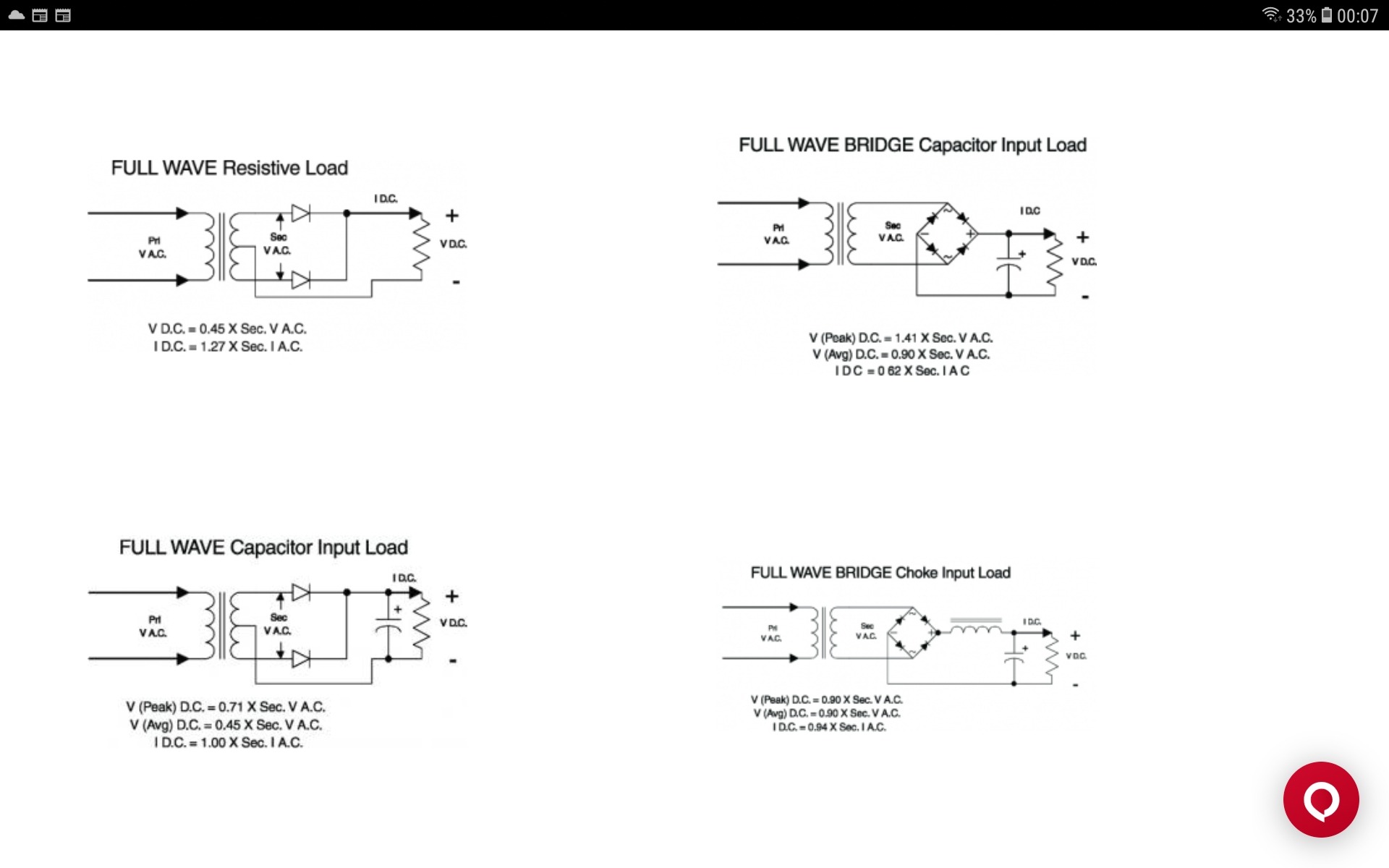

Hello,
Purepi max current during first start up was close to 1,8A
After draining the ultracaps with 2A load the new recharging was at a lower current then 1,8A
Original lifepo4 board has a 5v 2A that is recommended for the raspberry.
If you don't wanna make your stuff like a Christmas tree 2A will be enough.
I use choke input . To many people using their supplies the wrong way if you take a look at the Hammond website

@WladimirMXP ..purist here as well... like it..the wood-role is for grounding?
Especially your stacked D-Link switches I love (i personally use Paul Pang, as well an TeraDak with external linear PSU)...it makes a difference for me, for an "audiophile-grade DAC/Streamer" ;-)
hey @gerihifi , yes that role is for grounding, I also use a second modded one with silver fork for grounding my network via the bottom switch (Aqvox SE).
As you said, switches unfortunately make a difference and not exactly a subtle one.. The more experiments I make, the more I find the importance of multiple reclocking of the music data along the way to the target. But there are some principles to follow in this delicate subject..
Disclaimer for others: I was a non-believer or sceptic at first, so don't attack me for my observation, if you find it impossible (as I did before).

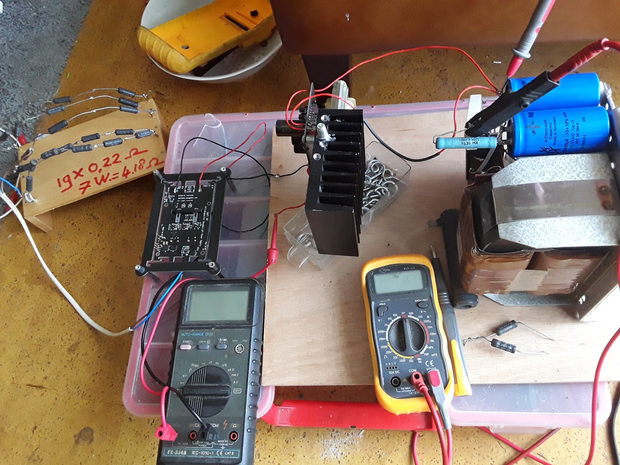

Hello,
I made a string of 0,22 ohm 7 watt resistors so i could easily compose a load like 2 or 2,5 A . A 2,5A supply was recommended for the purepi. So i did some test to make the LCRC supply that feeds Doede's 5 volt supply.
After some test i connected the purepi and measured the max current was only 1,8A so i " redesigned " the supply for 2A
Of course most cheap 2,5 A supplies available on the cheap part of internet where most of us will buy their stuff were not actually designed to deliver 2,5A all the time for a decade so Ian used a safety margin.
Greetings,Eduard

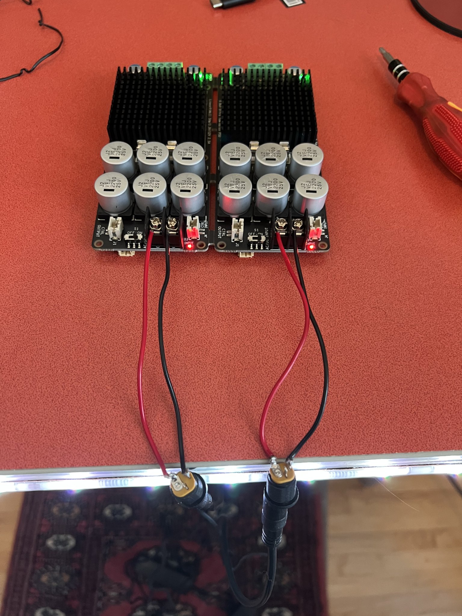

I have the LinearPiMkII Duo no less - now powered by 2 12VDC power adapters!
This will power my OPA861 I/V board on the Ian DAC stack I’m making. I’m getting the required 5V out the other side like I should.
All that gear just to clean power that little tiny analog board for the XLR outputs!
Super excited.
Stay tuned for the stack build.

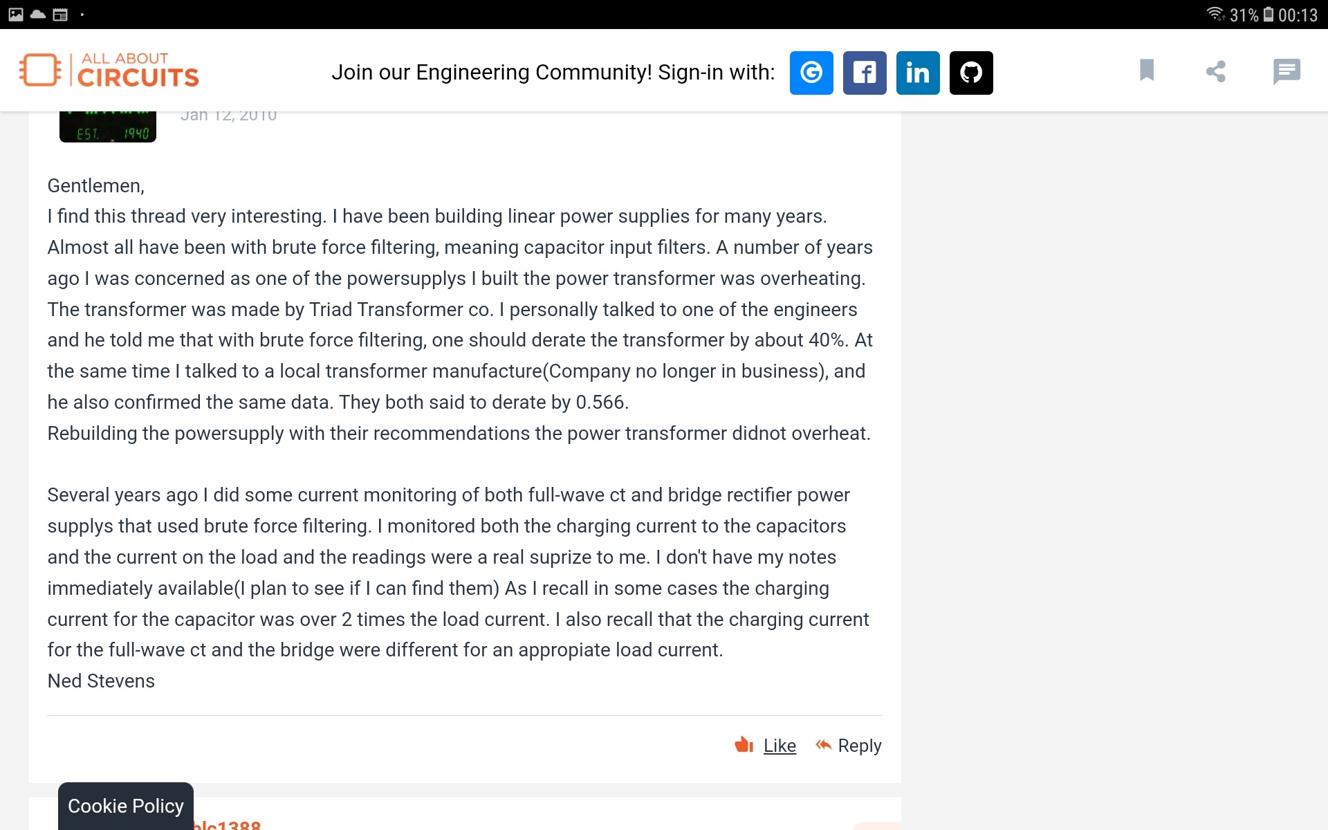

Hello ,
Short paths is a good starting point. For my power supply test set up i used a bit longer wires because i wanted to be able to turn the circuit board upside down.
The connections between transformer, rectifier, input choke and first cap need to be short. You always read that is where the work is done and done continuously because 2A drains your supply really quickly.
You can read in the Hammond document with a cap input current being drawn is far from steady.
