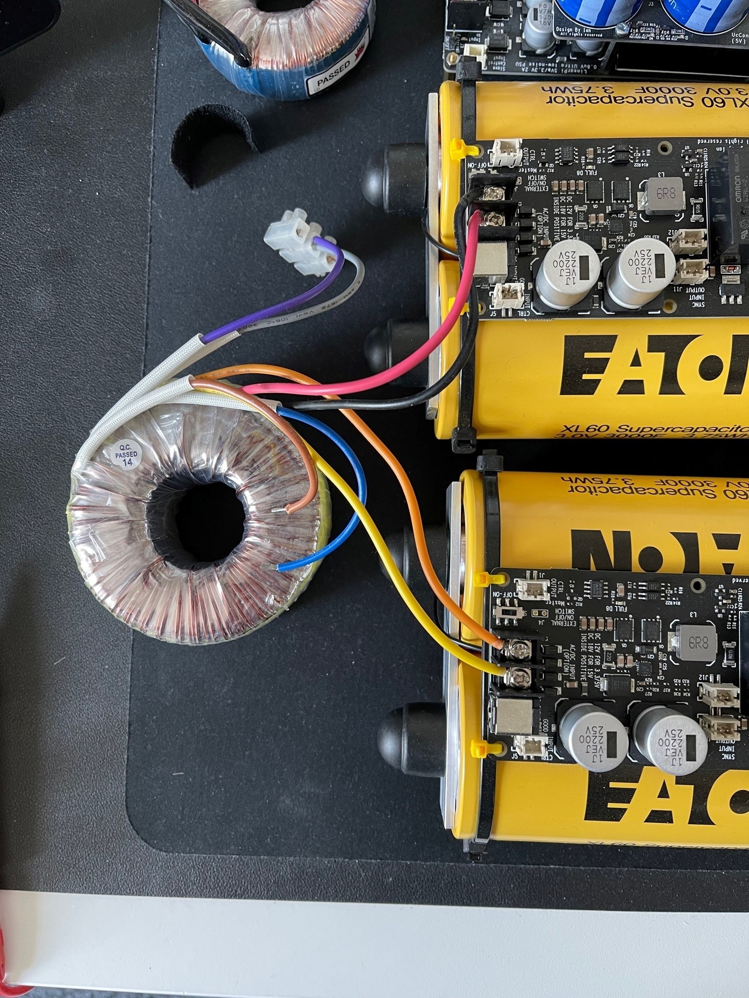

I use 2 x 5v UcPure for mine as the best PSU Ian does - https://github.com/iancanada/Docume...citorPowerSupply/UcPure/UcPureMkIIIManual.pdfI have a purePi 2 for each stack. I re read the manual. To power the OPA I/V I need a dual linear pi.
Where I’m stuck is what to power the dual linear pi with? His guide recommends a toroidal to supply AC but also says you can use DC non polarity supply??? Page 4 and page 7 of linear pi dual manual. I have no ideas what to shop for. If I build the toroidal thing is there a guide somewhere.

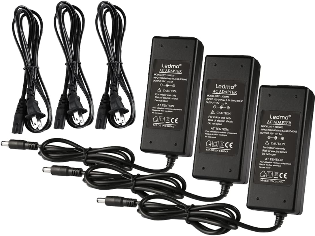

Would these work for LinearPi Duo. I need to get +5 and -5 out of each one. Manual says I need 12V DC input if I use DC.
LEDMO 3 Pack LED Power Supply, Transformers,LED Adapter, 12V, 5A Max, 60 Watt Max, for LED Strip Light
I would just cut the ends off and attach to the terminal blocks on each side of the Linear Duo?
Correct 2 x 5v Uc Pures tapped to give +5 & -5 volts. I power my 2 with a single transfomer with 2 sperate windings using the AC inputs but you can use 2 x laptop PSUsSo I would need two of those to get the centre tap for the OPA? And you power these UcPures at J6 with laptop power adapters?

Cool. What does the molex white plug on the toroid plug into ? 120v. How do you keep it safe. Where is the fuse?Sure....

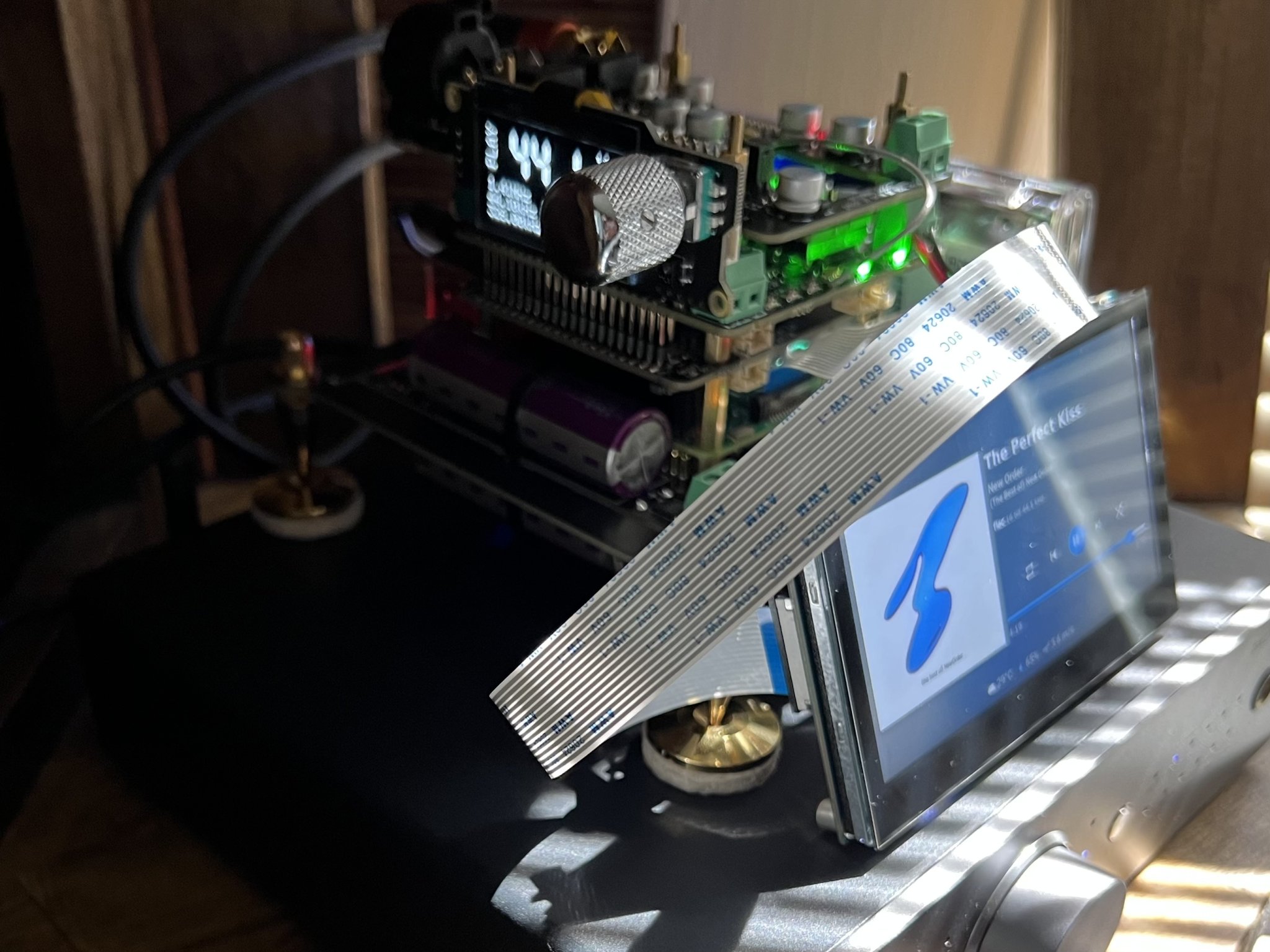

Back to the streamer stack while I await power boards to finish the DAC build….
I played some sound recommendations from @Gabster 2000 to test. It really sounds amazing. On the silence track there is absolutely no noise I can hear. I have a DSI screen. Doesn’t seem to impact sound. I do have a ShieldPi pro mkii. No other shielding yet.
Stack as is in picture is
1. PuriPi II
2. RPi3B with external SSD FLAC and ShairPlay enabled in Volumio.
3. ShieldPiProMkII
4. FiFoPiQ7
5. MonitorPiPro
6. TransportPi AES —> coax rca digital out —>
7. Cambridge Audio DacMagic200M - dual ESS9028Q2M —> XLR balanced
8. Focal Audio 50s professional powered monitors
I know many of you have way better amps and speakers - my room is small and this is just serendipitous.
Everything is so tight and open and clear.
When I build the DAC with dual 9038Q2M we’ll see if I can kick the DM200 butt 😂

It’s 240v in the Uk here and what you see is not at all done. It will all be fused and correct are wired right. That connector is where the 240v AC is applied. I suggest you stay safe and use laptop PSUs to power the UcPuresCool. What does the molex white plug on the toroid plug into ? 120v. How do you keep it safe. Where is the fuse?
