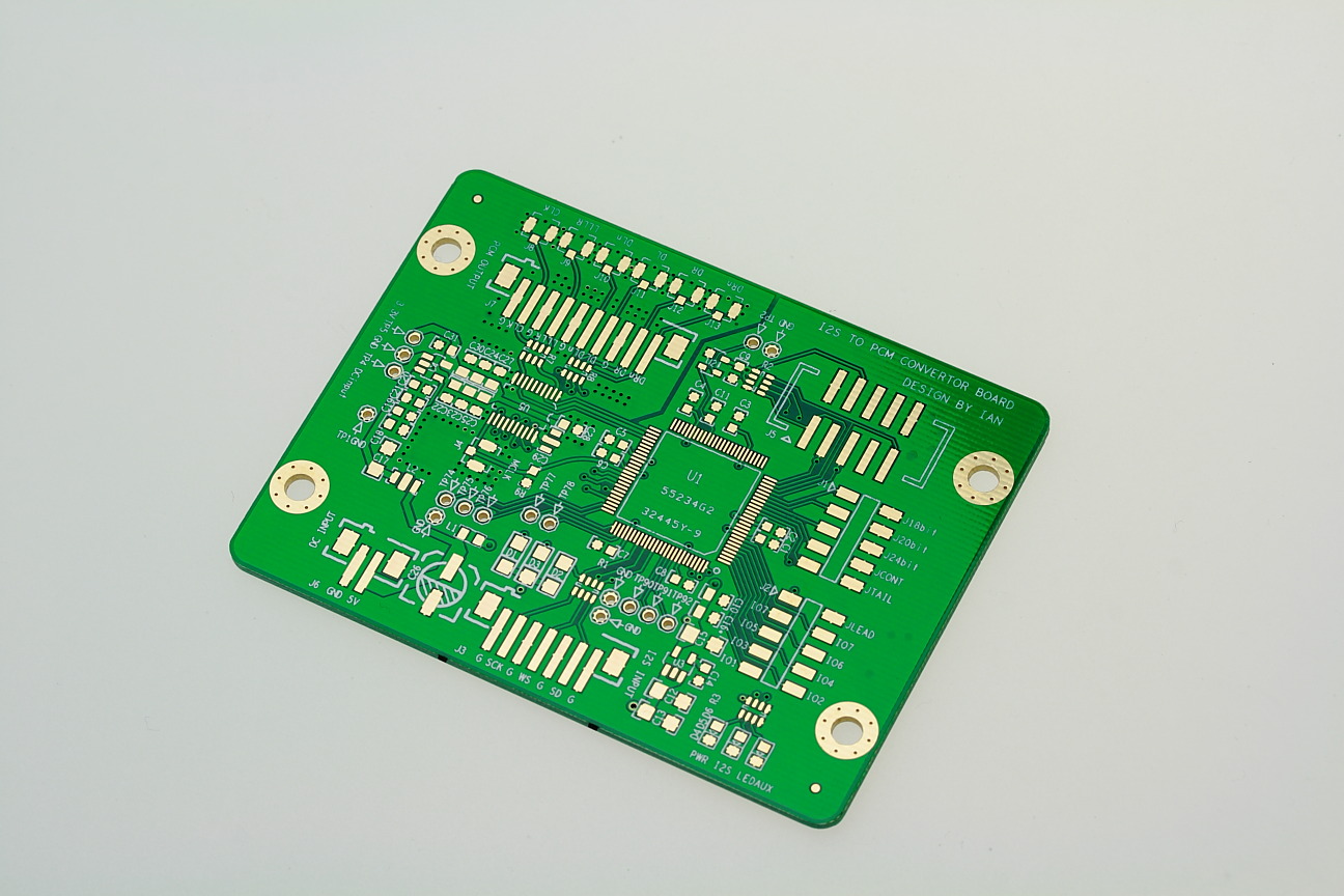

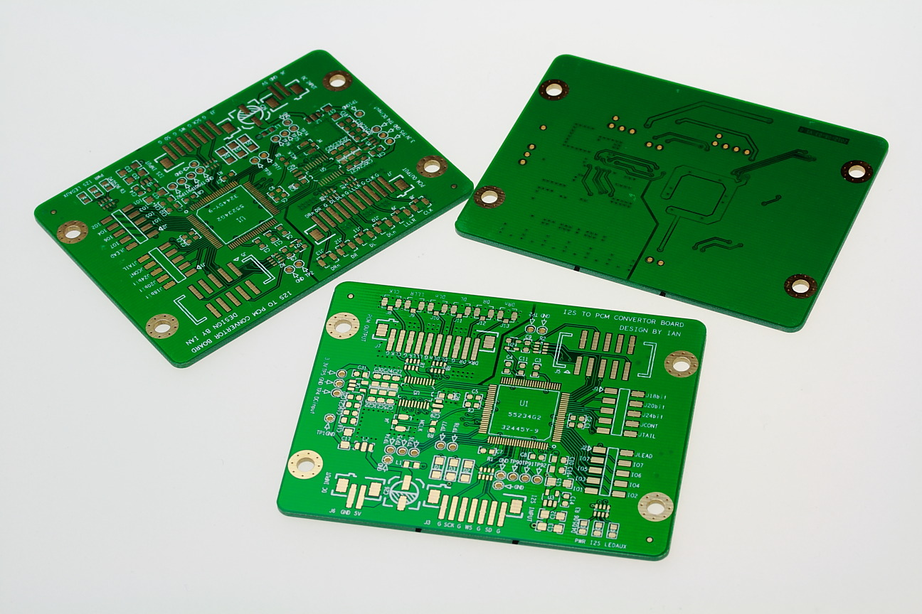

Hi Regal,
Got the I2S to PCB convertor daughter board PCBs.
I'm thinking about your suggestion opening a new thread for this project. Because this project is becoming a universal I2S to PCM convertor, it could not only interface with FIFO KIT but also interface with any I2S sources together with MCLK. All NOS DAC will benefit from this projcet, even TDA1541 🙂. The FPGA/CPLD design is 100% synchronized logic and the output timing will exactlly fit those NOS DACs.
