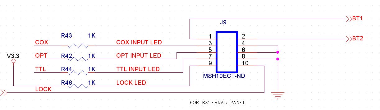

Ian, thanks for your reply. I did some measurement on the 10 pins and found the following :
Niether Pin 1 nor 2 is connected to GND, and I can't measure any voltage on both pins, should I need a relay to short these pins for input selection?
Pins 3, 5, 7 are GND, and 2, 4, 6 can provide logical high for input detection.
Pin 9 and 10 are not connected to GND or 5V, so I need additional circuit to provide logic "high" for SPDIF lock indication.
Are my measurement and assumption correct?
Hi bigpandahk
You did correct measurement.
1, The key button is scaned by the internal state machine, so the logic level is not fixed or determined, using a relay is a good idea. The 'on' pluse could be around 100ms;
2, Defferent from other LEDs, the lock LED is an active low logic;
I attached the schmatic of the panel interface below, everything should be clear.
Have a nice weekend.
Ian

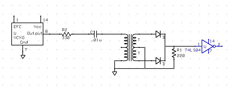

That's a good idea. But the low phase noise doubler would be the key part 🙂. Any reference design?
Ian
Here is a first pass. The principle is to generate a positive edge on each transition. At low frequencies this won't work but at 50 MHz the source rise time is slow enough to make for more of a triangle wave than a perfect square wave. I would breadboard it before committing to a layout.
First, Minicircuits has many well suited transformers and they are pretty reasonably priced. Second, use Shottky diodes, there is no signal or transition time to waste. The capacitance is low and the phase noise will be lower. Third, getting the gate to switch will be the challenge and may need tweaking. For a 100 MHz output you will need a fast scope to see what is happening and very good technique to see it well. No long ground leads. Use a sampling scope if you have one. The period on the output will be 10 nS or a transition every 5 nS. The gate on the output should be 74AC04 and well bypassed.

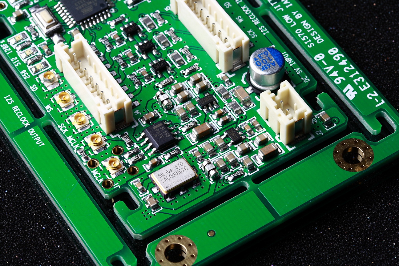

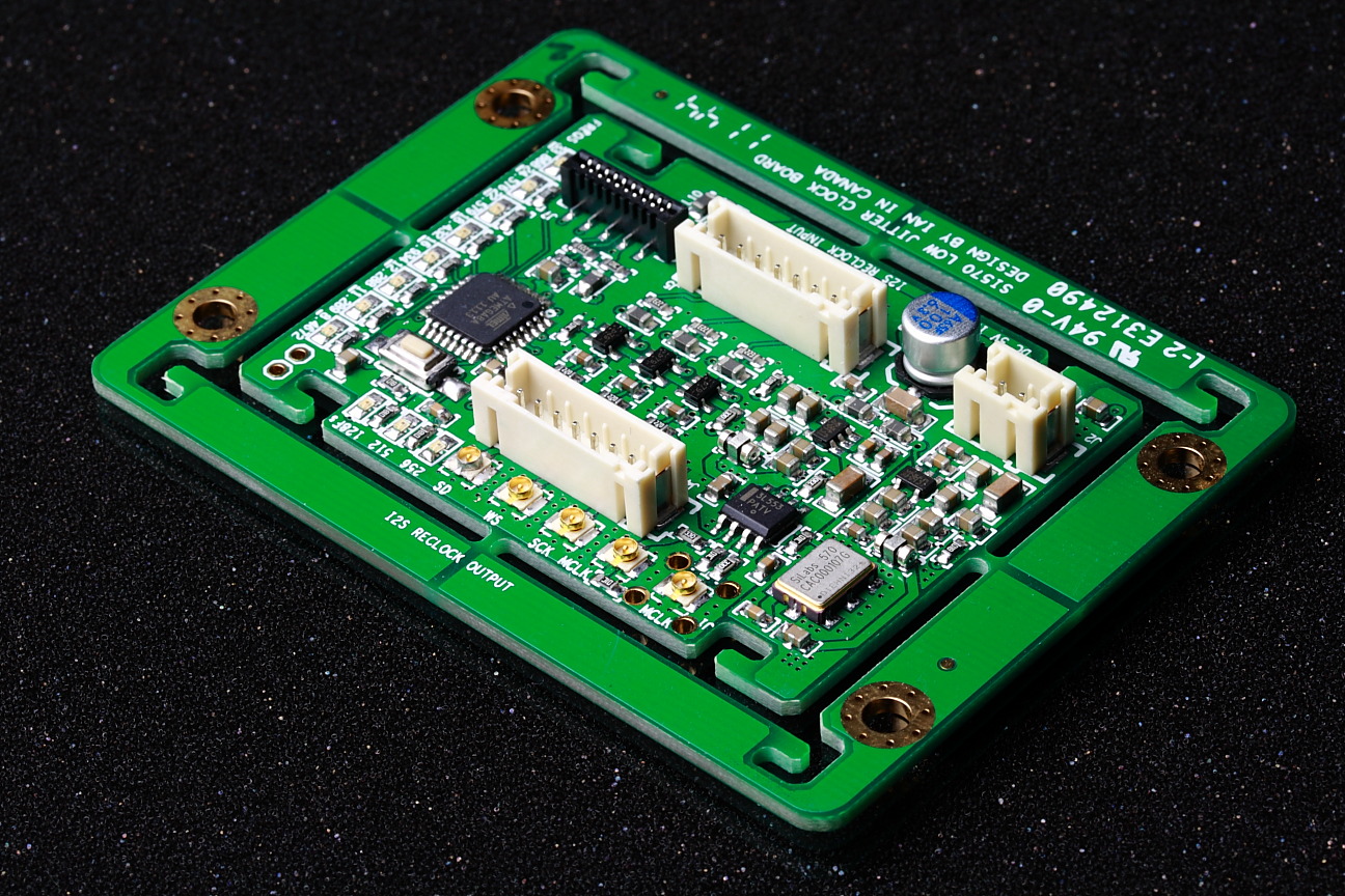

R&D progress, Si570 based clock board, first prototype
The first prototype of Si570 based clock board was down. With the single programmable XO, now I got 11.2896, 12.2880, 16.9344, 18.4320, 22.5792, 24.5760, 33.8688, 45.1584, 49.1520, 90.3168, 98.3040 MHz. Switching between frequencies will take only a couple of ms. Pretty amazing for such a small gear.
This Si570 based clock board could be a universal digital audio clock generator/FIFO clock board/ESS9018 sync mode clock board (90.xxx and 98.xxx).
FW driver was down. Hardware still need some revising to support 2048*Fs with perfect on current V3.80 FIFO FW.
Ian
